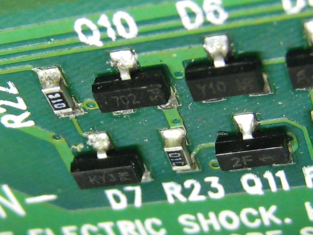

                  #88
                  Re: UPS and inverter questions
                  Davmax the temp was 100F.
                  The relay states in the diagram are with the ups unpowered.
                  I measured power from the center tap on the AVR transformer and one side was 85 volts and the other was 75 volts.
                  Broken parts:
                  Q10 is the mosfet and the diode D7 is shorted also. It is driven by the microcontroller. The diode has KY3 on it.
                  Now we're really getting somewhere.
                  Here's a picture of both.

                    #89
                    I not sure that you have given the important voltage readings. You quote two sides. It is important that you measure and quote voltages with respect to neutral as previously defined.
                    I am glad the temp was 100F and not boiling.
                    D7 does not look like a diode compare with D6

                    • davmax
                      • Dec 2005
                      • 899
                      #90
                      problem what made Q10 and D6 blow???? Does this mean a shorted relay coil? Compare with other inverter.

                      • andrew77
                        • Jan 2008
                        • 81
                        #91
                        Sorry, from neutral to the center is 75 volts. Wasn't using my brain, I put it back together to test it after realizing it says on the board "AVR CNTR" and "AVR TOP". The center one was obviously lower.
                        The relay is not shorted. I unsoldered it and tested it earlier.

                                          Originally posted by davmax
                                          Funny I must be missing it. I could not pickup link to code book. Does one have to be a member?
                                          No, let me give you some more links.
                                          http://www.tkb-4u.com/code/smdcode/indexsmdcode.php
                                          http://www.marsport.org.uk/smd/mainframe.htm
                                          http://www.the-foundation.be/smd_codebook.php
