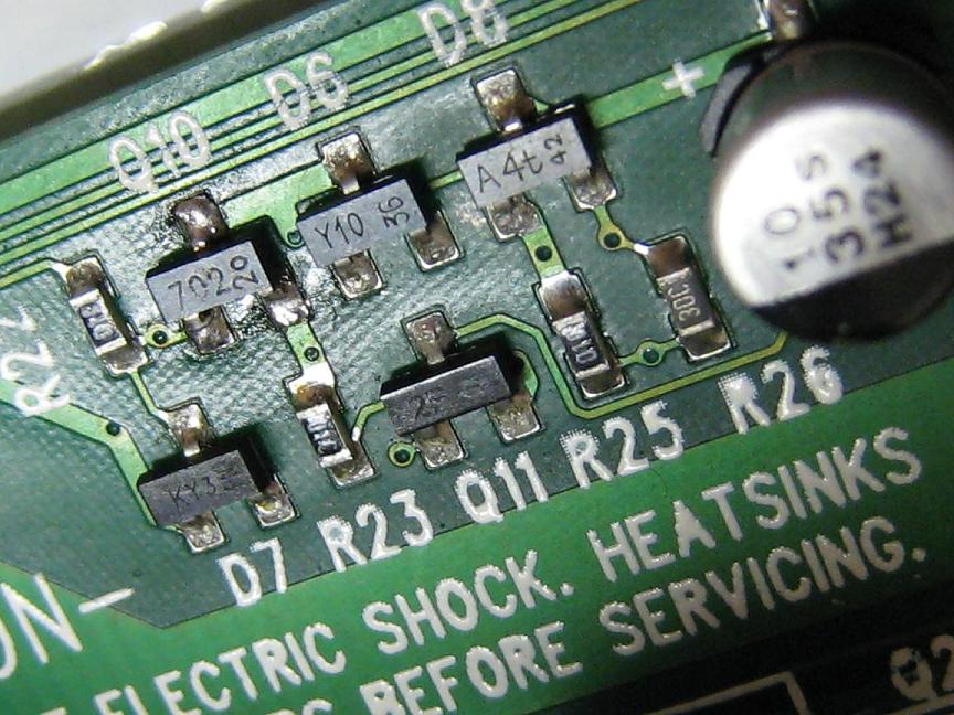

    Have looked at this link: http://clivetec.superihost.com/SMD_CodesK.htm
    Gives Q10 as 60V 0.11A MOSFET, D6 as 27V Zener and D7 KY3 as N FET ???
      KY3 is wrong, search with google as KY3 diode. All the others are right, I think.

        Have a good night . KY3 confirmed 13V Zener.

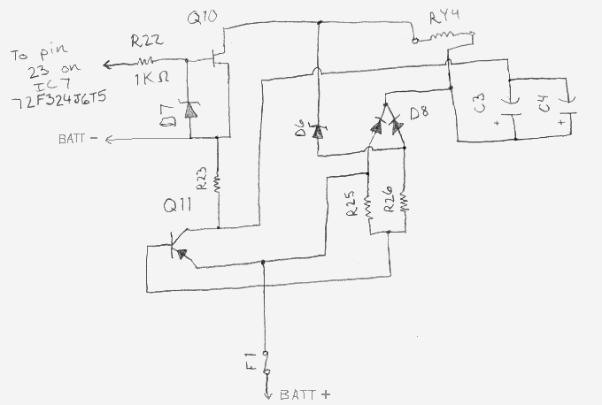

            Here's what I did:
            Replaced Q10. That didn't fix it, but I noticed when I unsoldered Q10, D7 was not bad.
            So I made a diagram of how this part of the circuit works. I found out that D8 was two diodes, and both were blown open.
            I replaced D8, and now all of it works.
            Now all I have to do is order parts for the other one, and diagnose it.
            Thanks for all the help that's been given. I'll order the parts and wait for their arrival. Probably be a couple weeks.

            Here's the pictures and some extra stuff.
