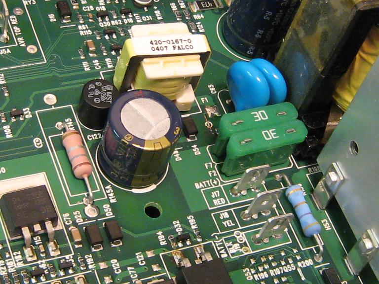

      2 The burnt track is in fact a fuse F1. This is quite a common trick, to reduce the track width to create a fuse. The fact that it has blown indicates a fault current. The circuit needs to be traced from this point to find out what components are supplied. You will find a short there.
      3. Maybe your shorted transitor is the cause. Have you lifted the transistor legs to confirm a device short? When you do also check the diode alongside, make sure it is not shorted.
      There was a trace that was blown on the other side of the board and I repaired that first before replacing the 94-2358. This caused the F1 trace to blow, because after I fixed the trace, the UPS wouldn't do anything at all. It did actually show some signs of life before.
      I soldered up the gap after I replaced the 94-2358 from the other UPS that I have. That 94-2358 was definitely shorted, if you look closely at the first picture at the top of the thread you can see a little chunk missing from the part.
      After I replaced the shorted MOSFET and soldered the blown traces, the thing shows signs of life, but it still doesn't work right. Probably some of the other components are bad.
      That part (94-2358) is for sure a MOSFET. There's a test that I found on google that shows you how to do a simple test with a multimeter to prove that the gate still works. This part worked with the test. The other part that I pulled last night, 94-4311, doesn't act like a MOSFET when you do this test. Maybe this part that I'm testing is damaged it did get hot enough to make the tin on the leads melt off, but it's not shorted. It's probably not a MOSFET. I'll pull one that isn't heat damaged and retest.

                            I apologize for not making it more clear what I'm working on, so here it is:
                            http://www.shentech.com/1055427sn.html
                            The output is supposed to be about 115 volts, but I think I was seeing 95 volts. I'm not too good at electronics and I don't think this meter is giving me a totally accurate reading since I don't know whether or not it's output is a sine wave or a modified sine wave. Pretty sure it's a modified sine wave, but it does seem to have more electronics than it should.
                            I dismantled a Belkin 550VA earlier today and took some pictures to see how it was put together, and it only has 4 MOSFET's for the inverter part in it. There's also only one transformer in it.
                            I'm trying to find where the blown trace goes to, I guess I'll have to unsolder where I fixed it at and I'll be able to see where it is going. I'll get back with you when I figure it out.
                            Let me know if you need more pictures because there's nothing stopping me from taking more. Just let me know what part you need to see.

                                    By the way. How was the F1 fuse bypassed? It can create further damage if you do not replace witha similar level of fusing. I would have stripped a multistrand wire and used one or more thin strands of copper conductor (to approximate the original blown copper).

                                      With the F1 fuse, all I did was bridge the gap where it was blown with some solder. The area that I had to repair the break was really tight. There's a little inductor that looks like a transformer but it only has two wires, then there's the two fuses that are in the way, and the two capacitors.
                                      The circuit breaker is inline with the power cord. I guess the breaker is there to protect the UPS, and it only protects the load from utility power?
                                      Anyway here's a picture of where I had to solder the thing. The capacitor that is near is about 16mm tall and maybe 15mm wide.
                                        #39
                                        Re: UPS and inverter questions
                                        1. I understand that the breaker is in the input power lead , right!
                                        2. It can be fatal to do what you did. ie bridge out a fuse with solder. Use the correct fuse rating at all times. Go under the PCB if necessary.
                                        How is circuit tracing from F1 and MOSFET testing? Needs to be checklisted.
