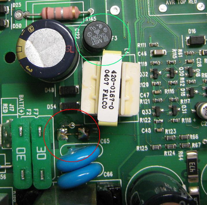

    Here's a picture of the hot spot from the board, it got so hot it melted the case a little.

      OK, here's the update for what I've found now. I replaced my bridged soldered connection with a tiny piece of wire(red circle in picture) probably like 40 gauge or something like that. Then I found this other fuse F3(green circle in picture) it was blown, so I took it apart and did the same thing to it.
      I put everything back together and still it does the same thing. It gets up to like 85 volts and then kills the power. This takes about 3 seconds. I've had a 60 watt lamp plugged into it and started it on battery power and the inverter part runs for 3 seconds. The "Battery Backup Ready" and the "Battery Outlet Overload" lights flash alternately after it kills the power to the inverter section. After I turn the power off completely and it sits for 30 seconds or so, the "Battery Outlet Overload" light comes on and stays on.
      I've also noticed the 12v voltage regulator IC11 (7812c) seems to have gotten really hot on both boards. The board is discolored on both sides where the chip is.
      I don't know where to go from here. The other board has no blown fuses, but does have two shorted high voltage MOSFET's on it.
      I should have remembered how the inverter part works, since I looked it up like 6 months ago. Must be getting old.
      Fuse F1 comes straight off the batteries, so there's like 26 volts when it's fully charged. The side that doesn't go to the drains goes through the inductor L4(you can see that one in the middle of the picture), through capacitor C122 which is 390uf 50v, and then goes to the three 94-2358 MOSFET's.
      I appreciate all that everyone has contributed to helping me. It's really made my brain start working again, and I don't think I could have gotten this far without your help. I'll have to look at this for some more hours and maybe I'll be able to figure out exactly what's going on in it and report back.

        1. Fuses. F1 not only protectes components but if shorted with solder it can burn out a thin PCB track somewhere. The Green fuses look like blade fuses and need to be replaced by a new fuse of same rating. What is the current rating?
        2. Well thats great that you have found a definite fault ie two failed MOSFETs in the output. Replacing them may get that unit going.
        3 . Hot regulators 12V. Have you checked their operating output voltage? If heavily loaded they may have a low output and these would indicate a fault. Maybe these devices need better heatsinking!? Simply get very hot.
        4. Battery voltage. I thought these units had a 12V battery where the voltage should not exceed about 14.5volts. You quote 26 volts which would indicate a 24 volt battery. I am curious.
        5. I am a little confused about the F1 circuit. I read that one side goes to the drains of 94-4311 and other side apparently goes straight to battery (that makes a lot of sense) indicating that some heavy current must have flowed through those devices to blow F1. You add that the circuit goes through an inductor and capacitor to the three 94-2358 MOSFETs, the cap would appear to be DC current blocking, it would seem that these MOSFETs are on the supply side of F1 and could not blow the fuse. What is the connection to these MOSFET devices? source or drain? This would mean that these MOSFETs are connected to the battery via the inductor and cap. Is this correct?
        6. The hot spot photo. What are the two components that got hot? Look like MOSFETs. Which inverter?
          I didn't take the fuse protection completely away. All I did was bridge the 1mm gap with a tiny bit of solder, but since you mentioned using wire, it was a very good suggestion to use a thin piece of wire as a fuse. So I used a single strand of really fine wire to bridge the big gap where a fuse should be. Did you see the wire in the picture? It's not real easy to see, it's about the diameter of a hair.
          The green blade fuses are 30 amps and they didn't blow.
          I apologize for being confusing. The side of the F1 fuse that is near the Green blade fuses goes through those fuses to the batteries. So the drains from the low voltage side of the inverter go through the 30 amp fuses, and not the F1 fuse. I guess it's just a common point where these parts are connected like a buss bar or something.
          The fused side goes through the inductor L4 and the capacitor C122(50v 390uf). It also goes from the capacitor to the source pins on the 94-2358 MOSFET's. It's a little hard to follow since some of the traces are hidden beneath components. I'll unsolder the inductor to look at what's underneath it. I know there are some diodes right next to the capacitor that are connected somehow to the capacitor and inductor.
          This is the one that I'm using for parts. It underwent the same overloading as the other one, but somehow the fuses didn't blow, only two of the high voltage MOSFET's shorted. The current sensor may still be good on this one, not that I know that the one I'm working on is bad. I mean the lamp I used wasn't dim when I turned it on.

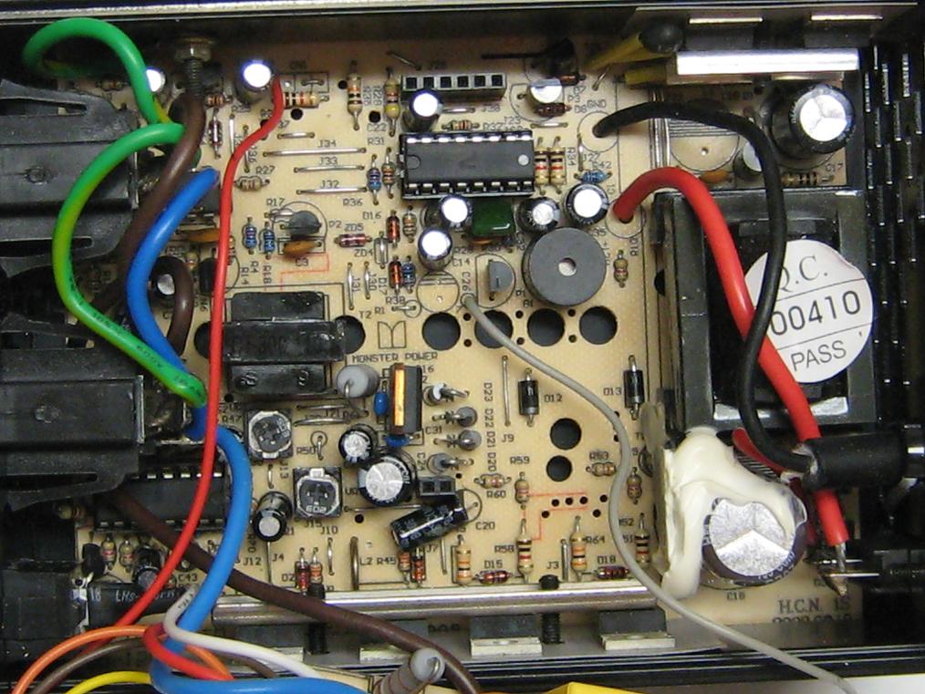

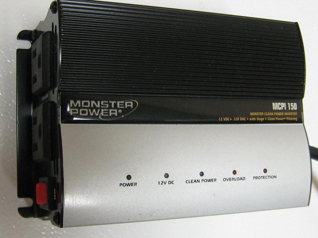

                Since I'll be busy for a few days on these schematics, I'm posting the schematics that I made from a 150 watt inverter made by Monster Cable. It's almost exactly the same for the way the circuit works. It has a current sensing transformer, 55 volt MOSFET's in the low voltage section and 200 volt MOSFET's in the high voltage section.
                It uses two IRF3205 for the low voltage and four IRF630 for the high voltage section.
                I really should have remembered all this since I did the schematics, but I didn't know what the current sensing transformer was. I thought it did something else. One of the unmarked chips that are on it is the oscillator and I don't know what the other one is. Maybe it's a wave shaper. The output is a modified sine wave.
                If you have any more questions feel free to ask. I have a written parts list for it, but I haven't typed it in.

                  Oh yeah, and the parts for the Monster Cable inverter.

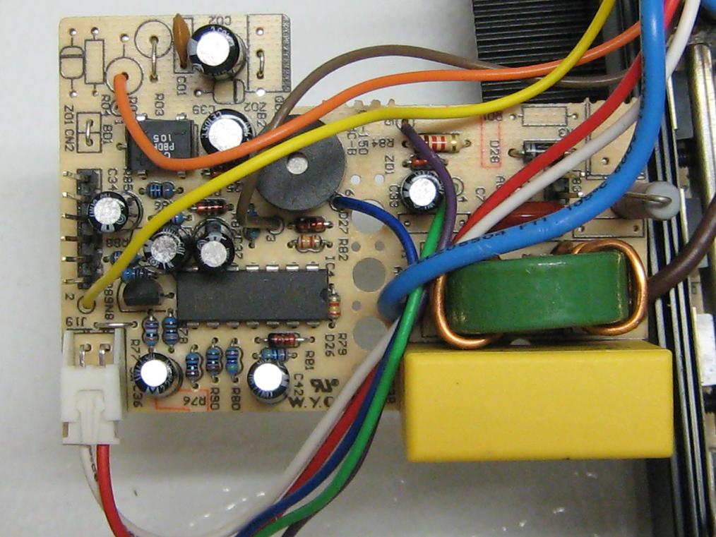

                        Does anyone know what these parts in the picture are?
                        • PCBONEZ
                          Grumpy Old Fart
                          • Aug 2005
                          • 10661
                          #52
                          Re: UPS and inverter questions
                          Use a magnifying glass and see if there are any numbers.
                          Also give us a local area scat for where they are.

                            The B is challenging, look like caps but I am guessing that they may be NTC or PTC resistors. Measure them with an ohmmeter. Are they resistive or not?

                              Are there any components designated with a B and that you know what they are?
                              Mann-Made Global Warming.
                              - Dr Seuss
                              • andrew77
                                • Jan 2008
                                • 81
                                #55
                                I get 0.1 ohms as 0 for my meter, and this component gives me 0.3 ohms.
                                No numbers. It seems to be wired like a resistor. There are only 5 of these on the whole board.

                                  Are they perhaps Biasing something?

                                    I have to look more at the circuit, but the two in the picture don't seem to be biasing anything. There is a long series of resistors before these parts. The other parts of the circuit that they're used in I need to study more, but I'm not sure if I'll be able to figure them out too easy. My electrical knowledge is pretty limited. I can read schematics, but I haven't been doing this long enough.

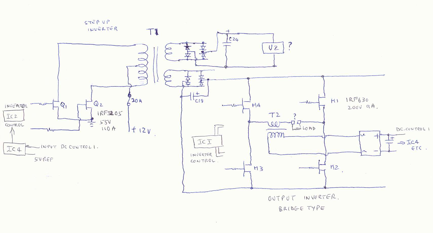

                                      Andrew. Thanks for your schematic effort on the 150W inverter a great effort. I have attached a rough sketch that changes the layout and makes it easier for me to interpret the operational fundamentals of the power circuits.
                                      What I see is a triple conversion UPS (not too efficient). First conversion 115VAC to DC for battery. Second DC to DC via a stepup converter using the IRF3205 MOSFETs and the transformer (T1) that has two output windings each with a rectifier. One rectifier supplies high voltage DC to the output bridge connected inverter (third conversion DC to AC) the other rectifier supplies a block labelled U2 whatever that is. Is it a possible second inverter for 230VAC out? Losses are incurred in all three stages.
                                      I see that no load current flows out of the output inverter unless an external load is connected. The current into the load is picked up by current transformer T2, rectified and applied to IC4 as a 5V reference and a voltage proportional to load current. The output of IC4 goes to IC2 that controls the switching of the stepup converter. Seeing this converter provides a voltage supply to the output inverter the voltage must be adjusted for load compensation.
                                      The output inverter bridge configuration defines that the inverter delivers either a single level modified sine wave or a PWM sinewave. I believe you have evidence that it is the former. The MOSFET drive is controlled by IC1 that has circuitry that monitors the voltage across the load + T2.
                                      There is no evidence of overcurrent protection within the output inverter itself.
                                      Temperature monitoring is by TC1 on your circuit and this only affects the stepup converter control.
                                      The finer details of operation need more component detail. However the above should be sufficient to identify power circuit problems.
                                      How this relates to your current inverters has to be seen. The three MOSFETs (one blowing) is an odd number that does not appear to relate to this circuit.
                                      If you are tracing the circuit try to create a layout similar to my rough sketch.

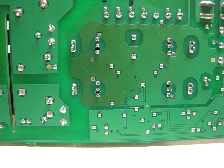

                                        Sorry, I must not have been using my head. U2 is L7812CV, a voltage regulator. T2 is the current sensing part of the circuit, the transformer is like 300 to 1 or something like it.
                                        Probably should take a picture so you can see what the boards look like.

                                          Here's the pictures of the 150 watt Monster Cable inverter. The red and white wires go to the ON switch.
