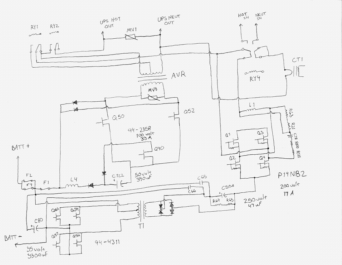

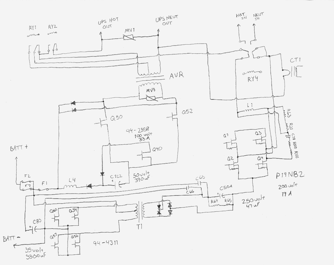

        • andrew77
          • Jan 2008
          • 81
          #64
          Re: UPS and inverter questions
          OK, here's a rough schematic without any control circuits, and I wasn't sure what else not to include. It should give an idea of what's going on.
          • andrew77
            • Jan 2008
            • 81
            #65
            Success
            I've got one working now! There was a shorted SMD transistor(2F) Q35 that was causing it to not stay running. I robbed the transistor off the other one. Now it stays on.
            I guess I have to fix the other one now. Thanks everybody for helping me solve this problem.

              #66
              Well done. You found the faulty transistor.
              Also that diagram is sufficient. So the Three 94-2358 transistors are for charging the battery. It looks like the inverter only supports the load when input AC goes. Switched in by RY4. Certainly a similar design to the previous 150W job.
              The burned 94-2358 points to a problem in the charger circuit/control. It would seem that F1 blew witha back flow of current from the battery. Presumably the MOSFET short.
              Now you have to establish if the charger is working. You can now start to isolate circuit sections. ie a charged battery will run the inverter without F1, establish which of the two next stages is not working. Is there the right voltage at the input to the output inverter stage? ie across C50A.
              and so on.
              Making real progress now.

                                      I get 180 volts at C50A while it's on. As I expected, I get battery power at C80.
                                      RY4 is definitely not switching.
                                      How do I check these relays in circuit while it is on?

                                          I checked with my meter and it was charging at 2.25 amps for about 20 seconds and gradually went down. One of the batteries got to about 100 degrees when it was charging, and I didn't let it finish, since I didn't know whether or not it would kill it. The other battery went through the automatic charge and finished. Didn't even get warm. The one that finished is at 13.10 volts now, and the other one, after cooling off, is at 13.13 now. How long are they supposed to take to charge? 3 to 4 hours?
                                          I found a mistake in my diagram after unsoldering the relay RY4. I had the high voltage output of the inverter going to only one side of RY4. RY4 doesn't have welded contacts and seems to be just fine. The logic part of the circuit must be telling it not to accept line power.
                                          Here's the fixed schematic.
