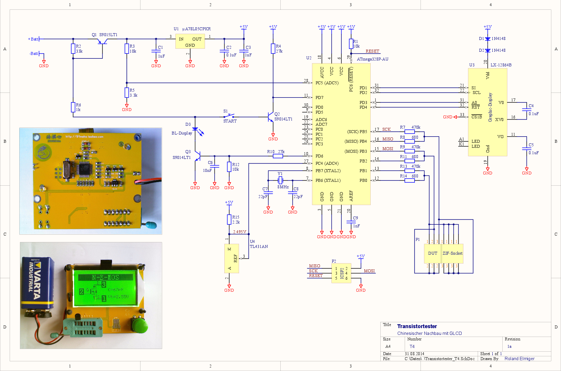

                Found some links in this thread:
                http://www.eevblog.com/forum/testgear/$20-lcr-esr-transistor-checker-project/
                All models (link can be found in the forum above):
                https://yadi.sk/d/yW8xa5NJgUo5z
                Youtube:
                https://www.youtube.com/watch?v=GfJizkJB21M
                Unfortunately, have no time to fiddle with this tester

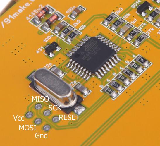

                What interface is needed to upload firmware into this?
                  • 31196
                  #48
                  Re: Help needed getting an ESR meter...
                  AVR programmer - preferably a chinese USBasp
                  http://www.ebay.co.uk/itm/261574745774
                  you will need to make a cable for the tester,
                  asp is 10pin, the tester is 6 and there is a second problem.
                  the T4 tester has the display right behind the pcb, so you need to lift the display a bit for safety before trying to solder to the board.
                  if it was me, i would get a right-angle 6pin connector or pinstrips, and cut them so they will be flush on the board, then lift the display and solder the pins.
                  then put the display back.

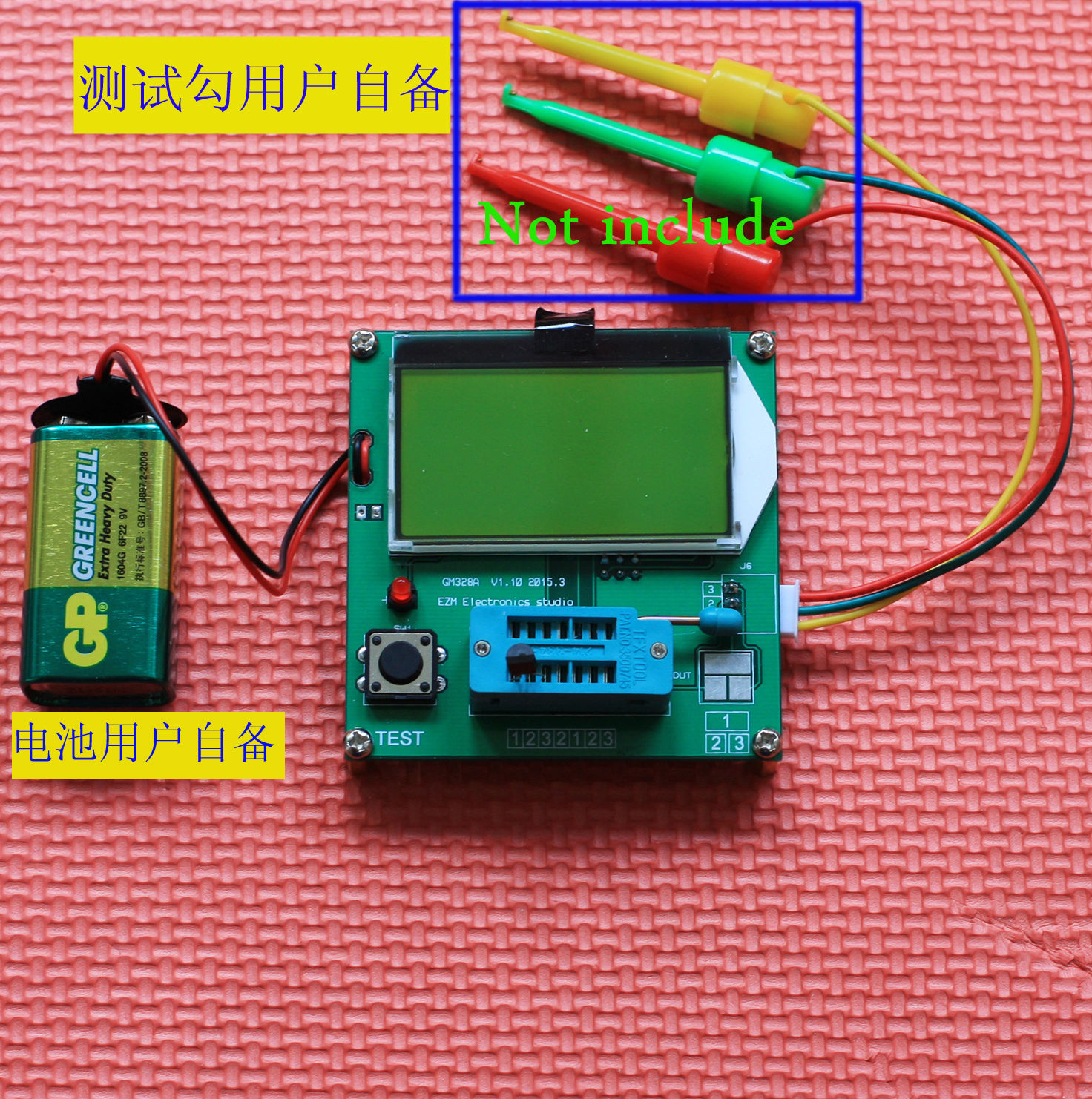

                                    I ordered this:
                                    http://www.ebay.com/itm/181861030068
                                    I've seen the following pic showing that the Test Clips are not included and was going to buy them separately...
                                    https://www.badcaps.net/forum/attach...1&d=1446559550
                                    I could get them from here for example:
                                    http://www.ebay.com/itm/5-Pcs-5-Colo...item419a26c354
                                    I got it yesterday. Turns out that the whole cable and the 3 pin plug were not included. I don't know how to search for it, is it proprietary plug?
                                    Right now the only thing I could do is order the mini clips and then solder the cables direct on PCB.
                                    If anyone knows where to buy it, please reply.

                                      #58
                                      The one I got is exactly the same but came with the connector and three leads but no clips. I got it here:
                                      http://www.aliexpress.com/snapshot/6...69560471073177
                                      I don't know what the exact spec is on the white connector but it looks like some I've seen for fans on video cards. The plug tends to work loose a little in handling but not a big deal.
                                        • 31196
                                        #59
                                        T-happy probably made a mistake, i got one from them with the cable included in the packet.
                                        contact them - they will probably send you the cable to keep good feedback.
