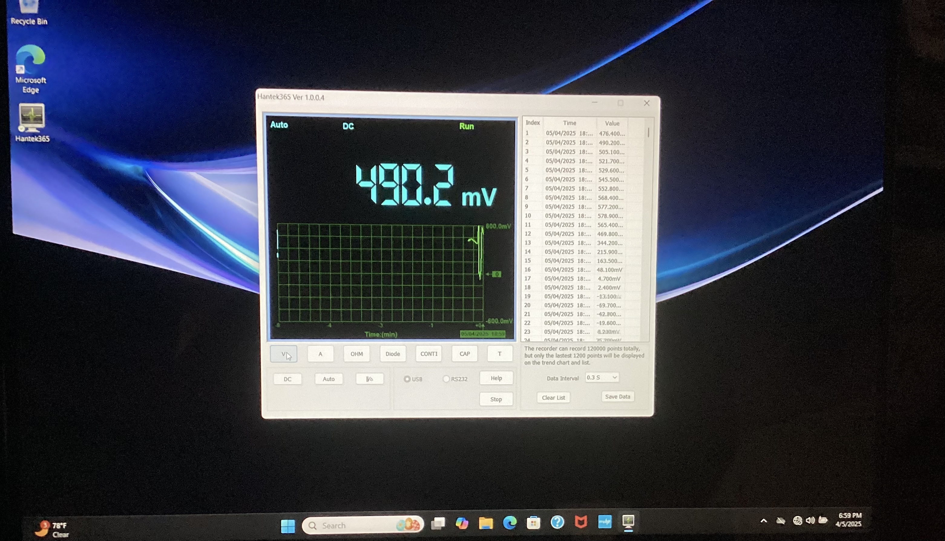

                  I finally got this meter today and I bought the new laptop computer and the USB drives would not load automatically you have to find the device in device manager and update the drivers and turn memory security settings to off to get it work properly
                  https://us.ampinvt.com/products/ampi...4aAu6iEALw_wcB
                  The sampling rate is very fast to very slow depending upon how you set it it seems to read dc voltage very well the only issue is and I knew this before I bought it that the current seems to be limited to six amps which is not a real big deal but I have to keep this in mind
                  The computer software seems to be very responsive to your function request and there is no delay from what I can see it does print the values on the right hand side of the screen which is very good the screen size for the meter is somewhat small but readable without straining your eyes
                  The graph screen is very small and there is a delay that is respectable and consistent but ( over time might not matter that much ) you could take reading output data and import to excel and turn it into a decent graph chart for your application if needed I probably will not go that far for now but I might look into if have to use the data to troubleshoot an issue with a BMS balancing board
                  The control panel on the screen is very well done and designed very nicely and very easy to navigate through the size of software file size is very small
                  One thing that was weird about this software that runs this meter is that when I finally found the usb device in the device manager and went to turn on the meter I got an error message that said that I had to turn off the memory security monitor for it to work properly
                  One other thing about this new computer is that was interesting is that you can turn off the WiFi by clicking the icon for the WiFi and turns off the WiFi a very nice feature because on some laptop computers you have to go to the internet connection screen to turn it on and off which is annoying as it can be if you want to turn it off and back on again later
                  Now I have to get another set of meter wire leads ( or more ) and put alligator clips to make connection to the battery cell or in series for doing the current function
                  Below is a picture of software screen size and you can see what I decided above

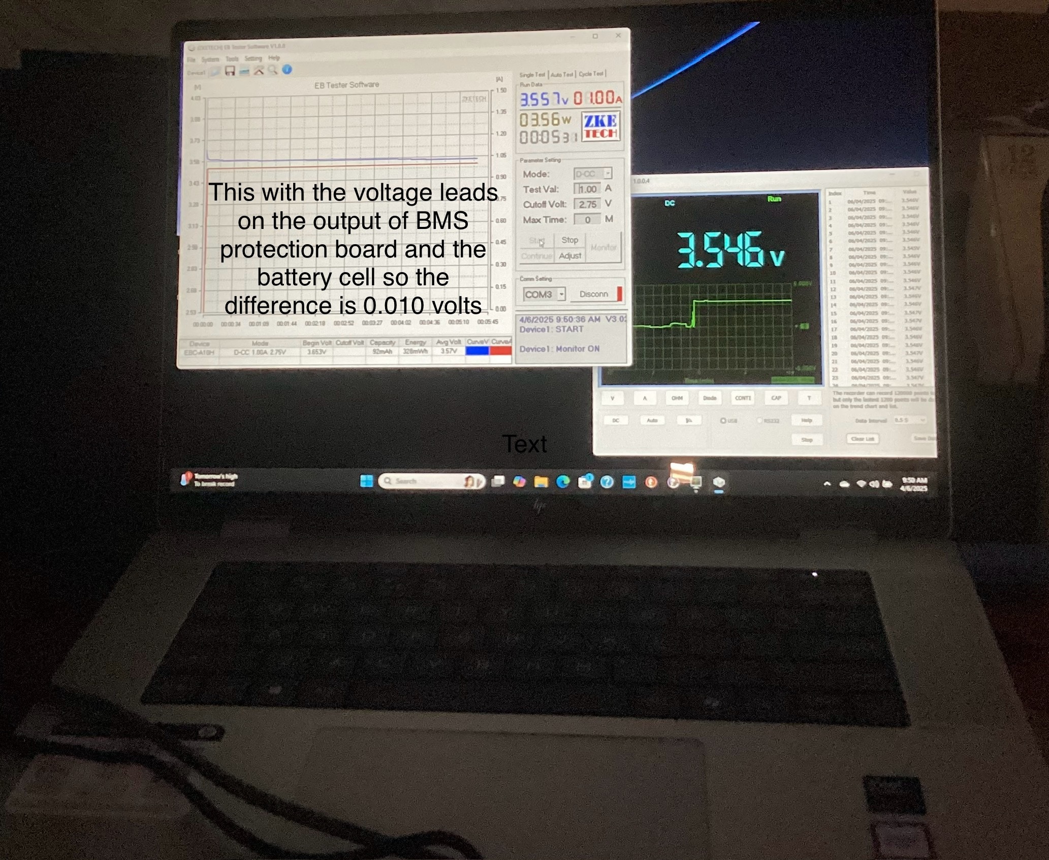

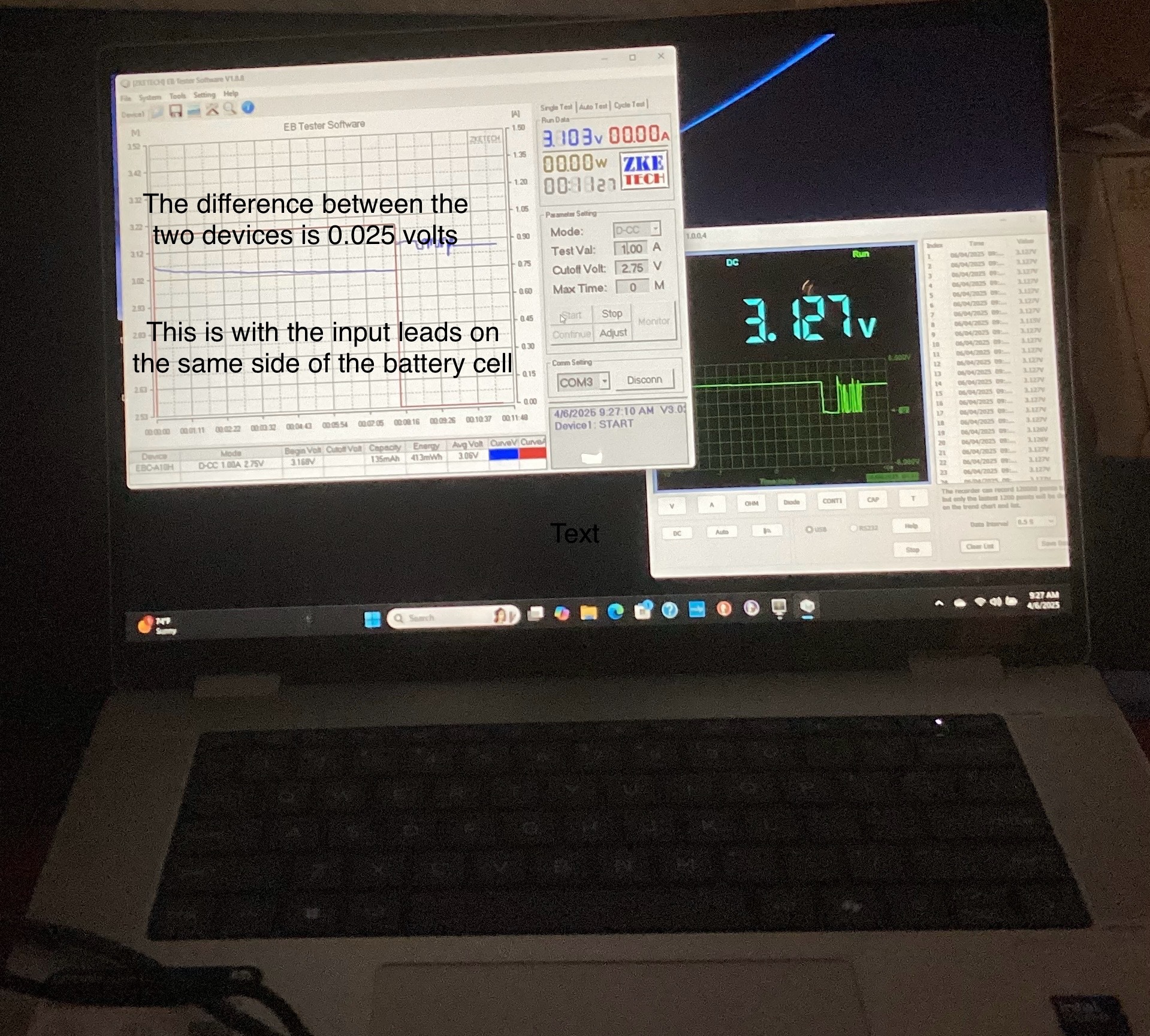

                      Here what I was hoping to do with this laptop computer that I just bought to be able to test BMS functionality in real time
                      In the picture below you can see both devices running at the same time one note about this setup you have to start the multi meter logging device first then start the battery testing machine and see the voltage difference there is a difference of N/A volts at this time see the reason below
                      The difference between the battery testing machine and multi meter using the same reference is 0.020 ?
                      The difference between the battery testing machine and the multi meter is not being tested is 0.010 ?
                      The difference between the battery being charged at 500 milliamperes rate I will have to test it at one amp is a difference of 0.050
                      Because now the battery cell voltage is nearly high enough to stop the charging cycle
                      So there is a difference between them but I am not sure how to calculate it because when it not being tested by discharge load versus when it is being tested do just subtract the amount that was when the battery testing machine is idle and use this offset value for my calculations for determining whether or not the BMS protection board is functioning properly or not which is my guess on this question
                      But for practical reasons I think that the results are basically the same so there is some difference but it is under 0.10 so I am thinking that I might not need to be concerned about the small difference between but when testing BMS protection modules it might be an important test to run and I can not run the battery testing machine with voltage input sensing wires and the current output side of the BMS protection board
                      If anyone thinks that my thought are not correct please feel free to chime in with reason why this is not practical way to look at this issue
                        • 31304
                        reading current at low voltage is VERY difficult.
                        any shunt will have a huge effect on the voltage so you really need to use hall-effect sensing.
