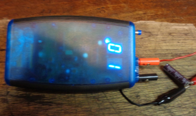

        Dear Joe:
        --I use a kit built and modified Bob Parker blue. Mine is modified to accept standard 5mm Fluke Type test leads. I am also able to connect an SMD tweezer which can be helpful at times. The Bob Parker Blue is very accurate as opposed to the $15 HK cheapie, which oddly enough is very accurate for capacitance.
        --Measuring ESR in circuit, as with measuring resistance in circuit, is sometimes determinative and sometimes not, on a case by case basis. See pics.
        Cheers!
