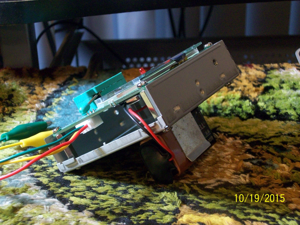

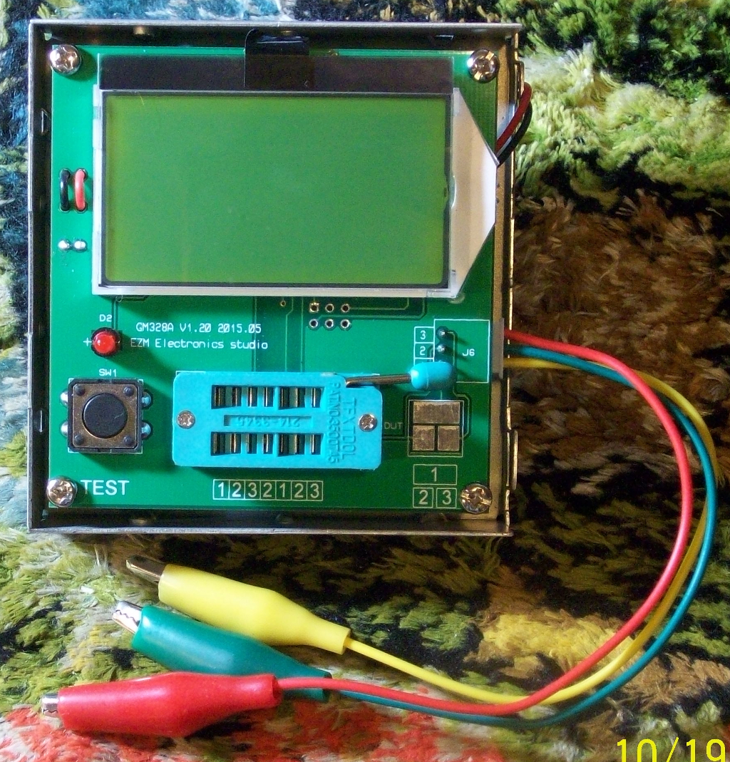

    I got my tester mounted in a metal half box that came from a dead TV that housed a G-Star decoder or some such thing. I put the battery clip on the back which props the tester up at a good angle.
      • 31304
      #62
      Re: Transitor/ESR tester dead
      that's a nice fit.
      you should consider something to protect the display though - specially as the cable is exposed.

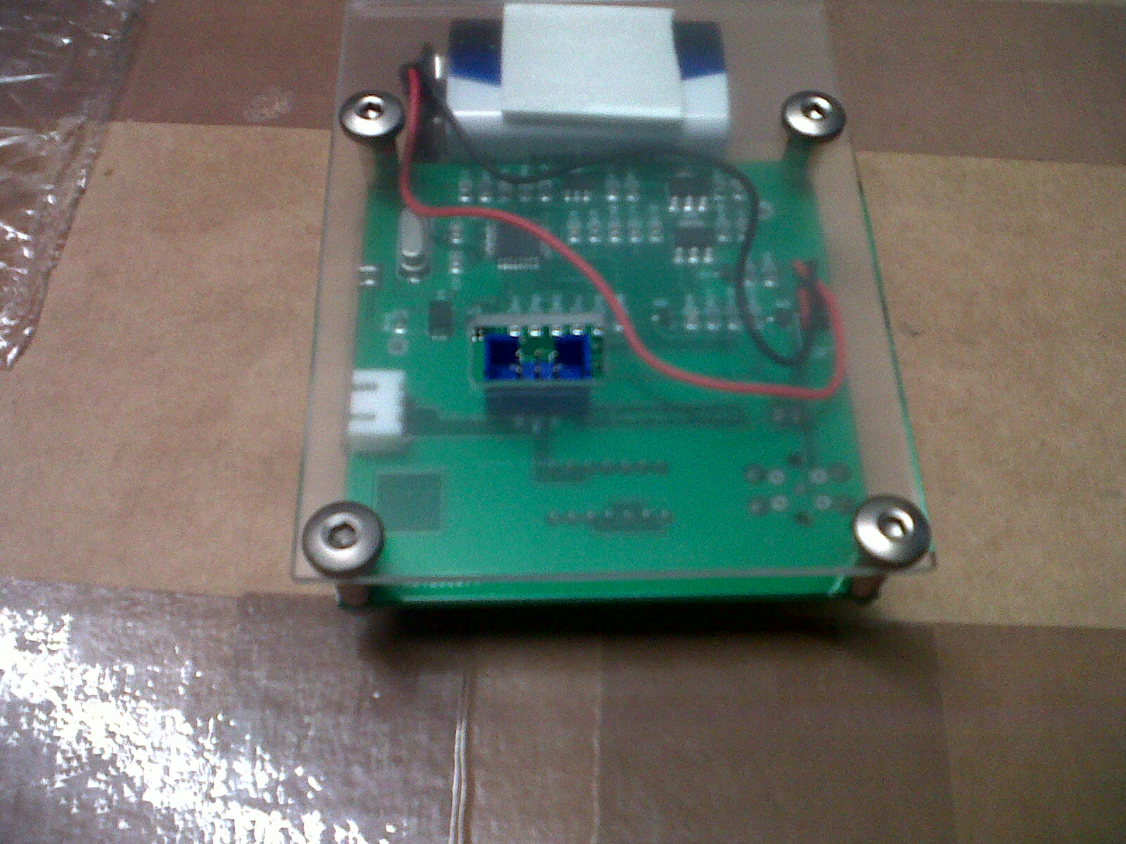

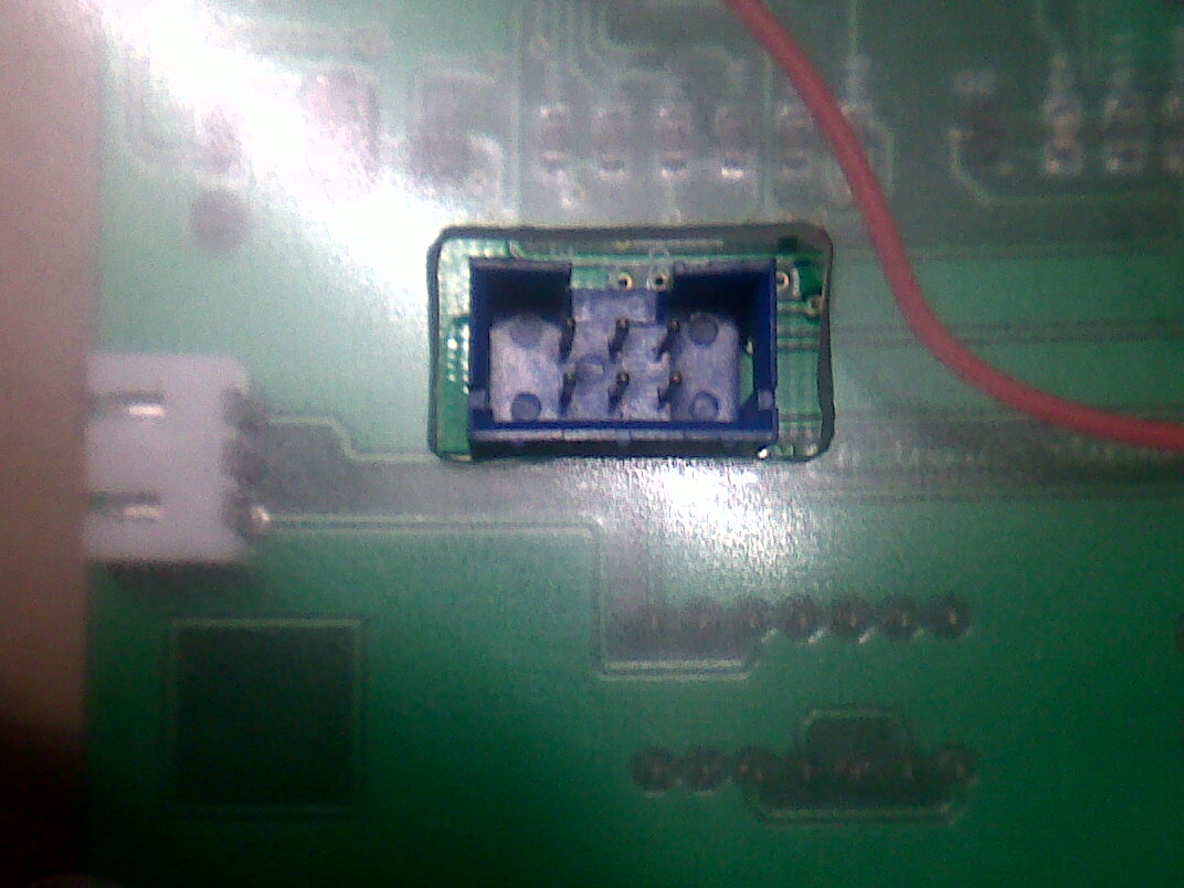

        #63
        decided to upstage your foto's with a couple of my programming connector.

          #64
          That's very good.
          Yeah, I'm not completely satisfied with my box yet either, but it's ok for now. I wasn't planning on using a metal box, I just happened to find it in a junk box and it's the right size. I know the disp cable is exposed, the tape over it is already starting to peel off just from what little handling it's had.

              #66
              Will this ISP programmer work?
              http://www.aliexpress.com/item/USB-I...rchweb201560_9
                • 31304
                #67
                that's exactly the right programmer.
                my rotary got delivered to a friends place, i wont be able to get it till later this week.
                i get parcels sent to a friend because he's always in to answer the door - it has it's bad points when i want something fast!
                about the programmer,
                you need to build of buy a 10pin to 6pin adapter.
                i built one with a 10pin socket from an old pc serial port and a 2x5 connector from an old pc case usb board.
                  • 31304
                  #68
                  programmer software is here:
                  http://www.fischl.de/usbasp/
                  driver:
                  http://www.fischl.de/usbasp/usbasp-w...2011-05-28.zip
                  programmer soft:
                  http://download.savannah.gnu.org/rel....1-mingw32.zip
