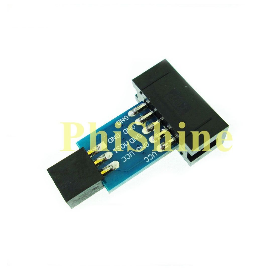

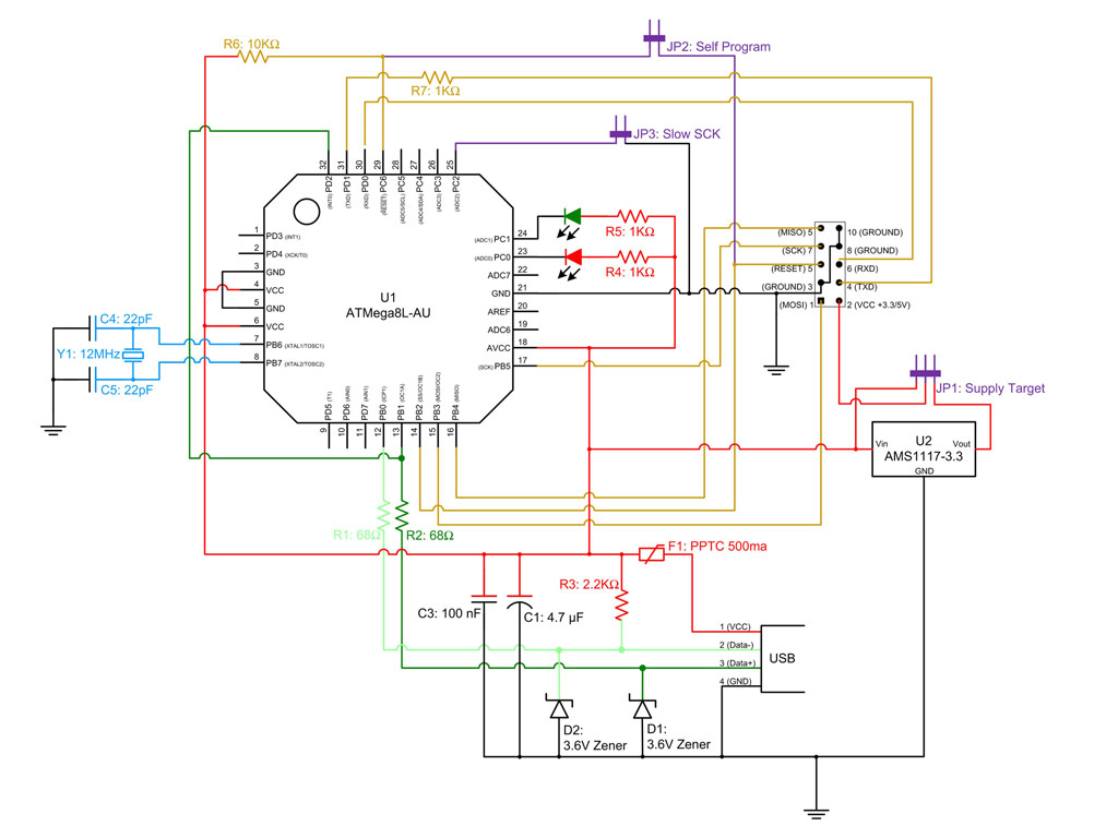

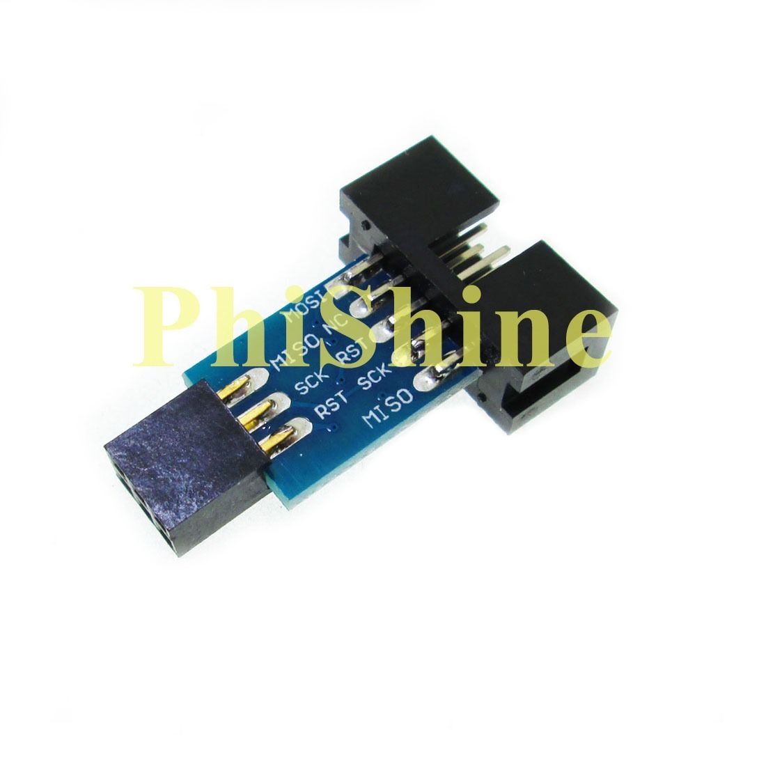

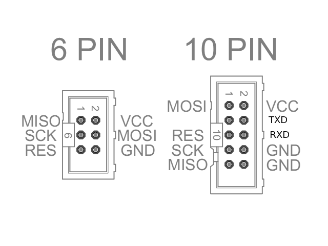

                  STJ: Do you have wiring diag of the 10 - 6 pin adapter?
                    • 31192
                    #89
                    Re: Transitor/ESR tester dead
                    yes
                    attached:
                    the common programmer,
                    the standard header pinouts,
                    and pics of an adapter from ebay - that i dont own btw, just saved the pics.
                      • 31192
                      #90
                      btw, put something over the display before you solder a header on, so you dont get flux on the panel!
                      • SteveNielsen
                        Retired Tech
                        • Jun 2012
                        • 2327
                        #91
                        Ok. Will do. Finally ordered the rotary and programmer. I'll scrounge up stuff for the connections. Thanks.
