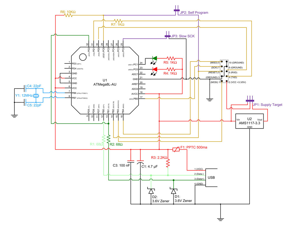

          • 31304
          #44
          Re: Transitor/ESR tester dead
          used in conjunction wih this:
          http://www.fischl.de/usbasp/
          supplied dirt cheap and improved by our friends.
          http://www.ebay.co.uk/itm/261574745774
          i actually built one on stripboard before i noticed them on ebay, it cost me about 5 times the price to build!
          here is the schem of the superior chinese one!

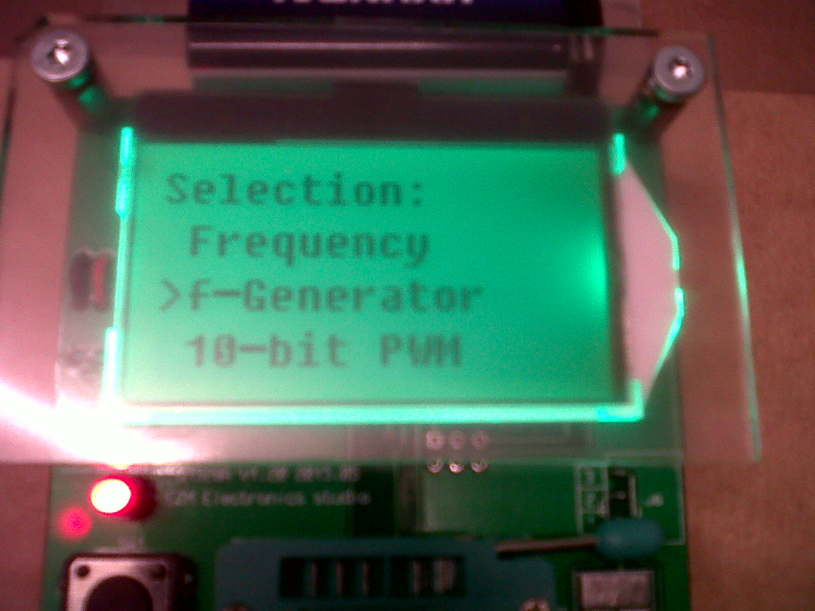

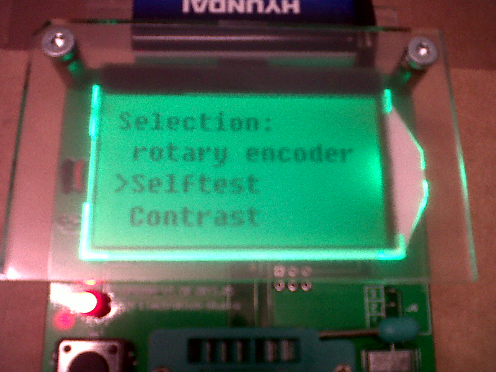

                    • 31304
                    #49
                    the leads are included, just not the clips on the end.
                    because mine is here!!!!
                    and i made some nice protection for it from a fucked lcd panel & some threaded spacers - pictures later!
                    btw, the firmware has the extra stuff compiled in it, if you hold the button down you get a menu.
                    then you can activate the frequency generator or pwm generator!
                    i tested the frequency generator with my multimeter that goes upto 10Mhz and the output was accurate

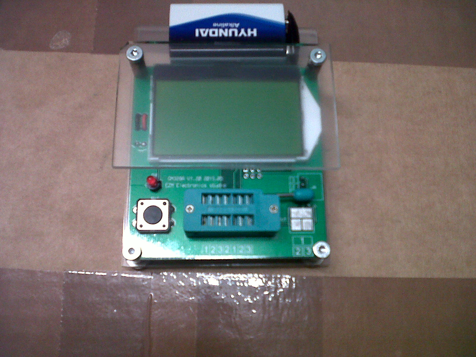

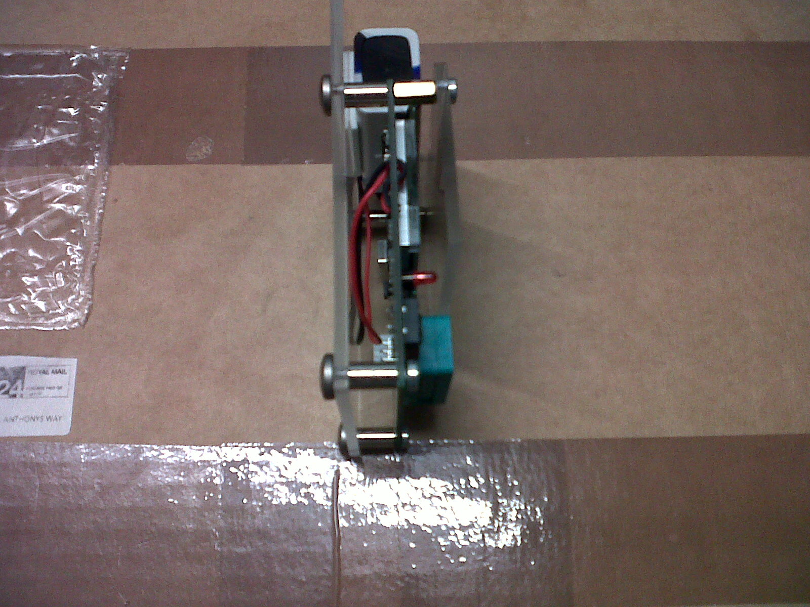

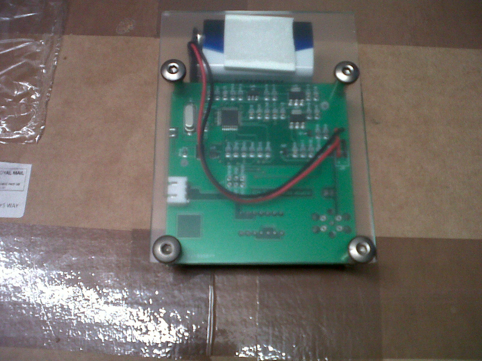

                      • 31304
                      #50
                      some pics with my acrylic shield.
                      i made an error in taping the battery down,
                      i'm going to get one of these for it.
                      http://www.rapidonline.com/Electrica...-Leads-18-0163
