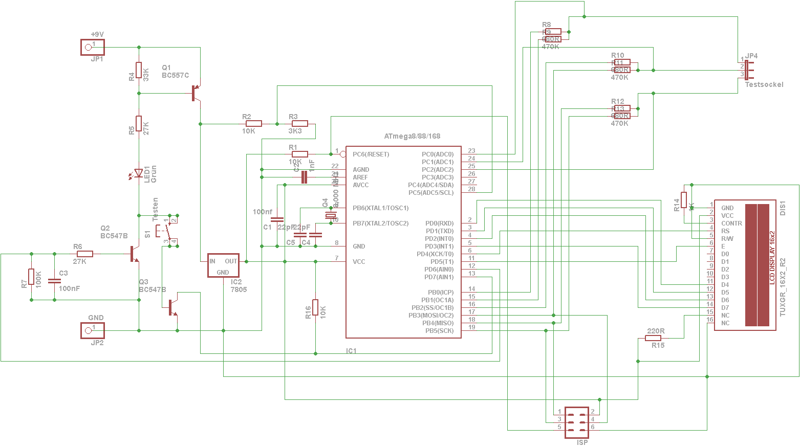

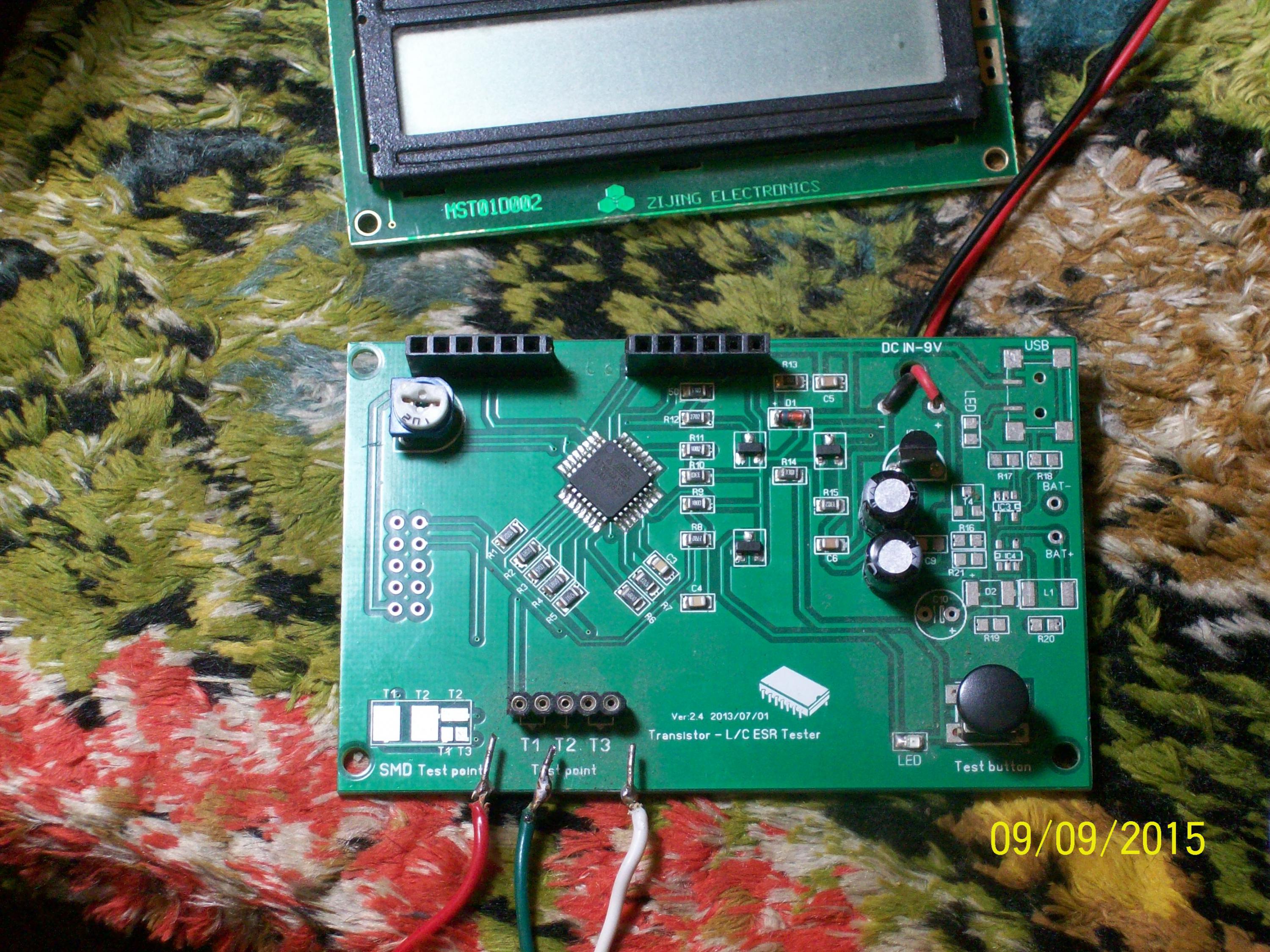

    post a foto of the parts-side so i can see the design.
    it may just be a voltage regulator.
    btw, i just ordered this model.
    i chose it because it has a 3pin connector and flyleads.
    http://www.ebay.co.uk/itm/181861030068

    see if that regulator near the battery wires has 9v going in and 5v coming out.
    btw.
    Originally posted by SteveNielsen
    Nope, input on the reg is only 2.4v, output is about 1v.

    Originally posted by stj
    i think your dead tester is just a transistor.
    look at the pdf i linked - page11

    Stj page 11 appears to show a mod for the board but not what's there on my board. If I'm mistaken let me know. If you meant the basic schematic then what transistor are you referring to?

    hi i have the same tester here any measurements you need just ask on the regulator i have 9.37 in 4.99 out im running off a 9volt battery is your dc power supply still giving the correct output voltage you have probably already checked this though.

      Re: Transitor/ESR tester dead
      battery power goes through the transistor top-right.
      it's similar to the schematic but the diode is missing.

          The schematic is in the PDF file.
          Stj, you mean the transistor to the left of the regulator?
            • 31277
            yes, just follow the track from the red wire.
            you could run a fine wire from the red cable to the input on the regulator for a quick test.

              Thank Steve. So you have a plug in "worts" if I spelled that right and a 9 volt battery. I imagine when its plug in it disconnects the battery. What are the symptoms? Does it not have a test button?

                this is probably it.
                • keeney123
                  Lauren
                  • Sep 2014
                  • 2536
                  So pin7 and pin1 of the big chip should be at +5 volt. ISP pin5 is also connected.
                    • 31277
                    the regulator should have 5v coming out - start with that!

                      • SteveNielsen
                        Retired Tech
                        • Jun 2012
                        • 2327
                        link the red battery wire to the regulator input and see if it turns on when you connect the battery.
                        Just did it except I've got no battery, using a regulated PSU. Nope, it does not come on. Nothing at the output of the regulator IC, which in circuit measures a short between Out and Gnd. I'll pull the reg test it and check the ckt for a short.
                          if your testing ic2 on 2k setting i get .772 ohms between ground and out
                          • SteveNielsen
                            Retired Tech
                            • Jun 2012
                            • 2327
                            This 78L05 reg (IC2 on my board) reads 3.2K ohms between Gnd and Out leads. It's not shorted. I've got a 2 ohm short downstream on the board.
                              • 31277
                              with or without the display fitted?
                              • SteveNielsen
                                Retired Tech
                                • Jun 2012
                                • 2327
                                Without display connected.
                                  • 31277
                                  got hot air?
                                  • SteveNielsen
                                    Retired Tech
                                    • Jun 2012
                                    • 2327
                                    I've got a dangerous heat gun.
                                      • 31277
                                      lift the atmel chip & re-check the short.
                                      btw, what part number is it?
                                      • SteveNielsen
                                        Retired Tech
                                        • Jun 2012
                                        • 2327
                                        ATMEGA168V 10AU 0812
                                        I can try to lift the chip but I'm afraid of getting everything else too hot with this heat gun, no nozzles to focus the hot air.
                                        I'll try making an aluminium shield over the board.
