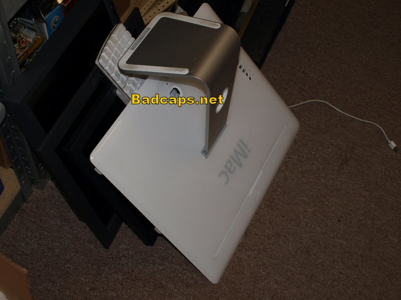

This is phase 1 of a little series I'm trying on a few of these with different brands and values of polymers. I won't reveal the others until I try them out, but this mod was successful with the values used. This is the 10-dollar thrift store 20" Imac from THIS THREAD.

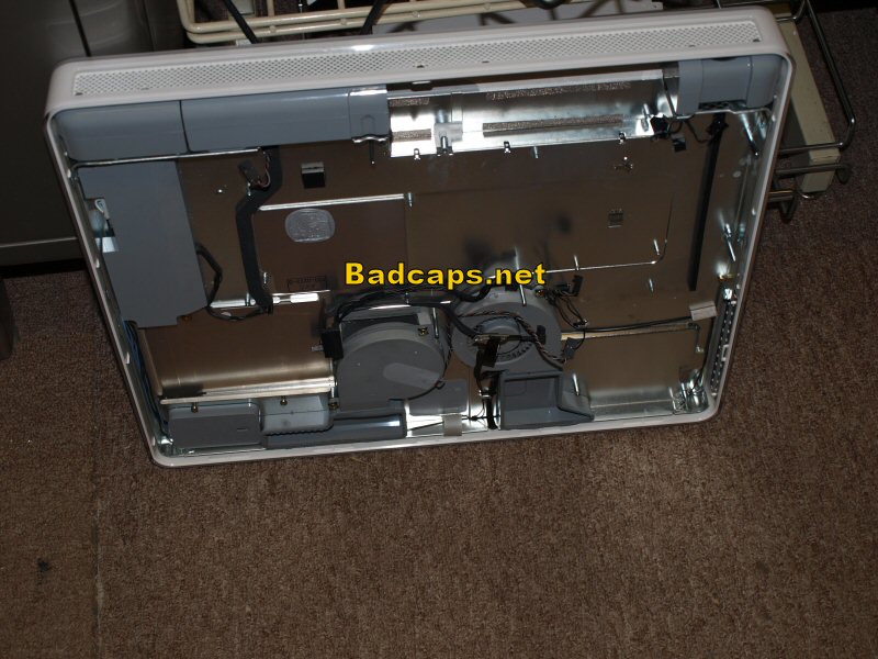

When I pre-tested this machine, it would power up, give me the 'chime', but would not display any video. The hard drive was missing from it as well. The machine specs are 2GHz processor, 2gb ram.

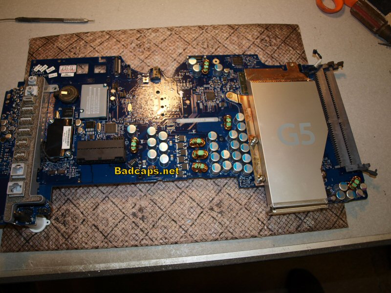

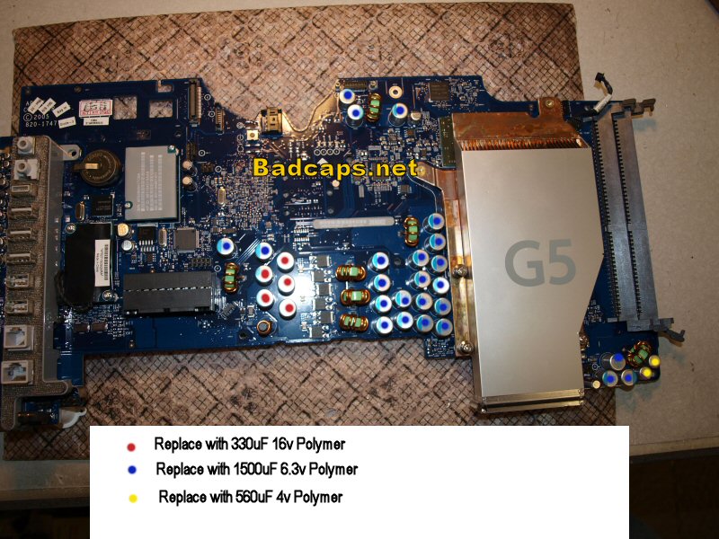

Here's the changes I made with the polymers, as to what I put in place of what, and where:

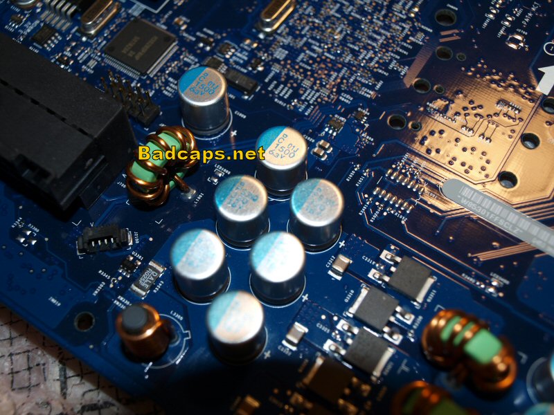

Here's just some pics showing the polies and my fantastic recapping job....I also recapped the PSU, even though it was a newer Delta build, the original caps were ok.....I figured what the hell, I'm in here....
Bird's eye view:

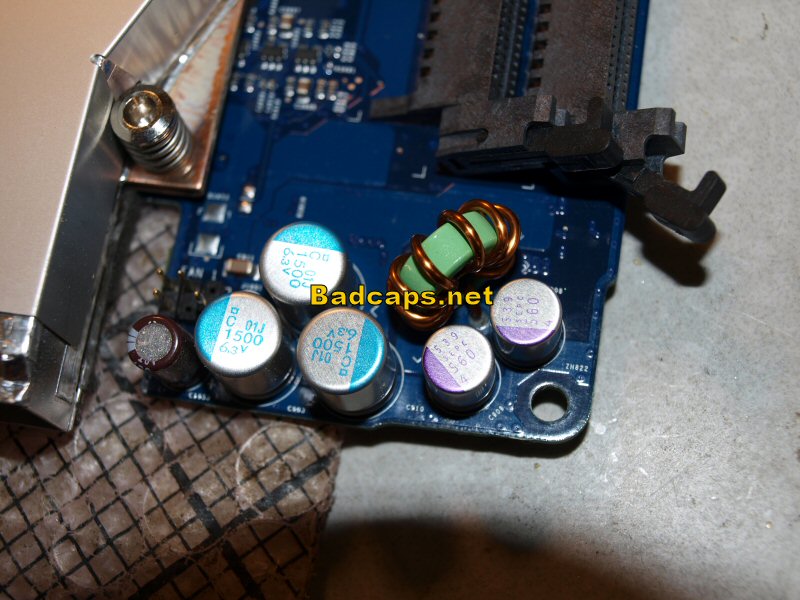

Caps in the corner by the RAM slots:
CPU Cluster:

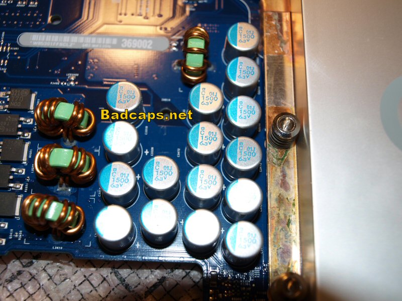

VRM Inputs:
Graphics:
Going back together:

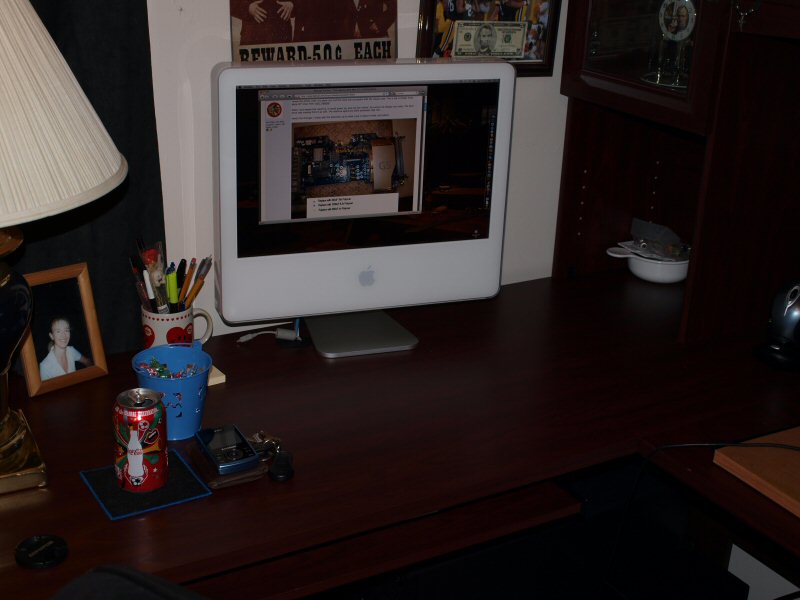

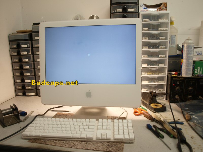

...and it POST's:
It's looking for the OS, which obviously isn't there......no HDD. I have no more spare SATA HDD's, I'll have to grab one and throw OSX on it to fully test it. So far, looks like a success! These ever-so-popular systems seem well worth the polymodding effort, I see a lot of them for repair. Based on the results of these experiments, I will soon offer a full polymer cap kit for these systems.
