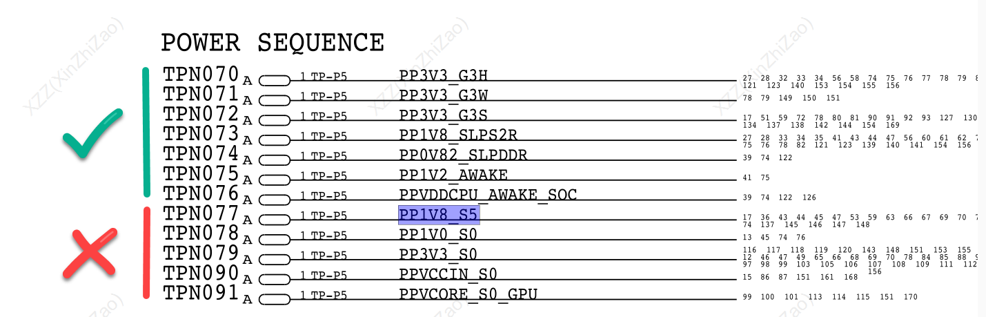

        Hi. Ditto on the same model in for repair. Were you able to make any progress?

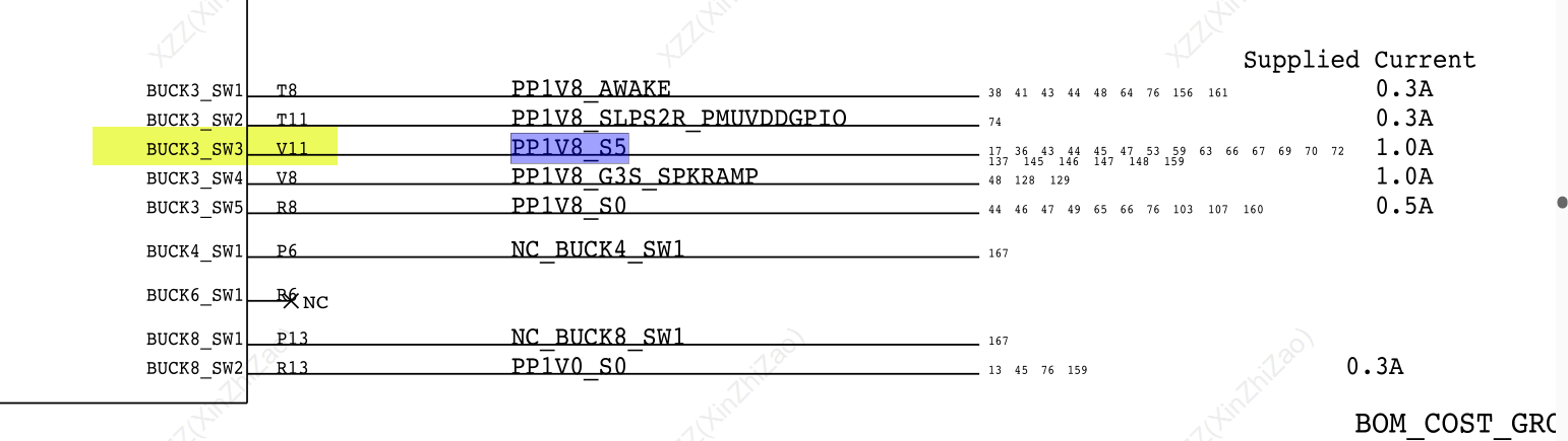

        For our case, the power sequence stops @ PP1V8_S5. This unit will end up in the landfill if we cannot fix it. May try to do a bypass for this PP1V8_S5 rail.
        The PP1V8_S5 appears to be supplied by BUCK3_SW (PMIC @ U7800). Has anyone attempted to replace this part with success?
        Where is the enable for this rail? Is it internal? Can any similar PMIC be used for the replacement?
        BTW - the switching leg of this regulator IS WORKING @ PP1V8_SLPS2R (BUCK3_LX0).
        PP1V8_S5 is not shorted but has 0 volts. This rail powers the flash IC and many other parts onboard.
        Can enter DFU using a remote macbook with proven USB cables running Sonoma but repeated attempts result in Error 9. According to a find on the internet by 'Barry', the DFU issue with Error 9 is a software fault.
        Unable to REVIVE / RESTORE this logic board. Did see a small fan spin during the DFU process.
        Welcome all feedback.
        Click image for larger version  Name:	buck3_SW3.png Views:	0 Size:	95.2 KB ID:	3315983
        Click image for larger version  Name:	power_sequence.png Views:	0 Size:	160.7 KB ID:	3315977

              Came across this power sequence charge for the CALPE PMIC which should help:
              https://logi.wiki/images/8/86/820-01...r_Sequence.pdf
              Will continue to review. Issue may be corrupt T2 firmware which is required for a proper DFU. The T2 controller communicates with the PMIC to enable the missing power rails (PP1V8_S5). This is a catch-22.
