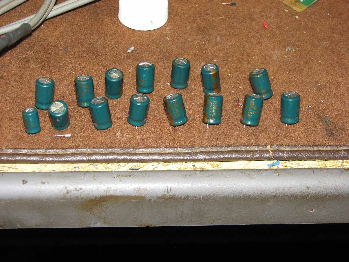

            #1625
            stj:
            >btw, keep an eye on the motherboard caps around the cpu - they are famous for bursting.
            >i did a full recap using NCC around the cpu and replaced *every* small cap with tantalum!!
            14 of 15 of the bigger caps were bulging on the mb on mine so I replaced 'em all with the tallest caps (of the same capacity) that would fit - every one of 'em was a pain to get the holes cleared on, too, requiring soldering iron and stainless steel pick. I was very glad that it started right up after that ordeal. I'll try to attach a pic of the caps...

              Originally posted by xelectech
              stj:
              Using high heat is normal for removing motherboard caps and a stainless steel needle tool/pic for clearing holes. There's a lot of metal in multilayer boards, especially where there is a wide common copper trace the caps are solder to.

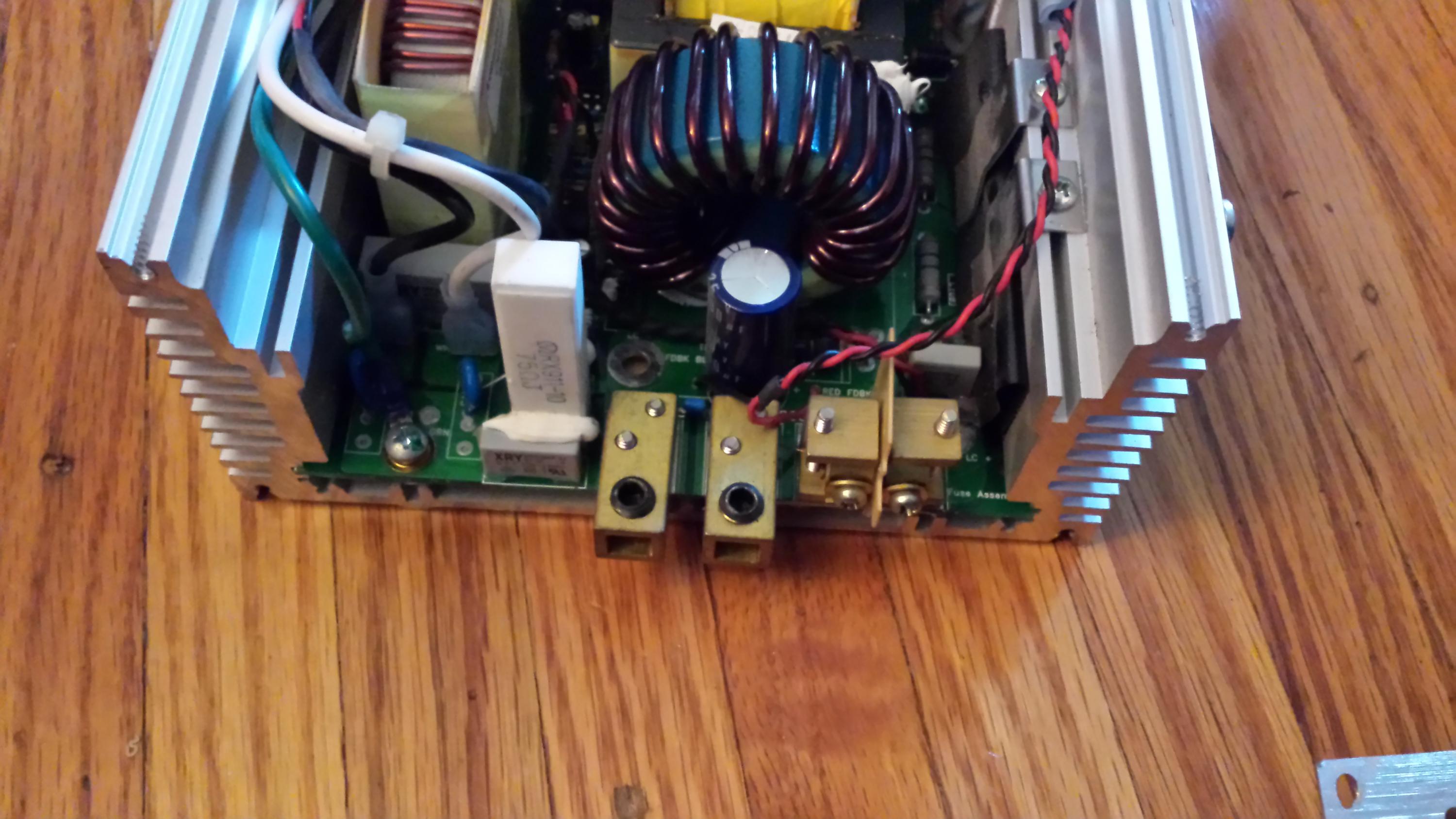

                          Scored a Beefy looking 60A RV battery charger for $5. It had a smashed front (broken ATC fuses) and no top cover, other than a bodge on the AC input side (extra resistors piggy backed) it's in good shape otherwise. All name brand components (UCC 'lytics, etc.), and almost looks to have been conformally coated. No model number though (must have been on the missing lid?).
                          I'll post pics in a bit... I wonder if it could be used as a car battery charger?

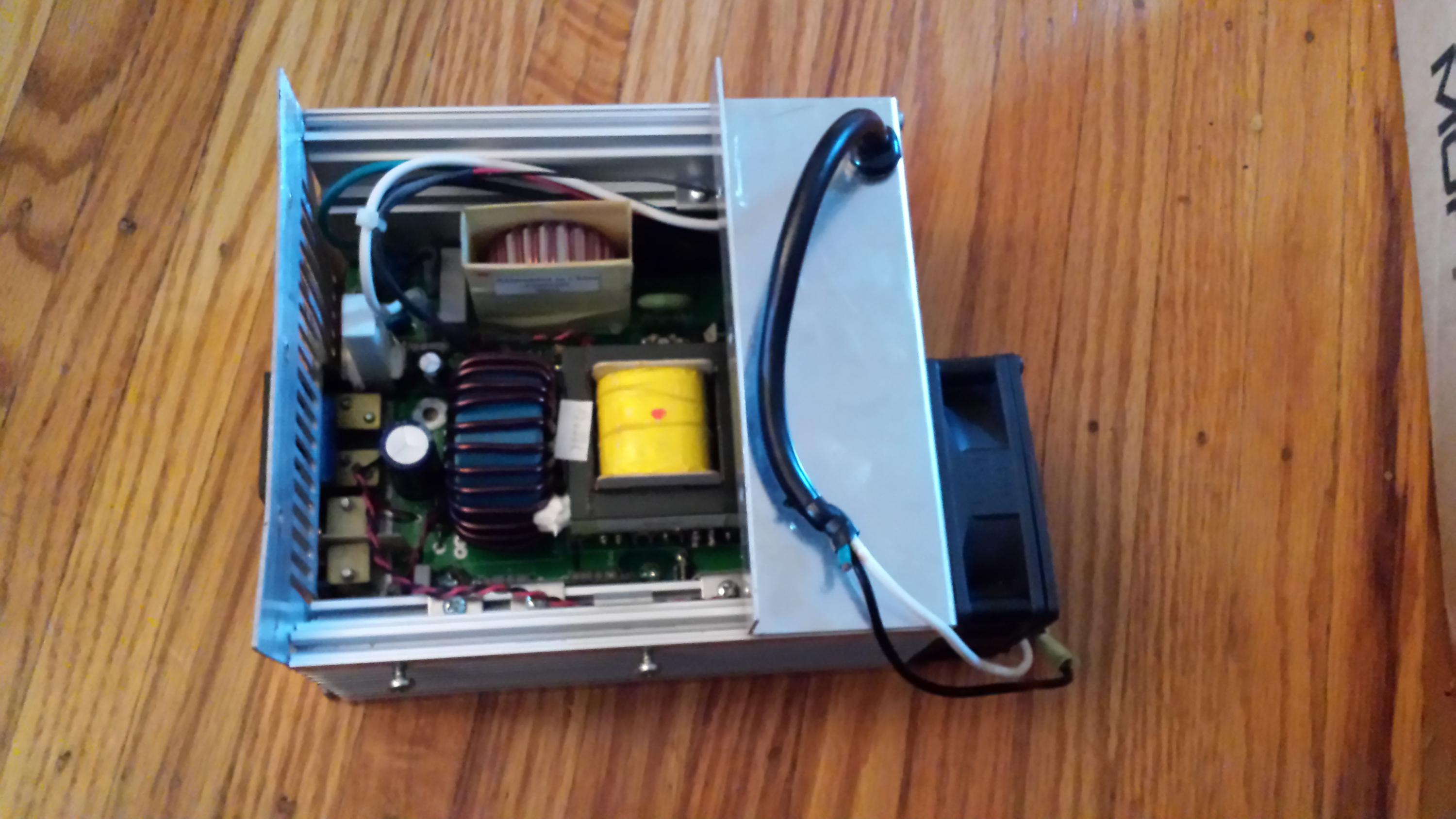

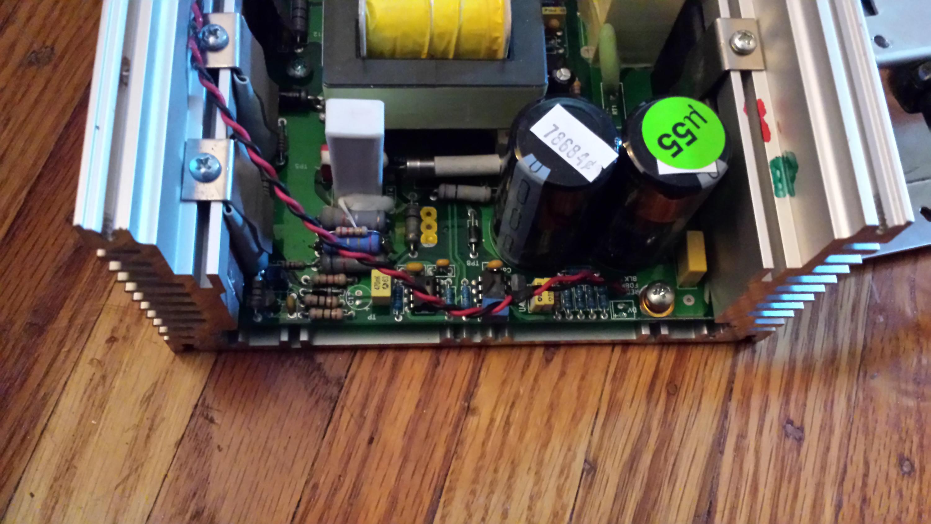

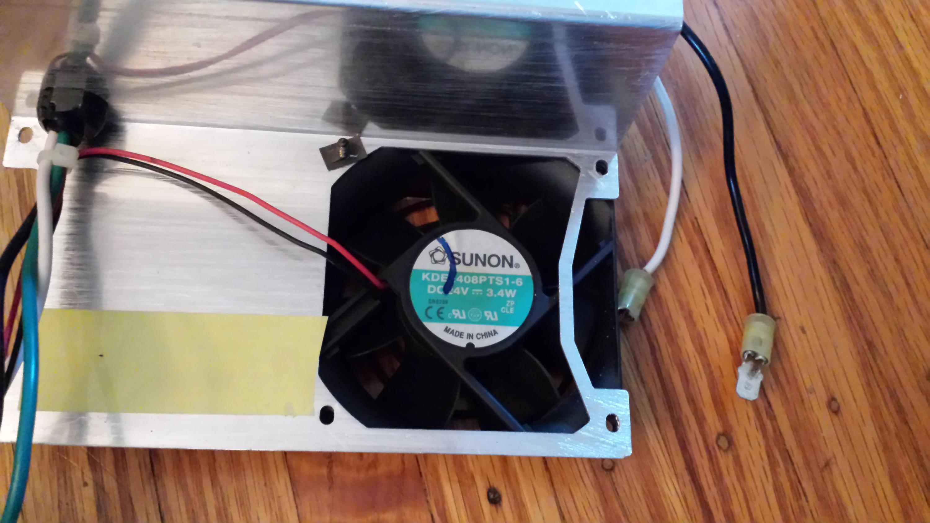

                              • 17136
                              #1634
                              Here we go:
                              The end w/o fan was missing the screws too.
                              The 12V end is pretty beefy:
                              I've removed the two 30A fuses, as one was smashed. those are pretty beefy lugs, looks like 6 gauge wire might even fit
                              The other end reveals a bodge (factory?) and a cut wire (2nd red wire on the 12V feedback pair, that's what the twisted red/black wires are) Why there was a 2nd positive feedback wire is beyond me, maybe for a gauge? It also looks like there may have been soldered wires at a now empty footprint too.
                              Last, it has a good quality sunon fan:
                              I wonder if this can be (safely) used as a car battery charger? If not, it's a hella beefy 12V (well, 13.5V) source... ?

                                SteveNielsen:
                                >Using high heat is normal for removing motherboard caps and a stainless steel needle >tool/pic for clearing holes. There's a lot of metal in multilayer boards, especially where >there is a wide common copper trace the caps are solder to.
                                It's just the first time I encountered having to treat *every* thru hole like that - but I've not attempted/repaired but a few, guess I really should get a heavier iron than the 30 watt Weller I've been using since 1981 &-)

                                    sure.rv= deep cycle lead acid.
                                    car battery same.
                                    i have a hobart pallet jack charger in the shed i use for super fast charging.3 stage all automatic.yours likely is too.
                                      • 31185
                                      #1638
                                      just as long as it's outdoors, fastcharging will make the battery gas-out and fill the area with hydrogen and oxygen.
