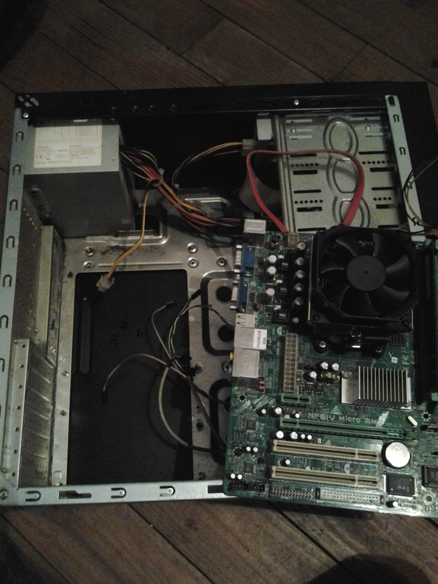

                        #1451
                        Re: Your Best Dumpster Finds
                        Saw this pc case outside, all smashed up on the front side. I thought someone had ripped everything out of it. But I was wrong.

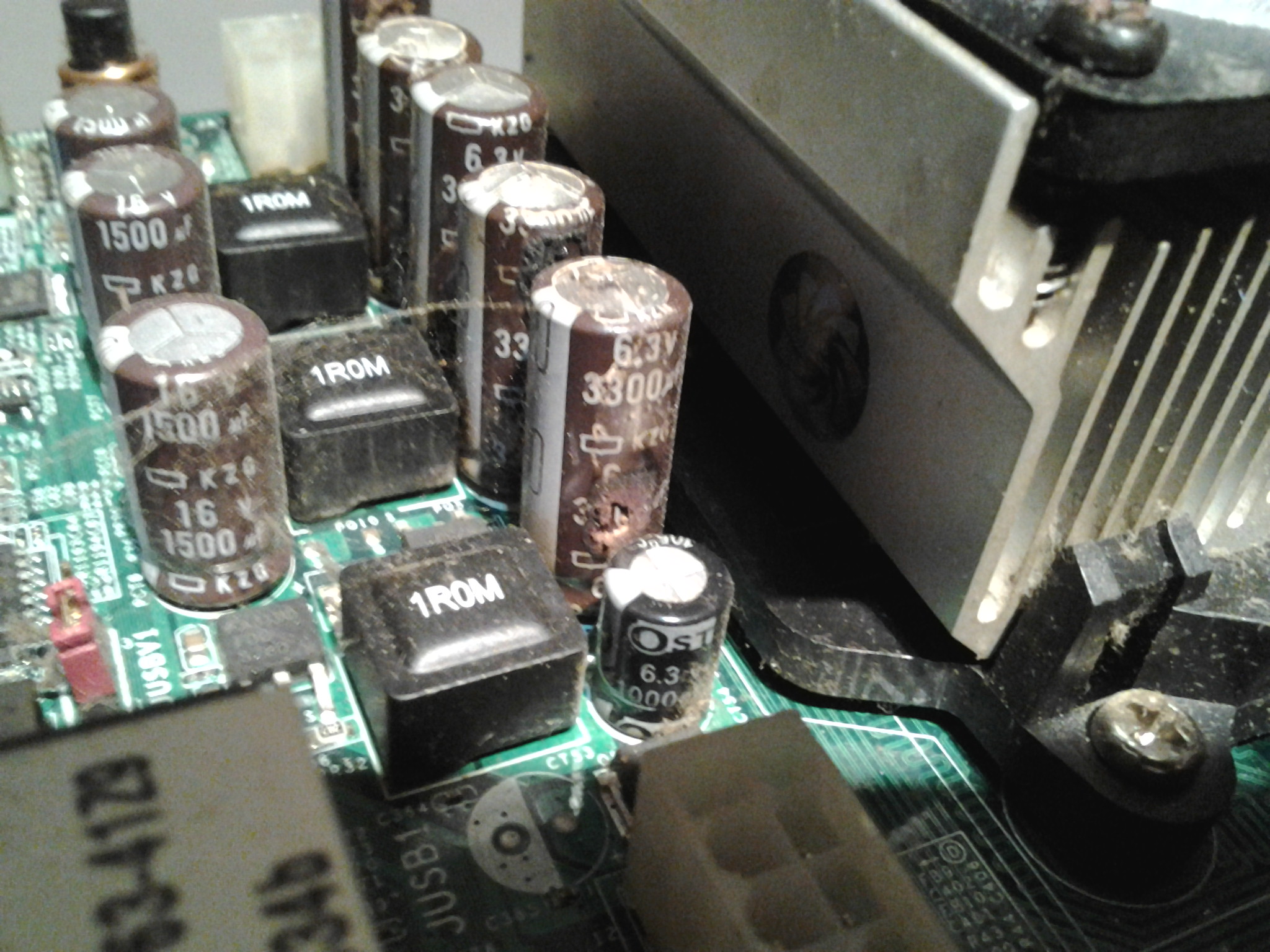

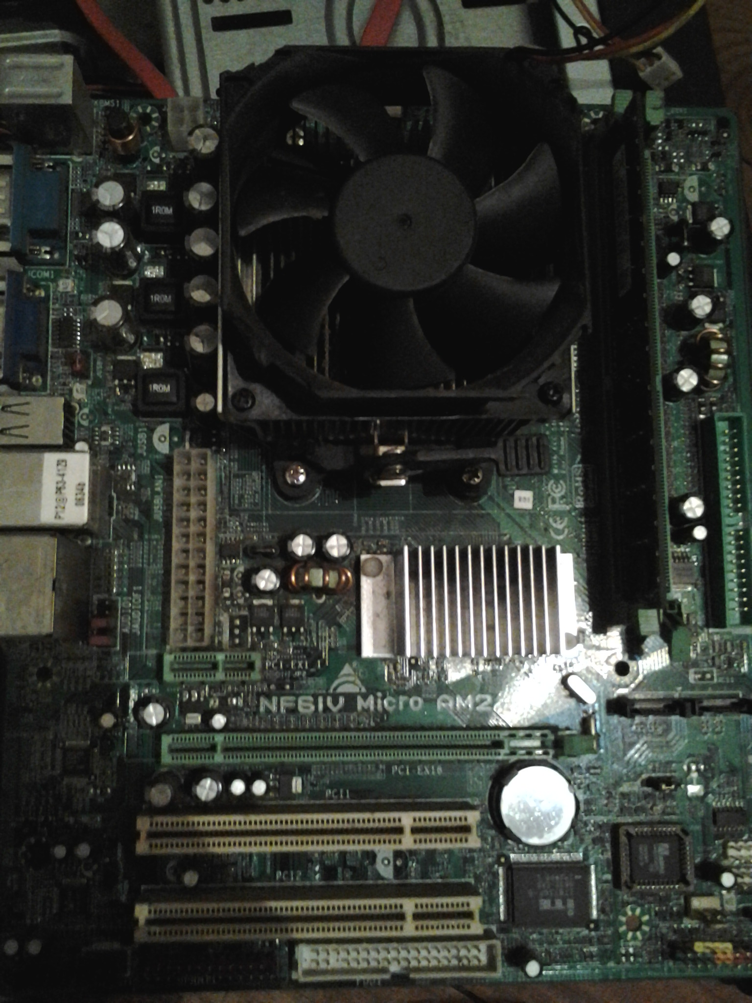

                        Took a sneak peak from behind and there is a PSU and mobo present so I took it home. Opened up the panel, and I was surprised, nothings missing!
                        Fired her up. fans are spinning but no display.
                        Upon further inspection the mobo had some bad caps. KZG 6.3V 3300uF replaced them and now she works.
                        Spec:
                        Cpu - AM2 Athlon64 3000+
                        RAM - 1GB
                        HDD - Hitachi 160GB 3.0Gb/s
                        MB - Biostar NF61V Micro AM2
                        DVD/RW - Philips
                        Surprised to find the HDD inside.
