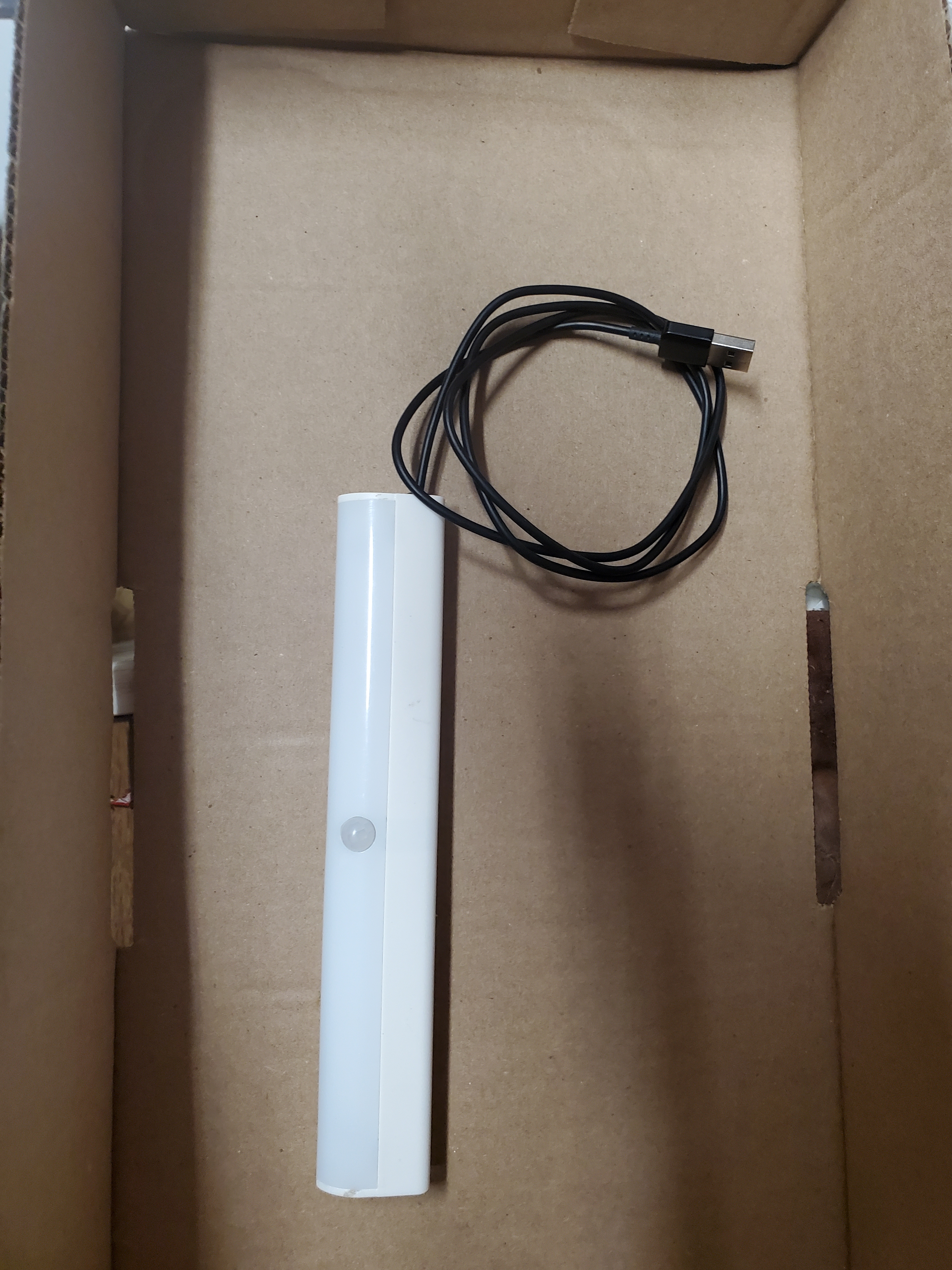

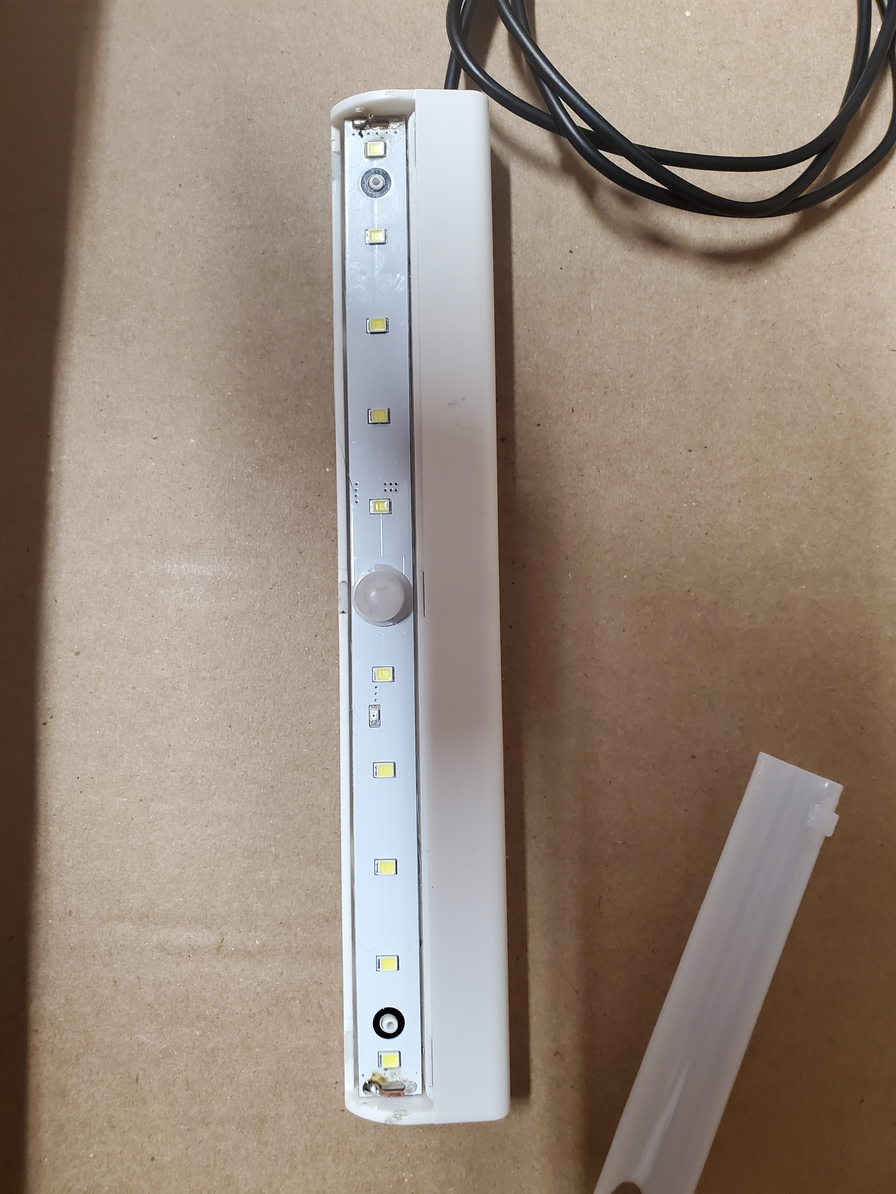

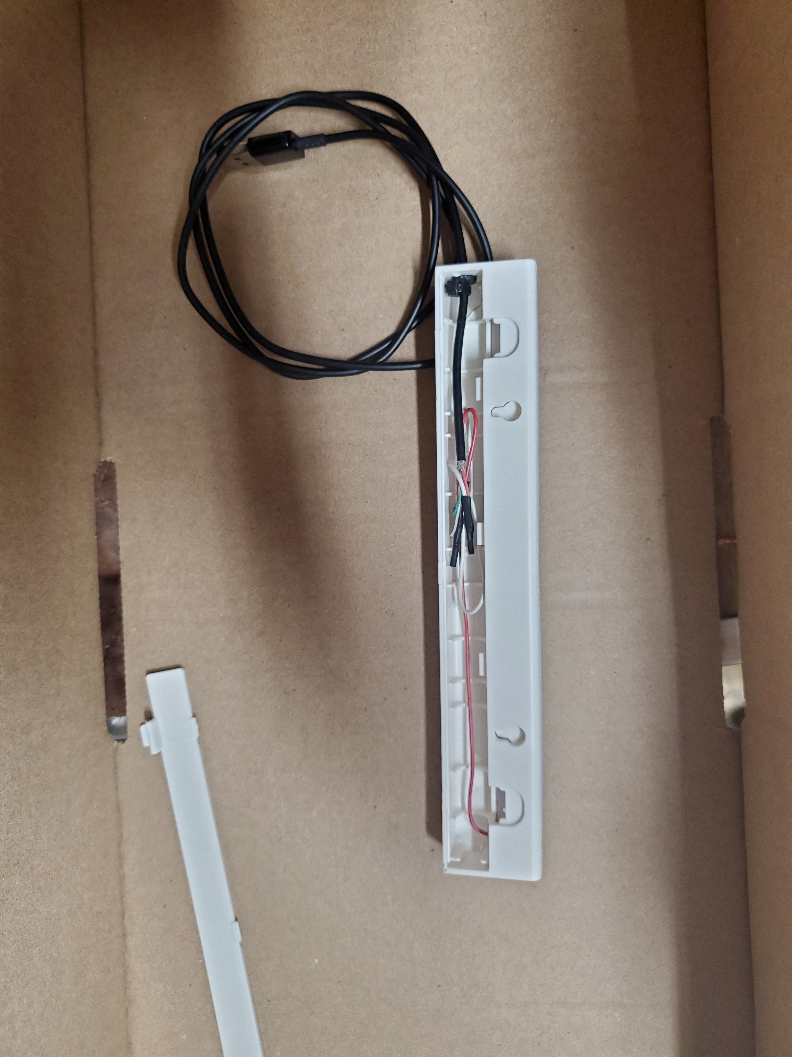

    lets ignore the fact that i thought the board fit both ways... and the wire color is reversed going to the board
    She also got rechargeable puck lights and complains about there battery life... they have 160 mAh batteries in them

      10 leds thats 43ma each . way over the top in my view .
        Probably but if I were doing this I probably would power the LED light bulb on a lower voltage so you would have lower current draw but not to low that your brightness would suffer and you would not be able see anything
        The one thing that I find with LED devices is that they have a tendency to over current the LED light bulb to the point that it drastically reduces the life of the LEDs or the quality of the LEDs are crap to begin with
          yes my view entirely . they run them maxed out . they get way too hot .

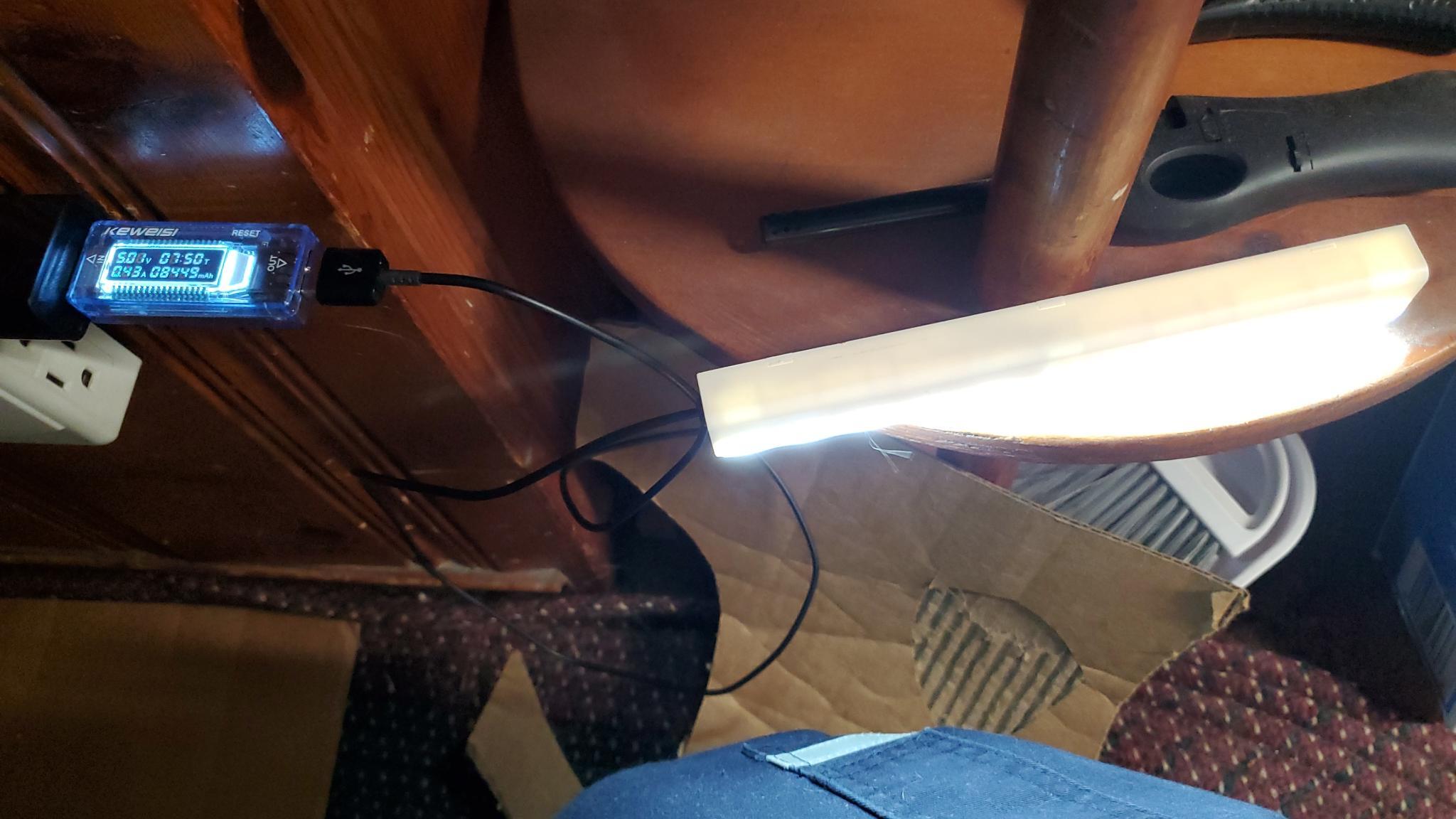

            stand by looks to be 0.50 mA, had to use my meter for that one the usb tool can't even close to that low (i think it bottoms out at 0.07A), that said my jank adapter under load only showed it pulling about 250 mA and my usb tool confirmed that, either my jank adapter or multimeter is limiting the current
