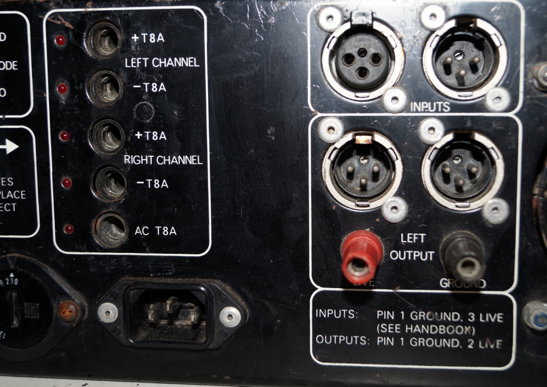

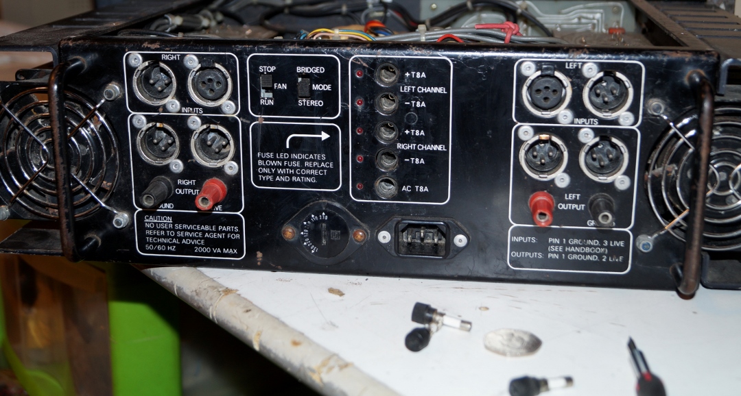

                                and a rough looking studiomaster mofset 1000 amp, cover is missing but it does power up. Has two huge capacitors in it, terrified if they just blew up.
                                Does anyone know what kind of connectors these are? XLR?
                                3Pin ones
                                  • 31287
                                  #1756
                                  those are XLR
                                  btw, cheap bastards using pop-rivets - not seen that before!

                                    Something like this suitable to pass audio from PC to amp?
                                    And to connect would be one xlr to the right input and 1 xlr to the left input.
                                    Why does it then have two xlr on the out put side?

                                        you should only need one to input the signal, it's a poor design.
                                        i would cross-wire those sockets so both sides have L+R on them.
                                        if you dont then you will need to connectors.
                                        the bay link looks good.

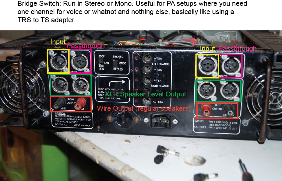

                                          Here's a quick diagram of connectors on that amp. Looks to be missing the fuses however, so you'll need those, caps and possibly springs.

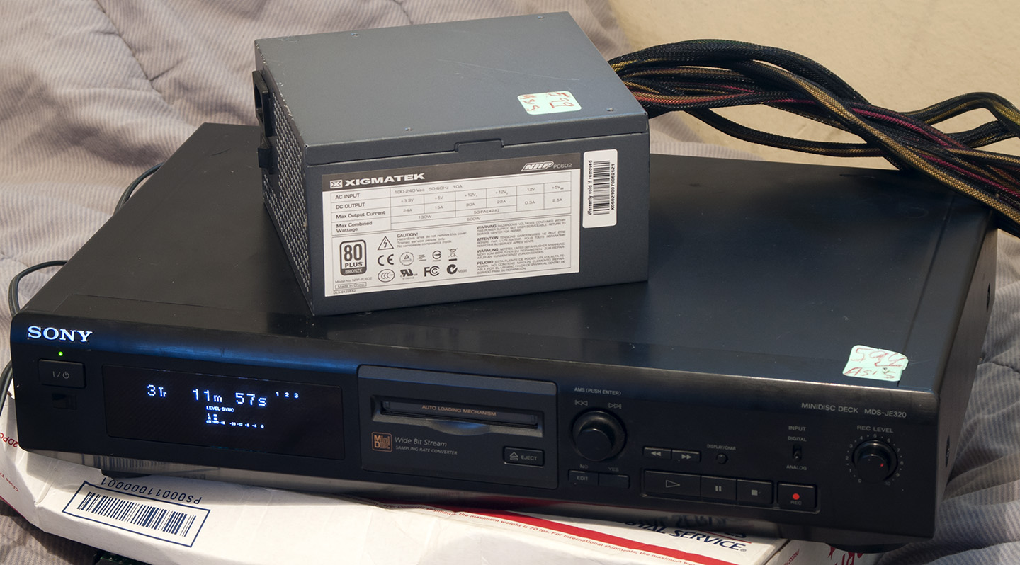

                                          As far as more cheap stuff, hit up a thrift store with a half off day yesterday and grabbed a Sony JE-320 and a Xigmatech NRP-PC602. Both work, surprisingly since they were only $3/ea.
