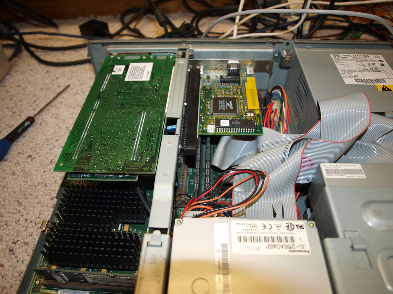

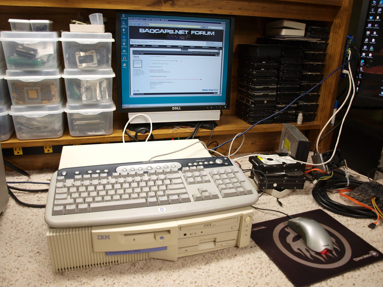

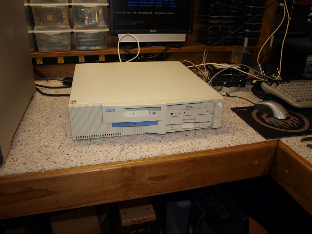

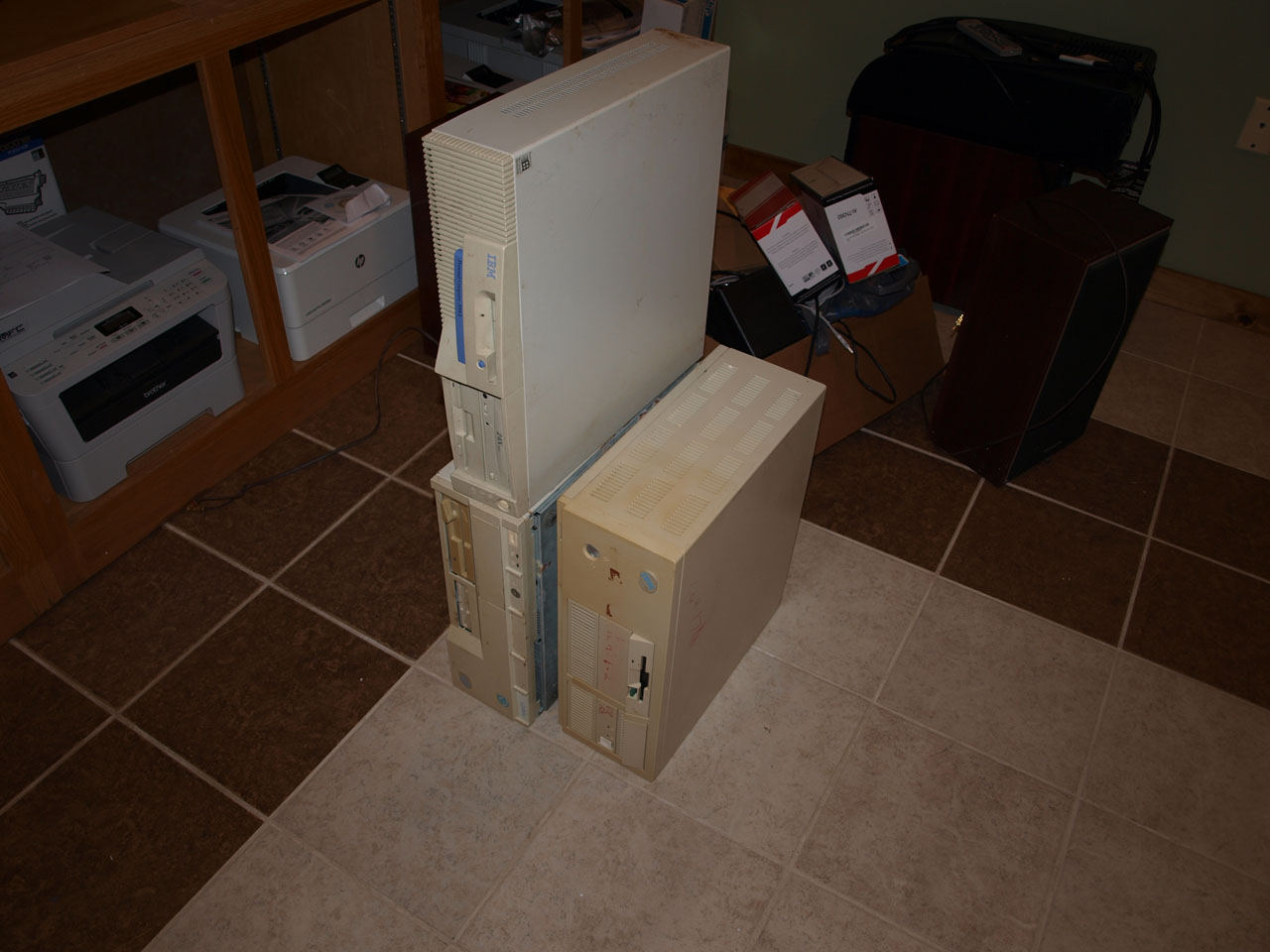

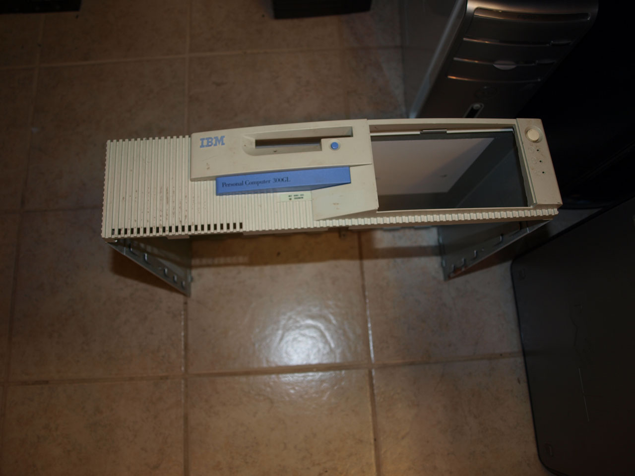

        Today's weird build arrived yesterday in a pile of old systems that were dropped off.... 3x 486's (2x IBM PS/2's and a custom built) and a pentium classic; IBM PC 300GL type 6282.
        Naturally, I started with the P-Classic IBM 300GL. It's sporting a Pentium166 & 128mb RAM; the max RAM it can take. The P-166 was an absolute workhorse of its era....definitely worthy of a little resto work.
        Filthy but in good physical condition.
        Cracked it open. Somoene upgraded the video from the useless 1mb onboard cirrus logic to a 8mb Matrox Millennium....big bucks for the time! It had a dialup modem as well....I yanked that and added the NIC (period-specific 1997 3com). The modem was tossed into the e-waste bin.
        Both the 1.44 3.5" floppy drive and the 2.5gb western digital HDD were bad. The 1.2mb 5.25 floppy is good. I replaced the 1.44mb and the failed HDD with a 6.4gb WD I had on hand....smallest HDD of the period I had that wasn't in use.
        I won't go into all the gory details....but it cleaned up nicely and functions as well as can be expected for as old as it is with a fresh install of NT4.

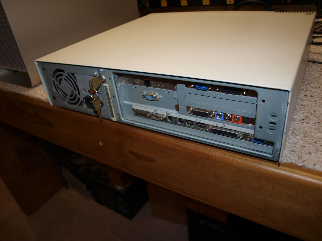

        Butt shot....as if by some miracle, I even got the case keys with it....a first for any IBM I've ever gotten.
        Web browsing on this is no treat....but BCN still displays on old junk!!
        That's all for today....chalk up a win for the retro fleet!

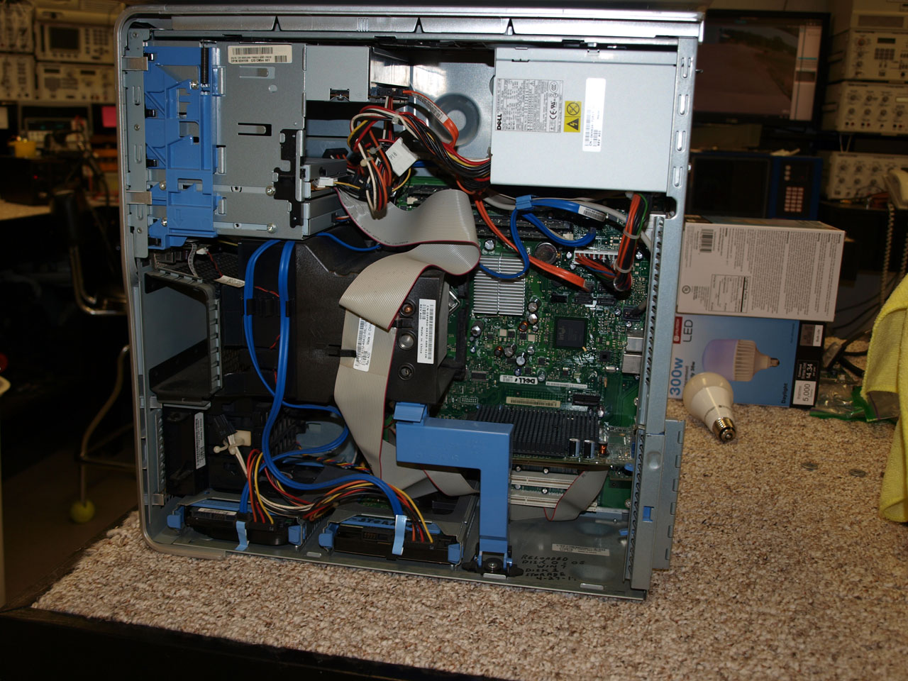

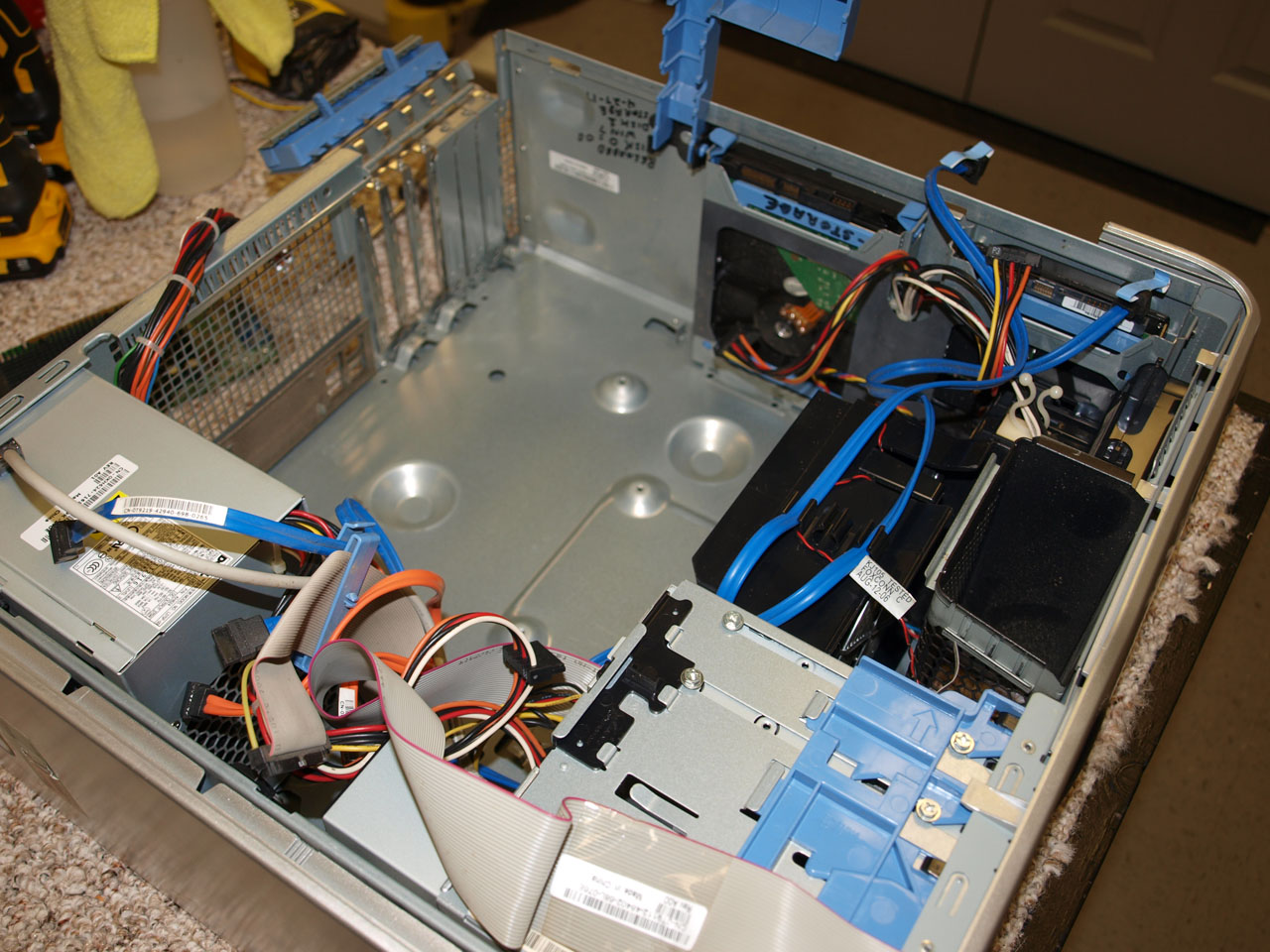

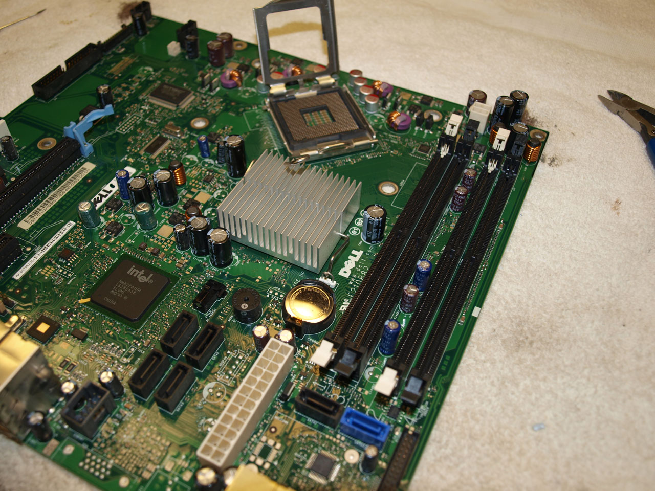

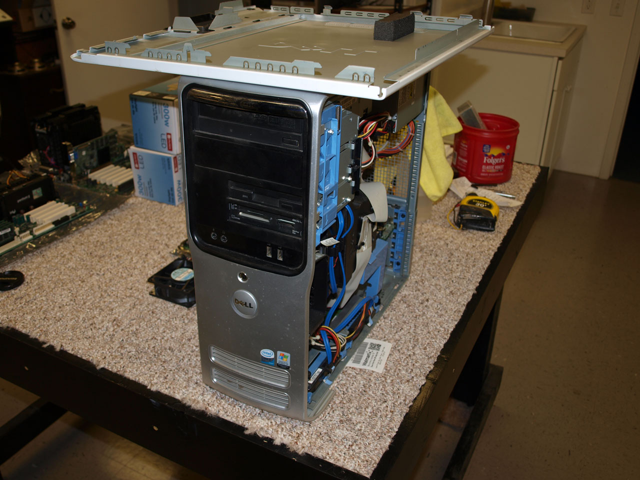

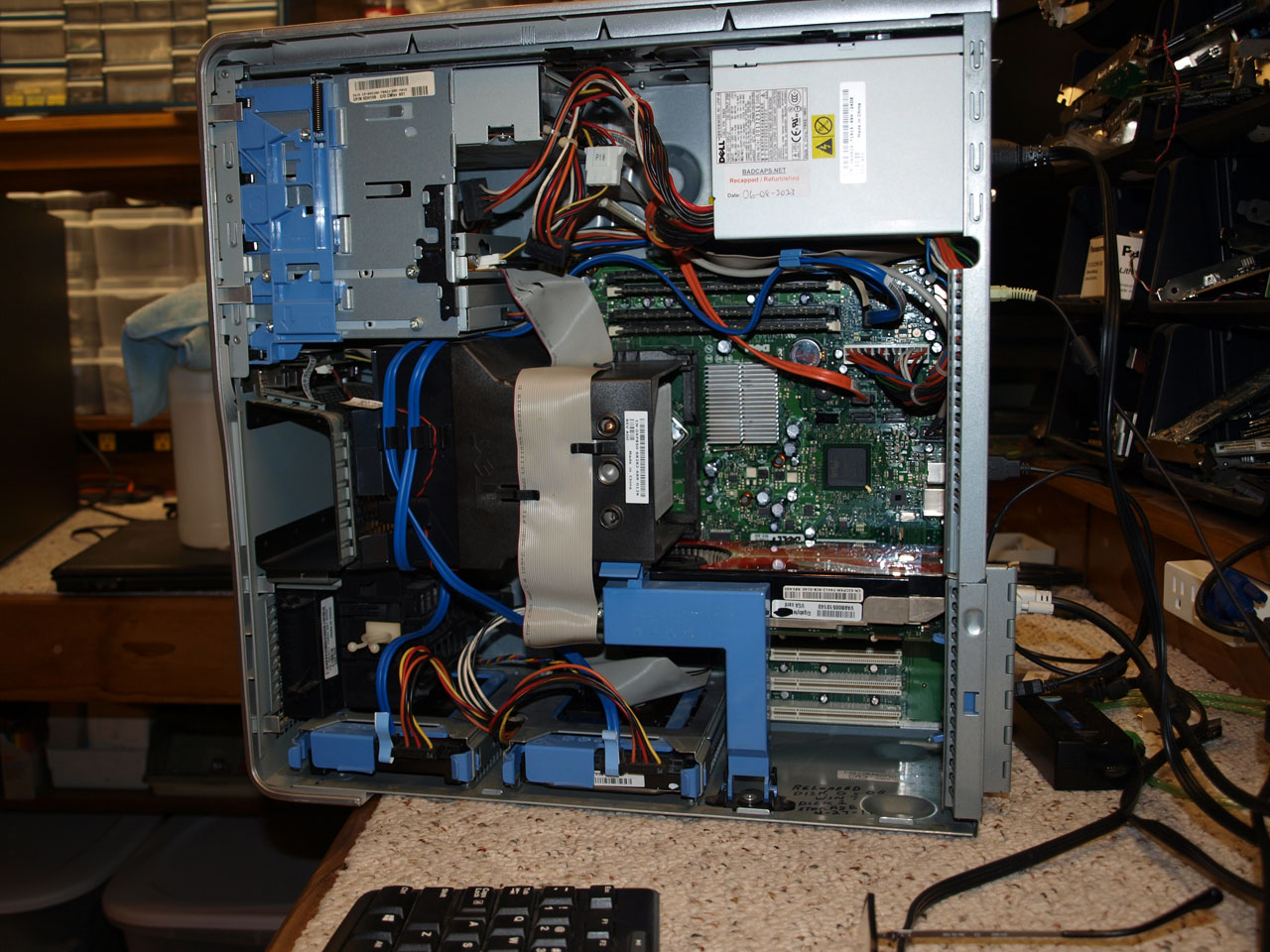

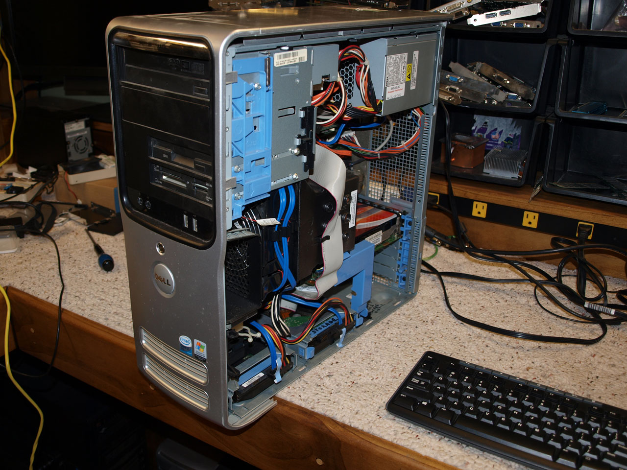

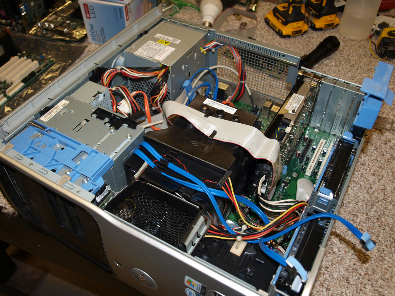

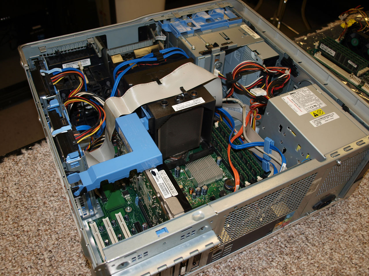

                                  Here's another for this thread....and if your first question is why did I waste any time on this, don't bother....I don't have an answer. This is a Dell XPS 410 that was one of about a dozen random junk systems that were dropped off this week. It's a gutless wonder with a C2D @ 1.8GHz and 1gb RAM. GPU is a Radeon HD 2400....Talk about a lemon! ...but I've always kind of liked the styling of these cases....but being that oddball BTX form-factor, even with my case surgery skills there's not much I can really do with one....so I have to use what I have available.....so lets take this lemon and make some lemonade!!
                                  I didn't even power this up, as I knew what would be wrong with it....

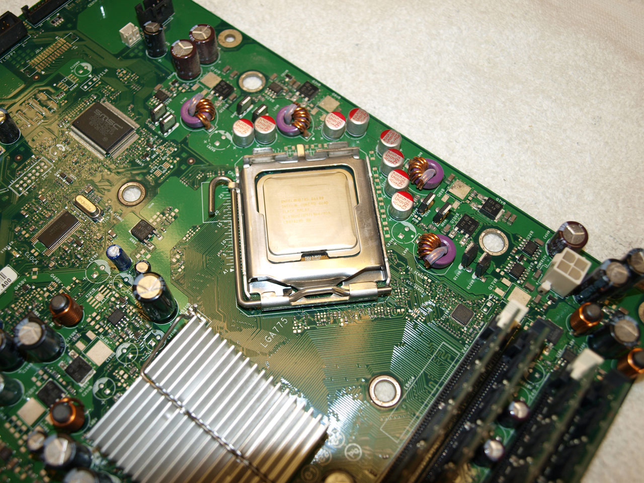

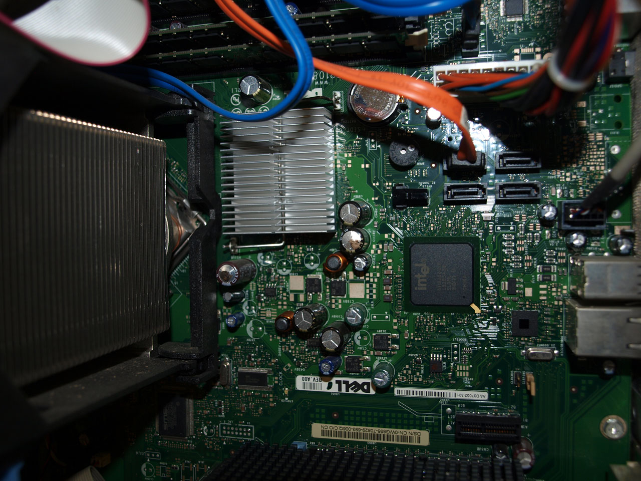

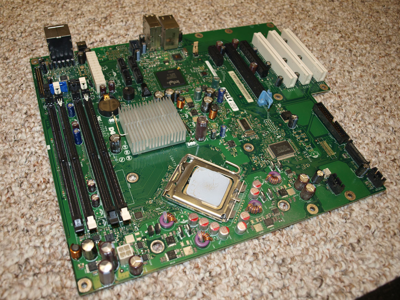

                                  Motherboard out for recapping. I only replaced the KZG & KZJ. The 680uF 16v were KMG, a series that's not prone to failure....so I left them alone.
                                  Case inside wasn't too bad. Dusty, but the air hose cleaned it well enough. No need to wash it.
                                  Recapped and then tested in the oven. It worked.
                                  Lets rummage through the bin of C2D & C2Q CPU's. This board can't run anything faster than 1066 FSB..... I had a C2Q Q6600 @ 2.4GHz in the drawer, perfect! The fastest it could take would be a Q6700 @ 2.66GHz....but I'm not spending the $18 on one when the Q6600 will do fine.

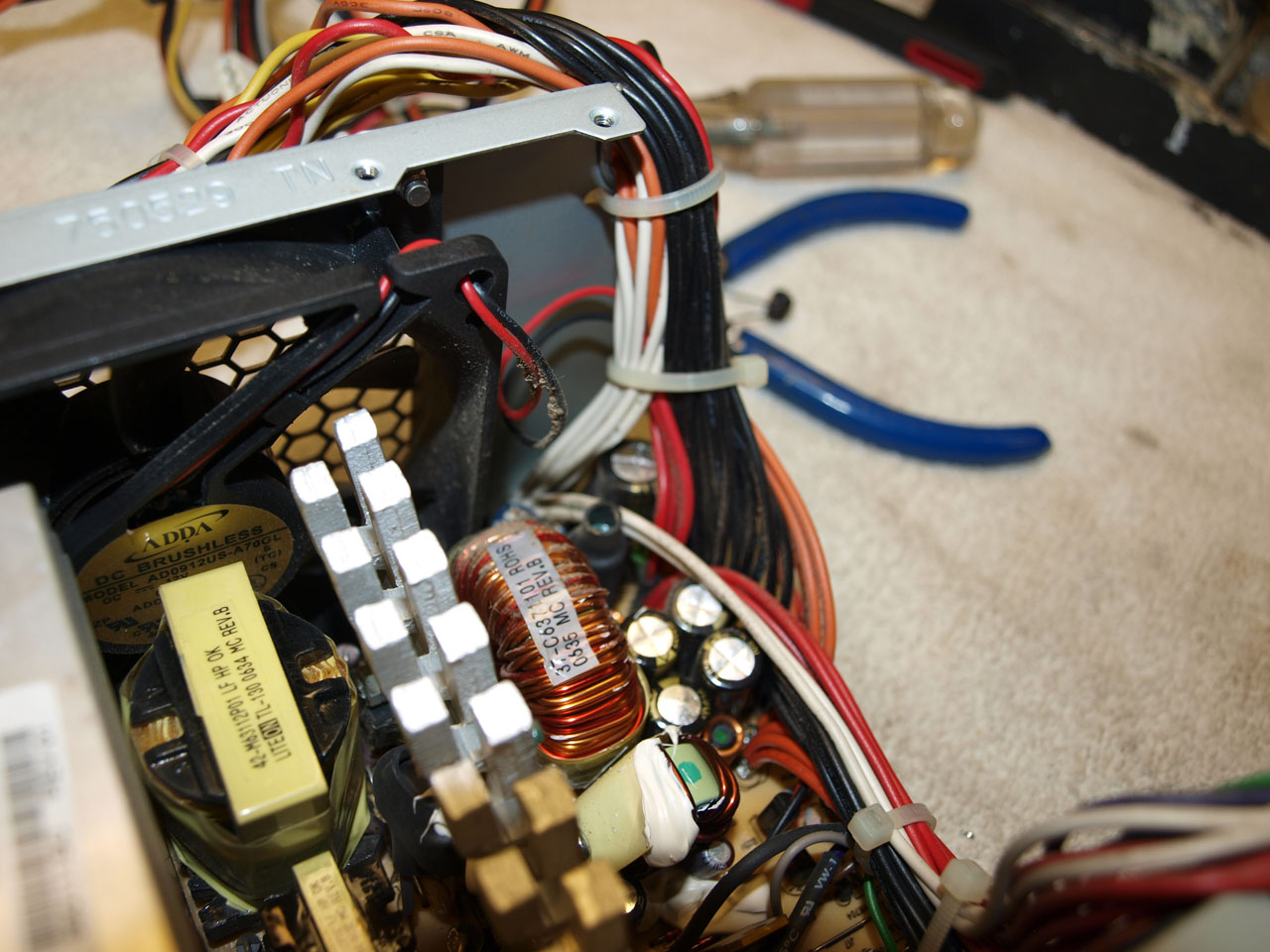

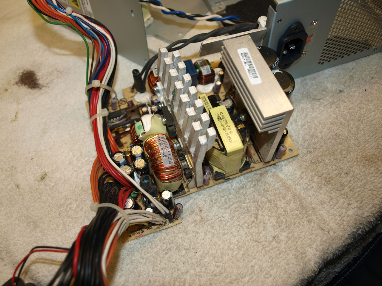

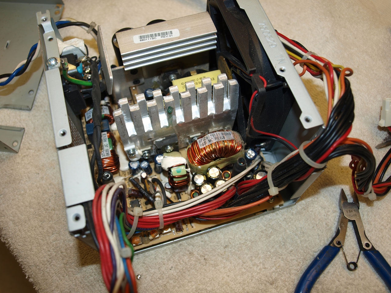

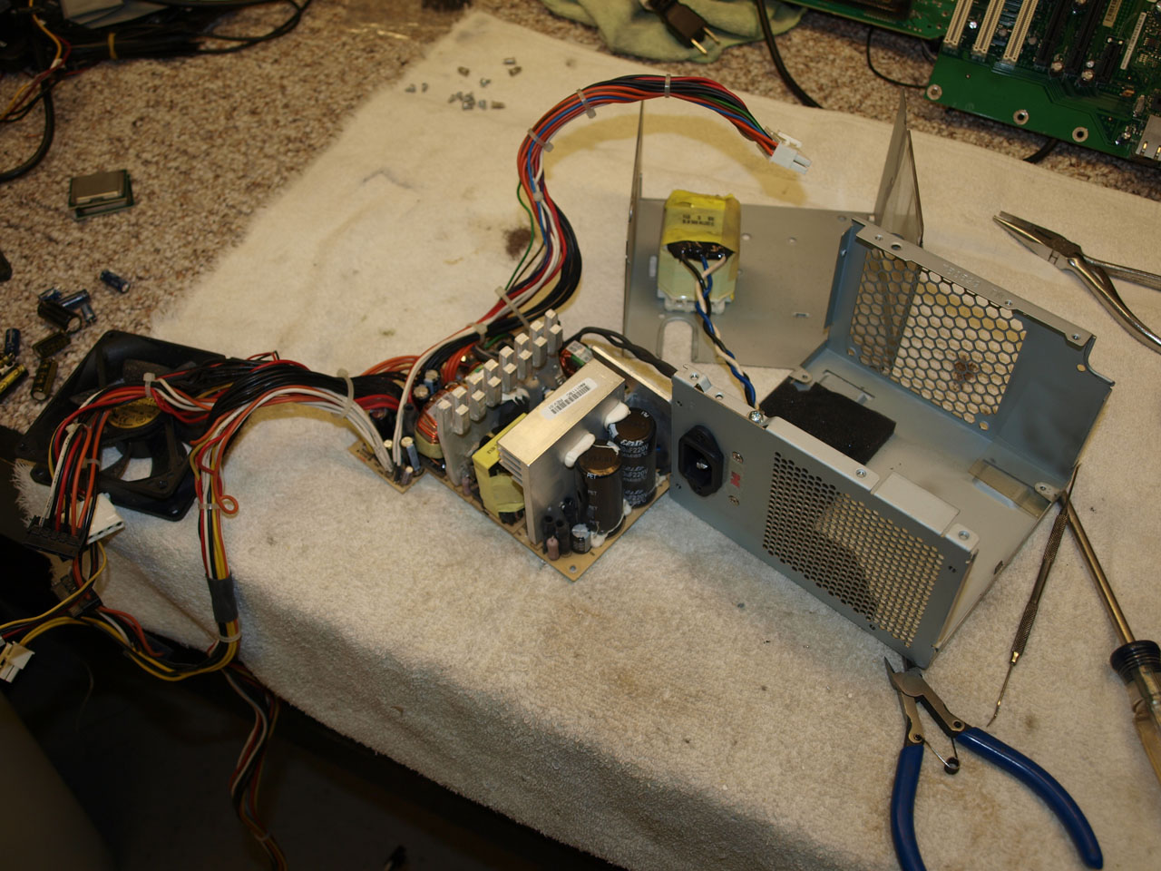

                                  I also knew I had to crack the PSU open.....and imagine that, bad caps...
                                  Recapped.
                                  This PSU was a real pain to work on. Nothing unplugged and there was just too much extra crap to desolder....so I had to work with it half ass still assembled. It looks like a lite-on build.

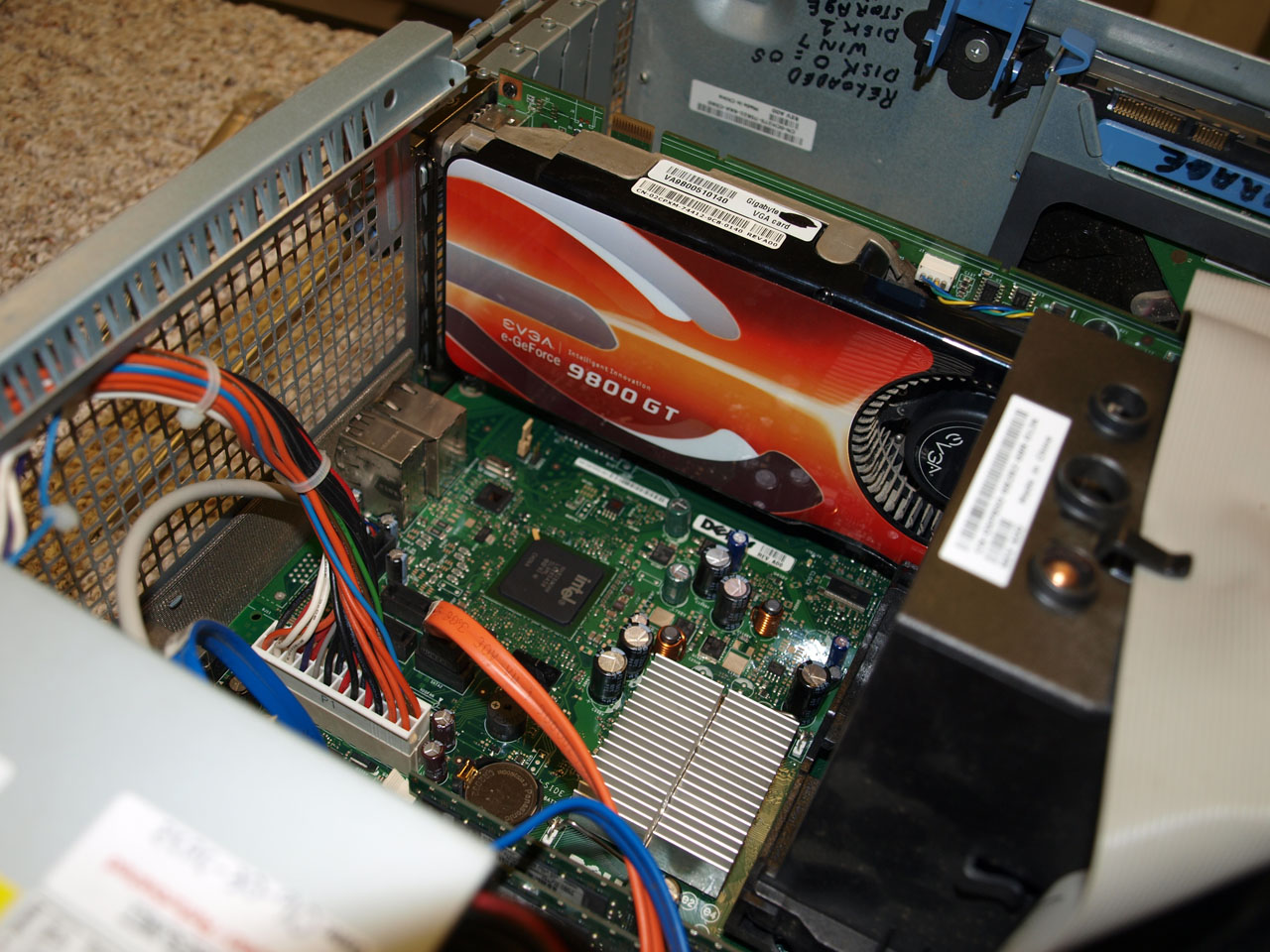

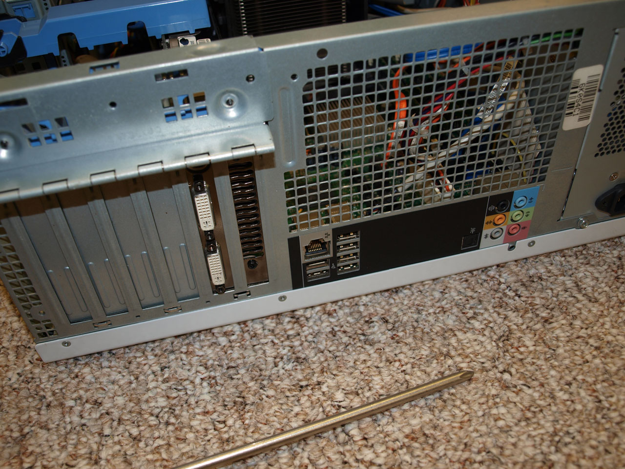

                                  Going back together....and a few other upgrades..... A double-slot GPU can actually fit in this.....
                                  Time for the mystery period-specific GPU to sign in!

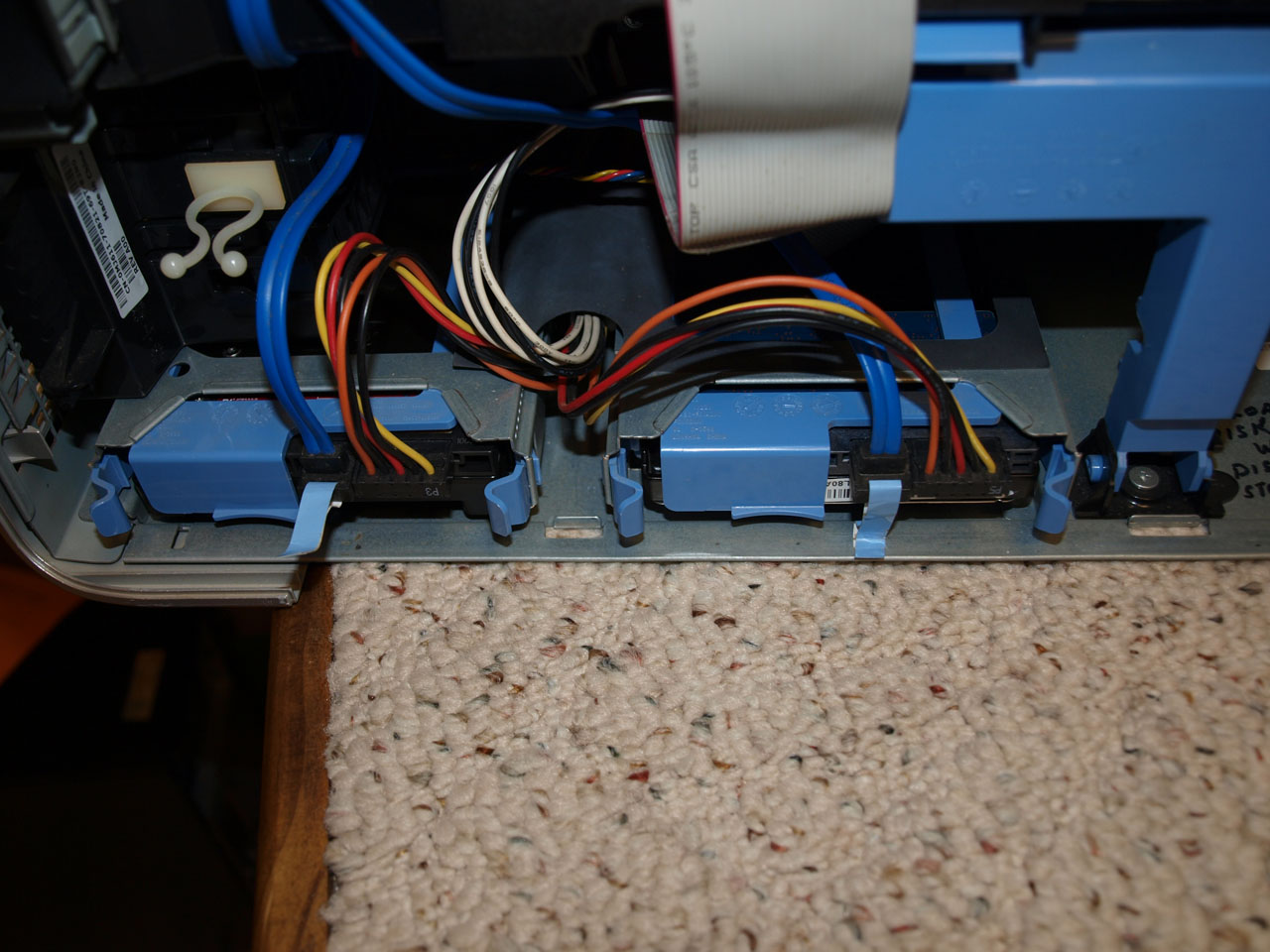

                                  I had 4gb of RAM in the bin....I guess I used up all the 2gb modules, all I had was 1gb. No biggie really. I'll install Win7 on this, 7 on 4GB ram is just fine.
                                  Butt shot... I deleted the rear header for the PS2 & serial ports, as I accidentially tore the ribbon that connected it to the mainboard. It wouldn't release from the plug and the ribbon pulled out of the plug. Oops....ohh well, I always use USB anyway.

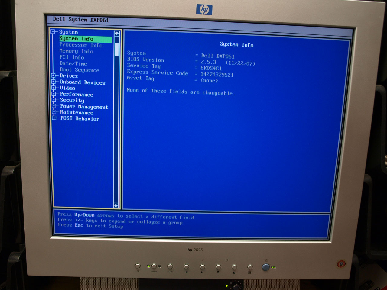

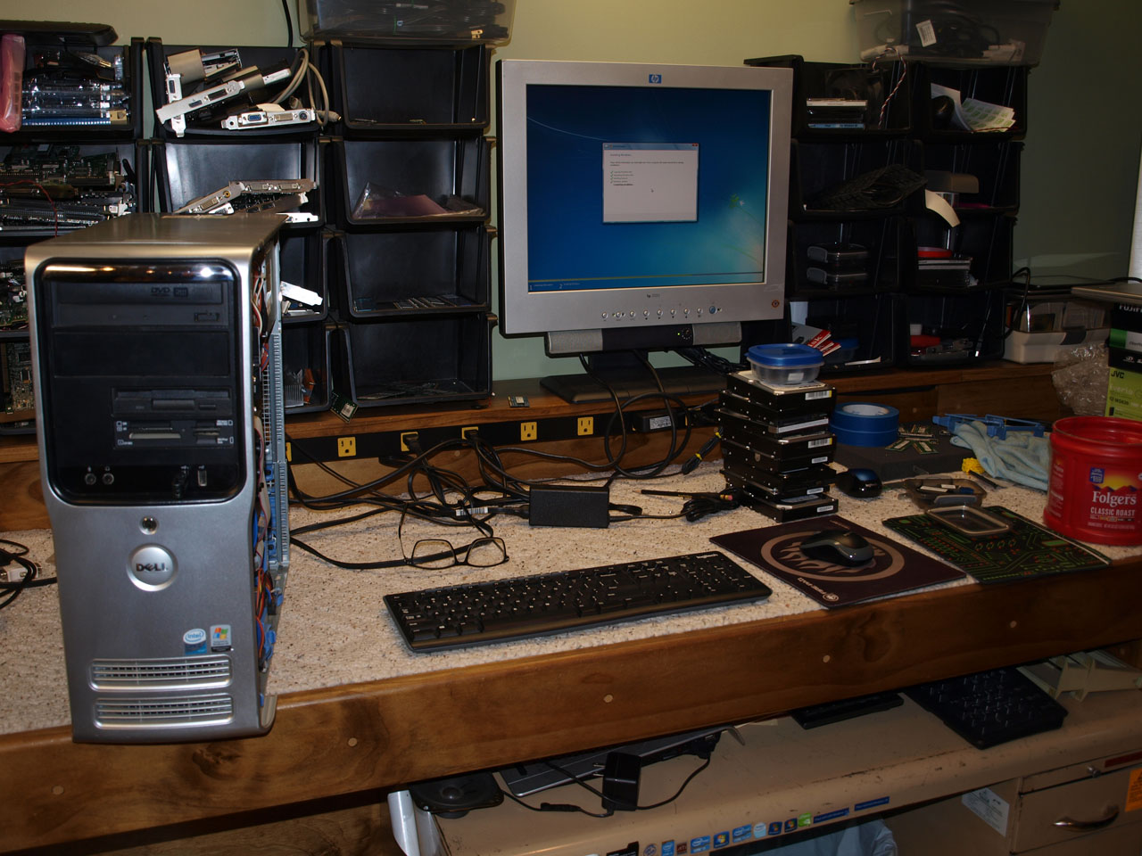

                                  Time to light it up....

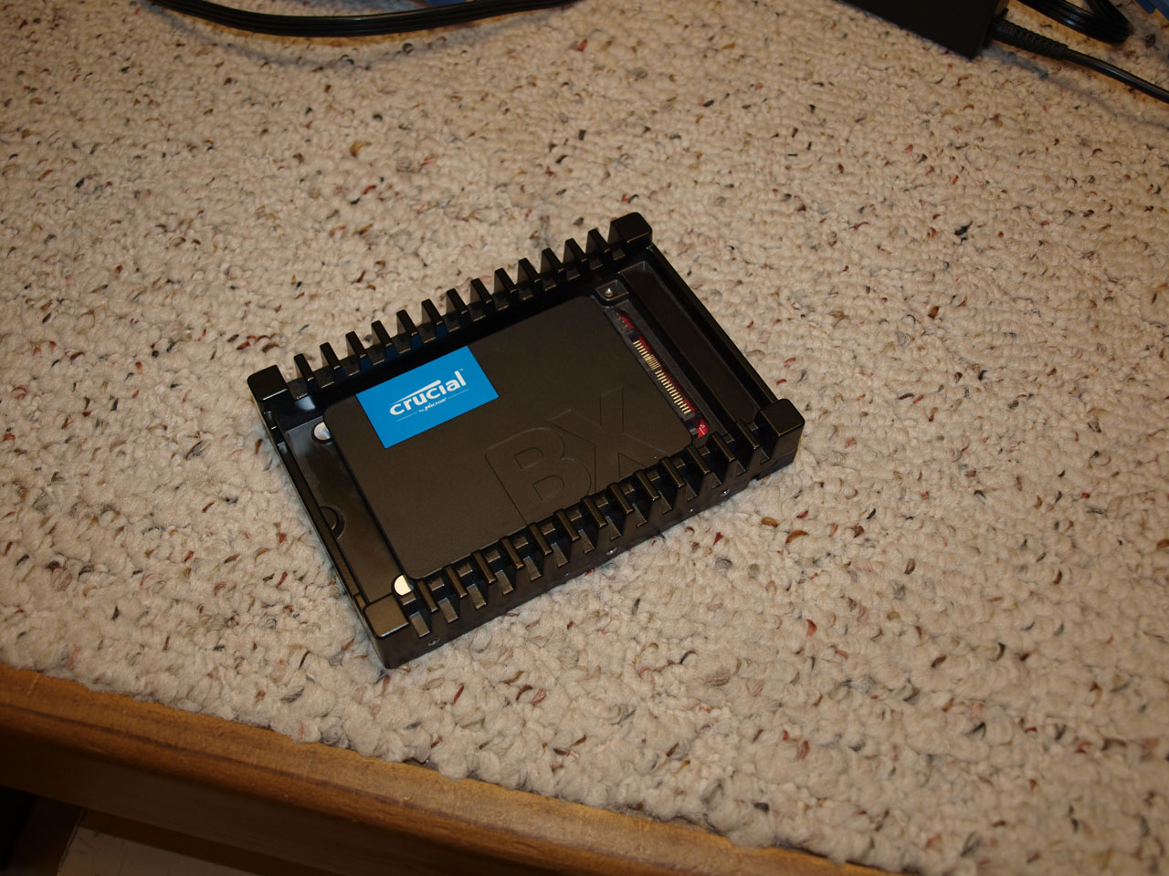

                                  I removed the drives that were in it. One was a 160gb Samsung, the other a 320gb WD. I replaced them with a 120gb Crucial SSD for the OS and a 1TB Toshiba for junk.

                                    Re: Topcat's Other Misc Weird Build Thread
                                    I like it!
                                    Actually, this is essentially what I thought about doing with a Dimension E510 (or was it 520?) that I got some years back. It was the same thing like yours, but minus the "dedicated" GPU and no HDD included. Otherwise, bad caps in the PSU and on the mobo just like yours. I didn't end up doing any mods or upgrades to it yet, though. Just fixed it up and set it up as a spare PC to have around. It plays older (<2006) games nicely with a better GPU.
                                    The big 120 mm fan on the front is also nice - pulls cold air from the front and dumps it on the CPU. Also pulls some air through the HDDs too. What I don't like about this setup, though, is that there is no exhaust fan other than the PSU. So these cases do get somewhat hot inside. I also have a Dimension E5150, which on the outside is the same thing as the E520, but the motherboard is a i915 chipset (IIRC) and won't take anything better than Pentium 4 and Pentium D. I have a 130W TDP Pentium D 830 that member Pentium 4 sent me a while back. Always wanted to use that thing, but it needs some serious cooling. Luckily, I found a spare 6-pipe cooler with the rest of the junk where I picked up that PC. So the goal is to replace the P4 CPU on that E5150 with the D830. I know what's the point of wasting time on something like that today. But the case does look pristine otherwise... and like you said, I also like the styling.
                                    That being said, I've flipped the front fan on the E5150 to pull air from the case and dump it out front. Haven't had enough time to play with it to see if that makes the cooling any better, but I'll get there one day.
                                    Hey, at least it's not a Celeron with integrated graphics and Windows Vista (not uncommon for that era.)
                                    Yeah, not worth it.
                                    In today's times, the difference between Q6600 and Q6700 is negligible, particularly to online browsing. And a Q6600 can be had for <$10 all day long - essentially 2x cheaper.
                                    Sounds about right.
                                    I find 2nd tier/brand caps in OEM PSUs from that era never to last too long. The same Ost, Ltec, CapXon, and Teapo caps from just a few years earlier usually outlasted them.
                                    Again, it's a shame, because these OEM units are pretty solid otherwise - no APFC to worry about blowing up the primary cap(s).
                                    It is.

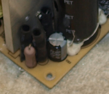

                                    That being said, beware some of the Lite-On units from this particular era use an electrolytic cap for the primary-side main PS snubber circuit.
                                    It's rated something like 400V and 2.2 uF, and you can just about see it peeking with its top in the picture below, right next to one of the big caps on the primary side.
                                    https://www.badcaps.net/forum/attach...1&d=1686366550
                                    So if you get one of these units and it's acting "funky" with weird noises when you try to turn it on, check that cap. The one I had wasn't making any noise, but I did check the cap pre-emptively and it read high ESR (20 or 30 Ohms, IIRC.) I replaced it with a 2.2 uF (again, IIRC) polypropylene... which do cost a little more. But at least I won't have to worry about it again.
                                    Cool!
                                    The only issue I run with these cases (at least the Dimension E520 & 5150) is if the GPU is too long - then it clashes with the CPU cooler shroud.
                                    I like it - you got the dual-slot cooler version of these. The single-slot ones run blistering-hot and are retarded IMO. Whoever though it was a good idea to couple a 100+ Watt TDP GPU with a heatsink that's probably not even capable of cooling a Pentium 3 should reconsider their career.
                                    Was the Samsung 160 GB one a pre-Seagate model? If so, keep it around - those are super-reliable, IME. Not the fastest, though... though not the slowest either.
                                    Installed Win7. Its been a while since I've worked with 7, I was a little rusty with it....
                                    I had a moment like that with Windows XP the other day. Set it up on a PIII laptop I wanted to test out quickly while doing other stuff. After setup finished, I was like "OK, what else did I have to do now that I always do with my standard XP installs?" I really had forgotten how much simpler it was to set up XP and not have to deal with disabling a ton of crap like I have to with Windows 7. And my 15 YO flash drive still has all of the standard utilities and proggies I need for XP.
                                    ...and that's that! Time wasted on a pretty worthless system.....but ohh well.
                                    Specs:
                                    Dell XPS 410
                                    C2Q Q6600 CPU
                                    4GB PC2-5300
                                    Geforce 9800GT 512mb
                                    120gb SSD + 1TB HDD
                                    Oh c'mon, it's still not that bad of a system (anymore), IMO. Will easily browse the internet all day long. 4 GB might limit how many facecrook tabs one can have open (probably 2 max. ), but this ain't the kind of PC for "such people" anyways.
                                      Originally posted by momaka
                                      I like it!
                                      Gracias. I don't know what possessed me to pull this one off the pile and build it....but I did...
                                      I haven't tried any games on it yet, but knowing what this CPU & GPU combo are capable of, it'll play some Q3A and UT like a champ!!
                                      I was surprised how cool it ran bumping it up to a quad core. Under the 120mm fan is another 80mm that cools disks and the south section of the case. Well laid out case, I must admit.
                                      I usually break those down and junk them....especially the ones with no slot options for upgrading GPU's.
                                      It is.
                                      Correct you are. Here's a better view of it, pulled from another angle; from the high-res pic:
                                      Boggles my mind why thye used a cap versus a diode for snubbing (I don't recall seeing diode down there), so it had to be a RC snubber....but I'm sure they know things I don't. The unit was quiet (audible and on the scope), not that a failing snubber circuit would have shown noise on the outputs....but it did appear (and sound) to be functioning correctly.....but I confess, I didn't check it.
                                      Cool!
                                      This one cleared by a decent amount AFT of the card....but clearance with the shroud on top was close....but even the retainer bracket (blue thingy on a hinge) closed & latched correctly.
                                      LOL...I concur....and funny enough, I had that exact card sitting here as a standby if the double slotter didn't fit. The card is actually good.
                                      Yes, it is pre-seagate. I wiped it and put it in the smaller HDD 'good' bin. I have a guy that comes by periodically looking for smaller SATA & IDE drives....I give him anything sub-500gb for free. THey're not worth fooling with trying to resell. Not sure what he does with them....but I get the impression he's a hobbyist.
                                      I haven't touched XP in a looooong time....I'd be really rusty there....but I'm sure it'd all come back to me. I still use XP for analog media to digital conversions; such as a record to MP3. I've just found older hardware & software to produce better results and actually easier to use.
                                      LOL.....I did look, 8gb of PC2 for this would cost about under $20 shipped.....I just didn't bother. Fwiw, this site can be viewed from a pentium classic on Firefox 2.xx!!
                                        What purpose does this capacitor serve in a passive PFC device?
                                        Do you have a schematic that explains it?
                                        Incidentally I have recapped a PSU exactly like this too from a Dimension 9200, I think the cap was ok, but it was over three years ago so who knows today
                                          master hoarder
                                          • May 2008
                                          • 12170
                                          • Bulgaria
                                          #100
                                          Sorry for the late reply.
                                          It's the cap for the RCD (resistor-capacitor-diode) snubber circuit on the primary side for the main PS MOSFET.
                                          Normally, I've only seen ceramic caps used for the snubber, since they are cheap and handle the high frequencies well. But they are always much smaller in value. Not sure why LiteON used such a high capacitance value. I'm sure there's a reason, though. These PSUs do work fine after all. It's just that the high value for such cap calls either for an electrolytic or a polypropylene film type. The latter option is more pricey, so probably that's why they went with a 'lytic there.
                                          I did actually draw a circuit diagram when I saw this... but it's in my electronics notebook, which is currently a few thousand miles away.
                                          https://www.badcaps.net/forum/attach...1&d=1686457554
                                          They do have a diode in there. It's one of the heatshrinked parts next to the cap. So it is a full / proper RCD snubber circuit. Just not sure again why they did it with such a high-value cap. But like you say, maybe LiteON knows what they were doing and it's there for a reason. Nevertheless, I didn't feel comfortable leaving the original electrolytic cap in there when I checked it and it showed over 20 Ohms of ESR.
                                          BTW, here is the post in the quality build thread for my PS-6311-2d2 [Dell L305N-00]:
                                          https://www.badcaps.net/forum/showpo...postcount=2972
                                          And the thread that shows the recap and the snubber circuit mod with a PP cap:
                                          https://www.badcaps.net/forum/showthread.php?t=72929
