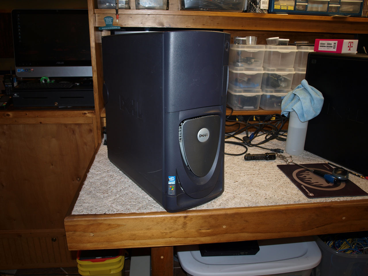

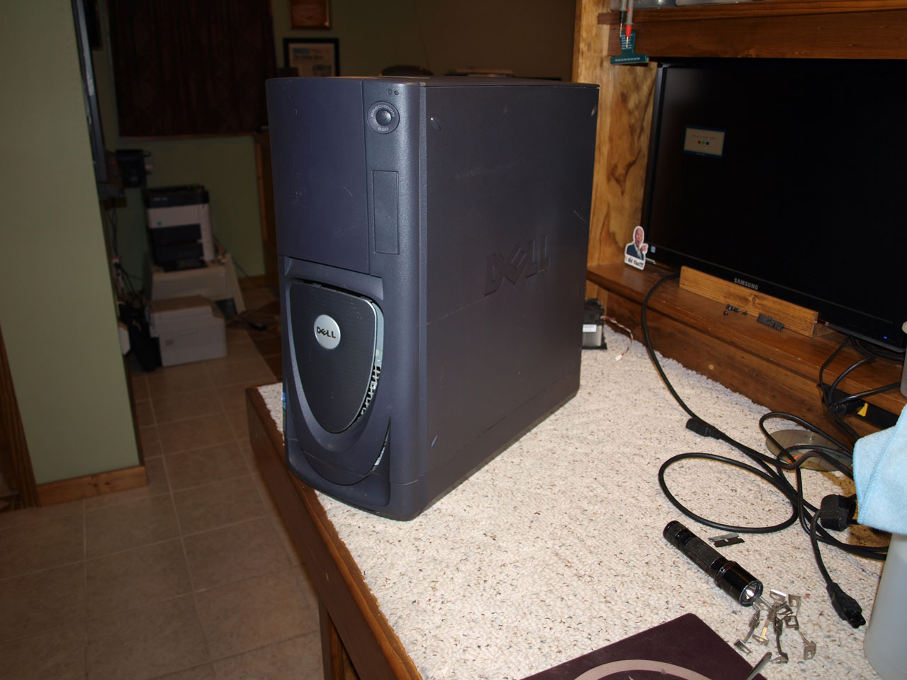

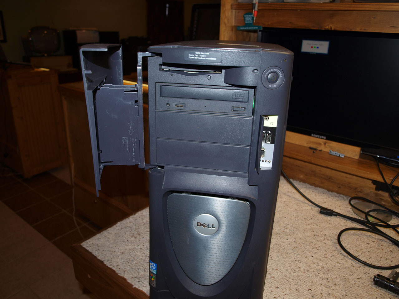

    Here's another for the retro fleet. Someone gave me this around 2008, Dell Precision 530 workstation; dual skt603 with failed caps of course, Nichicon HM. At the time it was deemed not worth messing with and it sat on a shelf in the garage since; it was made 2002~2003-ish (datecodes on the caps were 2001, the 'dark era' for Nichicon HM series). It being buried under other stuff is probably the only thing that kept it from being scrapped.... I came across it the other day when I was scrapping the stuff on top of it and thought hmmmm....maybe a little retro status, considering it's a RAMBUS system, and it has a pair of 3GHz Prestonia's (the fastest it could take)...but apparently their values has gone up!! I stole the RAM out of it ages ago, but CPU's are still in it. RAMBUS survivors are becoming less every passing day. Recapped it and it's working.
    Blasted with the air hose and wiped down.... The real miracle with this one, the door is still on it and not broken!!
    Click image for larger version Name:	p530_0650.jpg Views:	0 Size:	221.2 KB ID:	3156243
    Click image for larger version Name:	p530_0651.jpg Views:	0 Size:	203.9 KB ID:	3156244
    Yup, miracle! In hunting, I looked around for these. The door was almost never there.

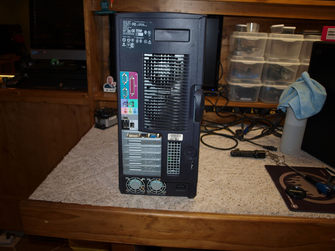

    Butt shot....
    Click image for larger version Name:	p530_0653.jpg Views:	0 Size:	228.3 KB ID:	3156246

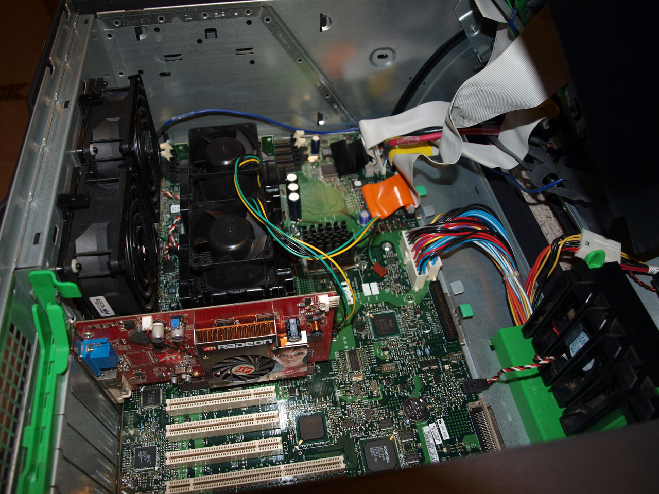

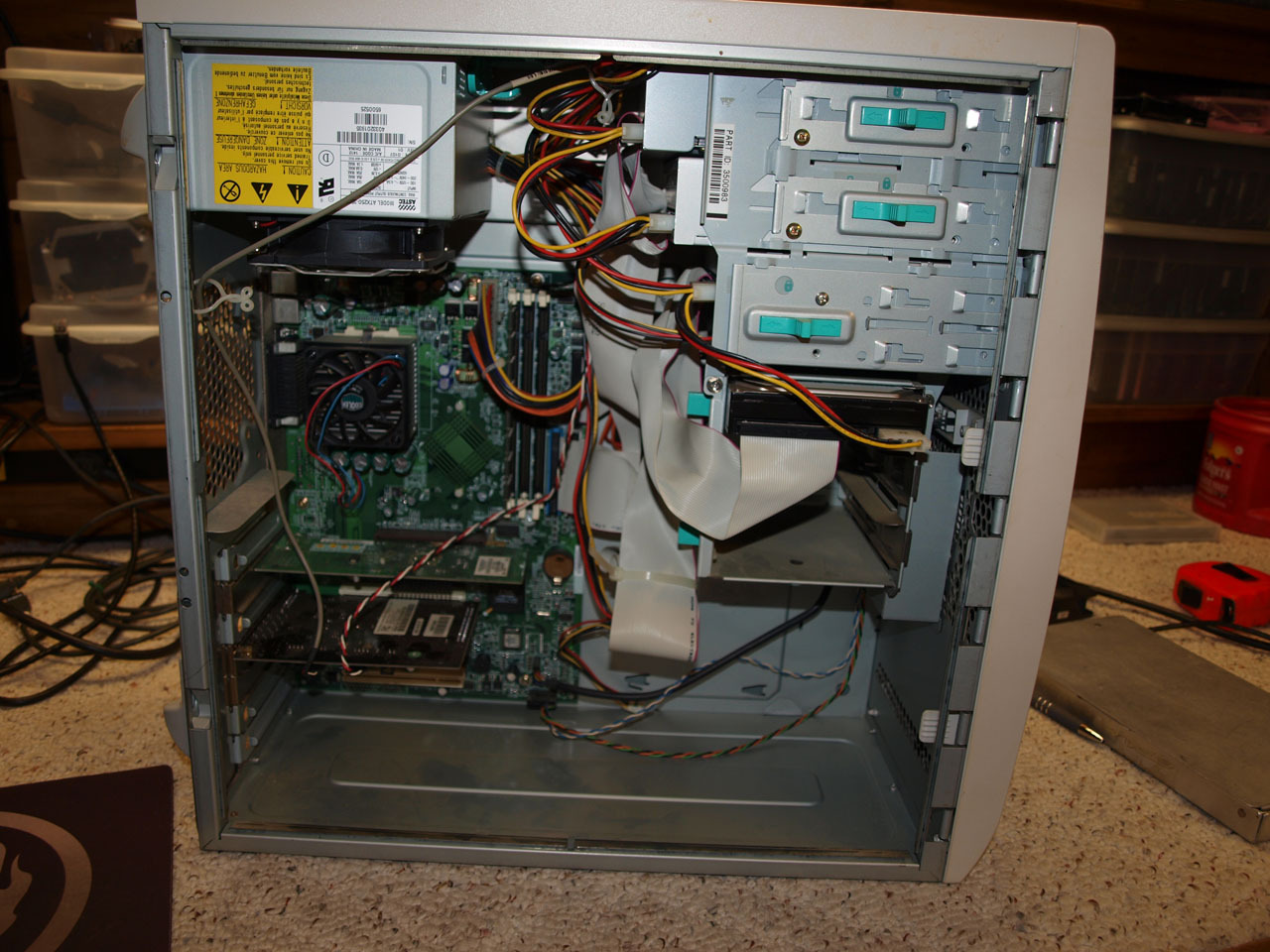

    Inside. Stuck an ATI x1600 Pro 512mb AGP GPU in it. Not sure what it originally had, I stole it over a decade ago.
    Click image for larger version Name:	p530_0654.jpg Views:	0 Size:	350.2 KB ID:	3156247

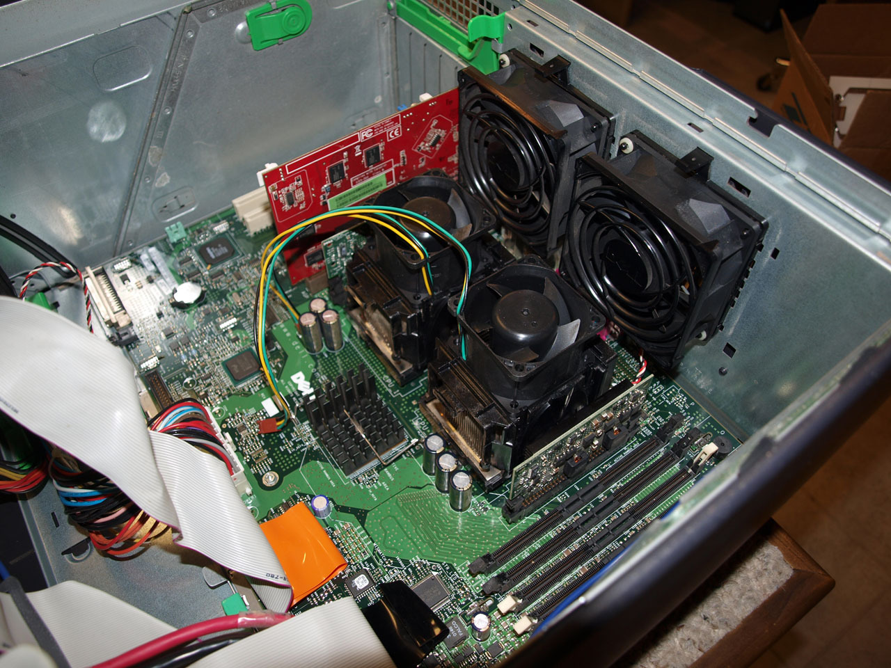

    CPU heatsinks & fans had also been robbed.....so I had to rummage through my box of old skt 603/604 parts. This is one of the few times Dell didn't use a proprietary heatsink/fan setup. The originals were really cheesy passives that I tossed ages ago, but the bases that held them were standard for any socket 603/604, thus any compatible heatsink could be used.
    Click image for larger version Name:	p530_0655.jpg Views:	0 Size:	375.0 KB ID:	3156248

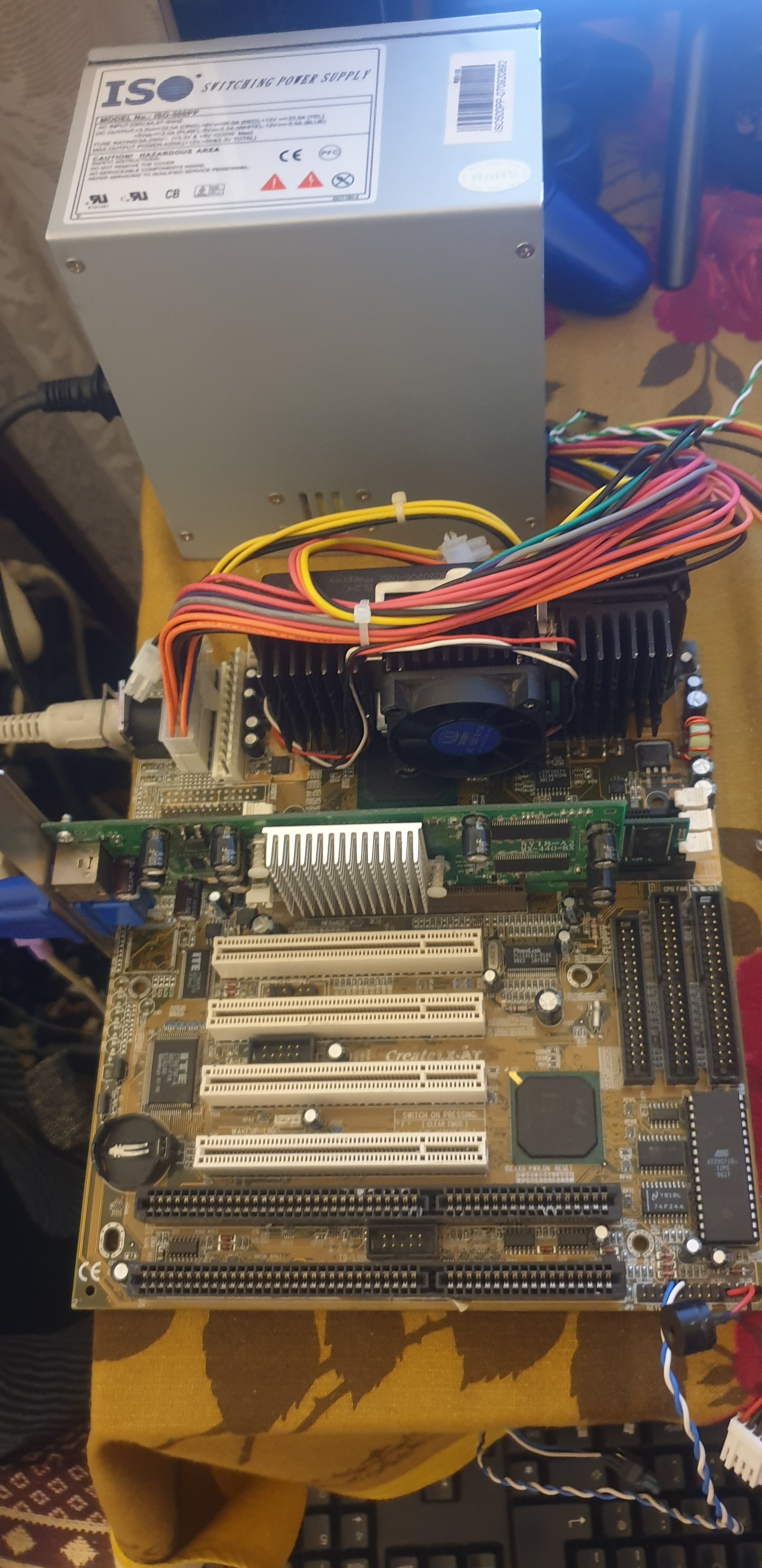

                  You sure it wasn't the HDD at fault for WinME being slow? I used it recently on a 500MHz Katmai build with a GF2 Pro/GTS w/ the same amount of RAM and it was pretty speedy.
                  Onto funky stuff... dug this Baby-AT Tomato 6DLX and what I suspect (I am not fully sure) is a unlocked 266MHz P2, SL2HC. It'll clock to 333 just fine but I haven't pushed it past that. The BIOS is absolutely packed with features, and CPU speed is set thru BIOS - no jumpers whatsoever.
                  I'll prolly dump the 266 into my BE6-II and see if it can OC. Zida reports a max setting of 533 - but I have some quite high doubts it can jump that high....
