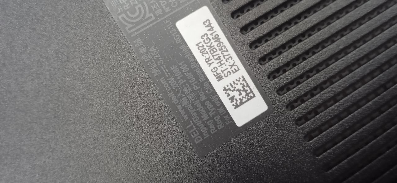

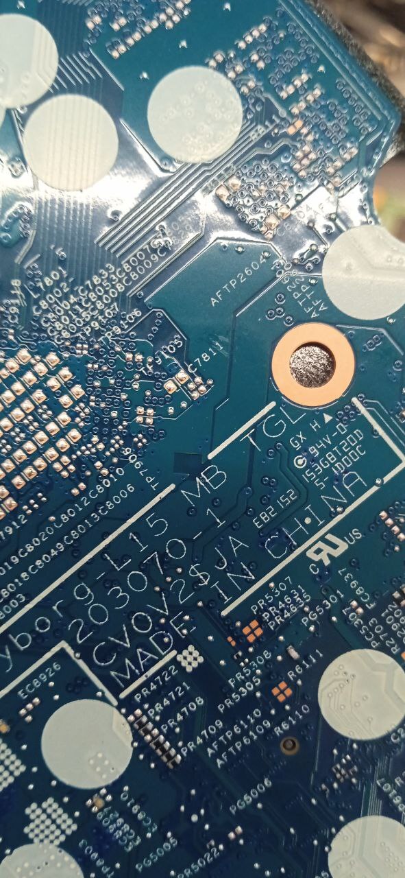

                                      Hello friends, I need your help and I will be grateful. I have a laptop and the BIOS is locked and I will not make a backup. I need your help. I will provide you with the information for the laptop
                                      ST:H47BKG3
                                      CYBORG-L15 MB TGL
                                      203070-1
                                      CV0V2$JA
