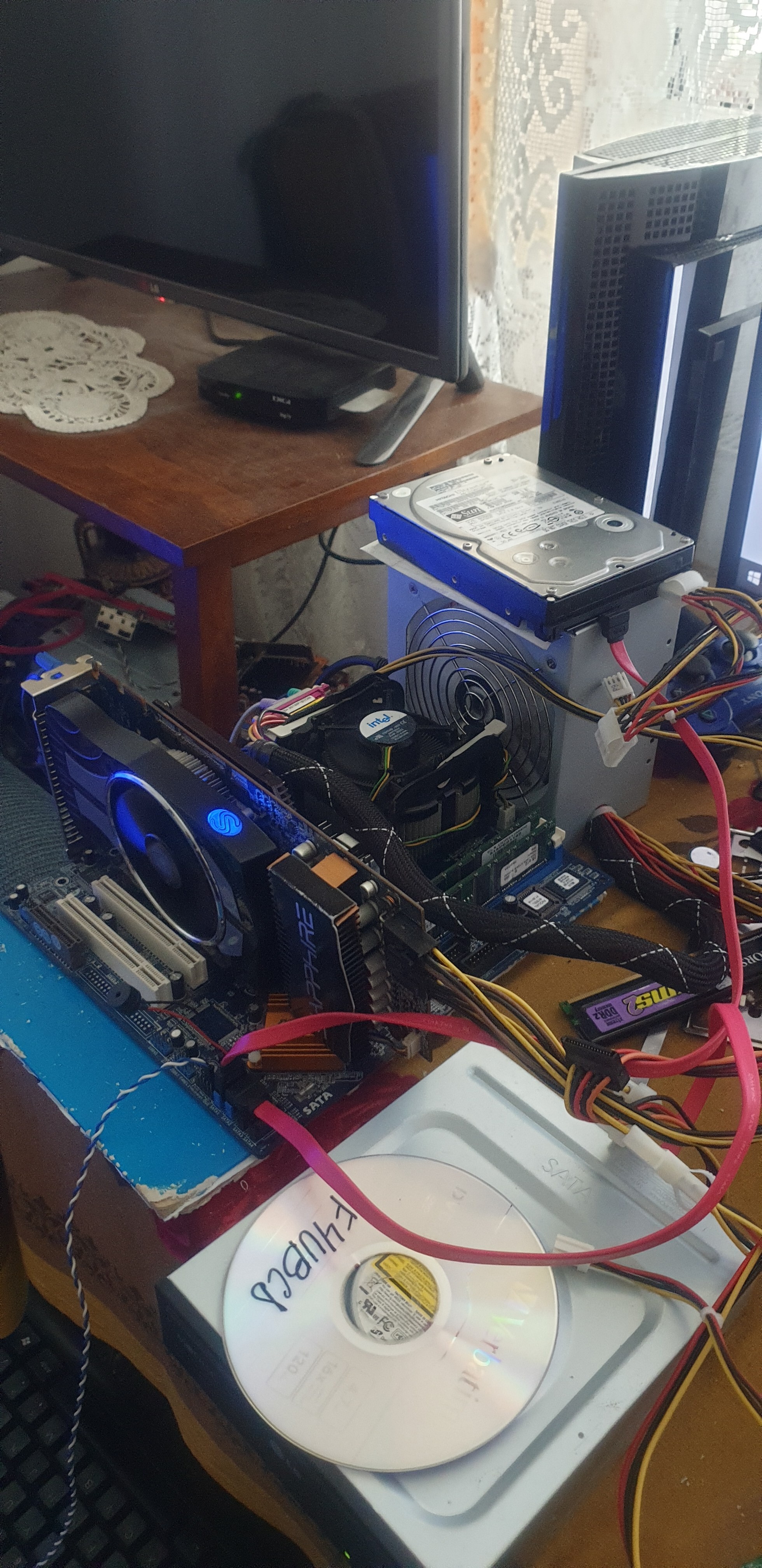

                      Speaking of weird builds... I felt like torturing a old Northwood HT today. Netburst deserves no mercy
                      Northwood HT 2.8, 1TB Hitachi Ultrastar I had around (7200 RPM, nothing special), HD4870 1GB, 2x512MB DDR400, SATA ODD. All running XP, powered by ASRock's funky P4Dual-915GL mobo.
                      There's no way the CPU would keep up with the 4870 lol

                        #151
                        Click image for larger version  Name:	20240406_135105.jpg Views:	0 Size:	1.64 MB ID:	3248363
                        Nice. Someone dropped off a Dimension 8250 system a while back. Supports Northwoods (533FSB max) and RDRAM. I haven't done anything with it yet....but I didn't send it to the R2 scrappers either.
