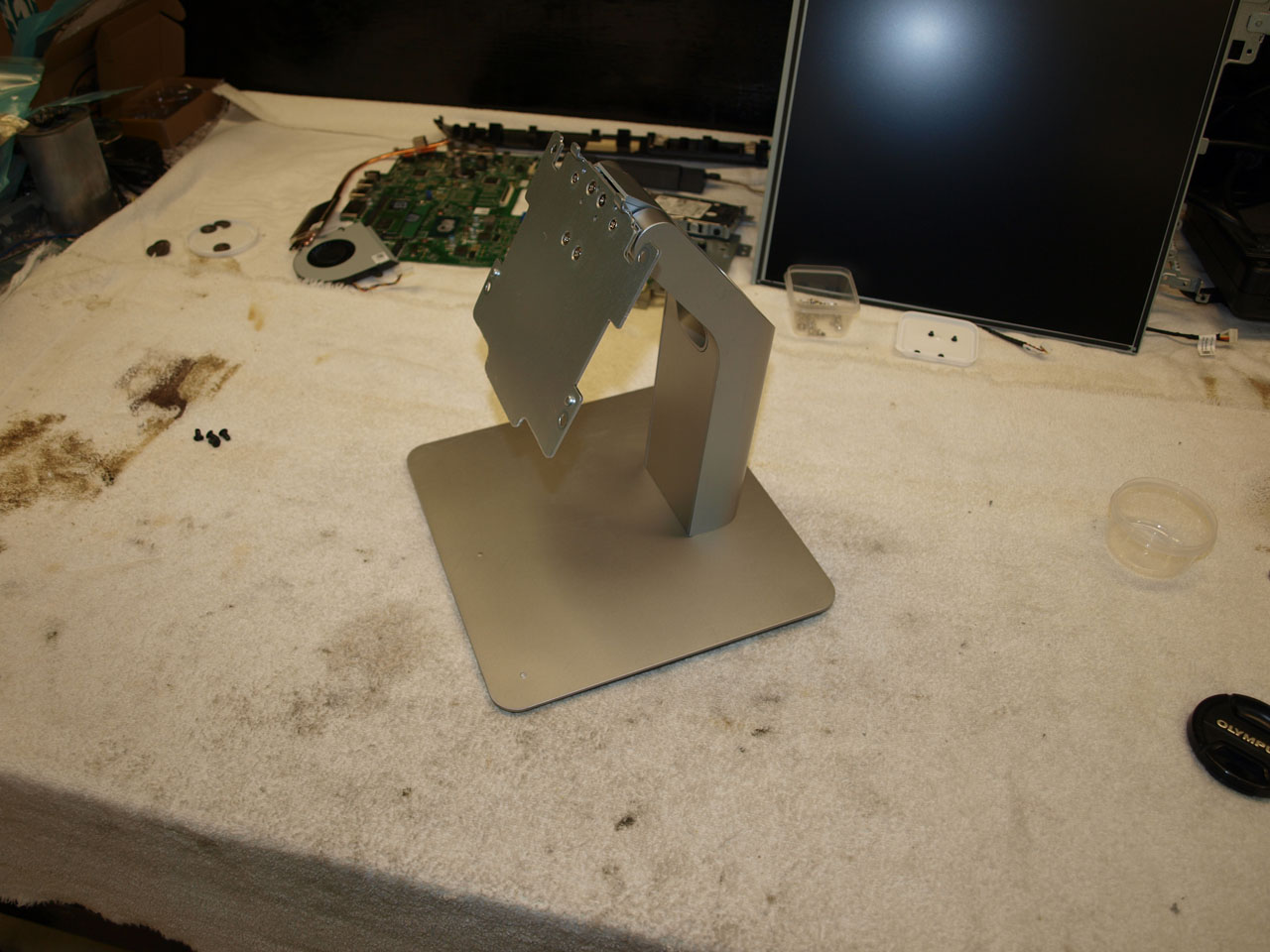

      Now for the stand... Paint is good and set up now. Smell is gone, and it sure looks better!!
      Bottom reassembled.
      The rest reassembled.
      Set aside....can't go any further. I need to get new foot pads for the stand. The originals are smelly and gross, I have thrown them away. These are nothing unusual, just stick-ons....can get them anywhere.

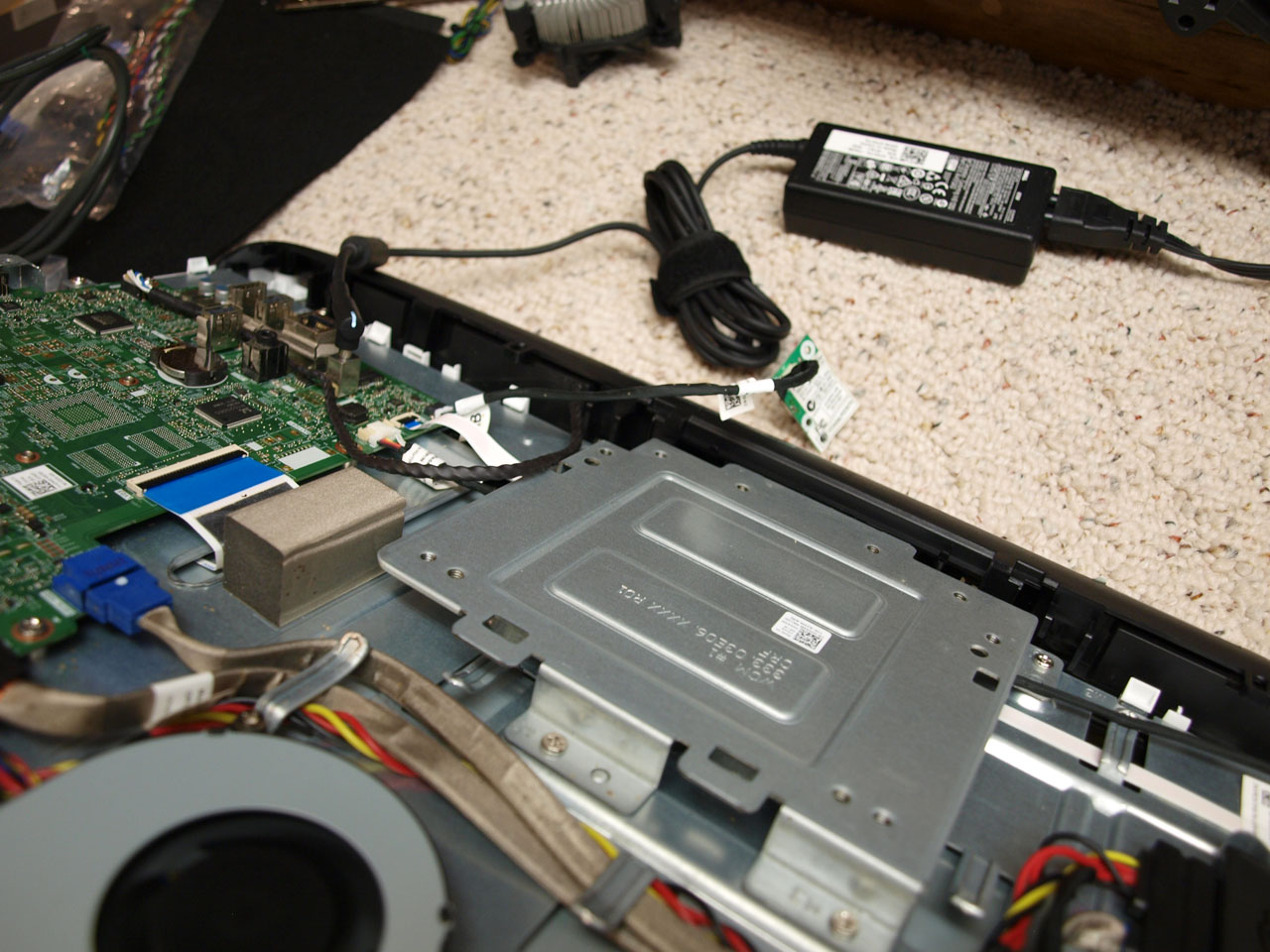

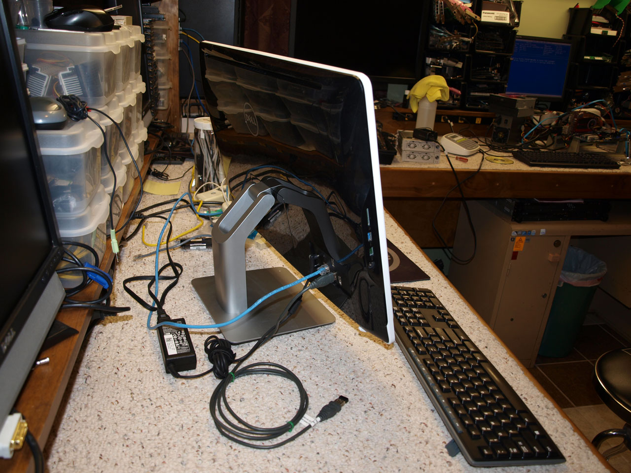

            Got to work on this a little today. The bezel is a perfect fit, not much to assembling it other than a bazillion little screws....but here we go!
            The new bezel:
            ...and the box it came in....
            about half way there...I also deleted the camera & microphone....I hate them. If the buyer wants them, I will put them back in.
            Not bad!
            New genuine Dell PSU (I've had horrible luck with the chinese knockoffs).
            Just about ready to test fire!
            It lit up!! screaming about the HDD not being plugged in (I'm replacing it with a SSD).
            A pleasant surprise, it is an 7th Gen (as I knew), but an i5 7200 instead of the i3 7100 I thought from searching....but only has 12gb RAM. I only looked quick, thought both modules were 8gb....but one is 4gb. I did order a matching 8gb to go with it....
            Booted off Hiren PE. NIC works, so does WIFI.
            Happy with it so far.

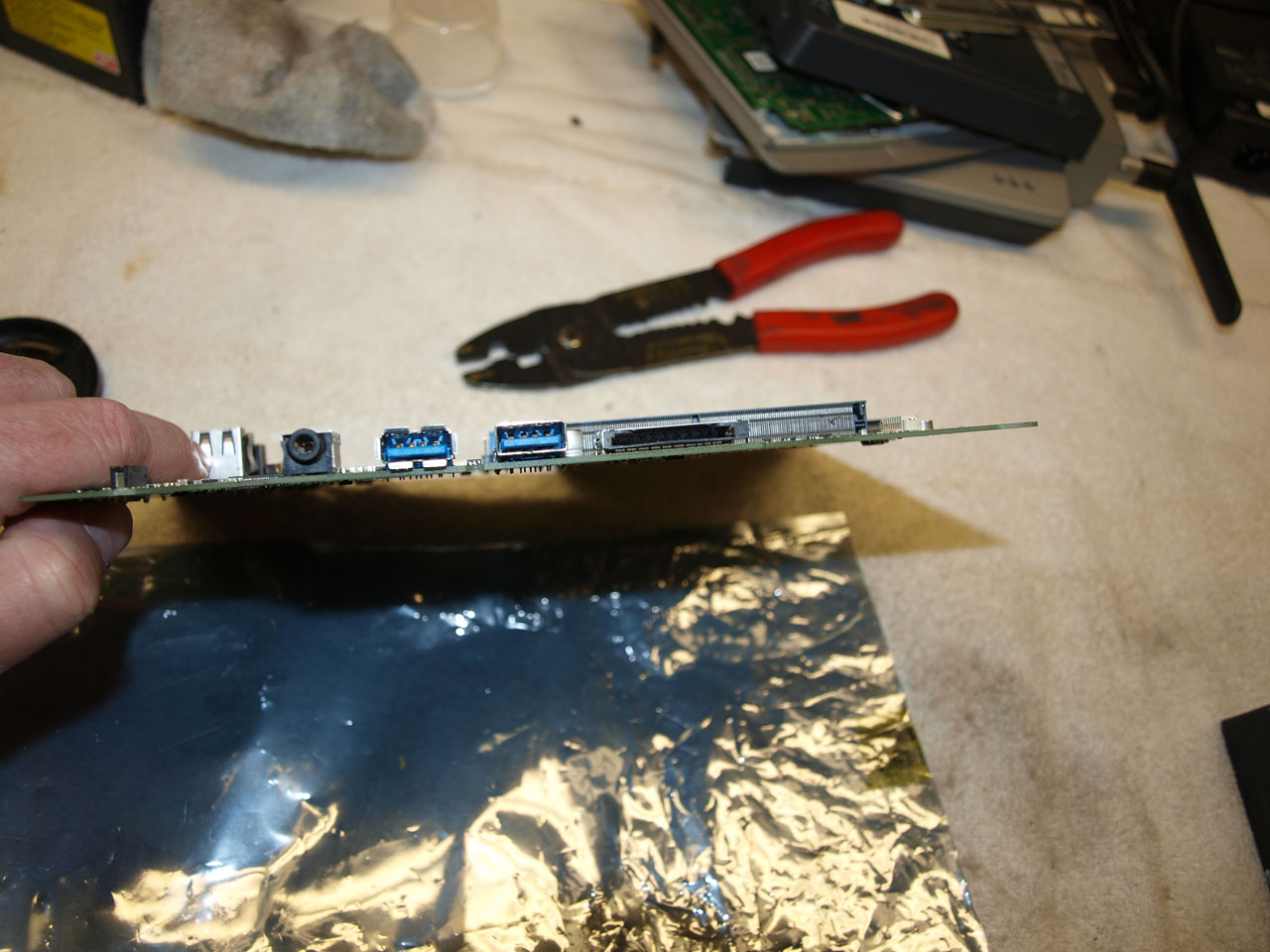

            I did discover a USB slot was trashed.... I'll have to pull the motherboard and see if I can find a replacement slot.
            YAY!
            Wow, that thing speedsteps down a lot!
            ...and that's all for today...

              Re: Topcat's Other Misc Weird Build Thread
              Since the discovery of the damaged USB and the good fellas that helped track down the piece to fix it, I'm at a standstill waiting for the part from China....which will be weeks probably....so I went ahead and reassembled this minus the missing port.... It takes all of 5 minutes to remove the board, so when it gets here I'll install it. The 8gb RAM module got here, so now it indeed has 16gb. I also stuck a 240gb SSD in it and reassembled it.
              Installed S2K12 R2. The only driver issue was as per the usual; the Intel GPU driver shell game.....but I finally found one that worked. Everything else was supported/worked with the drivers from Dell's site.
              The white bezel looks good, all things considered.
              Goodness!!
              When updating Windows, WUS was bitching about an unsupported CPU by the older OS.....I installed the most recent rollup update and that issue went away....but geez....between M$ and Intel and their constant quest for forced obsolescence..... ...but all things are happy!
              Now a better look at the 2-tone look....black back cover and white fascia. The oddball is the gray stand. I actually thought about taking the plastics back down and either painting them black or white to match the rest of the case..... I'll ponder that one in the weeks to come while waiting for the USB port replacement...
              Of course this post created from it.....for what it is, it's pretty decent/snappy.
                I don't know if it's just the common people being "rogue" as usual or those USB 3.0 ports being more fragile... or a combination of both... but I see busted USG 3.0 ports are lot more frequently.
                They really need to bring back d-sub in use for common people. Bulky - sure. But those d-subs can take a TON of abuse. In terms of connect/disconnect cycles, though, I think USB might be rated higher.

                      Agreed. I've never broken a USB port....but I'm one of those that's quite careful. I've repaired a lot of them for careless people....and other shops that aren't equipped for that kind of soldering. I've seen careless people that could break a ball bearing in a bucket full of grease....

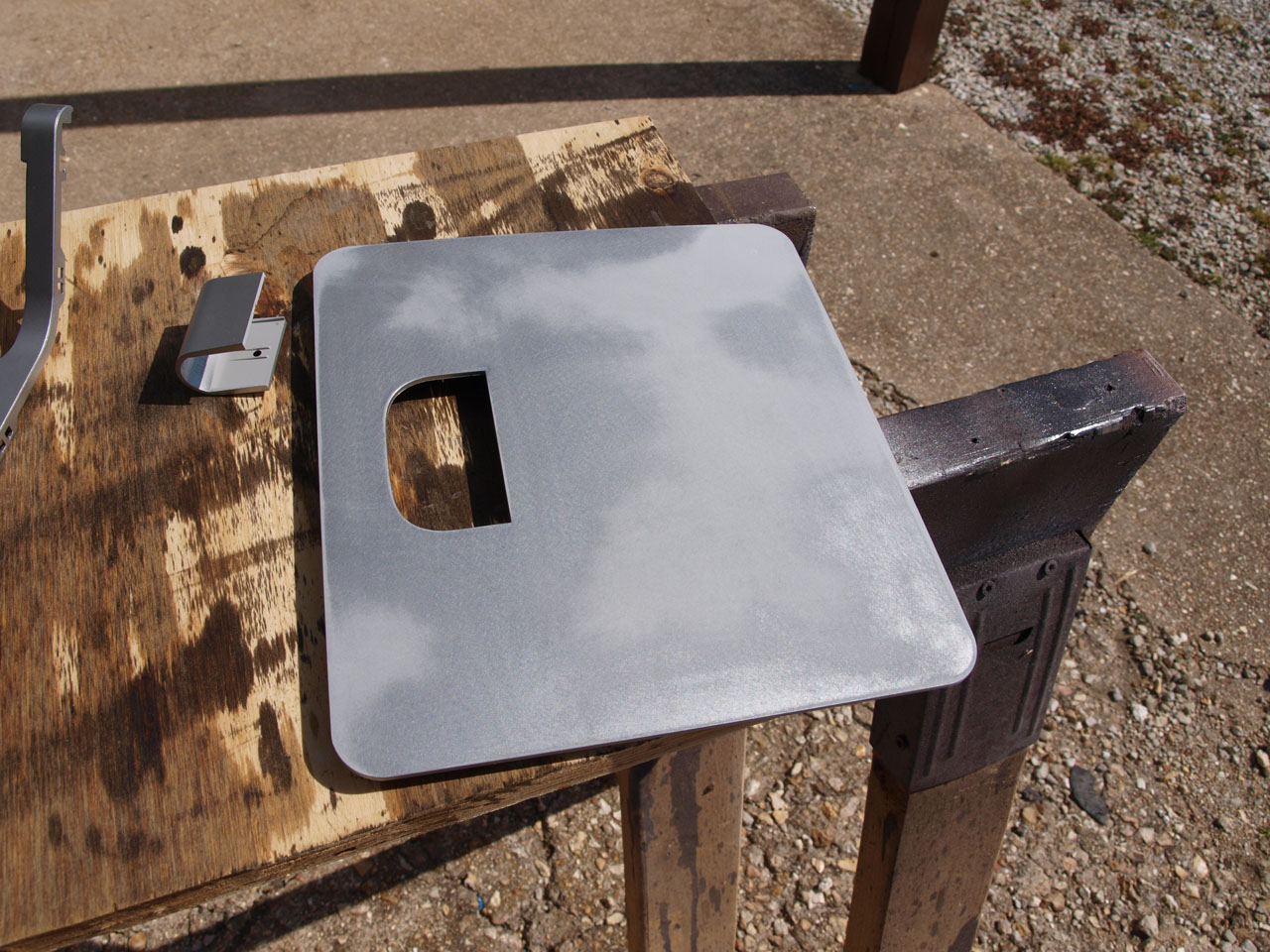

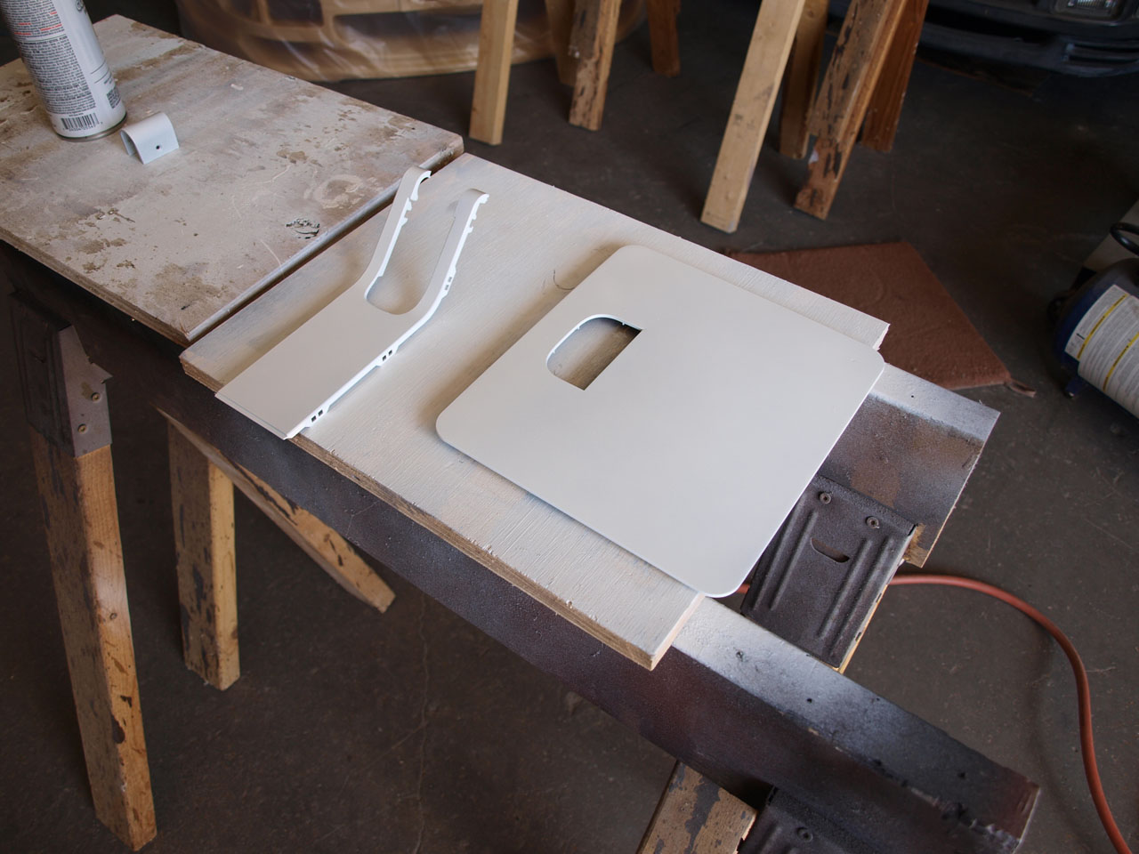

                        Ok pedestal paintjob done. Overall, it came out nice....but not without a flaw or two....but here we go!!
                        Base disassembled....once again!! heh..
                        I sanded out a few nicks & scratches.
                        This piece set aside, as it's not going to be white.
                        Inside seams shot.
                        Exposed surfaces shot...

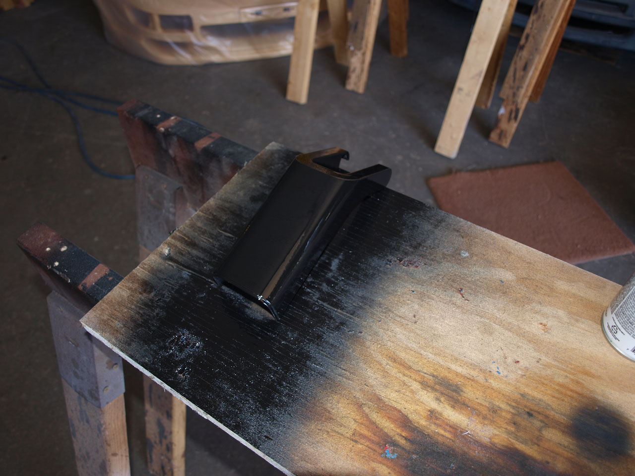

                        ...and the pedestal back, done in black....inside seams...
                        Exposed portion.
                        ...and done...allowing to set up...
                        A few hours passed and the parts were safe to handle...and reassembled.
                        The black for some reason didn't flow out very well...there were a few shrink marks and blurbs in it....you can see it in this pic...
                        Overall, not bad. The black part could have been a little better, but overall I'm happy with it. I do like the look. The white flowed out & settled fabulously & flawlessly....and since you look at it from the front, really all that matters... If nothing else, it's very one-of-a-kind now.

                          https://www.badcaps.net/forum/attach...1&d=1615242392
                          I like it.
                          Especially considering the rust bucket it was before, this is a darn fine job.
                          But really, the 2-tone blank-n-white paint seems to go quite well.
                          Meh, that's a very minor imperfection.
                          My luck with spray paint tends to be worse (though not always, of course.) That's one of the reasons I shy away from it. Also, I don't like spray painting, since I have to do it outside and that kind of sucks because...

                            I like it.
                            Thanks. Unlike some of my other weird builds, this one isn't arguable as to whether it was worth fixing it or not...unless you're a certain someone who's time is worth crazy amounts per hour. For ~2 working days effort, I'll make a buck on it. I don't have much in it dollar-wise (parts)....inspite of the improvisation due to the digitizer. Trashing this one would have been a horrible waste....not much besides the RAM and HDD would have been salvageable, and those by themselves wouldn't be worth much....but FWIW, the motherboards are worth ~$100-ish realistically. In the process of parts hunting, I found a seller that had some used ones with a $100 BIN, and he had sold quite a few.

                            Yea, I'm not sure what went wrong with the black...it was cool, but not cold....low humidity. It should have been ok....I'm a decent rattle-can painter...and the white came out stunning! Only one shrink mark after curing, and its tiny!

                              ...and this one is now complete...
                              This was the fastest shipping from China I've ever seen, the USB3 header arrived today.....so here we are, motherboard removed....again (I was getting real good at this)...
                              Soldered in....
                              I did have to trim those small tabs off the new slot, they interfered with the housing. It wasn't a big deal.
                              Slot works.
                              Now here's where it gets fun, and as mentioned earlier in the thread about repurposing that internal USB connection that used to run the touchscreen that has been removed.... Inspired from THIS POST, I found a complete boardset from a ET2203 that had a broken screen from ebay and it had the wireless keyboard/mouse controller....for pretty much the cost of shipping. It was originally intended for 'Project:PAT'.....but the rack cabinet and a different route because of it left this kb/mouse+receiver unassigned.
                              Then I found a brand new compatible keyboard & mouse:
                              ...but there was a problem...the plugs were same/compatible on both the Dell & Asus harnesses, but they were not wired & pinned out the same. The Dell pinout did not match the Asus harness at all. The Asus cable was a simple passthrough. The Dell OTOH did a weird crossover from one connector to the other.....so some voodoo had to be done. I chose to modify the Dell cable, as it was a little longer, and the Asus cable was potted with some kind of glue to prevent depinning it....so here we go!
                              Asus on the left, the way I had to wire the depinned Dell connector on the right.
                              Completed.
                              ...and the acid test...
                              Nothing went *poof* and I heard the 'new device' chime....and Winders detected it!
                              Married the new KB & Mouse to the receiver...they work.
                              Now to reassemble. I routed the cables in an existing trough and ziptied the receiver to some cabling....easy peasy.
                              Reassembled & done! Things are happy and this one is finished!!
                              This one was a mild challenge, but came out well and for not much money. When I sell it, I'll wipe S2K12 and doom it to it's native OS, W10.....but that'll be someone else's problem...but until then, I'll leave it as it currently is.
