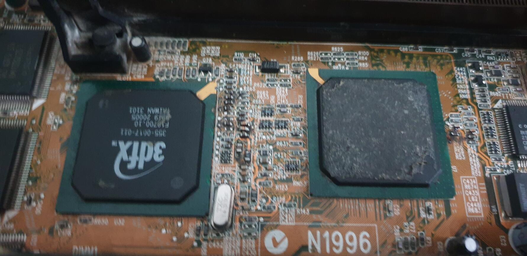

                      Technical difficulties on the seller's side (a friend of mine) with the KG7 so it may be delayed.
                      In the meantime, the MSI 6168 w/ the 440ZX chipset showed up. Clearly off the scrappers as the whole bunch of SMD resistors on the 3dfx chip's side were absolutely OBLITERATED .
                      Unfortunately, the pic I have is after I managed to rebuild the whole side of resistors.

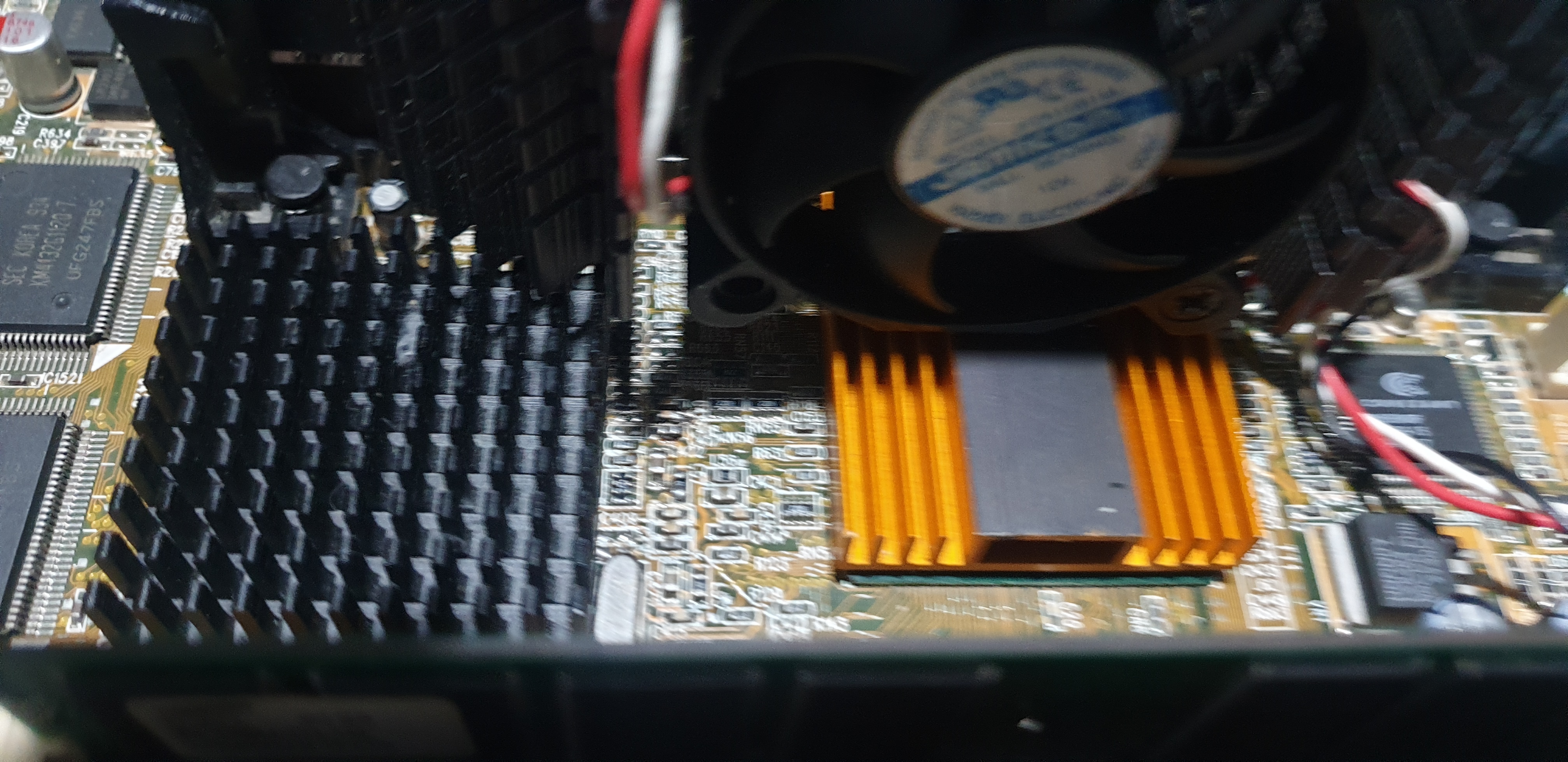

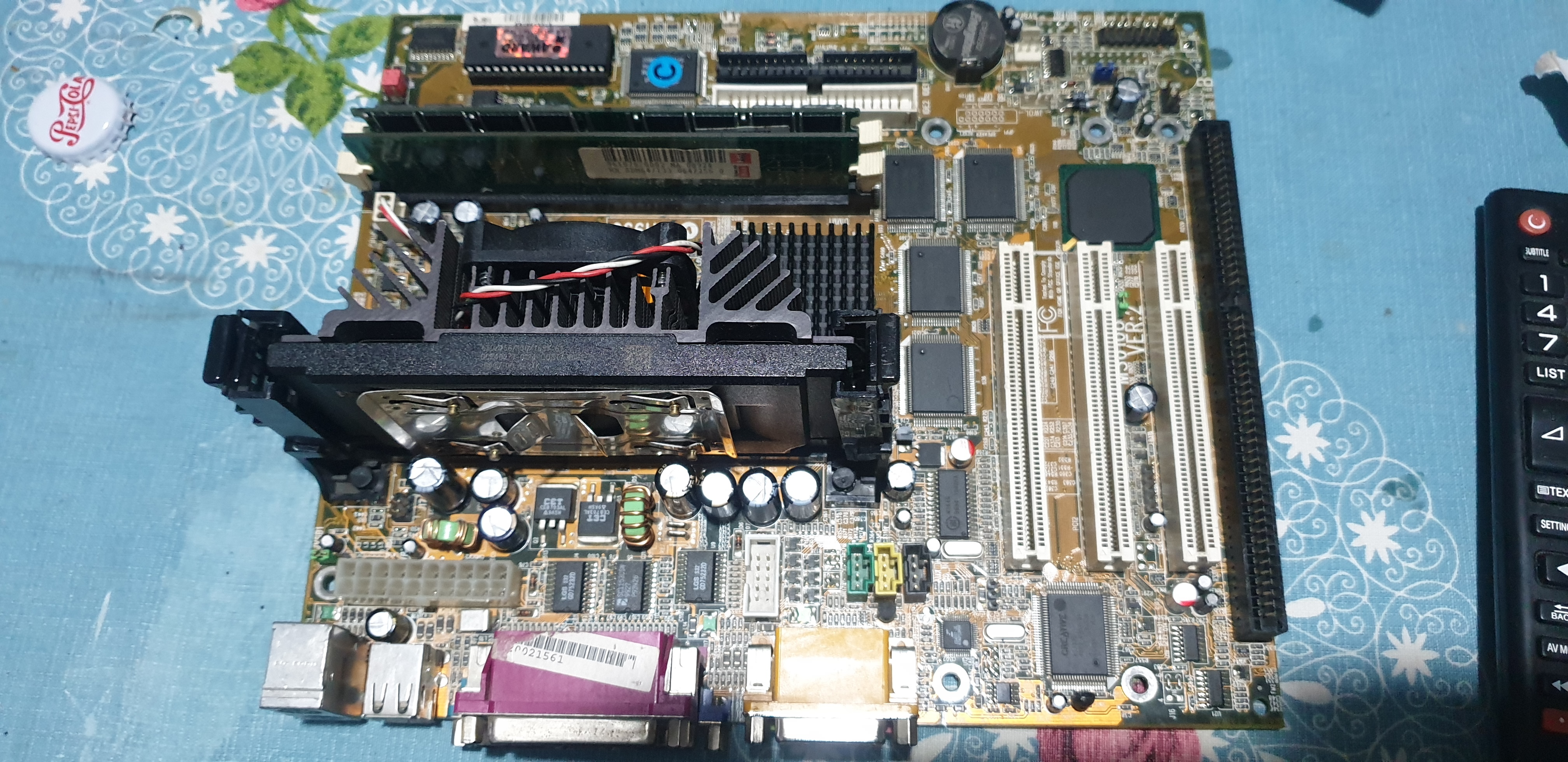

                      Finally, the "rebirth" of the Voodoo board

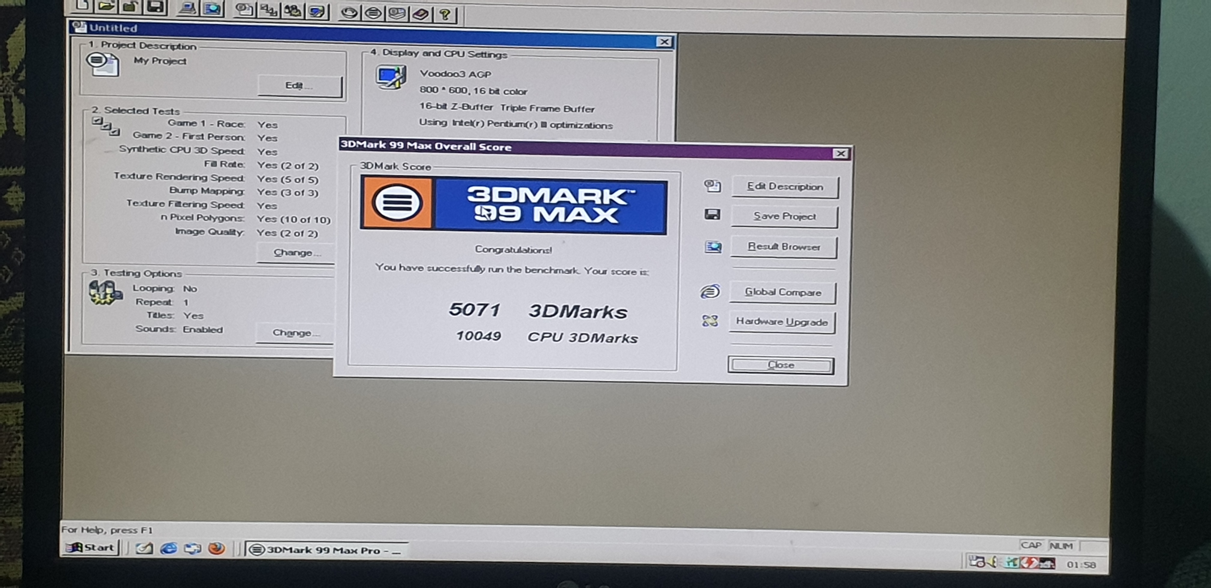

                      And a 3dmark99 score w/ the onboard V3 2000.

                                Some moar work on the beautiful MSI mobo from my previous post. I just wasn't happy using 16v 1500uF Rubies... so I switched to smaller 1500uG 6.3v Nichicon HN and a lone Panny FJ of same value to complete the count.
                                The MS-Industrial (Sun Pro) PSU you see was also recapped prior for a MSI 850 Pro5 build (with the AT styled Auxiliary connecto that ultimately fell flat due to the board's AGP being dead I'm in negotiations with two of my friends for Slot A board instead... but if anyone has an ABIT KA7 laying around they'd be willin' to part to, I'm open to offers. I ordered a Pluto Athlon @ 700MHz thay should be here next week... it's one of those monsters with TWO fans.
