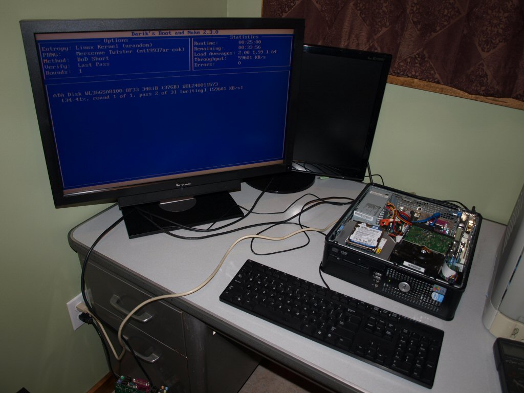

    Whats a good utility out there for obliterating data on a hard disk (sata) these days? I haven't had the need to do this since the SCSI days, and back then, I'd do a low-level format on them from the controller BIOS, which always did the trick....but that's not an option today apparently.
    The reason I ask, I'm cycling out a bunch of drives, and will be pretty much giving them away.....so it's rather obvious why I want to make sure all the data is destroyed.

    I formatted a bunch of IDE Seagate HDD (60+) using SeaTools from Seagate.
    80GB took 30-45 minutes to format.
    You could also try Active @ KillDisk free version. I think it might take longer to format each drive.

      DBAN if your hosting Personally identifiable info on the drives. Otherwise with the data densities of the newish disk just zero it out. dd if=/dev/zero of= /dev/ad0 with *BSD

        X2 on DBAN it's free and gives you several different wiping options.

            DBAN is what I've always used. It's good enough we were able to use it on government surplus computers no problem. Also free and supports doing massive amounts of drives at once (we had a system setup to hold 12 disks for wiping but there's no real limit).

                    MHDD!
                    But any other tool that can write a pattern from 0 to MAXLAB
                    will do the job.
                    http://hddscan.com/
                    http://hddguru.com/software/HDD-LLF-...l-Format-Tool/
                    http://www.majorgeeks.com/files/deta...r_windows.html
                    multiple passes are just a WASTE of time on modern (magnetic) disk,
                    if disk is healty a single pass will delete anything.
                    another option is internal secure erase, but is buggy on some disk.

                            That's just more nonsense. The Enhanced Secure Erase command is part of the ATA standard. It has nothing to do with Vendor Specific Commands. A freeware tool such as the following will do it for you:
                            http://cmrr.ucsd.edu/people/Hughes/secure-erase.html

                              Yup, either DBAN or the drives internal secure erase command.
                              The latter if support is better since it also will clear hidden HPA areas like reallocated sectors etc.
                              The tool fzabkar linked above can be quite fnicky with what hardware it likes to run on though.
                              Tools like the excellent HDAT2 will also allow secure erase to be performed, along with showing all SMART statistics and what more might be of interest.
                              Or HDPARM if you are on Linux...

                                Beware - When SECURE ERASE doesn't erase at all :
                                http://www.hddoracle.com/viewtopic.php?f=56&t=1412
                                More secure erase bugs ...
                                https://cdn.badcaps-static.com/pdfs/...79eb060c40.pdf
                                Remember that simply zero-filling a flash drive or SSD won't touch the over-provisioned area. Wear levelling moves your data around so you will be very dependent on the drive's secure erase function or cryptoerase, if your drive supports it. SED HDDs also support cryptoerase, which means that your data are instantly erased by discarding the security key.

                                    yup, dban works quite nicely. Thanks for the recommendation.
