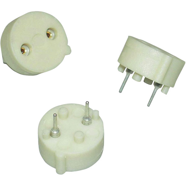

      You can use 2A 250V fuse in other from factor to test out the function first, this style of fuse can be found at Mouser or Digikey.

        I got a fuse and soldered two wires to where the fuse came from and attached the fuse to the wires with cables so I could replace it if it blew.
        There was no change in performance even with the new fuse. The fuse did not blow and you can see where the voltage is in the picture and it is slowly dropping.

          Re: Back-UPS RS 800 Not charging
          you could have just soldered in the correct fuseholder.
            Yeah I know that but I live by a small town and I was searching to just find the correct rating. This is just for testing.

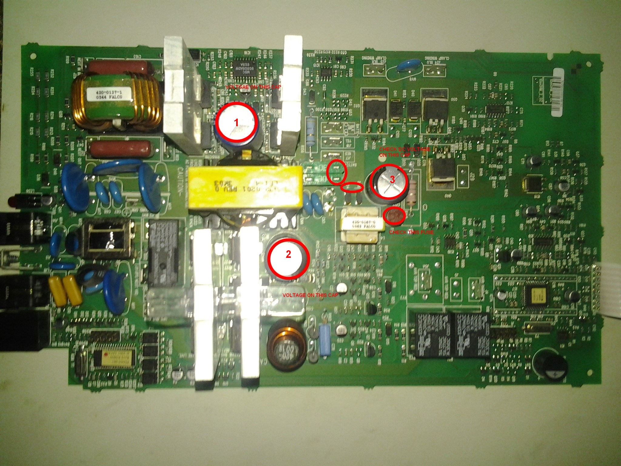

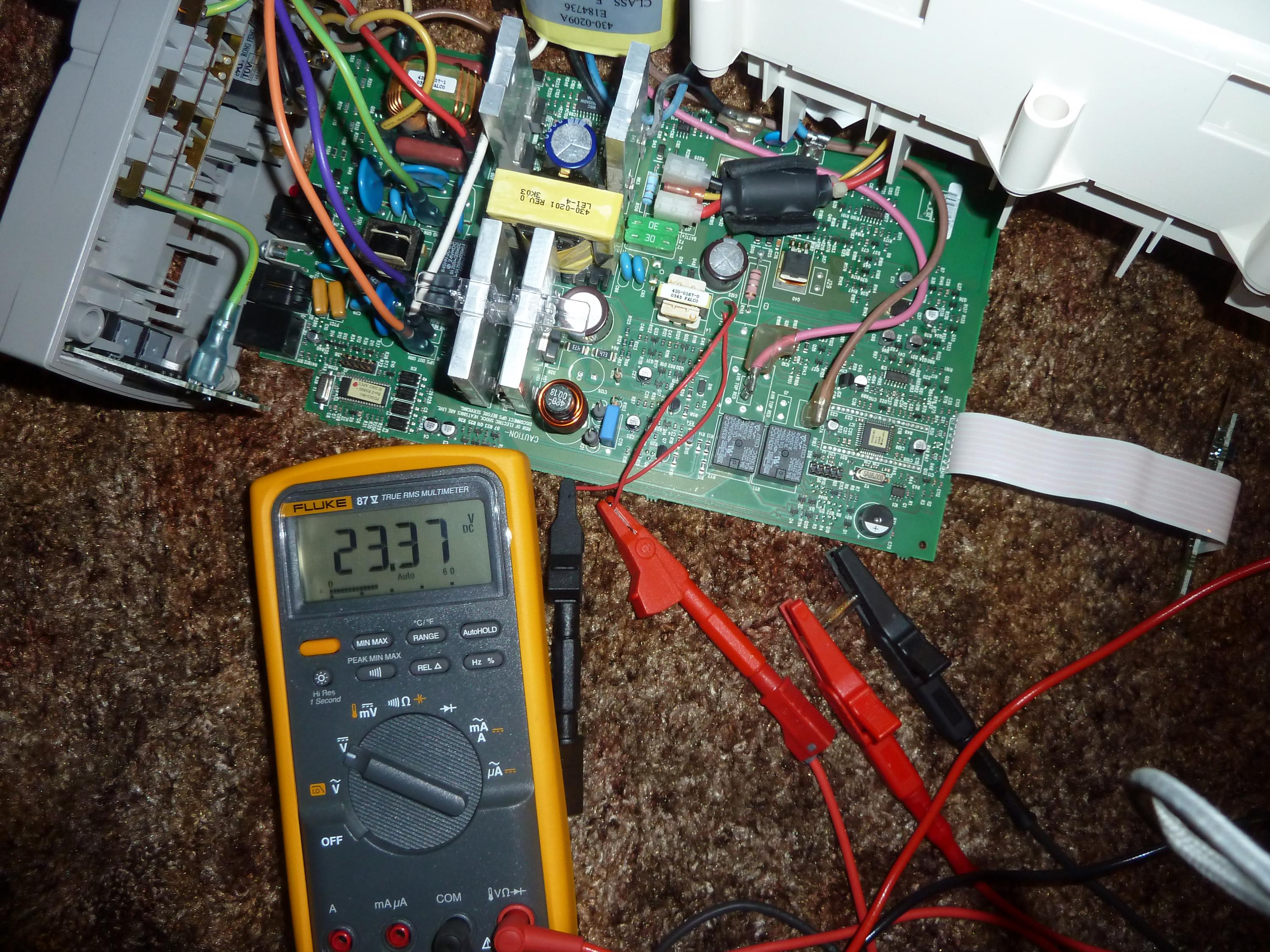

              So at what test point that you are showing the 23VDC? How about the voltage on cap #3 which has 1.1V on it.
                I have retested the voltages on the capacitors that you pointed out in this picture. All of the voltage tests were done with the replacement fuse connected while the board is on and connected to AC power. The batteries are also connected. These are the voltages I got from testing the two terminals on each capacitor with my multimeter set on DC volts.
                1 - 22 vdc
                2 - 6 vdc
                3 - 3.8 vdc
                It may also be worthwhile to add that the battery drops by 0.4 volts and starts dropping a considerably large amount faster if I disconnect the jumpers that are holding the fuse. The voltage also goes up about 0.4 volts and the speed of voltage drop also slows after I reconnect the fuse.
                  So far we do not see any 28~29V dc power source for charging the batteries yet, the highest one is the 22VDC, and we also do not get the charging voltage all the way to the fuses to charge the batteries either. This is not easy to trace out the connection.

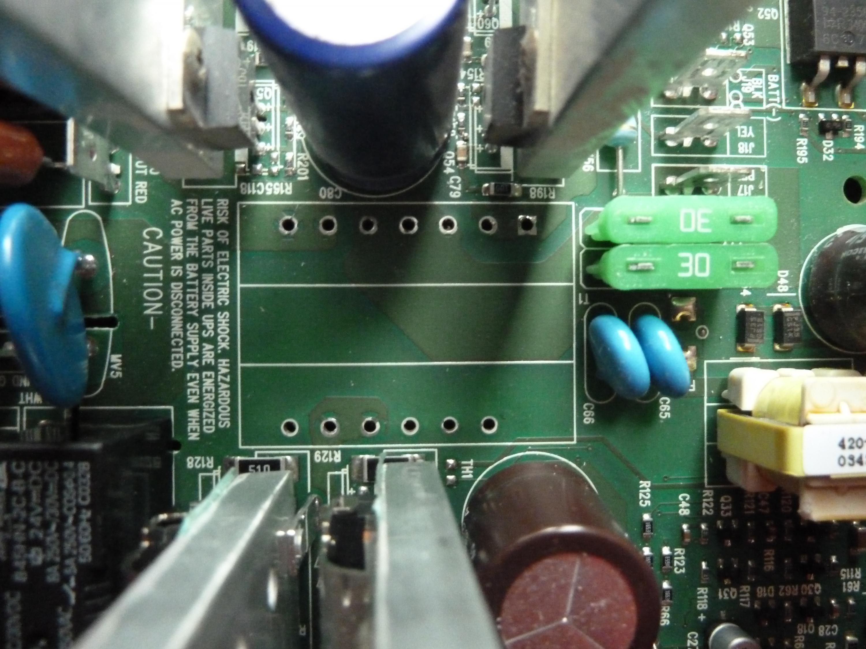

                    Would me removing the transformer and getting clear shots of the traces help at all?
                      I do not think so, what I need is to be able to see real closed up pictures that I can trace the connection from the two green fuses to see where it goes to. I look around at the computer recycling place and did not find any APC RS or CS 800, I found CS350, CS500 but the boards are not the same as yours. I will keep an eye for it.
                        What I need is to be able to see real close up pictures that I can trace the connection from the two green fuses to see where it goes to.
                        Well the traces go under the transformer and through the board to the other side so I will try my best to get some good pictures of the traces.
                          Well I fianally got the transformer removed and the main trace from the two fuses go straight to the large capacitor between the two heatsinks.
                          There are a few other small traces leading off to different places. If you need me to get pictures of those too let me know.
