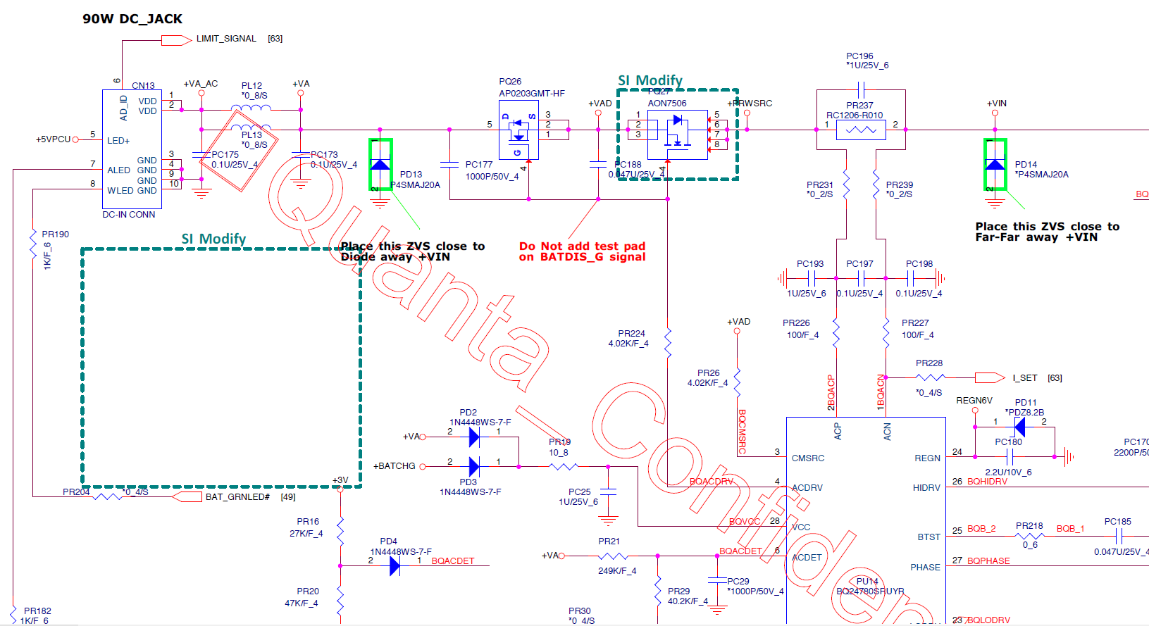

    See attached. This schematic may be the same / similar as your logic board. Found it on this website.
    Start with the meter in DC volts mode (30v or higher is OK). Red meter probe to the point to test. Black meter probe to ground.
    Measure the voltage to ground of each pin on the 2*DCin mosfets.
    So measure:
    source (1-2-3)
    gate (4)
    drain (5-6-7-8)
    for mosfets @ PQ26 and also PQ27. Each is a N-channel mosfet so the gate voltage must be higher than the voltage being passed between source / drain pins.
    So to enable these 2*DCin mosfets, the gate voltage = adapter voltage + REGN voltage from the charger IC = ~25 volts.
    If not, the mosfet and/or charger IC needs to be reviewed.
    Often, as per the above sticky by @Piernov, the 2nd DCin mosfet gets nuked. We can confirm the mosfet condition using resistance checks. NO POWER should be applied during resistance checks.

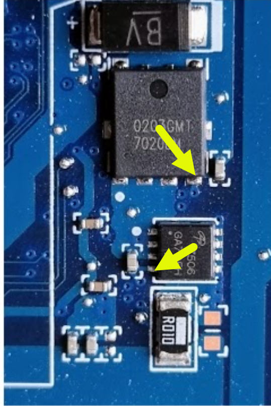

              See attached. Remove all power. Meter in resistance mode.
              Measure the resistance between the 2 yellow arrows to allow us to confirm that both of these mosfets are being driven by the common ACDRV voltage of the charger IC.
              Nearby should be the charger IC. Which one is on your board? Likely the 'BQ' series but share the full topside markings to continue the review.
              When you highlight pin #4 on the mosfet(s), the boardview should offer a local resistor of ~4k in resistance. The OTHER side of this 4k resistor will identify the charger IC and the pin should be the ACDRV pin. This pin is required to output the ~25 volts to enable these mosfets.

                Re: HP Probook 470 G4 - Power and Charging Problem
                Thank you for the picture and the datasheets. I've unplugged the charger and checked resistance between the two yellow arrows that you indicated. The resistance does seem to jump around a bit, but reads anywhere between around 6 Ohms and 21 Ohms, sometimes stays steady, other times moves around, so could be my probes possibly. I assume we are just looking for continuity on this check so that should confirm ok.
                Using the boardview, I identified the resister that you mention, which does indeed measure ~4k - it's PR224 and the OTHER side of this resistor does indeed connect to pin 4 of the charger IC which is the BQACDRV pin. The charger IC has reference BQ 24780S TI 741 AT4J
