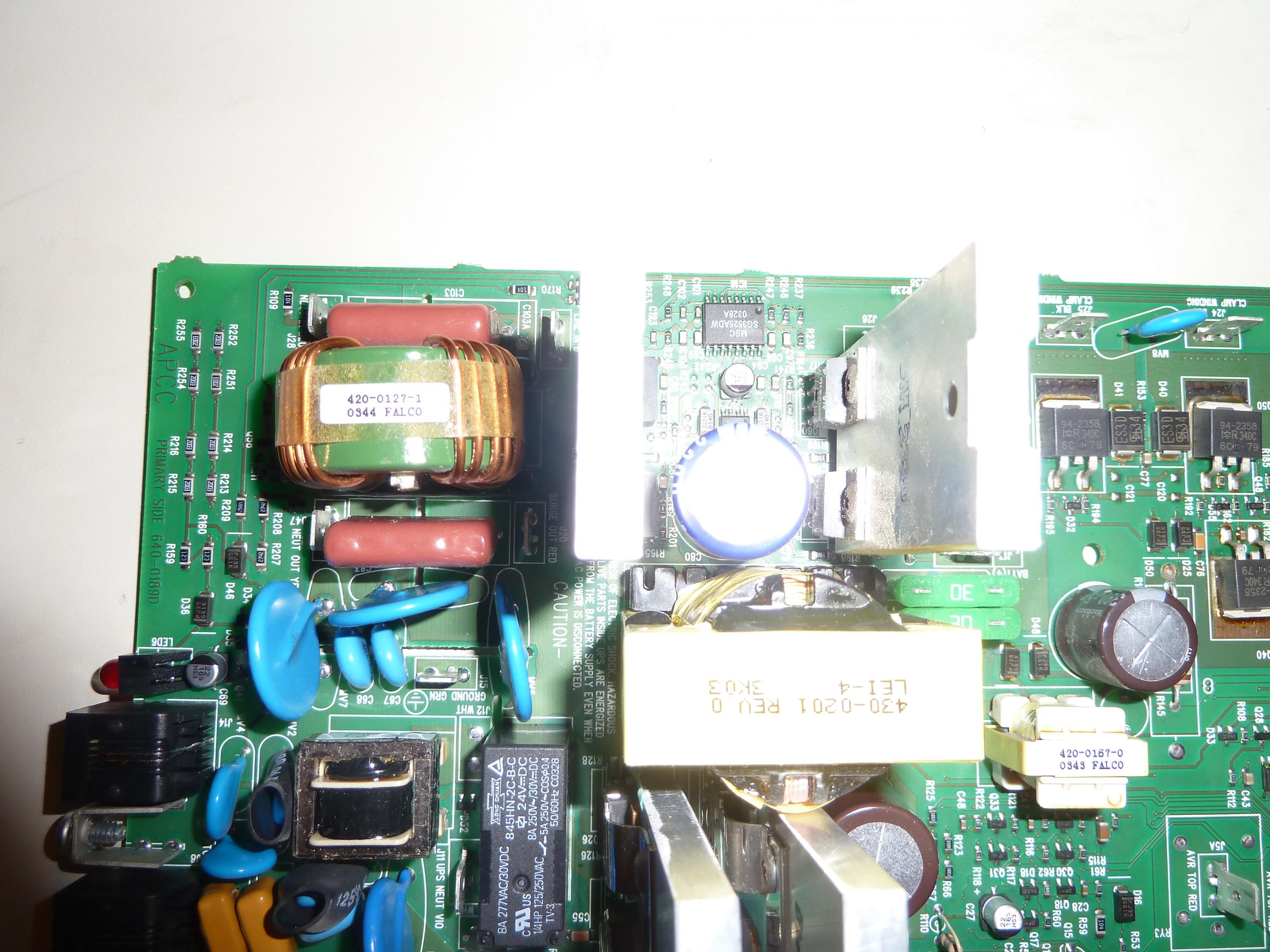

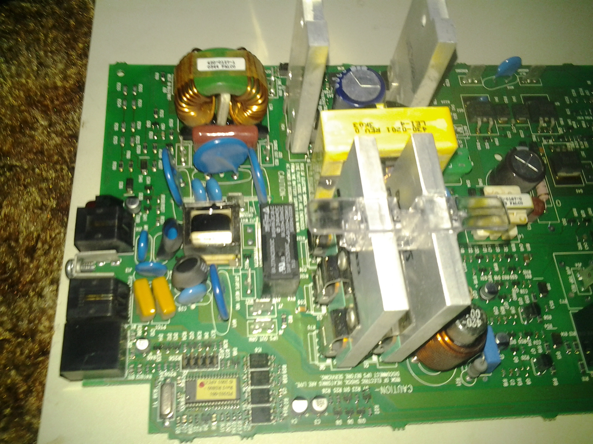

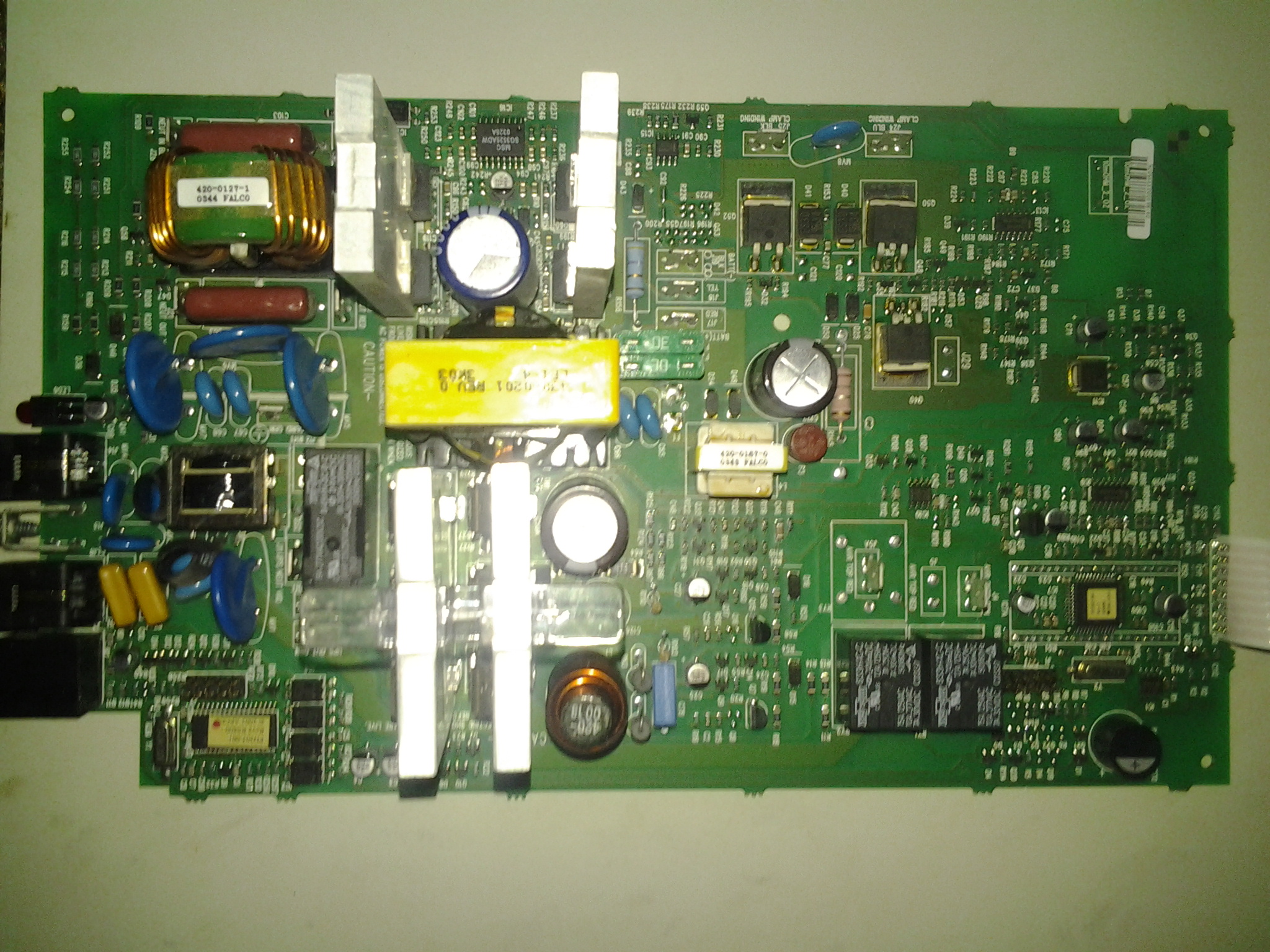

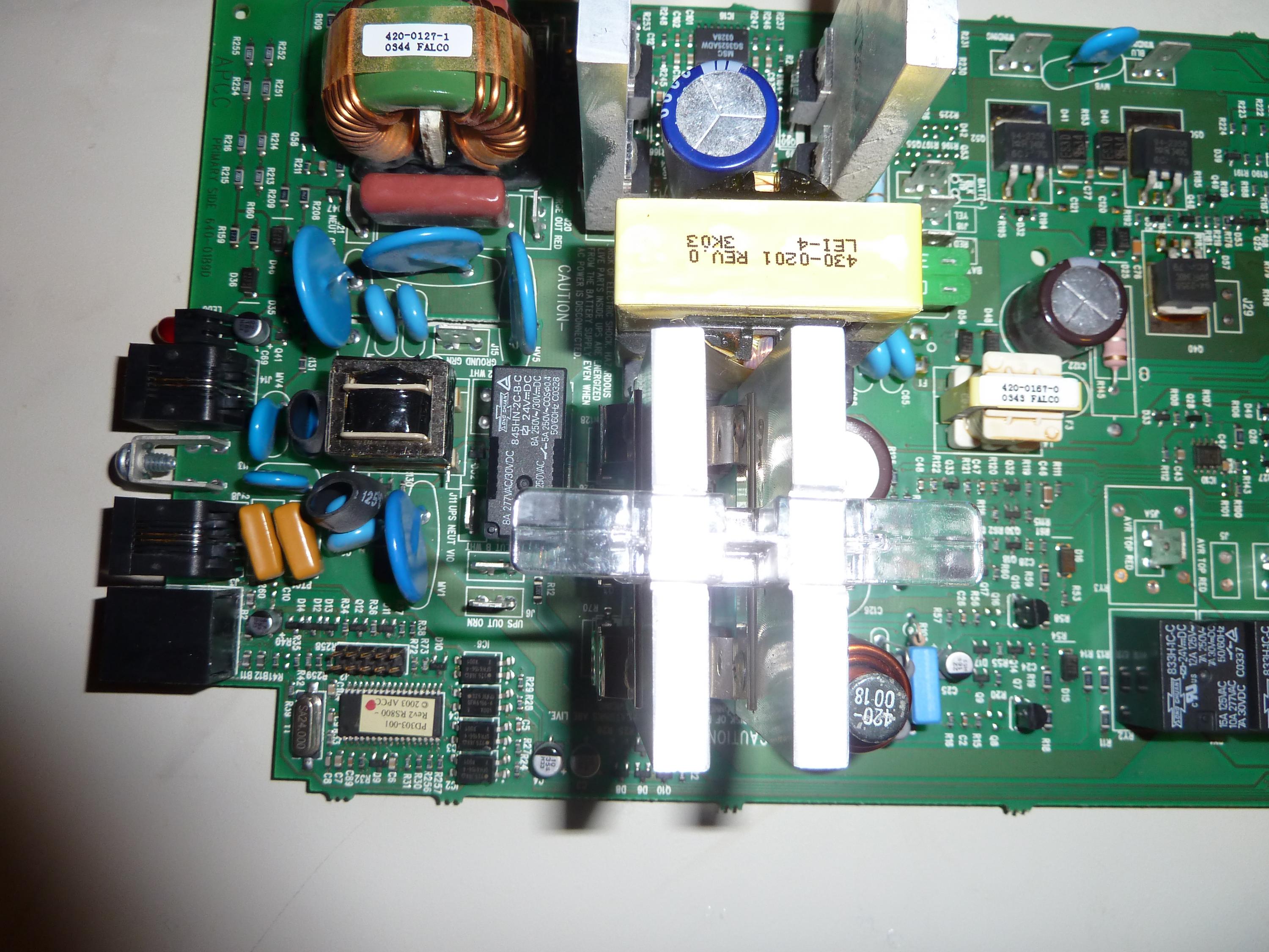

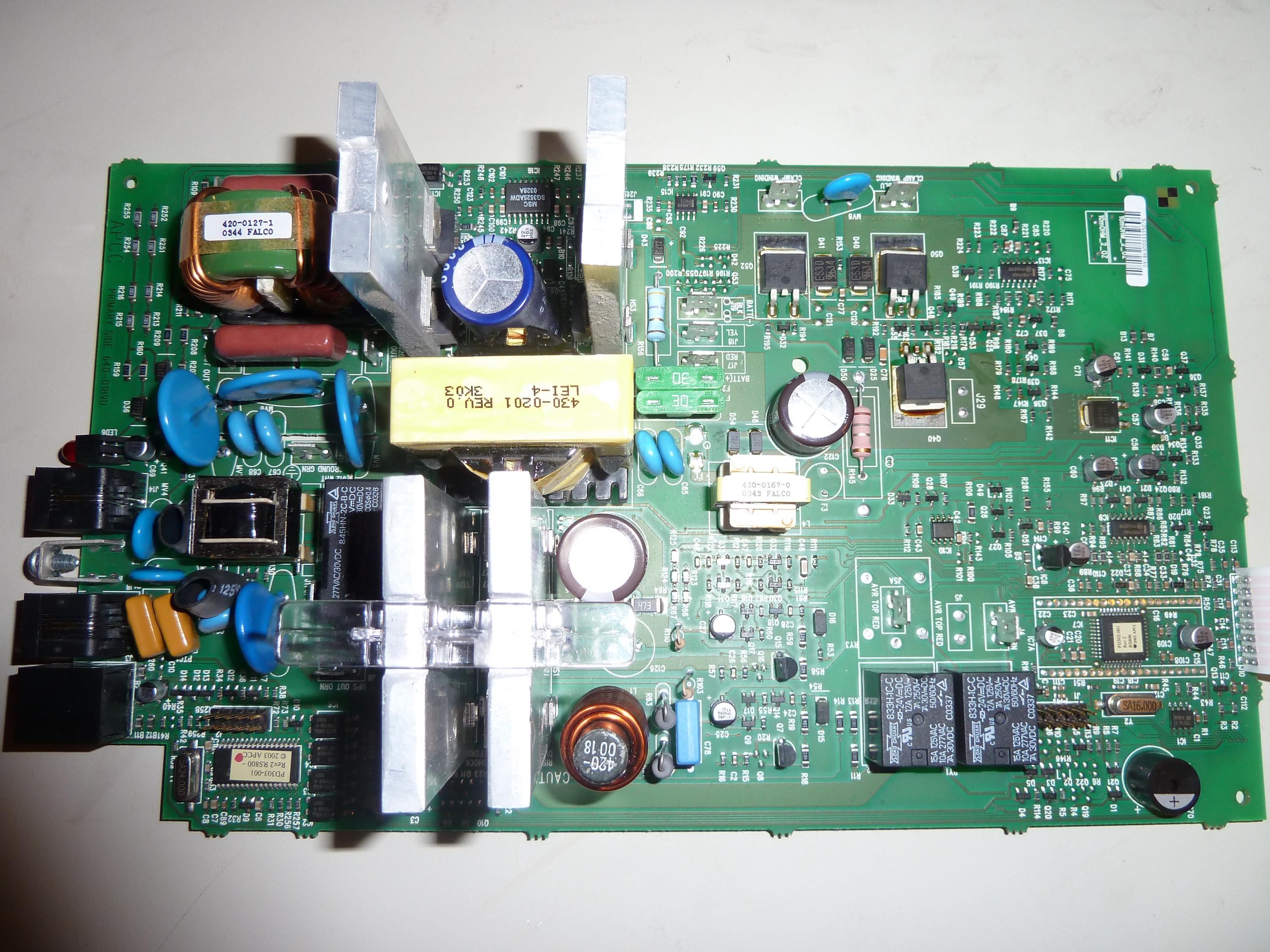

      Re: Back-UPS RS 800 Not charging
      Here are the pictures of the board. Let me know if you need close ups of any particular part of the board.
        SMD caps - bastards!
        i hate those things!!
            no idea, but i do have a trick.
            heat each pin/pad with yur iron - if it smells like catpiss then it's leaked.

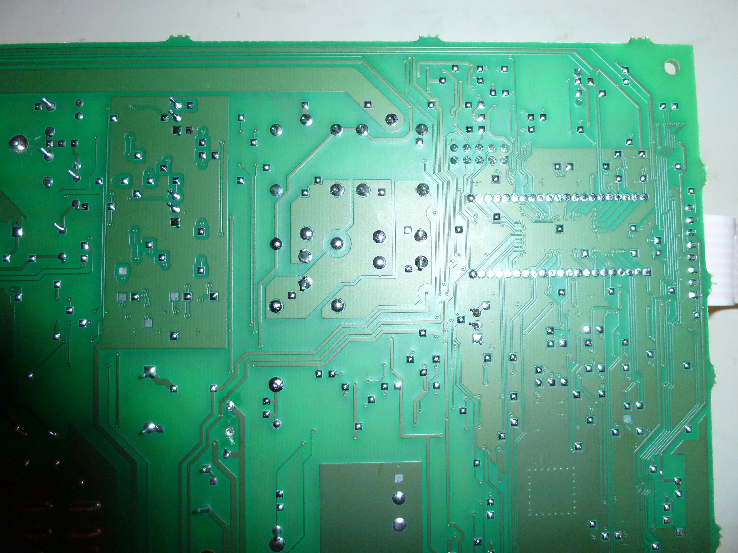

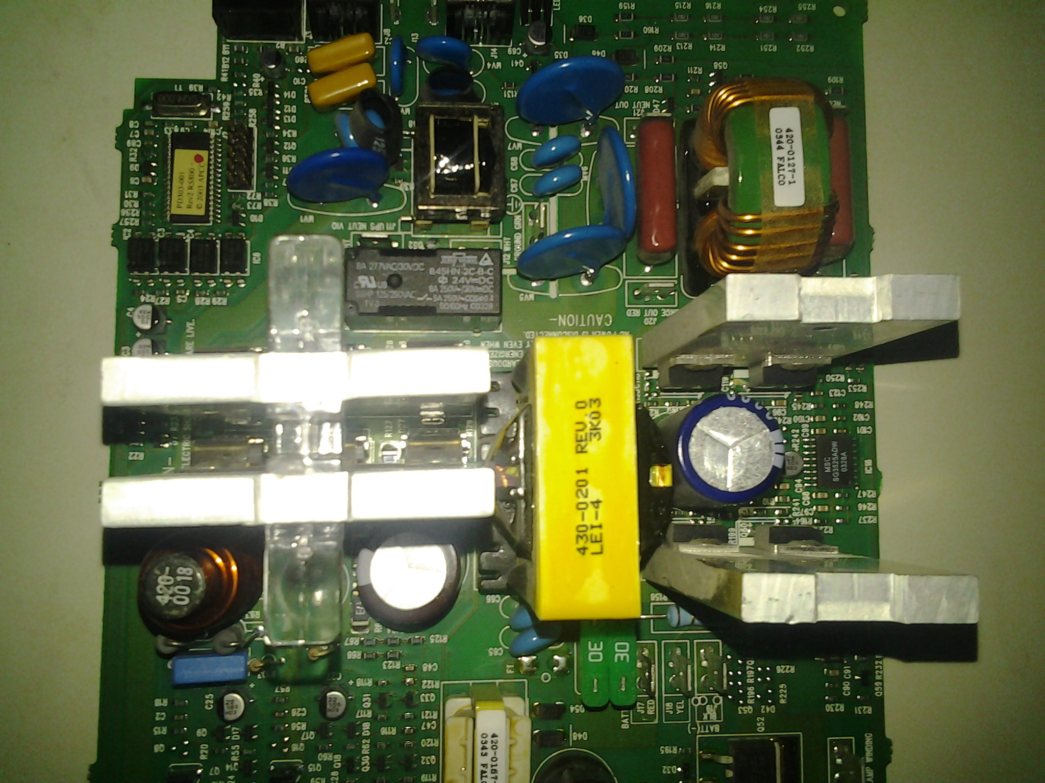

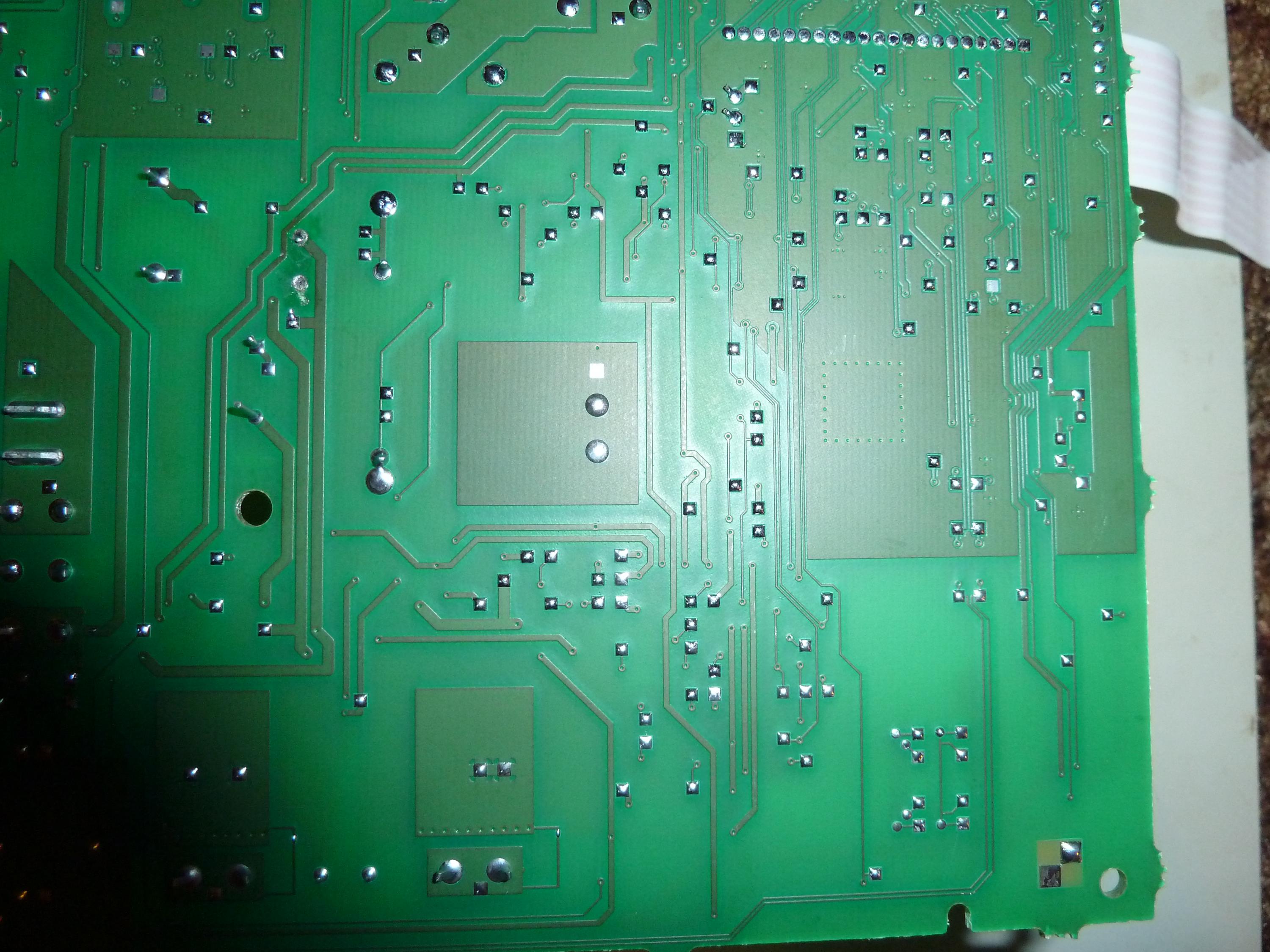

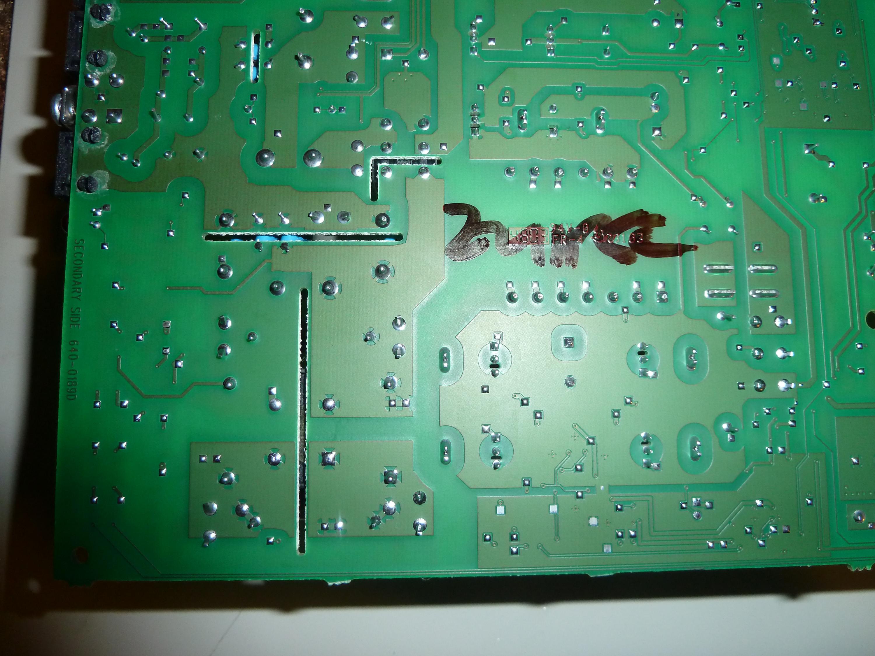

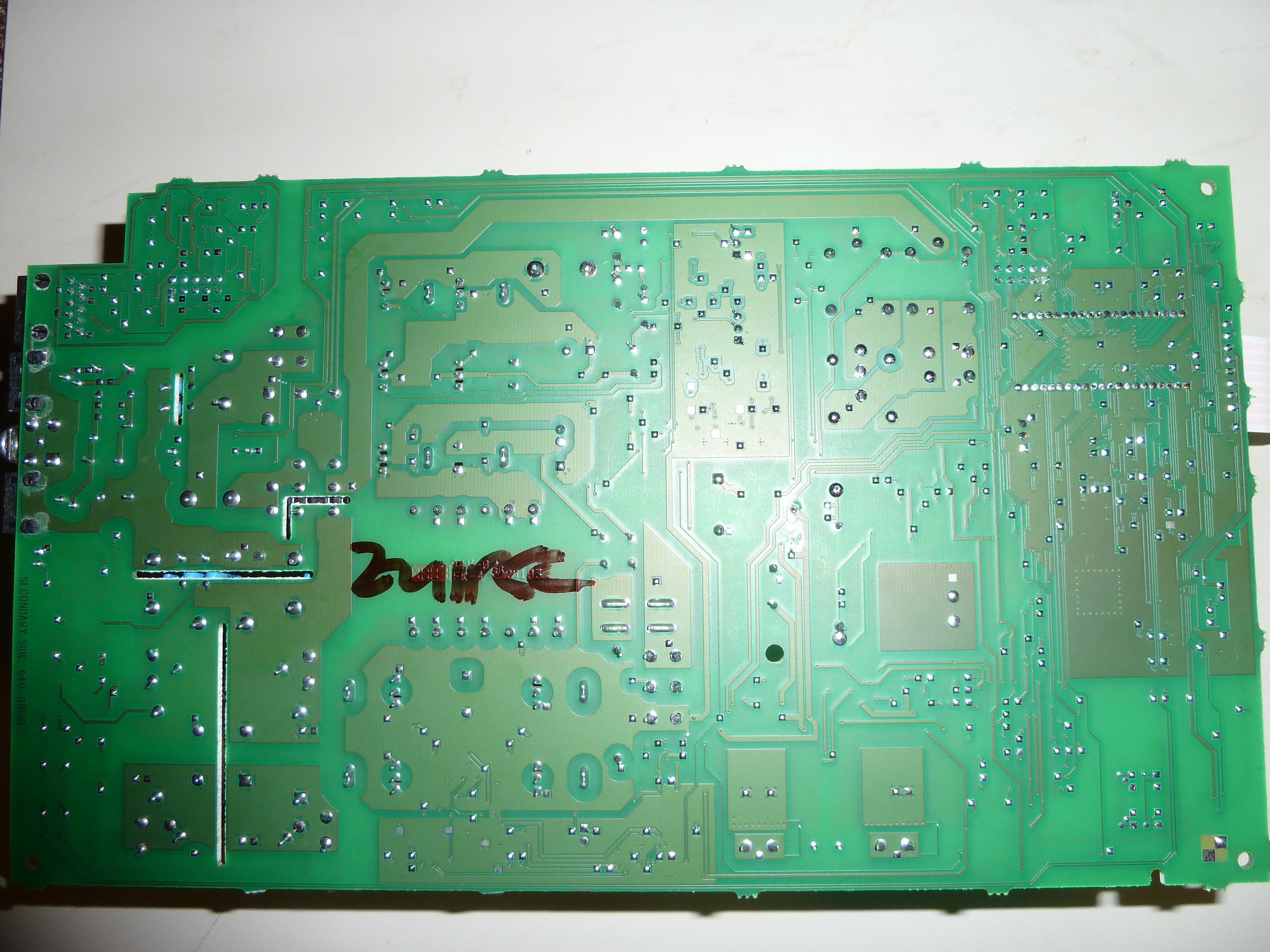

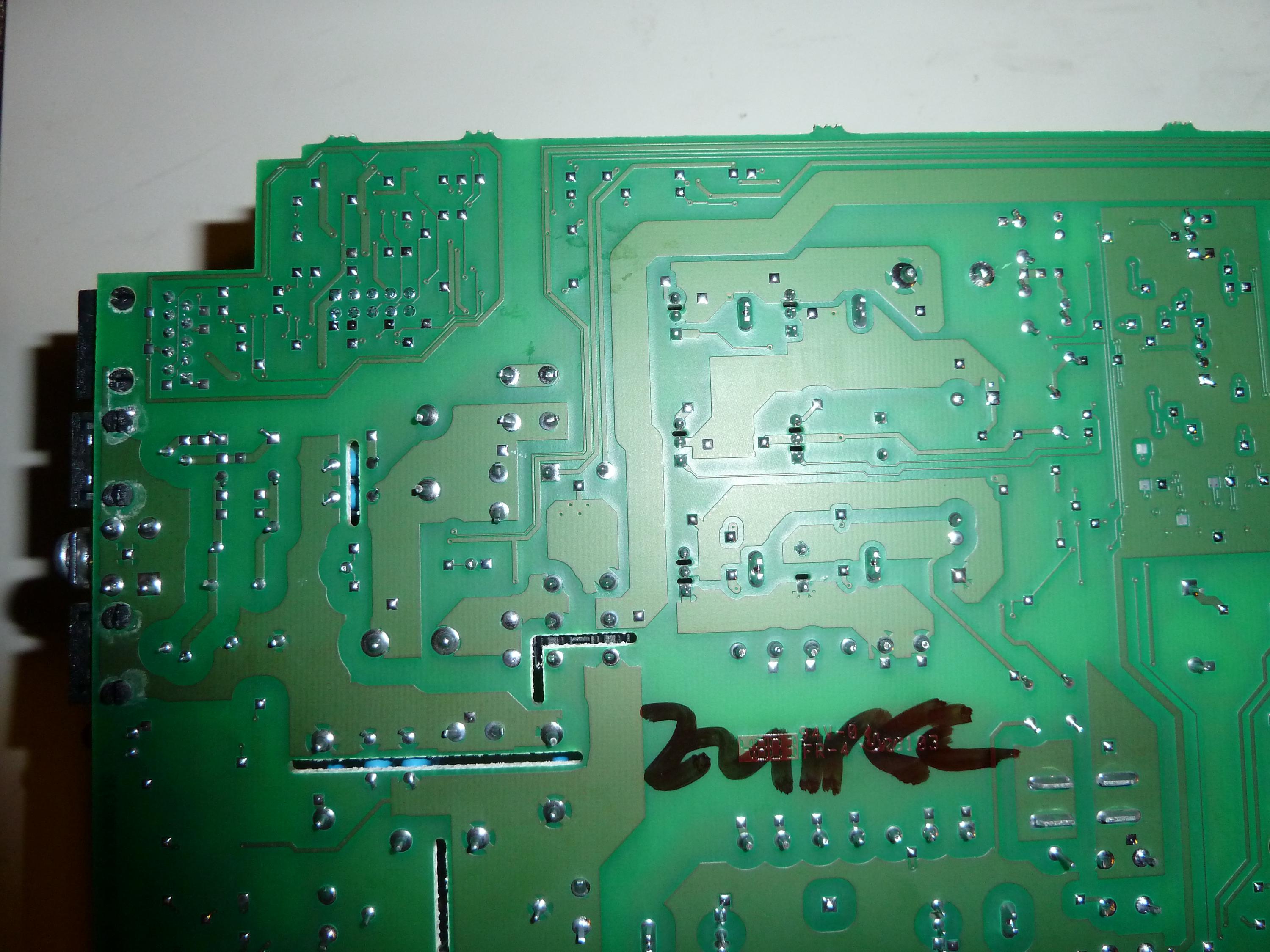

                      Can you please get better focus pictures, I also need the pictures of the bottom side of the board. Check the red fuse and voltages on those caps.
                      BTW, does it use two 12V batteries? From the spec it looks like just one 12V battery. And those two 30A green fuses are good, right?

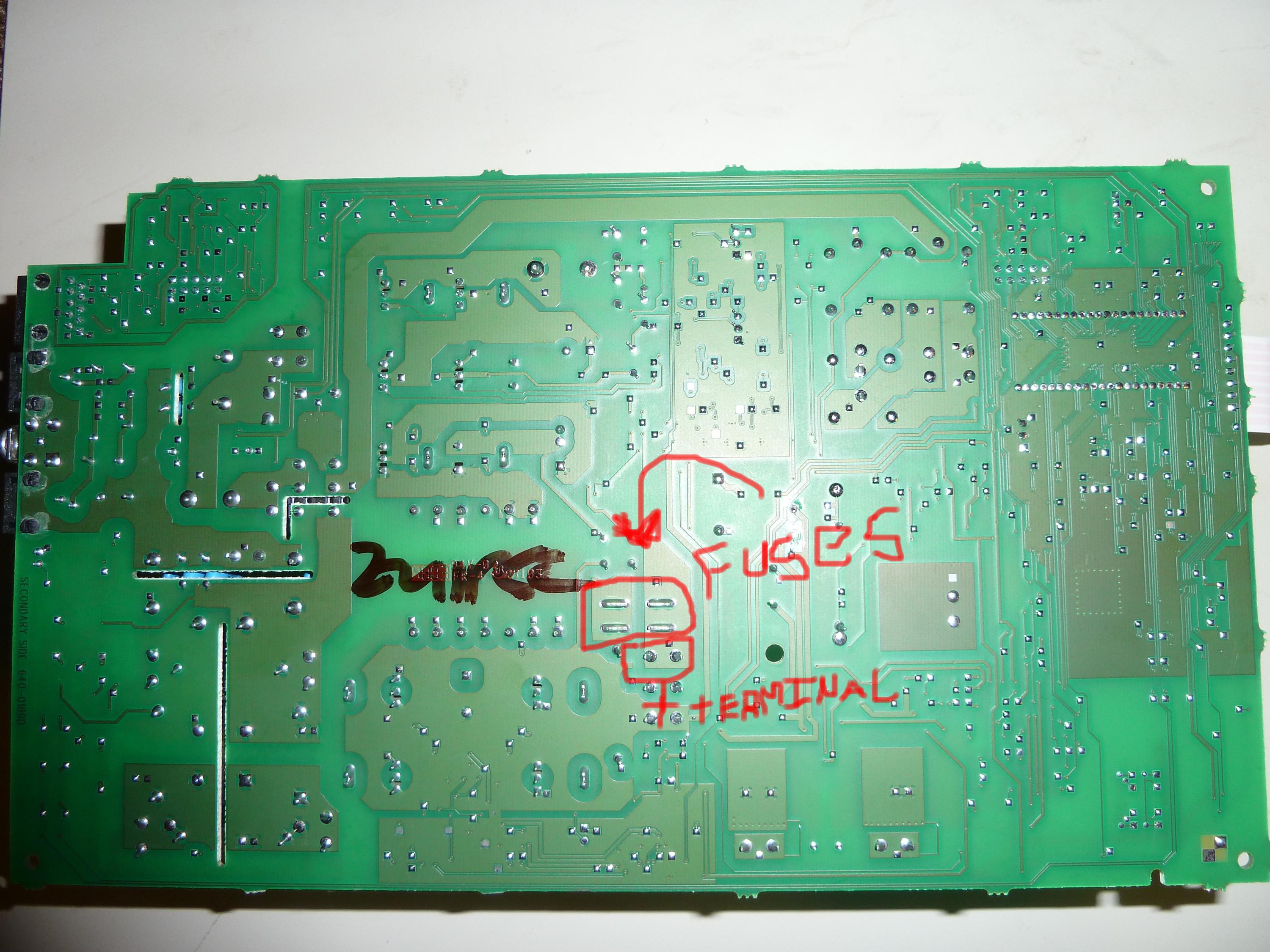

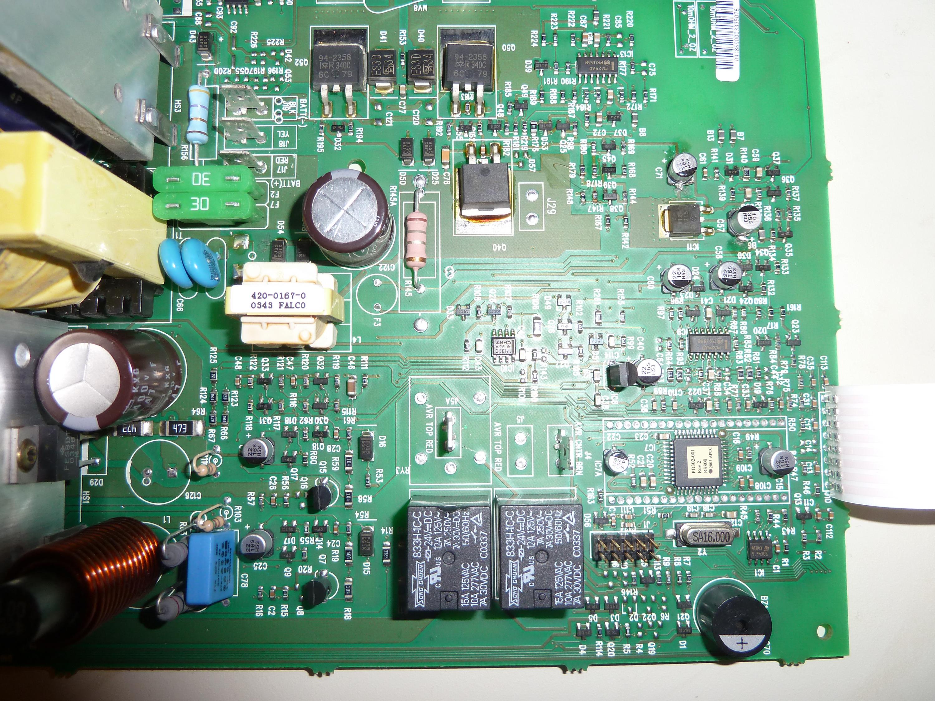

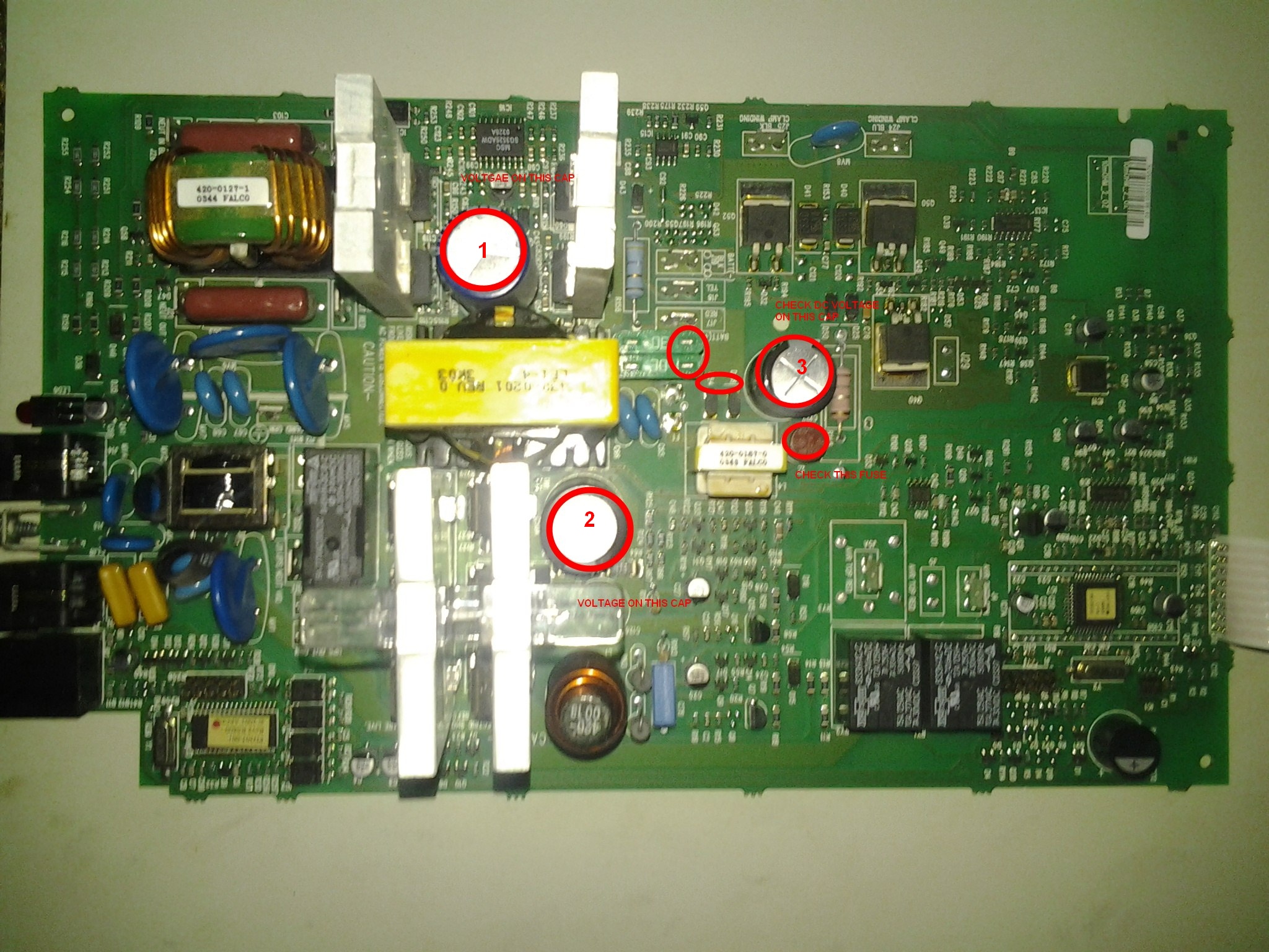

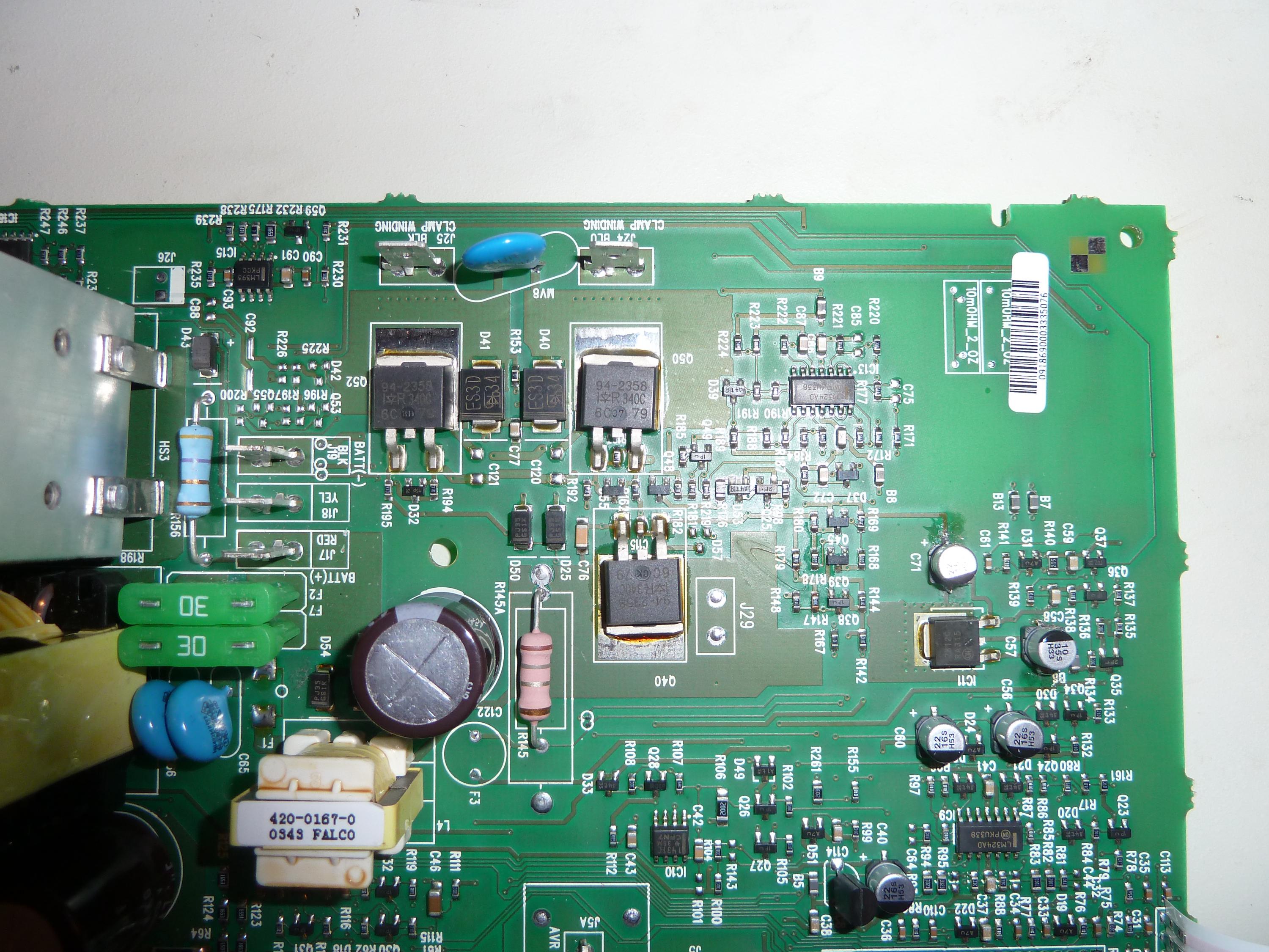

                        Here are the voltages of the three caps with the board running and one lead on each cap terminal.
                        1 - 23 vdc
                        2 - 5.8 vdc
                        3 - 1.1 vdc
                        The green beaver tooth fuses are also good. The round brown f3 was blown. I removed it from the board to be certan.
                        I am very sorry about the pics. Both of my good camera's were slightly knocked off a table. I hope these are better. If you need a picture of a very certain trace or something I will try my best.
                        And why were the ends of 2 doides to the right of the green fuses circled?
                        And the battey pack is 2 SLA's in series but they had shorted cells so now I just have some junker batteries with alligator clips on them
                          I believe that fuse is for powering the SMPS for that small yellow transformer (not 100% sure), the secondary side winding of that transformer is connected to those two diode and that #3 filter cap. So there may shorted circuit in that area.
                              It can be that the fuse may have blown due to in rush current. What is the value of that fuse?
                              BTW, that yellow transformer is actually an inductor, L4.
                              Those two green fuses, one end is connected to the + of the batteries, the other end of the fuses should be connected to charging circuit, you will have to trace that connection out, it should be connected to the Cathode of the blocking (or rectifier diode of the charging circuit) diode of the charging circuit.

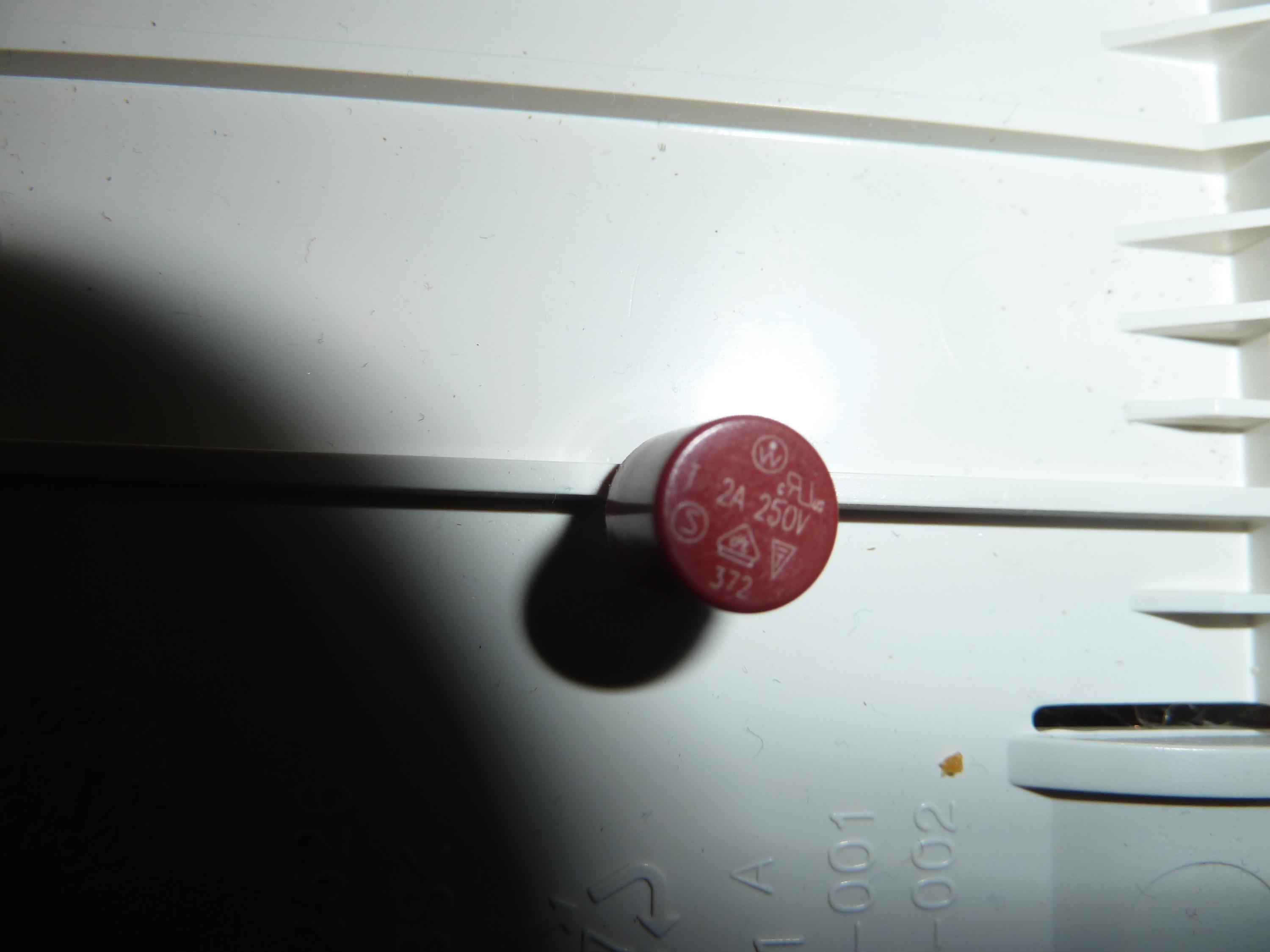

                                Here is a picture of the fuse.
                                The rest was about as clar as mud to me
                                Both fuses are connected to the + battery terminal and from what I see they are connected to the 2 blue capacitors beside them. It looks loke the trace goes under the big transformer but I can't see where it goes. If it is nesicary I can take the transformer off and see where the traces go.
                                  That is 2A 250V rating fuse. I am not sure yet as to where the charger circuit is, some of them use the SMPS for charging circuit, some of them use one of the winding on the inverter transformer (the transformer that is used for converting the switching 24VDC to 120VAC). I would try another fuse to see what happen, normally we would have used Ohm meter to check the resistance of each leg of the fuse (since we do not know which end of the fuse is the feeding side) to circuit ground, but we do not even know at this point which ground point is.
                                        So why is this fuse in such an odd formation? I haven't some across many fuses like this before.
                                        Would I be able to replace it with a "beaver tooth" fuse or one of those common cylindrical fuses to test the circuit?
