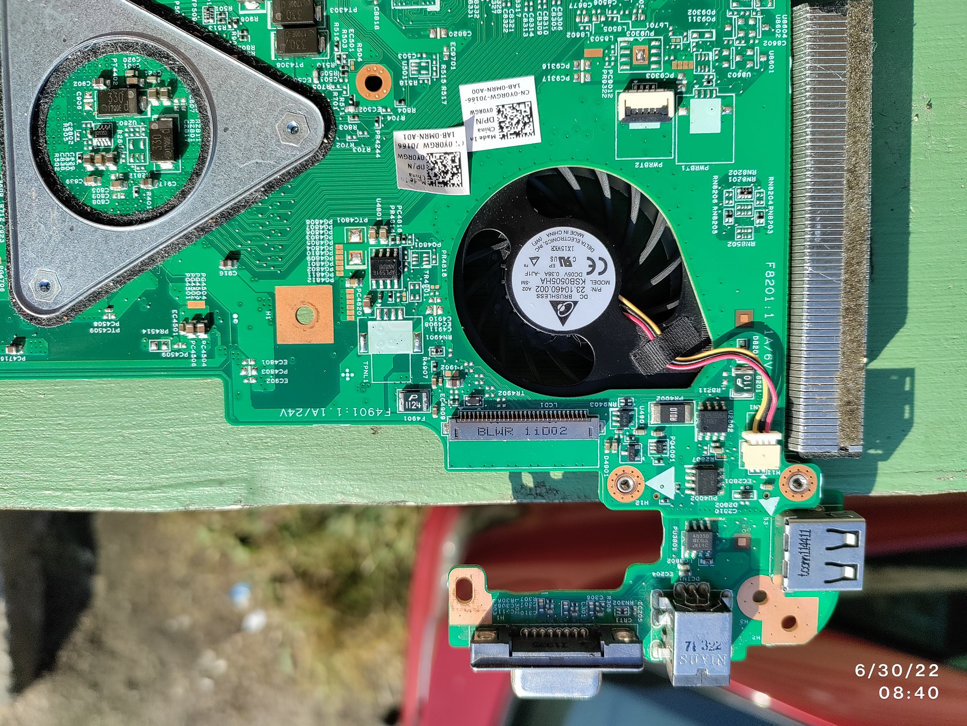

Dell Vostro 3550 (v A01 with BQ24707) Plugged in, Not Charging
  • Thomasraud
    • Jun 2022
    • 6
    • Estonia
    i have similar problem as https://www.badcaps.net/forum/showthread.php?t=37828
    QUOTED
    -It works on charger (without battery connected-only charger)
    -It works on battery (without charger connected-only battery)
    -& it also works when plugged in battery & charger, but it's not charging the battery

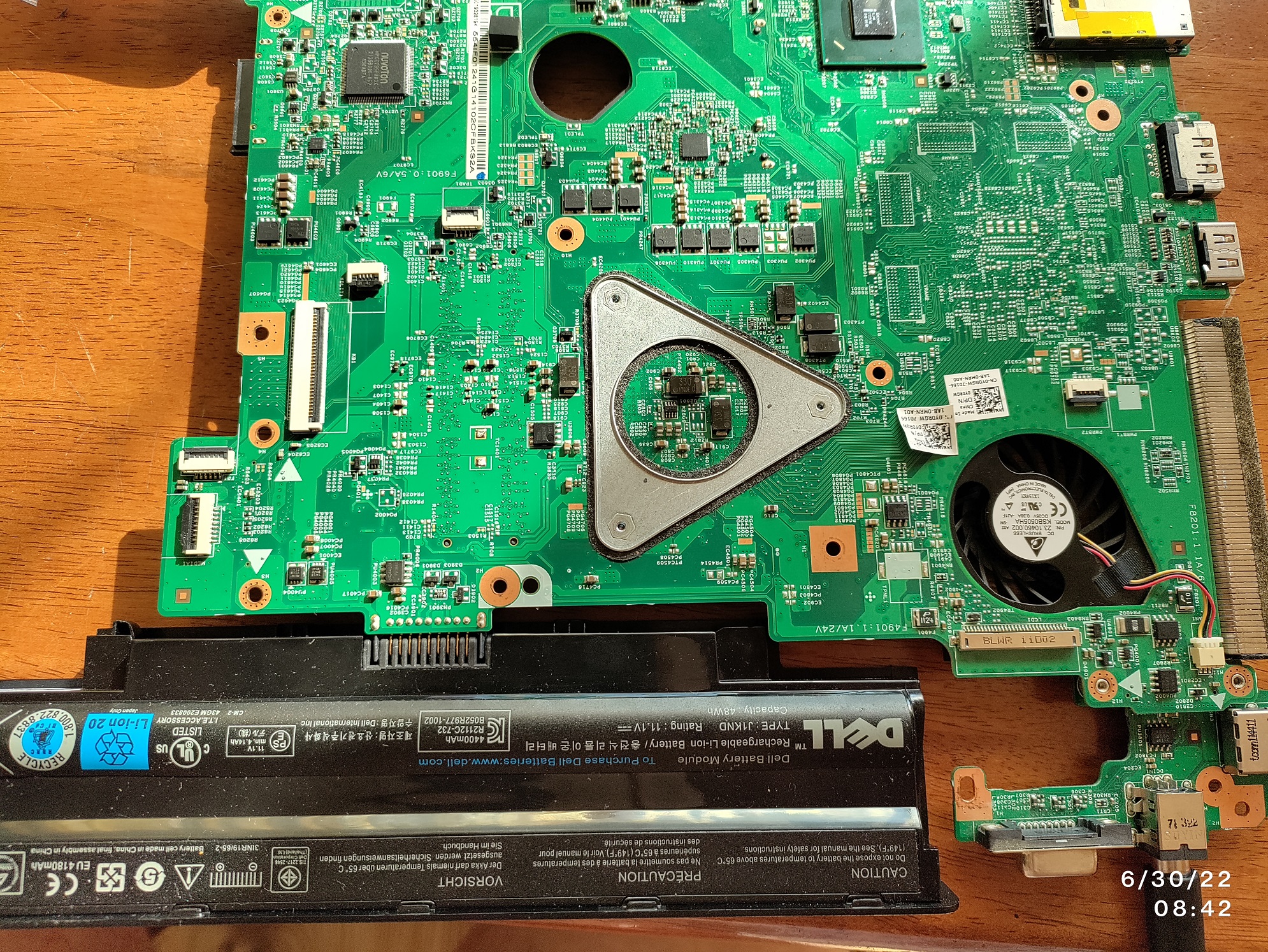

    Story untill today:
    Long long time ago.. around 6+years ago, this device got covered coffee and device had "insurance", motherboard got replaced, nobody tested charger... device worked fine untill randomly one day anomalies started...
    Laptop/Notebook (however we call that machine/device) is (actually was) working fine. One day i noticed [Battery 0] start giving Not charging errors. So.. based on math, the battery was 6+years old and mainly device was used as "desktop PC" charger always connected. And the day when i needed device in other places with powered ON, i removed charger and it died immediately (Battery was empty).
    Based on information i assumed, battery is old and need replace, so i did. I ordered [BATTERY 1] Green CELL (pro) J1KND battery (7800mAh/86Wh - BatteryMon measured based on charging, its 9000mAh+ and 100Wh+ and designed data is 9600mAh/106Wh), connected it to device and it start charging.. 40% somthing untill 87.7% (im using BatteryBar v3.6.6 and BatteryMon v2.1 B1010).
    And then chargin stopped - i didnt know that (i checked log file and noticed that later).
    Based on chargin indicator LED i assumed, battery is full and...
    So, to get best knowlege how well that battery is performing i started FULL scale battery test (CPU 100%, GPU 100% and no AC connected).
    3h30minutes later i got "Battery is below 10%, connect AC" message and test stoped. - bit later when battery "calibrate and reconsentrate" it showed 6.2% discharge left!
    I connected charger and ... nothing.. no charging (Message: Battery plugged in, not charging).
    So i did "12+ DIY FIX" first 11 points and then bought another battery [BATTERY 2] and started all over again for testing, why its not charging.
    BATTERY 0. DELL OEM.. yeah its dead, output is 2.85V (same as charging voltage)
    BATTERY 1. GreenCell PRO N4010
    BATTERY 2. DELL "original" im not sure is it OEM.

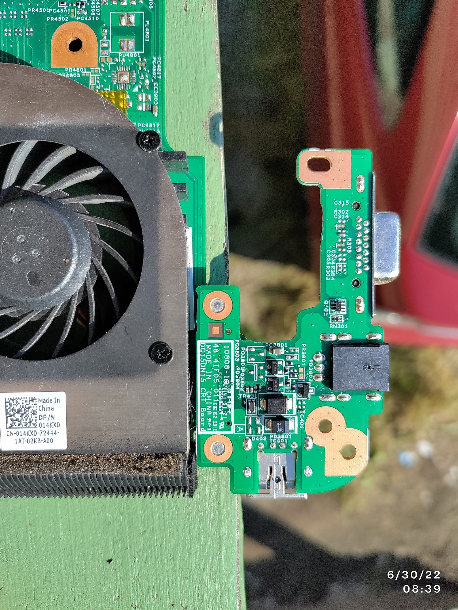

    And now im out of ideas, where to look (btw i dont have dell vostro 3550
    schematic, universal N4010,5100 etc schematic is guide, but does not help much. I dont know what values i have to measure or not. And Also, my dell revision is A01, there is replaced charging IC for more compact one..
    Im not expert, so i have multimeter (3 different) soldering irons (5 total), hotgun, other basic tools (tweezers etc..), but no
    oscilloscope, fancy magnified camera, flir camera.. etc...
    And also, im not good in electronics, i like to learn, but if i dont understand, then its not learning why and how its doing, hatever it should do, but if you only learn to replace parts, then its not learning to fix it, but learning to fix that problem.
    Im out of ideas what and where to look. Point me, if i missed something. For just to throw parts on it, is not viable solution. i really want to understand what it should do and how its working.

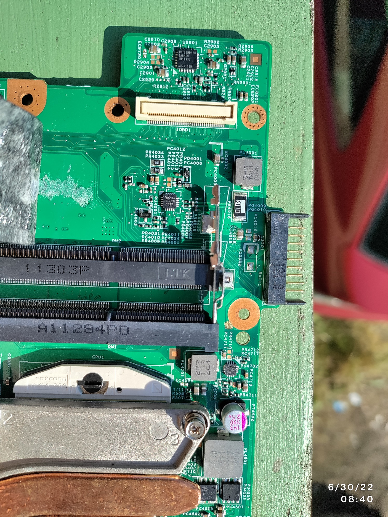

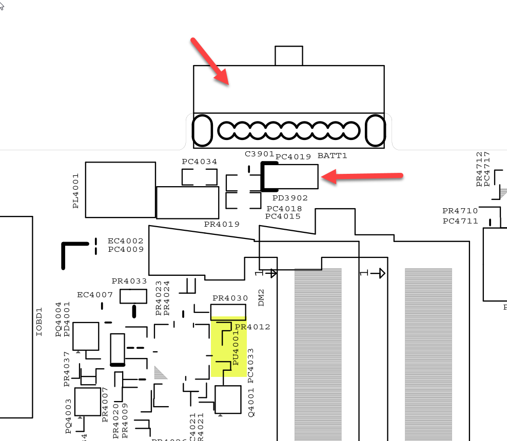

    Re: Dell Vostro 3550 (v A01 with BQ24707) Plugged in, Not Charging

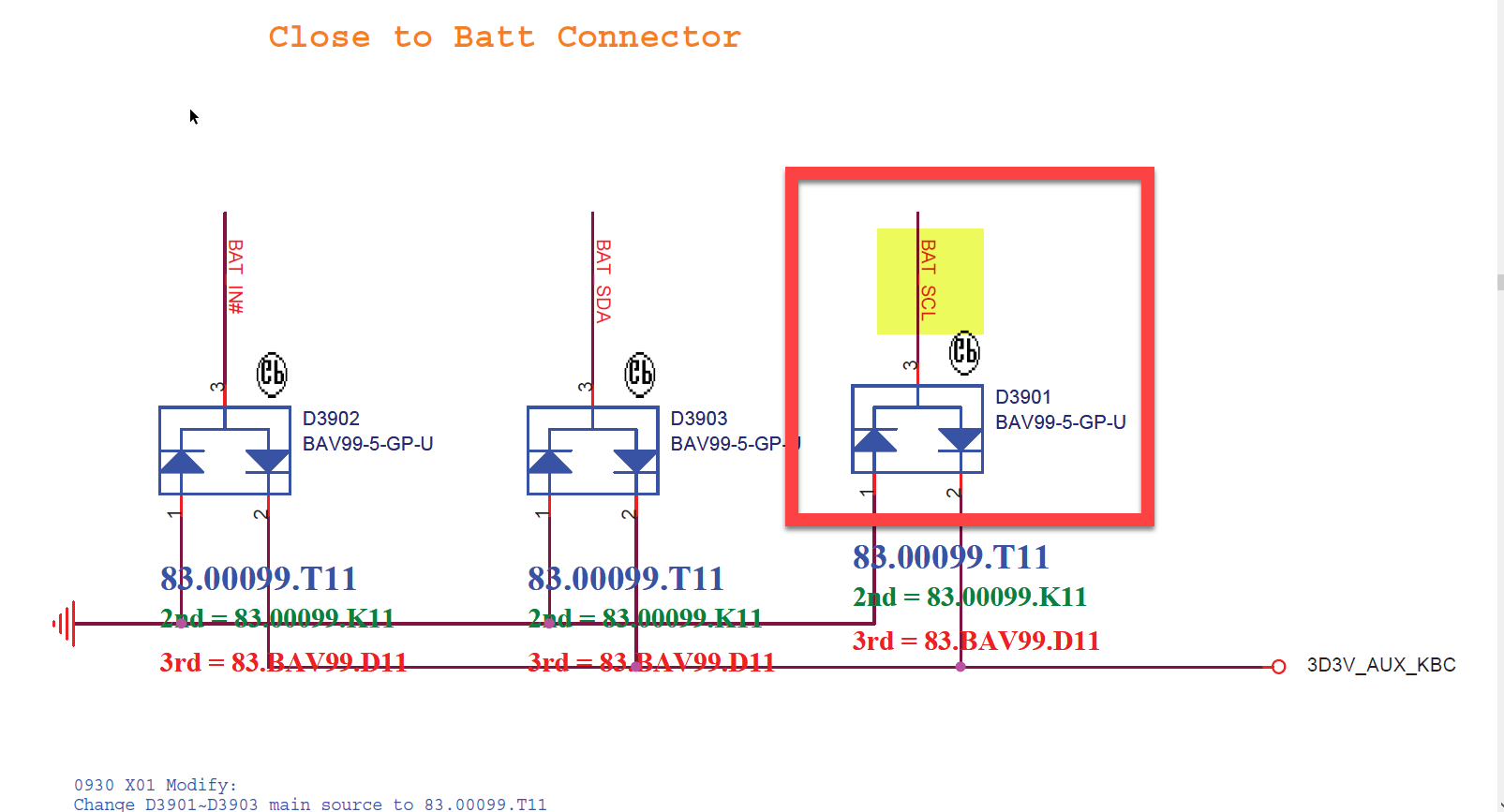

    See attached.
    Is your board layout similar ?
    1) Meter in DC volts mode (20v scale is ok).
    2) Measure the voltage of each pin on the battery connector and post the readings here for a review. Red meter lead on pin #1 of the battery connector; black meter lead to ground. Record the voltage.
    Continue to test pin #2, etc. on the battery connector.
    3) Take close but clear pix of the battery and charger area so we can have a closer look at the design.

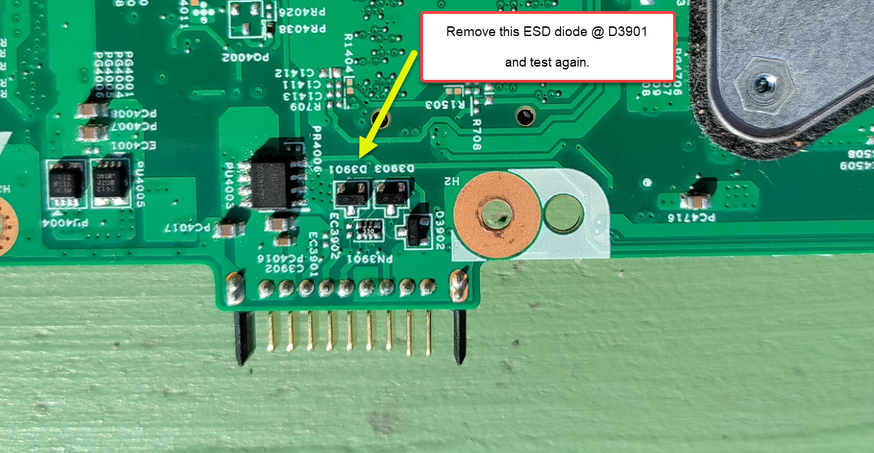

    Is component PD3902 a 3 legged part (2 on one side; 1 on other) ? (SOT23)
    This may be the dual ESD diode used to protect the SMBUS / I2C communication lines by the logic board host (bus master) and the BMS (battery management system) controller onboard your battery pack(s).
    Interested to know the voltage on the side with the 2 legs as follows:
    red meter lead on one leg (of the side with the 2 legs) & black meter lead to ground (shield is ok). What is the voltage reading ?
    Repeat but now apply red meter lead on the other leg (of the side with the 2 legs) & black meter lead to ground.
    If correct, this is an ESD protection diode that is camped on the communication lines. Often, this diode will get nuked and causes the communication to fail between the parties and the battery is then not detected. The stats on the battery are extracted using these 2 pins on the battery connector = SDA & SCL lines.

        BATT1 Connector (CPU, RAM side up as on attachment)
        Readigs left to right:
        1. 2.76V
        2. 2.77V
        3. 3.35V
        4. 3.35V
        5. 3.32V
        6. 0V
        7. 0V
        8. 0V
        9. 0V

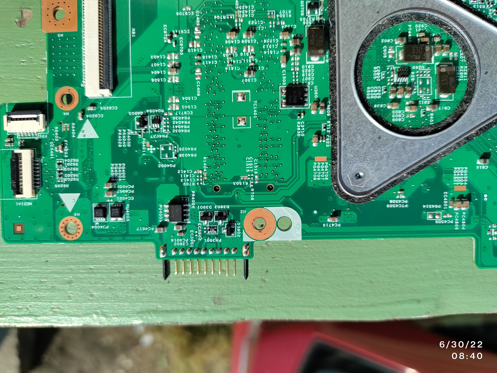

        On my board, its not populated, and it is 2 LEGGE part: but readings is: 2.76V ^ 0V
        Black on GND - Red on PD3902 (left side): 2.77V
        Black on GND - Red on PD3902 (right side): 0.00V
        If this is true, then device cant read battery voltage and report it?

          AC first mosfet? WITH AC CONNECTED
          PU3801 on my measure unit it is shorted in both ways (CRT BOARD)
          PU4002 on my measure unit it is shorted in both ways (Motherboard)
          If i remove charger, no short on any mosfet (PU series)
                PD3902-With flux and low air pressure, remove this part.
                Do not lose the part so we can place it back after testing.
                Power up without this part.
                Post your results.
                This may be the ESD protection dual diode for the smbus communication lines used for the battery pack. For this reason, both lines should ~3v to ground else this part is damaged and can halt proper communication with the battery.

                  This board does not have PD3902
                  • mon2
                    • Dec 2019
                    • 14680
                    Remove all power. Meter in resistance mode.
                    One meter probe on the same test pad with the missing PD3902 dual esd diode. Other meter probe to ground.
                    What is the resistance?
                    Next, repeat the same test with the other pad on PD3902 site and the ground on the logic board. Finally, the last pad of PD3902 will be the ground pin so resistance should be ~0 ohms to ground. Confirm this as well.

                      Is PD3902 the part near the battery connector and is with only 2 pads??
                      That is not the esd diode part if the same as the 2nd posted pic above.
                      Can you link the schematics for this logic board?
                      Update..is it the Queen schematic from post #1?
                      Then have it now.
                      Do you have the following parts on your logic board?
                      D3901
                      D3903
                      If yes, post their pic so we can confirm.
                      • mon2
                        • Dec 2019
                        • 14680
                        See attached.
                        D3901 = SCL ESD diode. Remove it and test again.
                        D3903 = SDA ESD diode. Remove this also, if required to restore SMBUS / I2C voltages on the battery connector.
