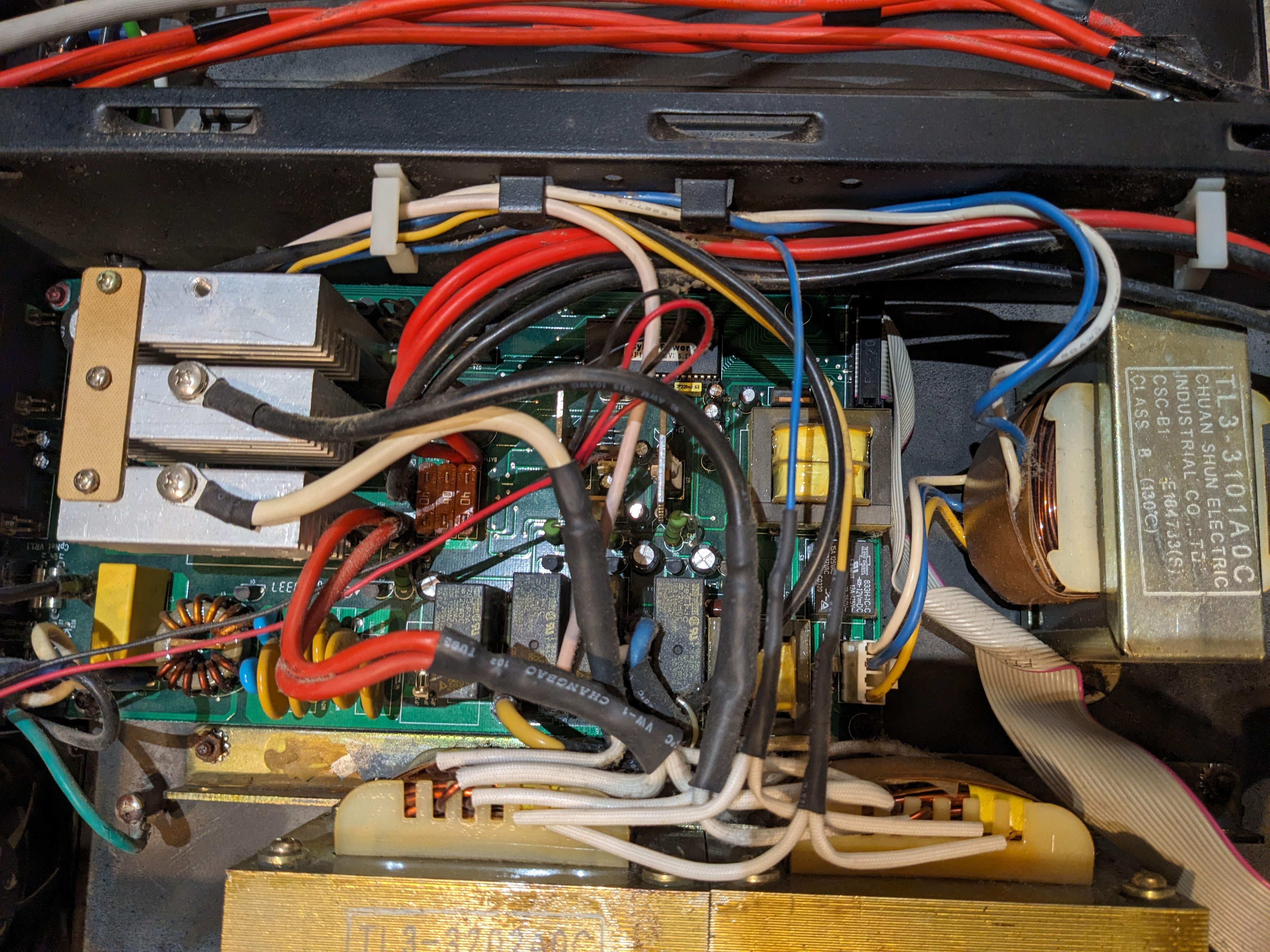

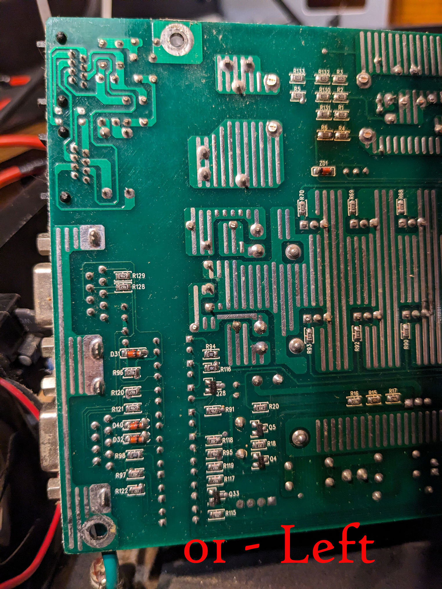

    Hello, all.
    Cyberpower Battery Backup Unit.
    I bought two new ML18-12 batteries through Amazon (They have already refunded my money for the two batteries as we thought the batteries might have been bad.)
    When I got them in, they were not fully charged. I connected them to the UPS and waited 24 hours before connecting any networking equipment.
    In parallel, they read 24v, but within 24 hours, the meter on the front of the unit dropped from 4 to 3 bars on the battery charge indicator.
    Checking the voltage, it was down to 22v.
    I quickly removed everything from the unit and powered it off.
    I put a Trickle Charge on each battery and brought each battery up to 13.6v.
    I connected them to the UPS, and nothing else connected to the system.
    The batteries have gone from 24.9v to 24.8, down to 19.8v within 48 hours.
    I checked the voltage from the UPS output wires, and they each read 24v.
    I am assuming one of two things.
    Either the unit is no longer charging the batteries
    OR
    The batteries are, in fact, not good.
    I had batteries on this unit about a year ago, but the batteries died, so that unit has been off for a year. (The batteries that were connected to the unit lasted for 4 years with constant runtime except during long power outages.)
    When the two new batteries are connected to the unit, they do not seem to be charging at all.
    And if I do a [test] on it, the system just shuts down.
    Everything looks good on the board; I do not see anything unusual, like glue issues or burnt components.
    I bought this unit new in 2001 and would really love to continue using it.
    So, any suggestions would be wonderful.
    I am not the best at electrical, but can do some things.
    Thanks All.
    Wayne

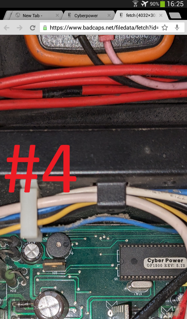

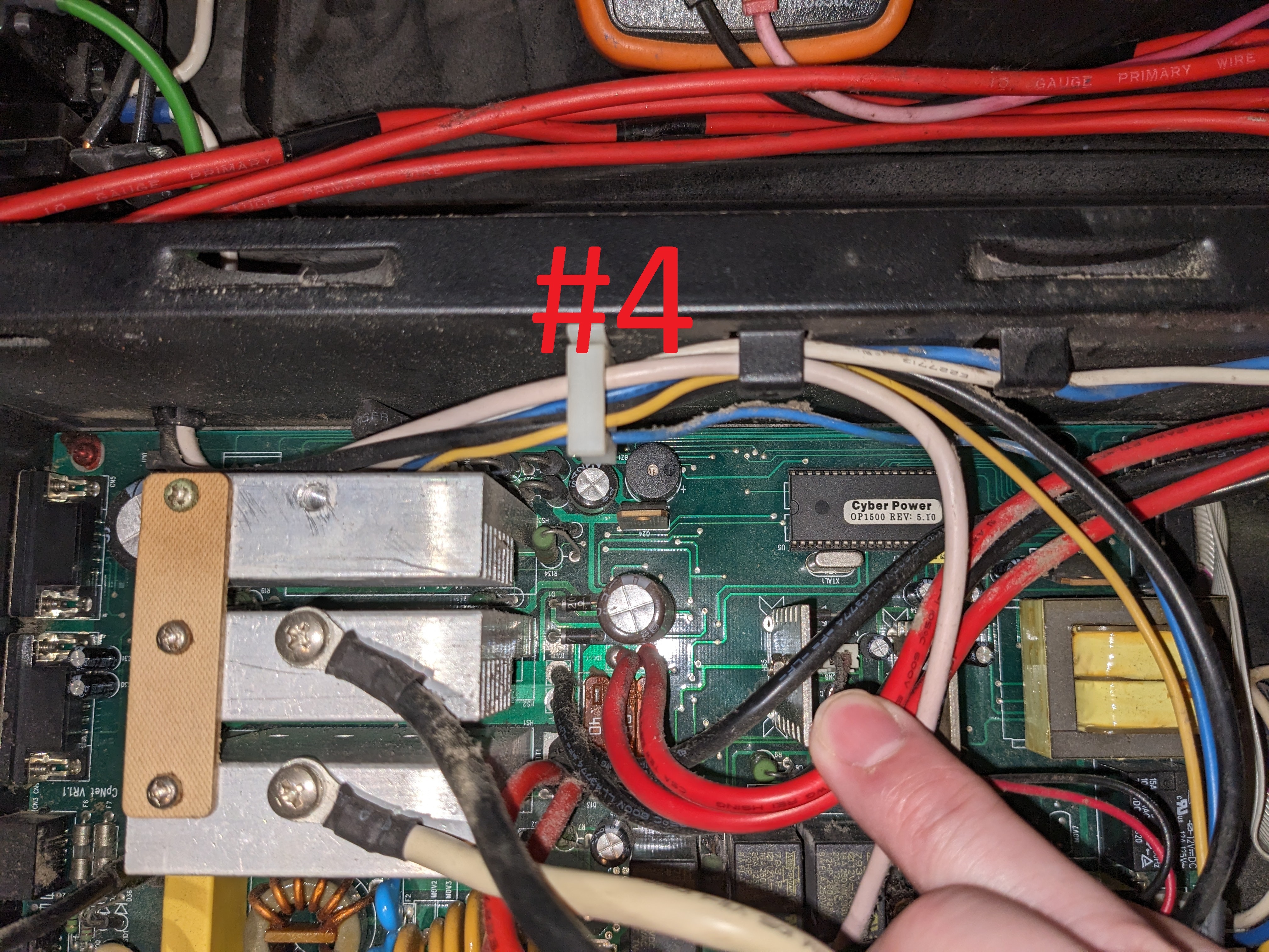

    Pictures of the board.
    Click image for larger version  Name:	PXL_20240615_195200993.RAW-01.COVER.jpg Views:	0 Size:	3.41 MB ID:	3291195
    • Jul 2011
    • 6070
    The first thing I would do is look at the charging circuit and this going to probably be near the small switching transformer this is the one that has the yellow tape around it what you are looking for is small value capacitor anything lower than 100uf change it even if looks good the other thing I would look at is for a switching power regulator ic chip ( this is a device that has 5 or more pins ) and check and see what is your DC Voltage at main filtering capacitor and post the results of the voltage reading
    Also check the three automotive type 40 amp fuse and report there status open or close circuit

      charging circuit
      I am unsure what I am looking for on this part.

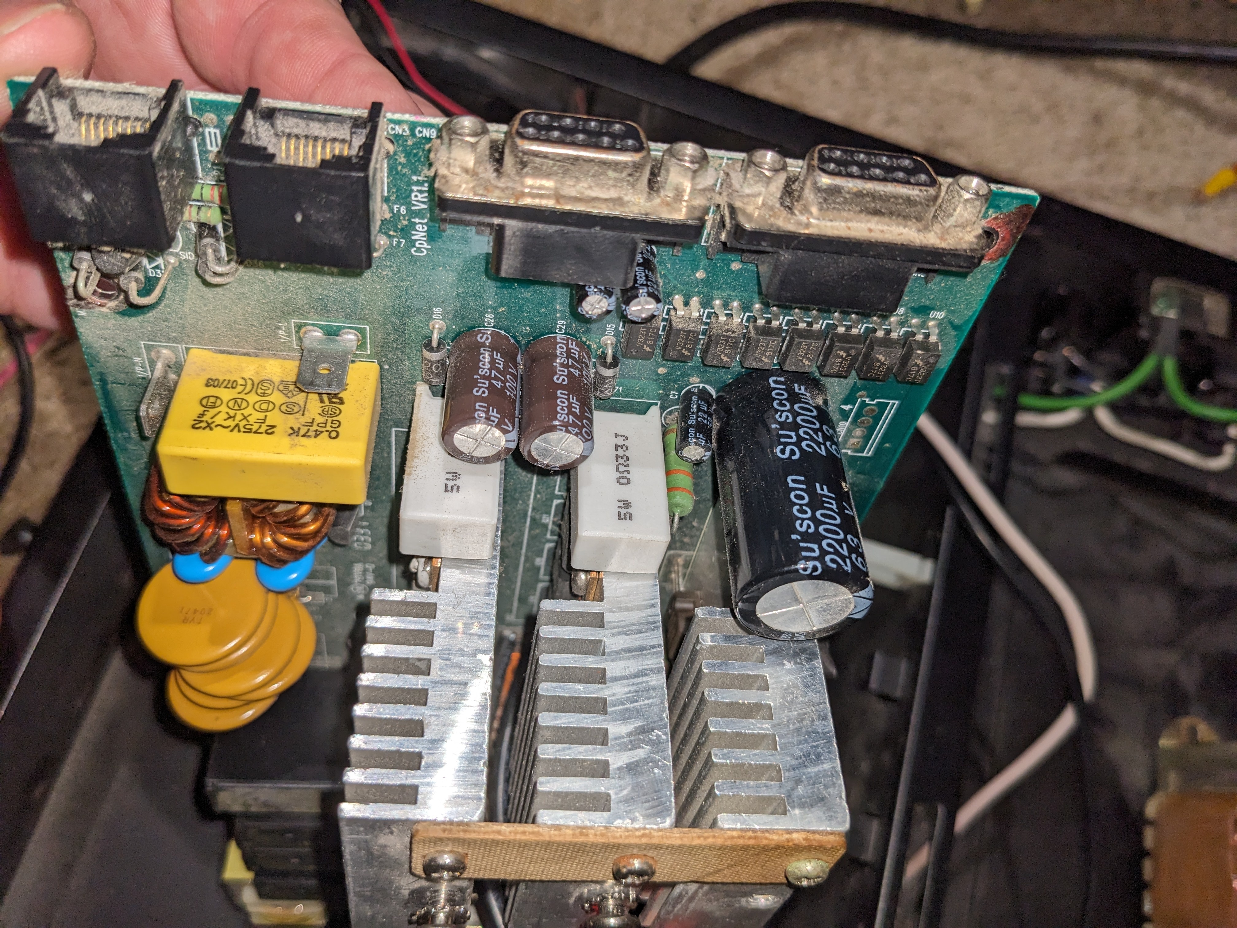

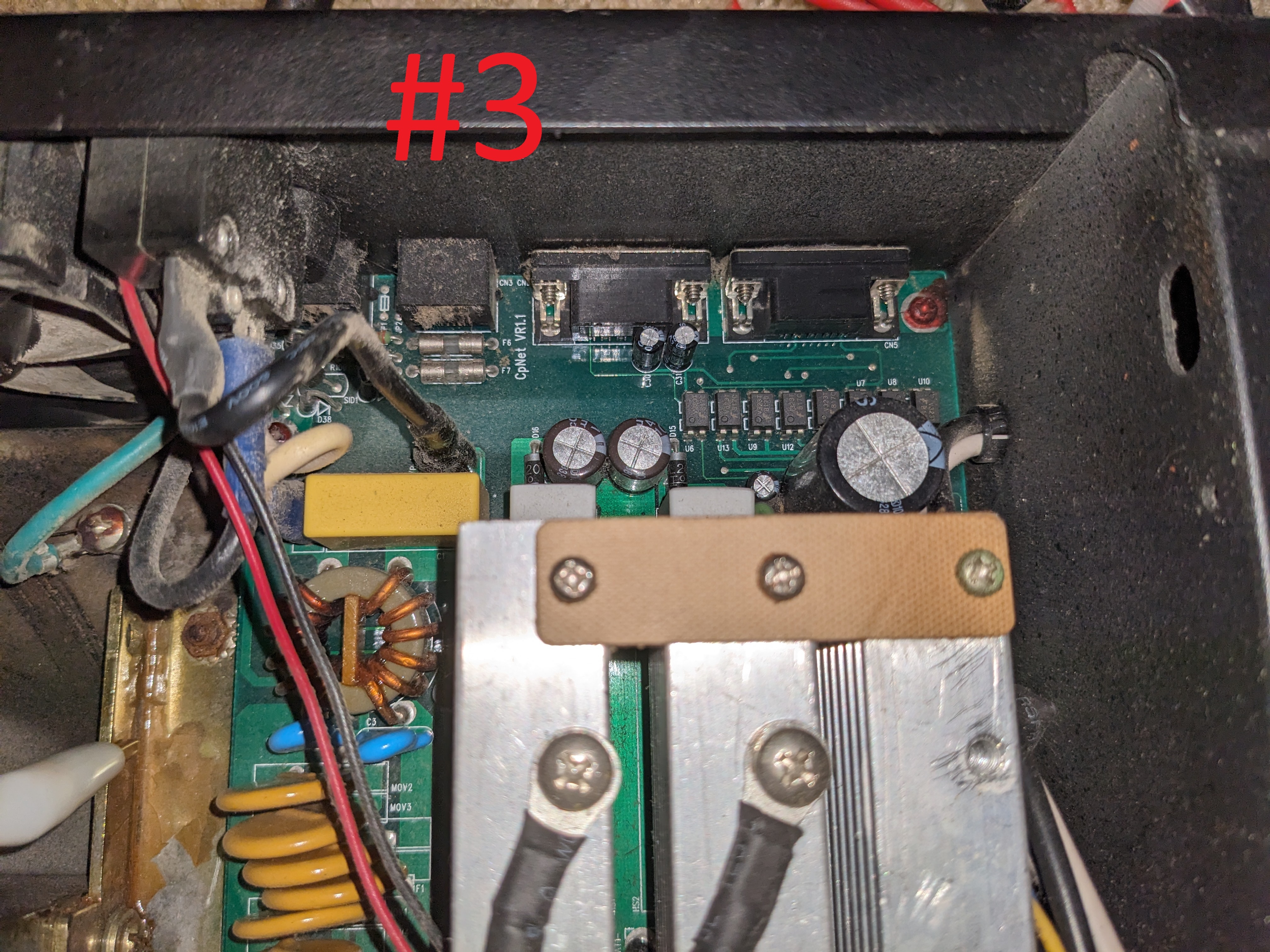

      I have taken high-resolution pictures that might help spot what I need to check. Also, how do I check to see if it is "100uf or lower"?

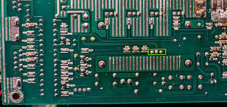

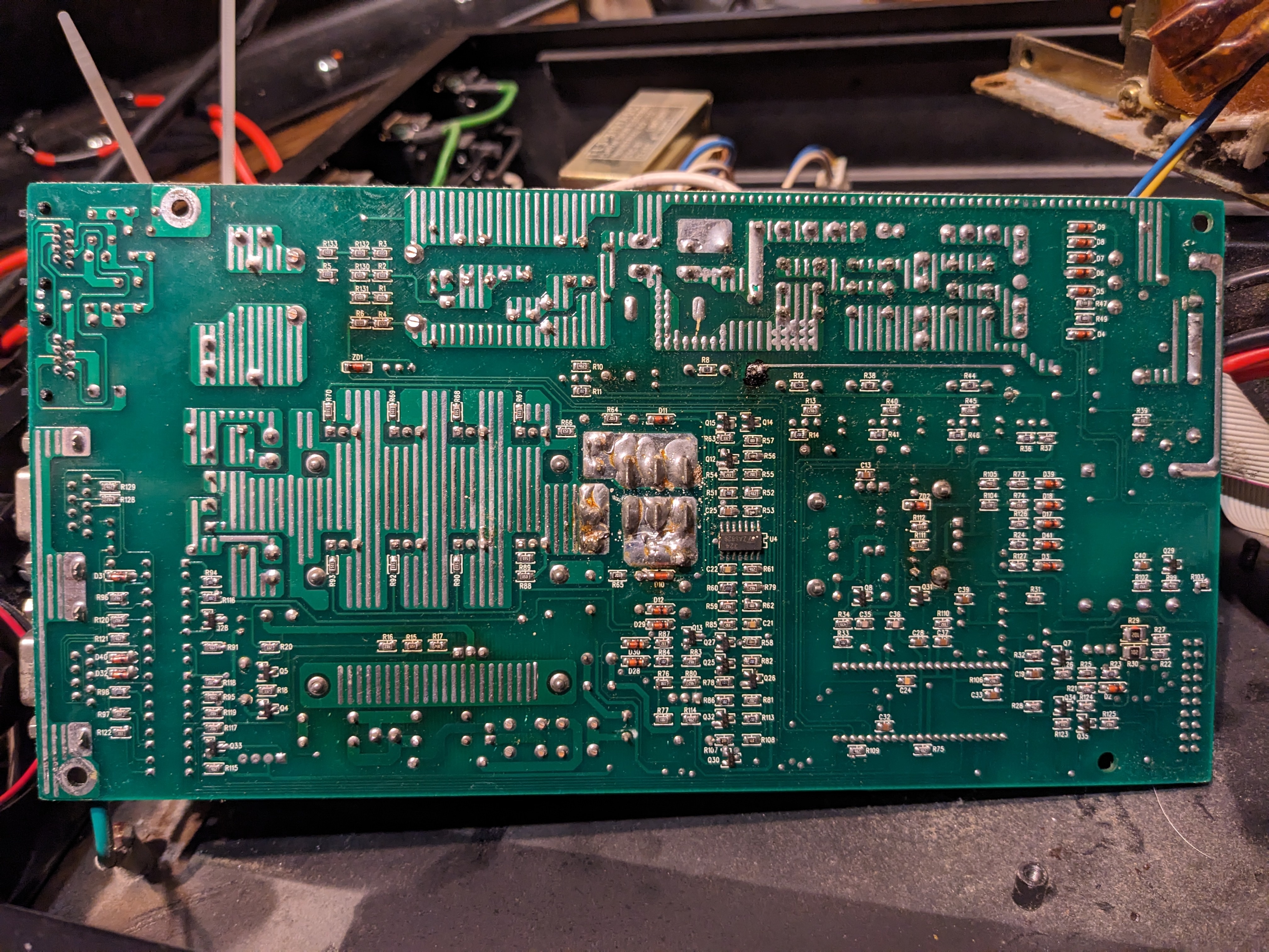

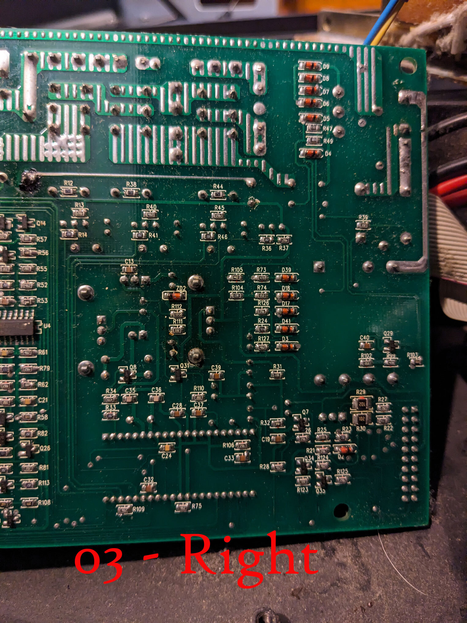

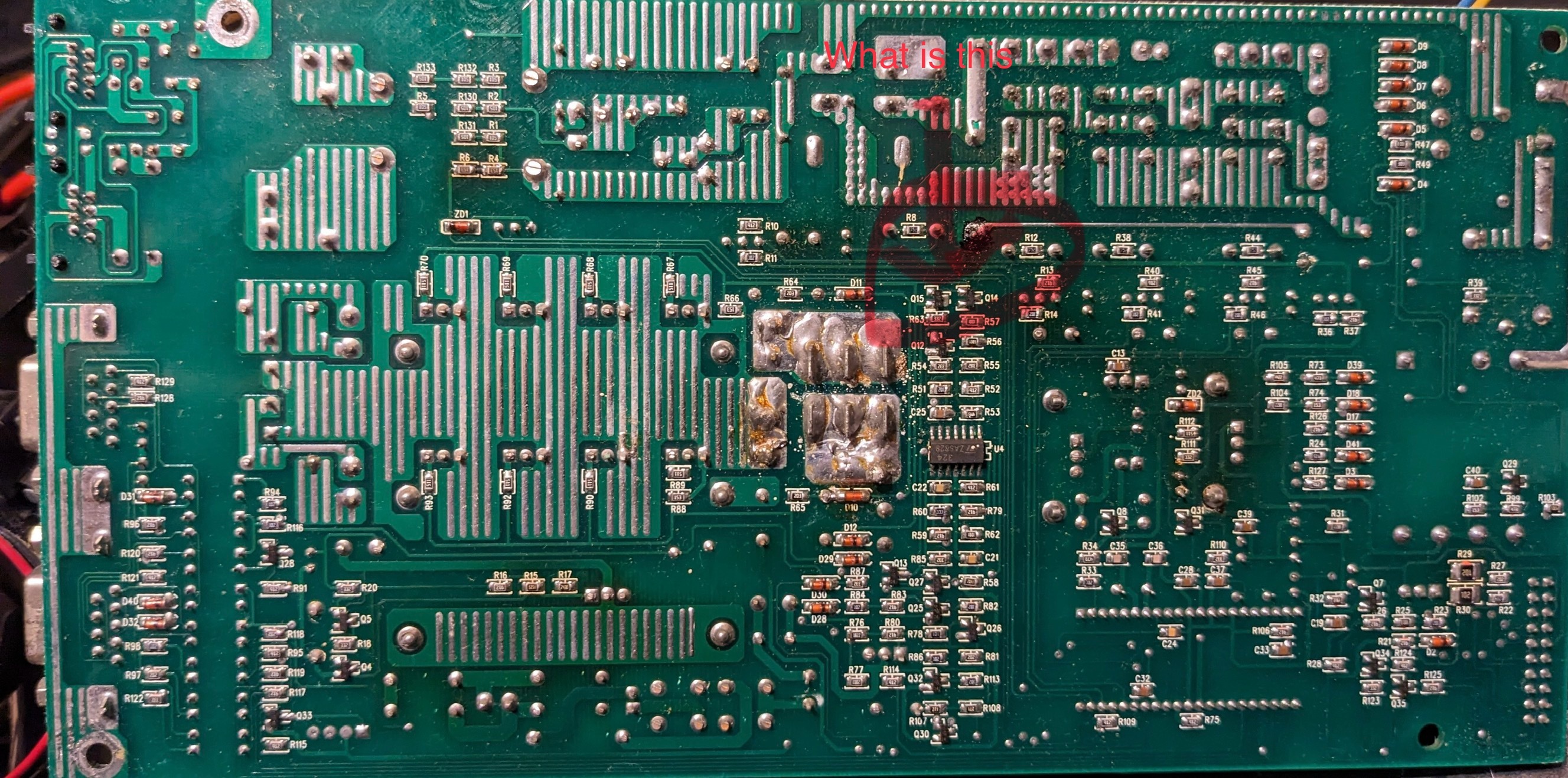

        Show some pictures of the back side of the board so I can locate the switching regulator if it has one or if you need to look for different type of regulator
        • carrzkiss
          • Jun 2024
          • 18
          Here is the back.
          I took three images, close-up, to make it easier to see.
          Plus, a completed full board image.
          Thank you, Sam.
            • Jul 2011
            • 6070

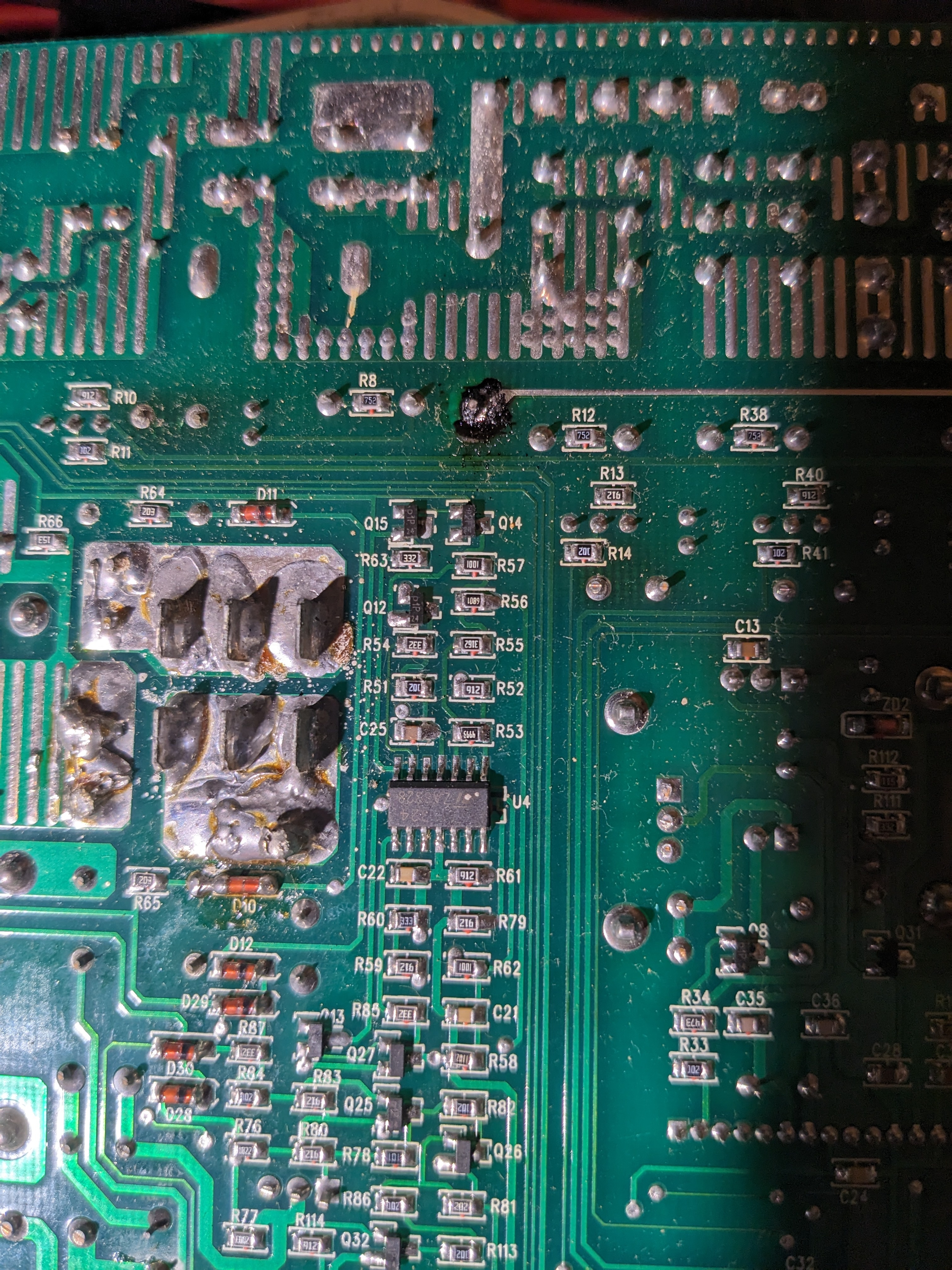

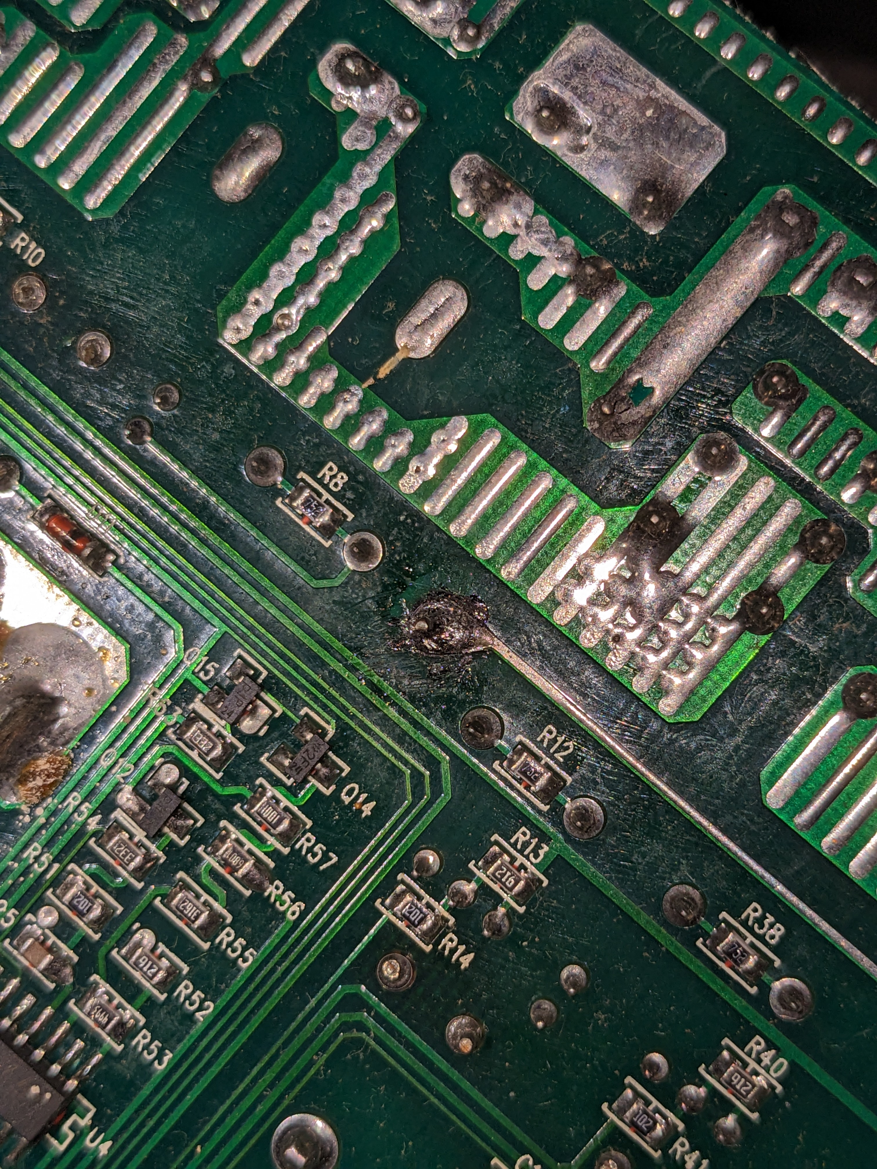

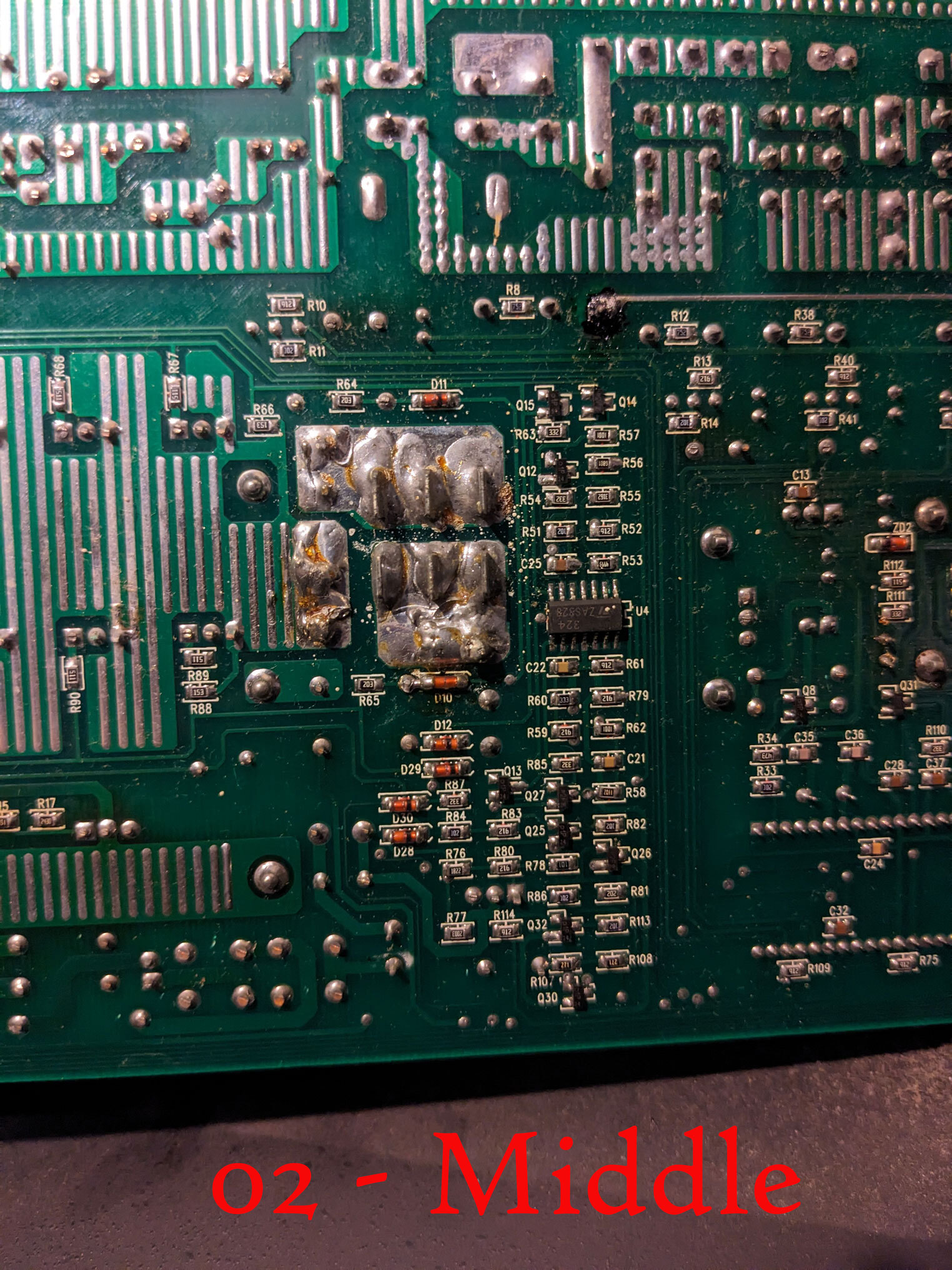

            Can you please post the part number of “V1” and “V2” or a in focus picture of the part number
            Look at the picture what is the black stuff around the soldering joint where the red circle that is marked if it is flux reheat and remove it from the soldering joint and then reheat it again until you have the majority of the flux from that soldering joint
            There are some other soldering joints that are questionable at best from the picture of the hole board but it is possible that it might be the way the light is hitting them but I would look the hole board over for dull cracks around the component pins and the soldering joints to the board or missing solder around the component pins to the board or a lot of flux around the soldering joint and the component pins and if you have a magnifying glass would even be better for accuracy of the soldering joint and the component pins to the board especially the transformer pins look at them very carefully for bad soldering joint
            • carrzkiss
              • Jun 2024
              • 18
              It seems the black might have been ink. It would not come off with the hot end of a solder, but it would scrape off with my fingernail. It is just a solder joint in that area with some kind of black ink or pigment on it.
              I scrapped it off with my fingernail.
              Attached is a better picture of that area before I scrapped it off and a picture after.
              The V1 and V2.
              Where will this be?

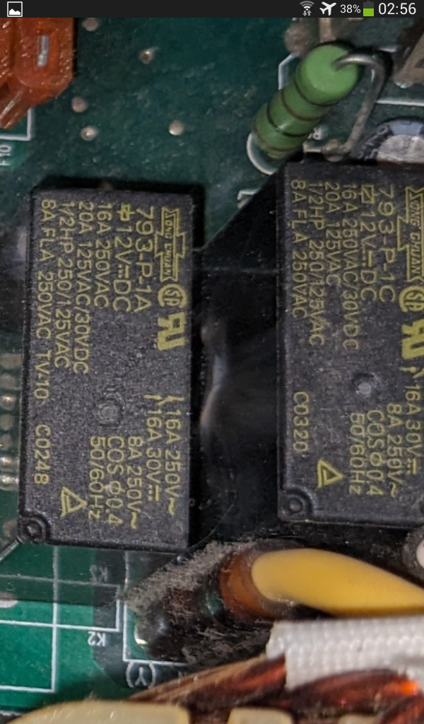

                  The smoke outline on the relays might be normal. After many years air currents cause dust and silt/smoke to deposit on things. But wait I see a fan, so that is odd there. Relay contacts might have arced.
                  I would give it a vacuum cleaning/compressed air blast and toothbrush rub on the back side, clean it up.
                  It has mains iron-core transformers- no SMPS here.
                  There are many fuses to check. Three of 40A automotive (red) blade fuses.
                  F1 not sure where it is.
                  F2 by the MOV's.
                  F3, F4 maybe for AVR taps.
                  F6, F7 by CN3 the serial port or something.

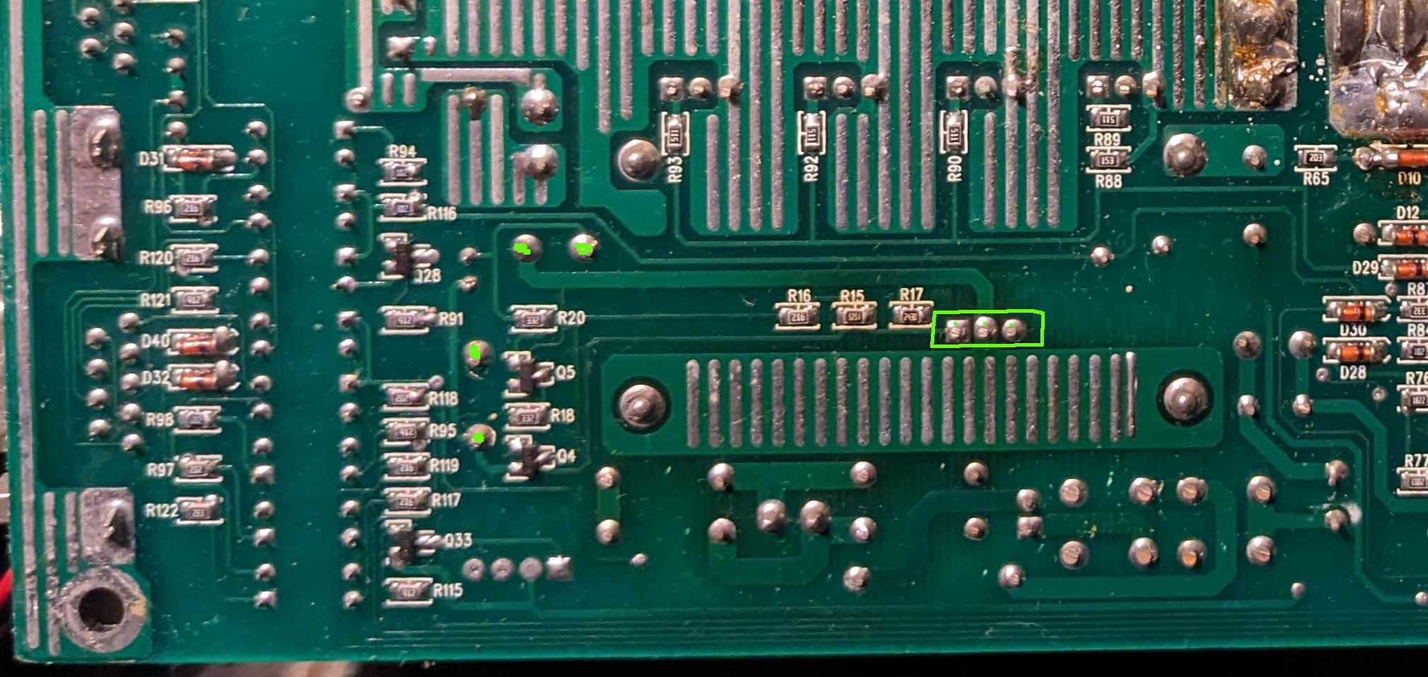

                  Usually it's relays that fail, fractured solder joints. Some MCU pins look dodgy soldering and those sockets are shit, they oxidize with humidity. Have you tried tapping (not too hard) the board with a plastic pen, relays included- to flush out poor connections.
                  If more complicated, the battery charge controller would have to figure out. The big heatsink at the board edge seems my guess for that. The other two big heatsinks are the (double) H-bridge to drive the (two big) transformers.
                  U2 might be the 5V regulator for the MCU power.
                  U3 looks a little baked? TO-220 next to HS5 and the red fuses. What is the IC on heatsink HS5 or next to it. One is a 5V regulator to power the MCU.
                  I can see it has a small power transformer making around 12VDC for the relays, and then 5V for the MCU. The two big (parallel-connected) transformers are for the UPS and connected backwards (by relays) they also charge the battery.
                  The medium size transformer is the AVR voltage boost, relays to switch it up or down taps.
                  • carrzkiss
                    • Jun 2024
                    • 18
                    Update.
                    Once I cleaned that black ink or whatever it was from around the solder joint, I put everything back together, and it seems to be charging the batteries now.
                    When I connected the batteries, they were at 22.2v
                    They are now at 23.4v.
                    I will update you all tomorrow on the status.
                    That is going to be weird if that is the issue.
                    And I also cleaned the back and as much as possible on the front.
                    I vacuumed, but I didn't have any air, unfortunately.

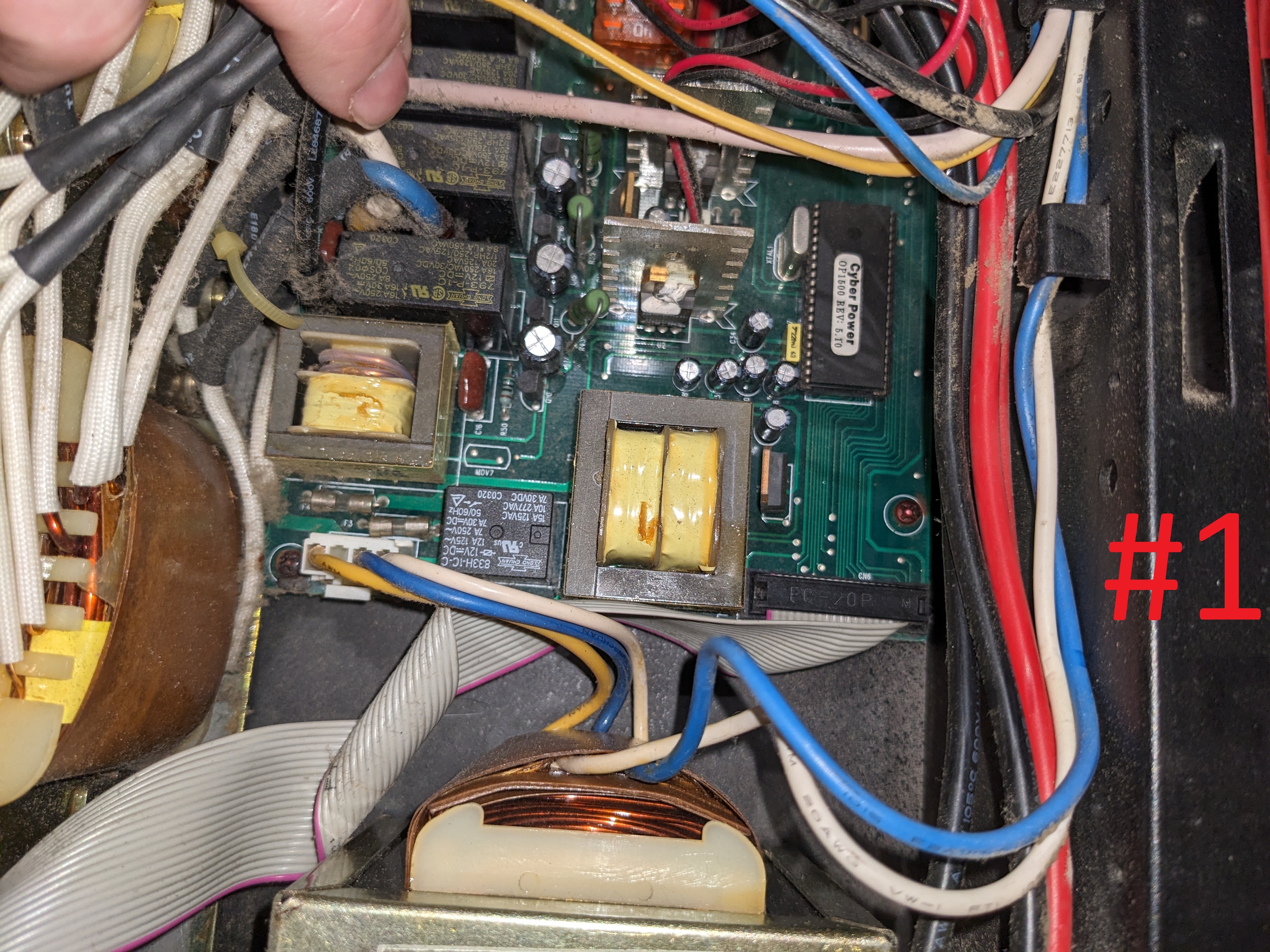

                          The microcontroller could have turned off the charger, or the charger circuit/IC is damaged, or the charger fuse is blown etc.
                          I'm guessing the battery charge control is an LM317 IC on a heatsink. This is the usual Cyberpower circuit.
                          Can you read any part number on that part, I know it's in a sandwich. I can't see that portion (top) of the board either to see the parts (where I put green dots).
                          Can you measure the DC voltages on the pins and post. Use BATT(-) for multimeter common(-). Careful the board has hazardous live AC mains on it too.

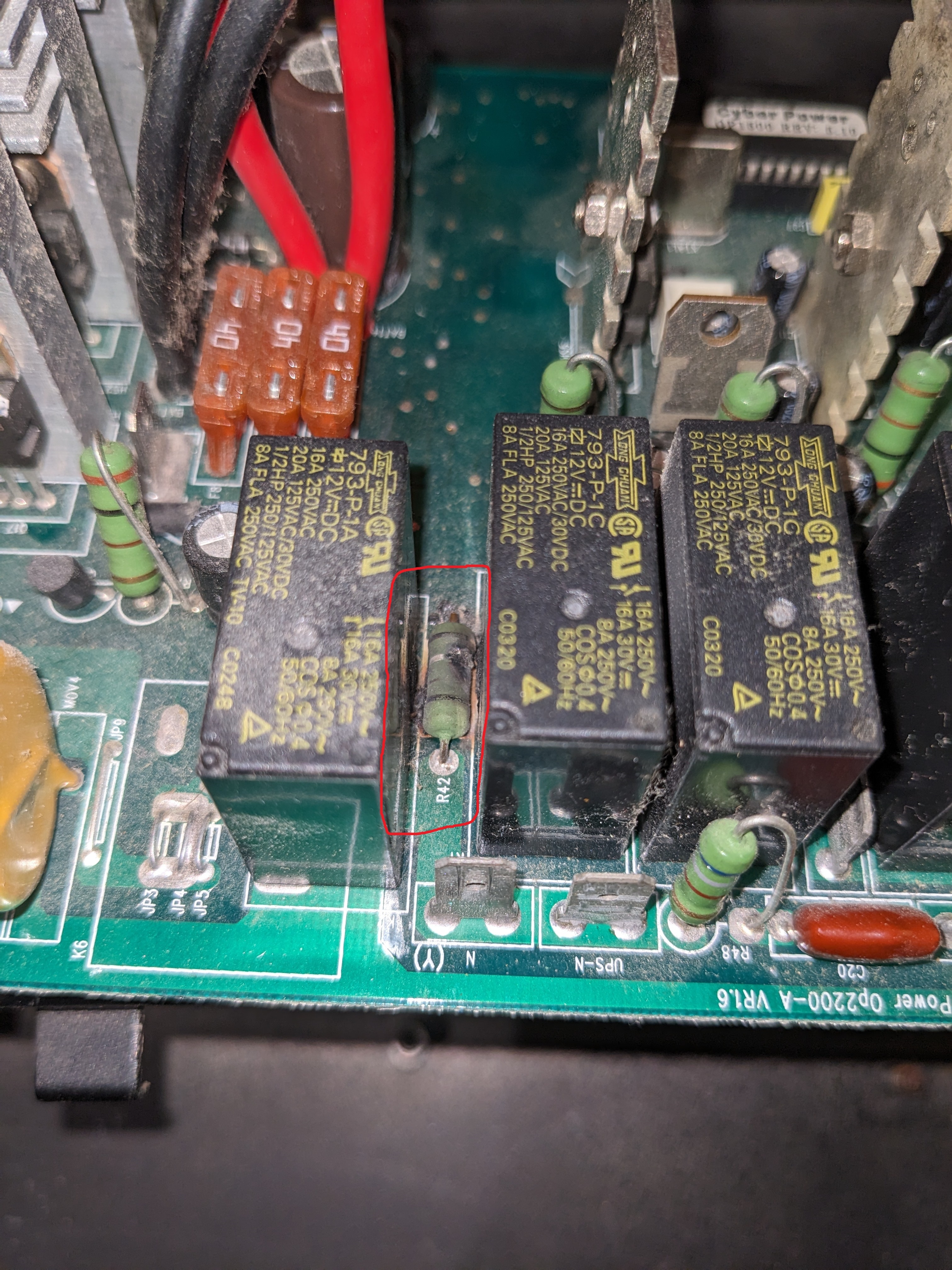

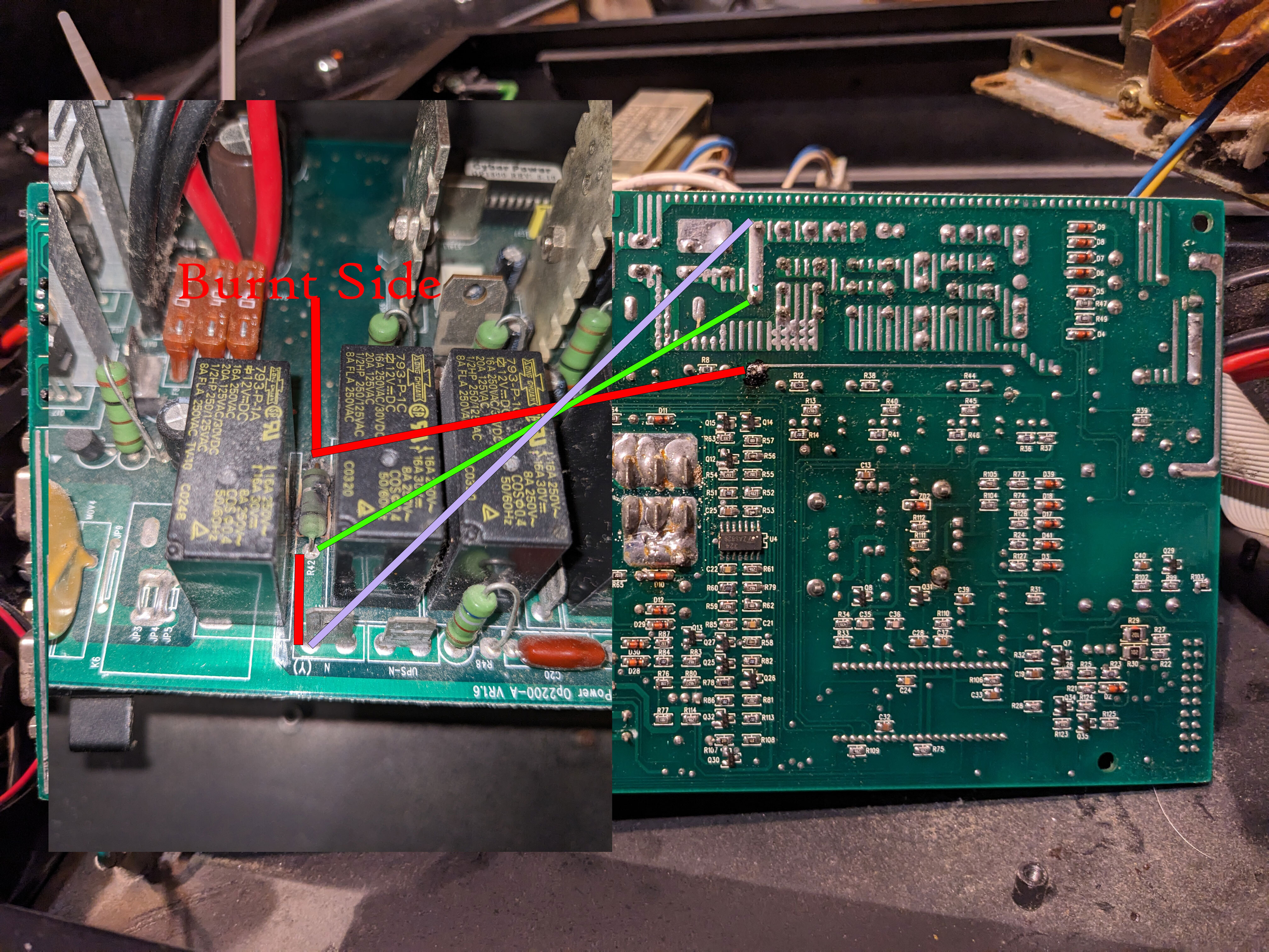

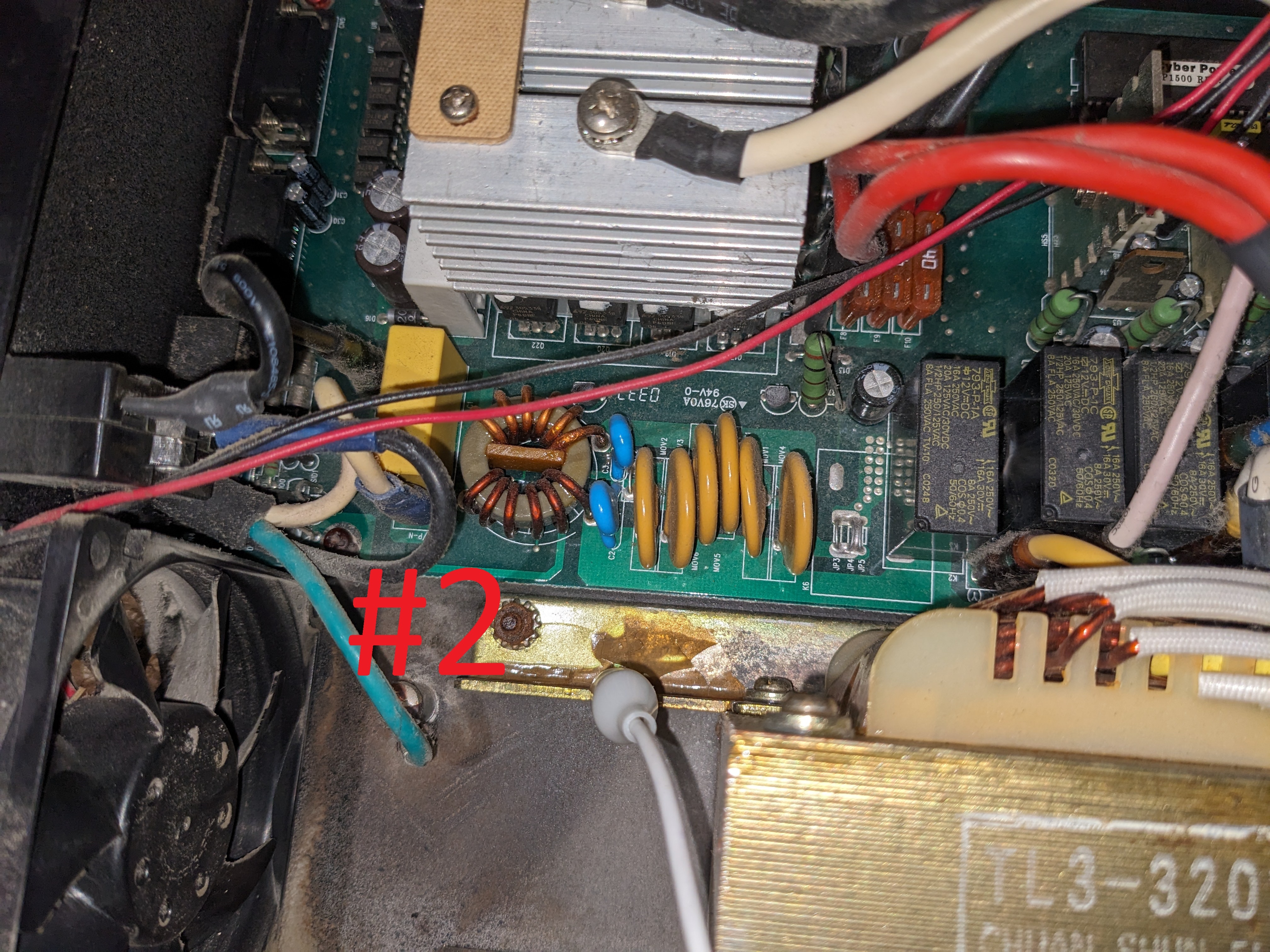

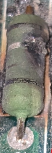

                            It seems harp might have been correct.
                            After taking everything apart, I found this.
                            It is burnt, which would explain the black from the back.
                            The black was soot from the front resistor burning up.
                            The resistor is R42.
                            Is it just the resistor that needs replacing, or is the power relay beside it also?
                            Could someone please provide a link to purchase this from?
                            I've marked up the last image to show where everything goes.
                            I believe I got it marked upright.
                            The only thing I have to work with is a small soldering iron.
                            I also have some solder, but I am unsure what type of solder I have. (I remember my father telling me years ago that there are different types of solder for different jobs.)
                            If you all could let me know what I will need to remove the resistor
                            And to put one back on, I will get them.
                            And any other information or advice.

                                  OP I thought you checked that out already.
                                  The resistor one end connects to mains Neutral, other end to C16 so I would guess it's a snubber resistor and cap C16 has shorted.
                                  Putting in just a new resistor will smoke it. Resistors only burn up when overloaded, so there is another problem- hopefully shorted C16.
                                  This still doesn't explain the no charging problem, unless the relays melted and don't work. You need a desoldering tool to get the parts out.
