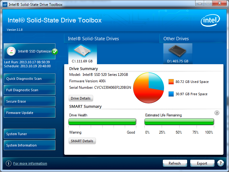

        My intel ssd toolbox says it is both 100% healty and there is nothing used.. or it just seems so. There is no numerical evaluation, just stupid graphs, cant see if it is 99% or 100%
        I had it for a year already, it is only for C drive, D drive is toshiba spinner

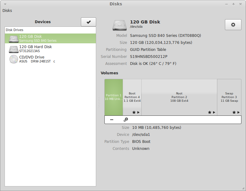

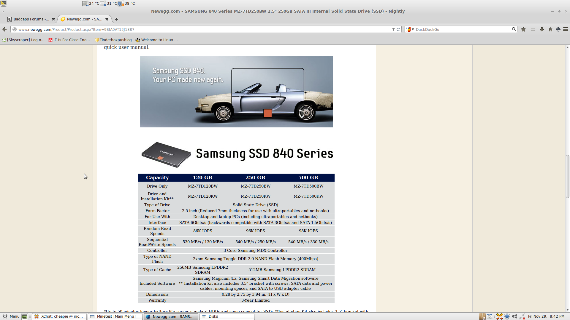

                                    I don't understand where people are getting the idea that the Samsung 840 series is powers of two (including the site ranting about it earlier). It's 120, 250, and 500 GB.
                                      Re: SSD suggestions
                                      the 840 PRO's are PO2, but the rest of the 840s are not
