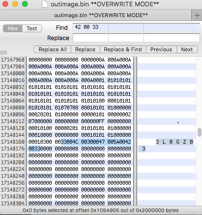

    Please help me clean up the slow startup dump if you have time. Thank you.

    wrong serial, check again
      ST-3J0GZB3

        ST-3J0GZB3
        yep, my bad, serial is ok. Try clean ME file.
          Sir, unfortunately, it cannot save the service code and cannot exit the manufacturing mode. Can you help me fix it again? Thank you
            i didn't touch Bios_Region so DMI should be there. Maybe also Bios_Region is bad. I will rebuild your bios a bit later, at interval from football match.

                Updated bios and ME regions to latest. There are 2 variants, try them both. Let it run for 2 minutes, at 1st boot press F2 and enter service tag, save (Apply changes on bottom page), restart, 2nd boot press Alt+F to exit factory mode.
                  I tried the latest two DUMPs and they started up quickly.
                  Sorry, I changed the chip and it still won't save.
