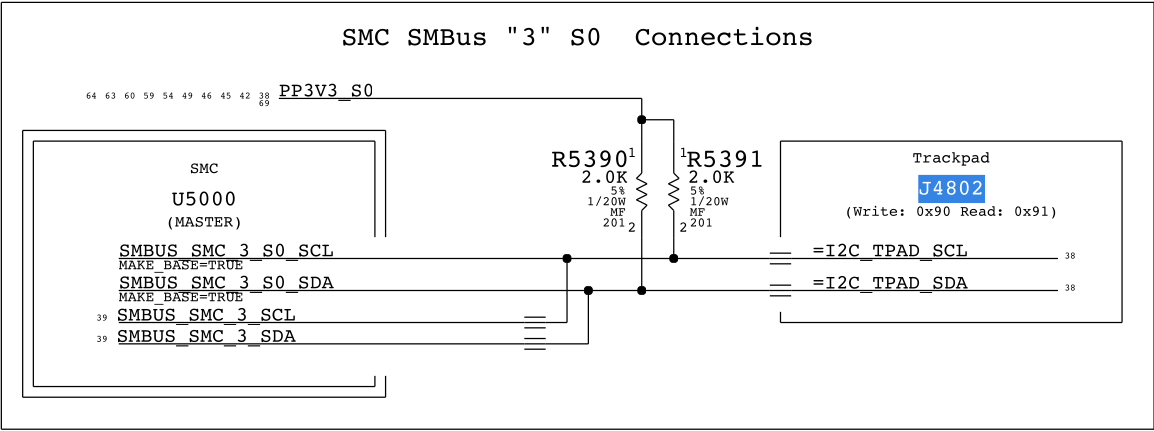

          Re: MacBook Pro A1708 - CPU extremely slow, locked @ 0.39ghz; fan full speed
          Ts0P
              Originally posted by piernov
              Ts0P
              Isn't that related to palm rest/trackpad?
              I already tried another palm rest/trackpad, and same anomaly happens. I also tried this one on another board and it works fine.
              Maybe Ts0P on this motherboard relates to something different. Can you give me a little more please?

                    Also, on this motherboard schematic I can't find any reference to Ts0P; is it called something else? Where would I go to follow its circuit and troubleshoot it?
