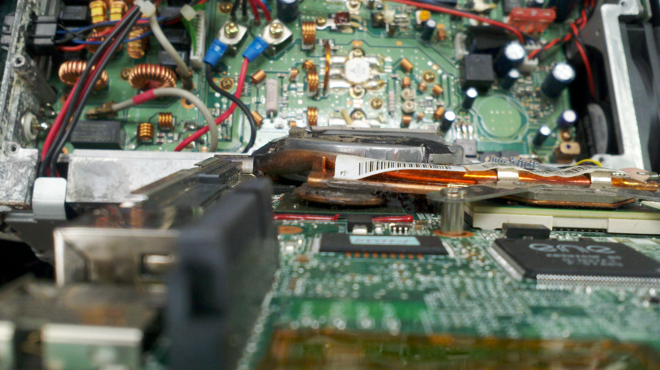

    found this abortion in an hp laptop/tablet.
    a surefire way to finish off an already problematic nvidia chip!

      that's why I always replace a pad with a new pad and never a copper shim, with distorted gaps like that a shim is useless
          Same here, same rationale. If there wasn't a need for a pad's "squish", then a pad wouldn't have been used.

            lol, someone trying to use a penny or some sort in this laptop. Doing it wrong, though!
