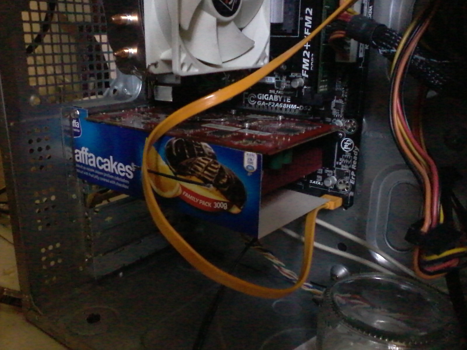

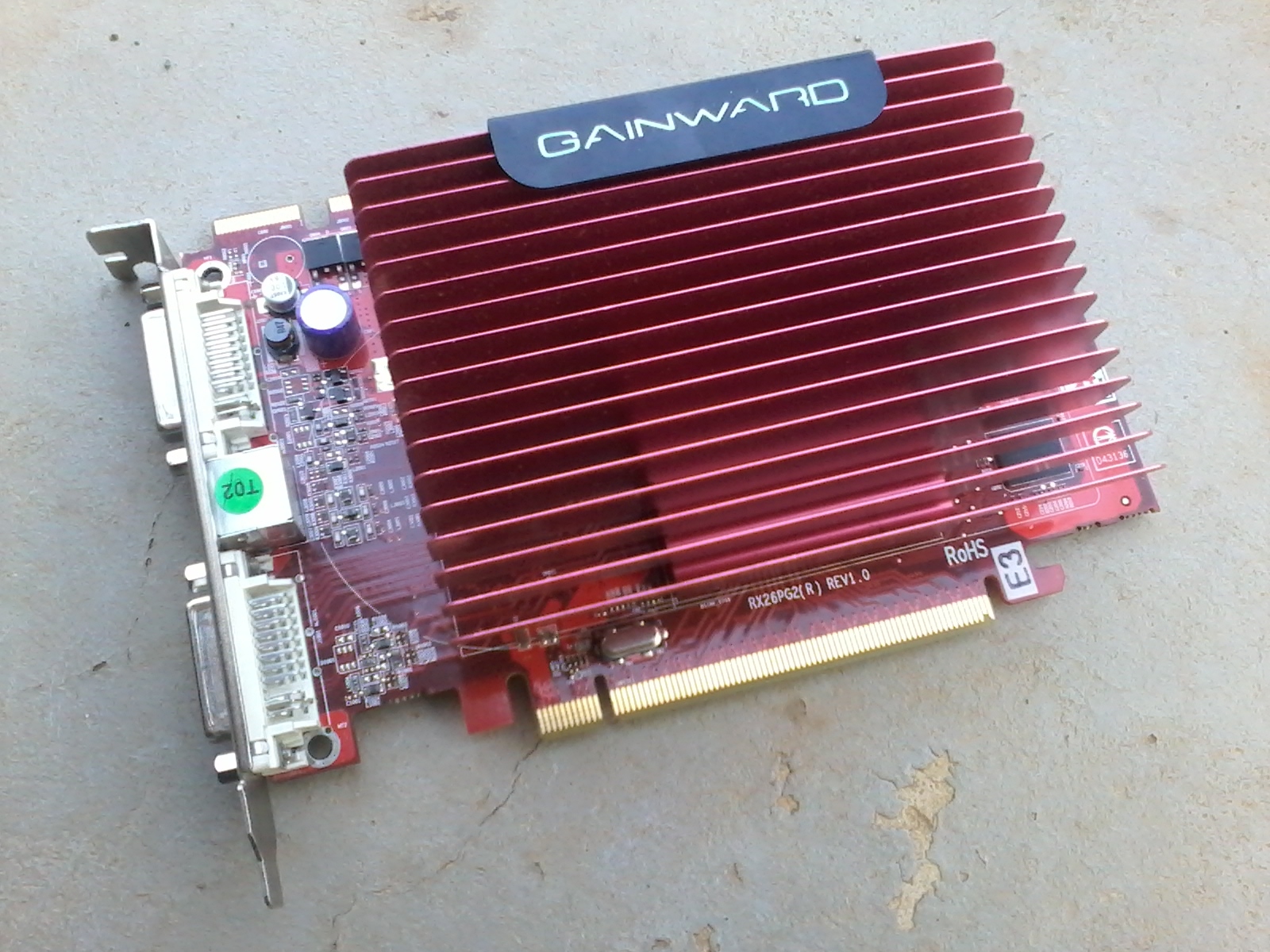

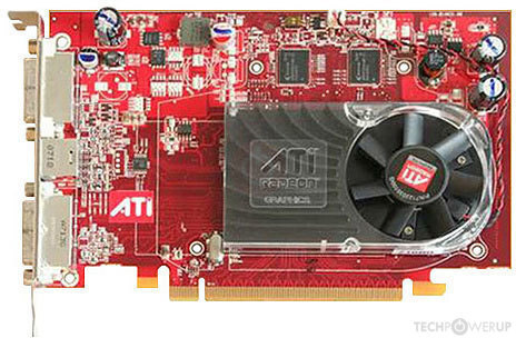

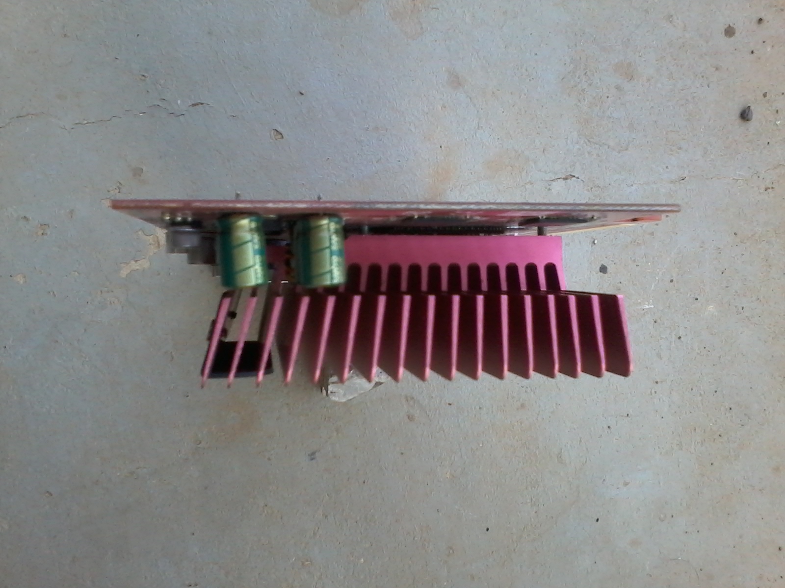

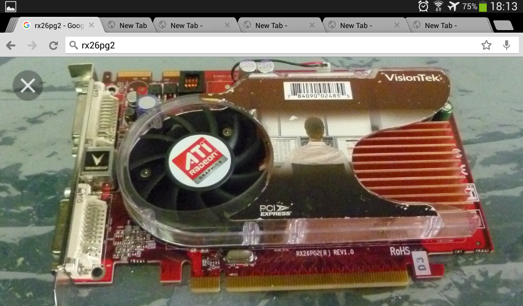

    I have RX26PG2 graphic card with incomplete original heatsink, only aluminium plate... but in original solution it look like such bad termal design that I asking if is proper fanless heatsink be adequate replacement ot better... what you think? Till powering on, it is propper hot...
    • 31286
    the big heatsink is a start, but you still need to remove the heat.
    maybe slap a spare 80mm fan on it
      • 31286
      btw.
      you have the cooler on backwards.
      its supposed to blow out of the case
      • harp
        • Jun 2022
        • 648
        • Planet Earth
        The fanless heatsink was from geforce 9500gt, and according to data it card have 50w disipation power. This rx26pg2 (radeon hd 2600 pro) has less power, again according to data, mention 35 - 45w, but I dont know what is expected temperature on this type of fanless card anyway... ... ... for me, it is too hot to firmly touch... I doubt that original small heatsink with fan run any lower temperature on it...? About cooling... I open few rear sheald for card slot, and put card into tide tunnel, so, when is computer case closed it suck fresh air over heatsink... I tested with piece of paper that work...
