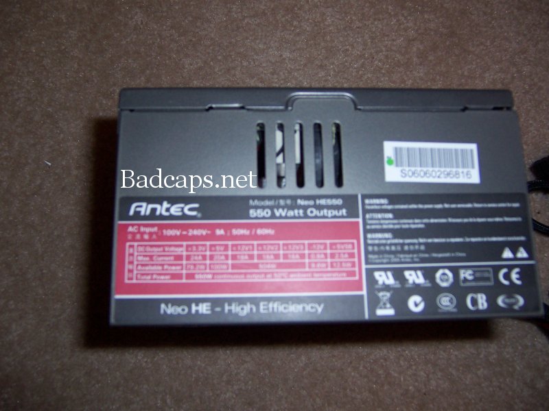

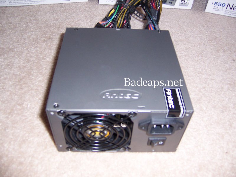

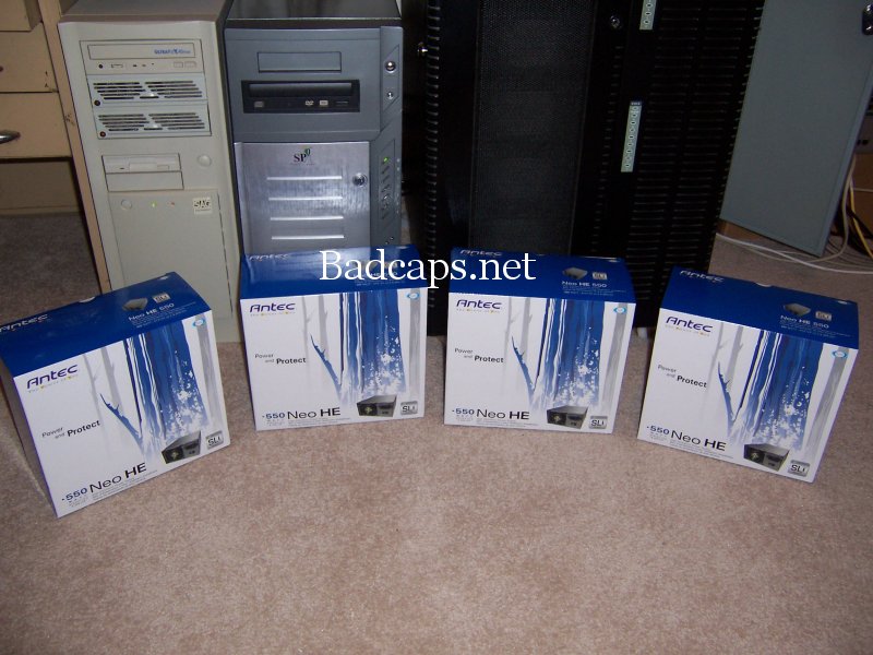

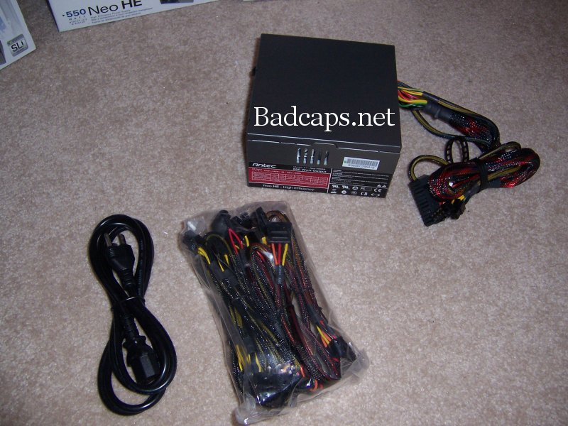

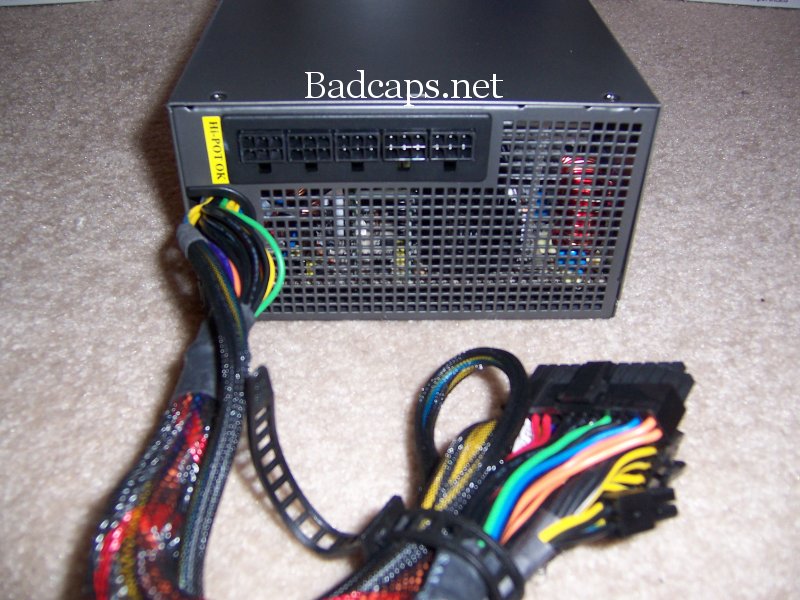

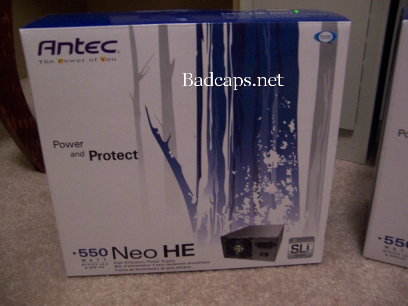

                The latest on the project:
                A very special thanks goes out to David Forster of Antec for contributing FOUR HE550 PSU's to the experiment. The cases I'm looking at for this experiment have some no-name PSU's (chiefmax or some off the wall shit), and I felt it better if good PSU's were used. There has been some debate as to Antec's quality in the recent past, and this will be a good opportunity for them to clear their name as well. I'll disect one of the units to see what brand of caps are living in it, but other than that, these units will not be modified in any way. This will be a good test for them for how they perform right off the shelf. My personal experiences with Antec has been good, I can honestly say. I've seen a few dead ones, but on that note, I've seen a lot fewer dead Antecs than say Powmax, enermax, and other shoddy brands such as deer and so on. My personal fav PSU is Zippy, but they're geared more toward the IT/server market, and are very expensive.
                As for the HE550 units themselves, they are very impressive IMO. Well designed casings (units are actually heavy and quite beefy), nice long cables, and connectors for any possible configuration imaginable. These units are gross overkill for the experiment at hand, so power issues will definitely not be an issue..... Hell, I've ran a fully loaded KT7 system on a cheapy 250W PSU with no issues.
                Since I received units, I think its best to keep the experiment closed at 4 systems, otherwise I'll have to track down more of these, and I wouldn't feel right requesting more of them from Antec, as they've contributed plenty as it is IMO.
                Once again, a VERY SPECIAL THANKS to
                DAVID FORSTER
                Director of Channel Relations
                http://www.antec.com/
                Here's some pics of the units:
