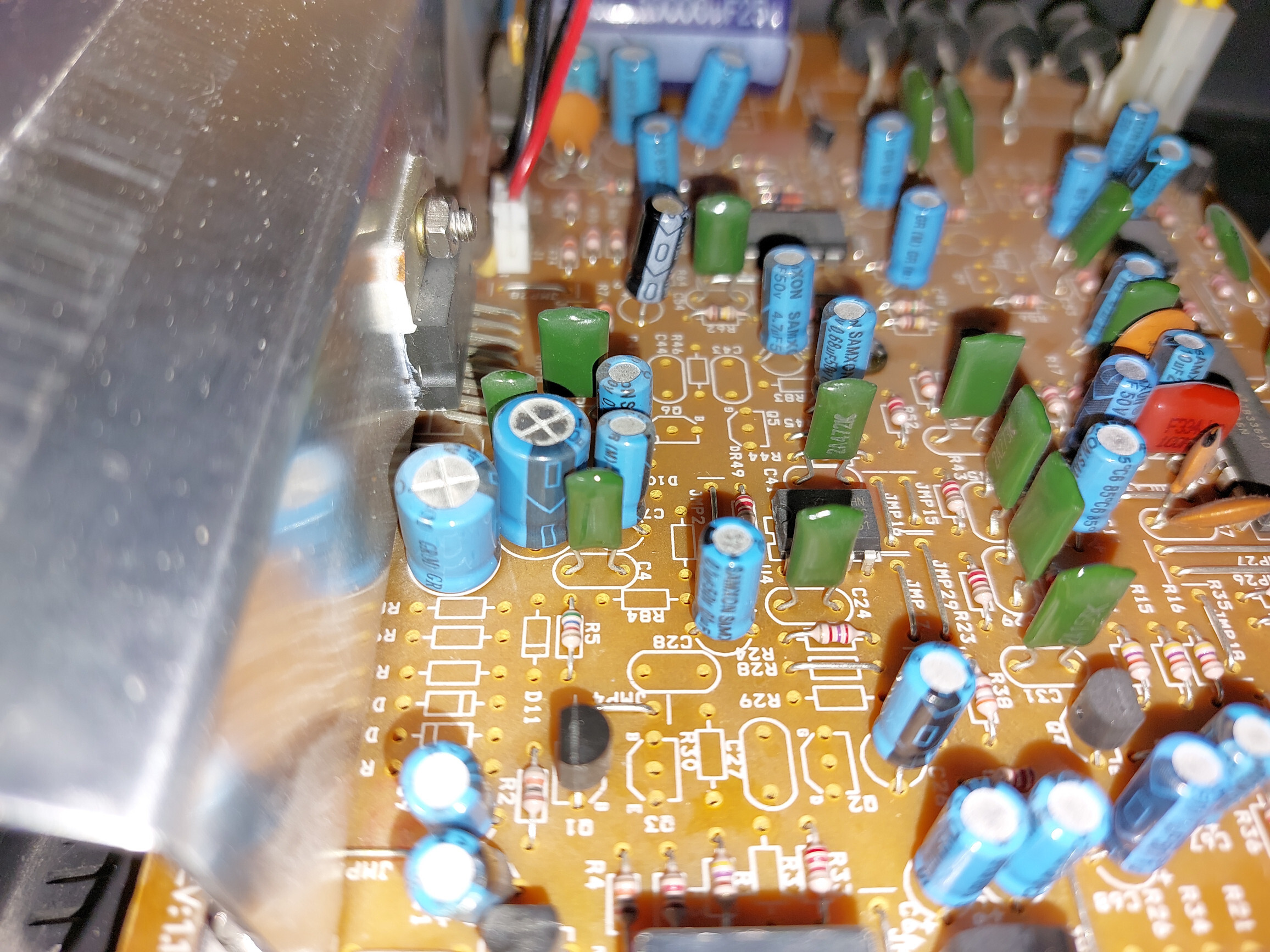

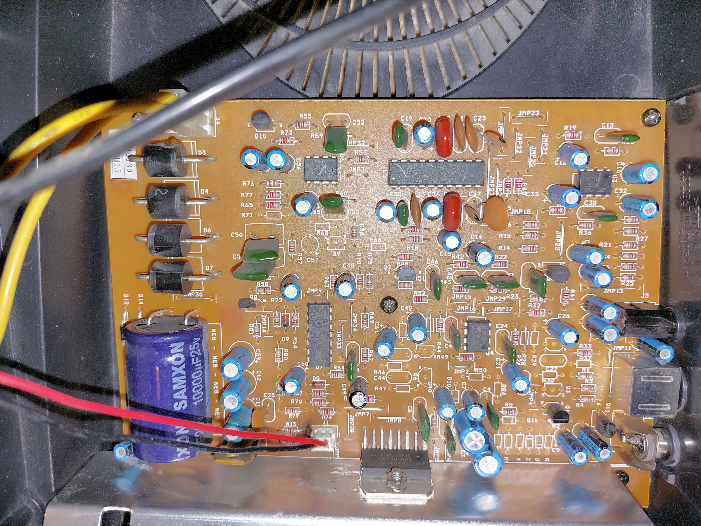

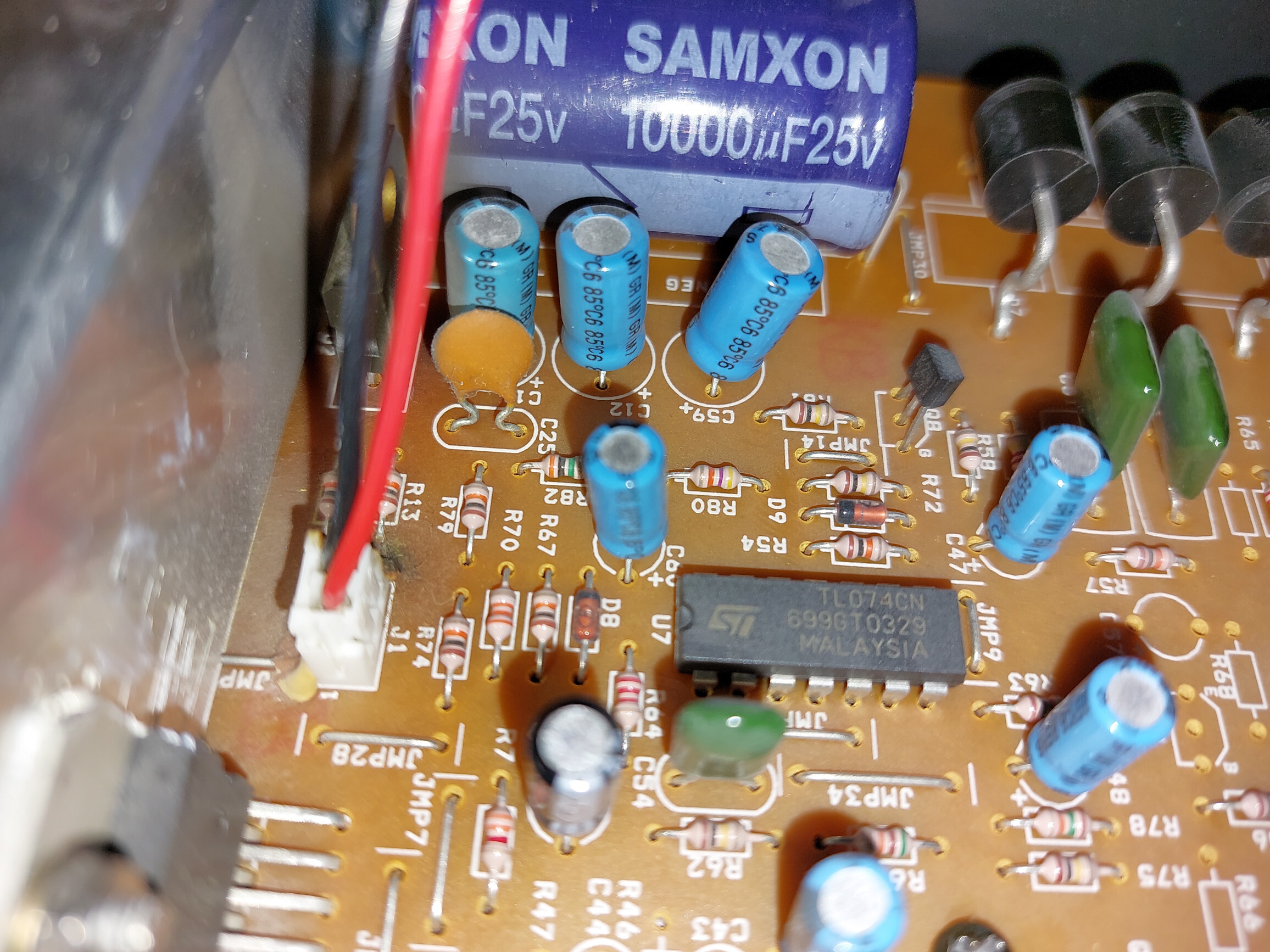

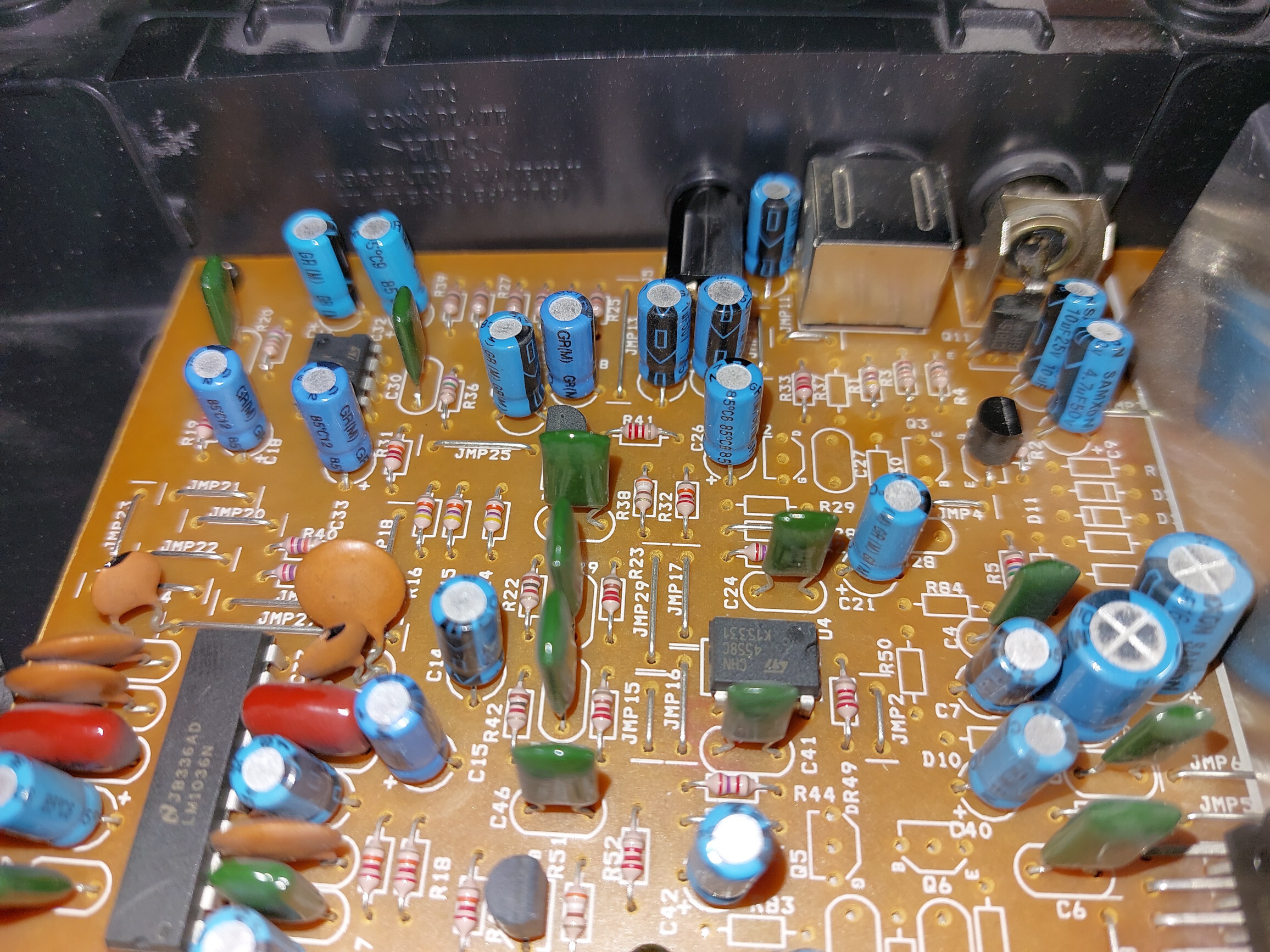

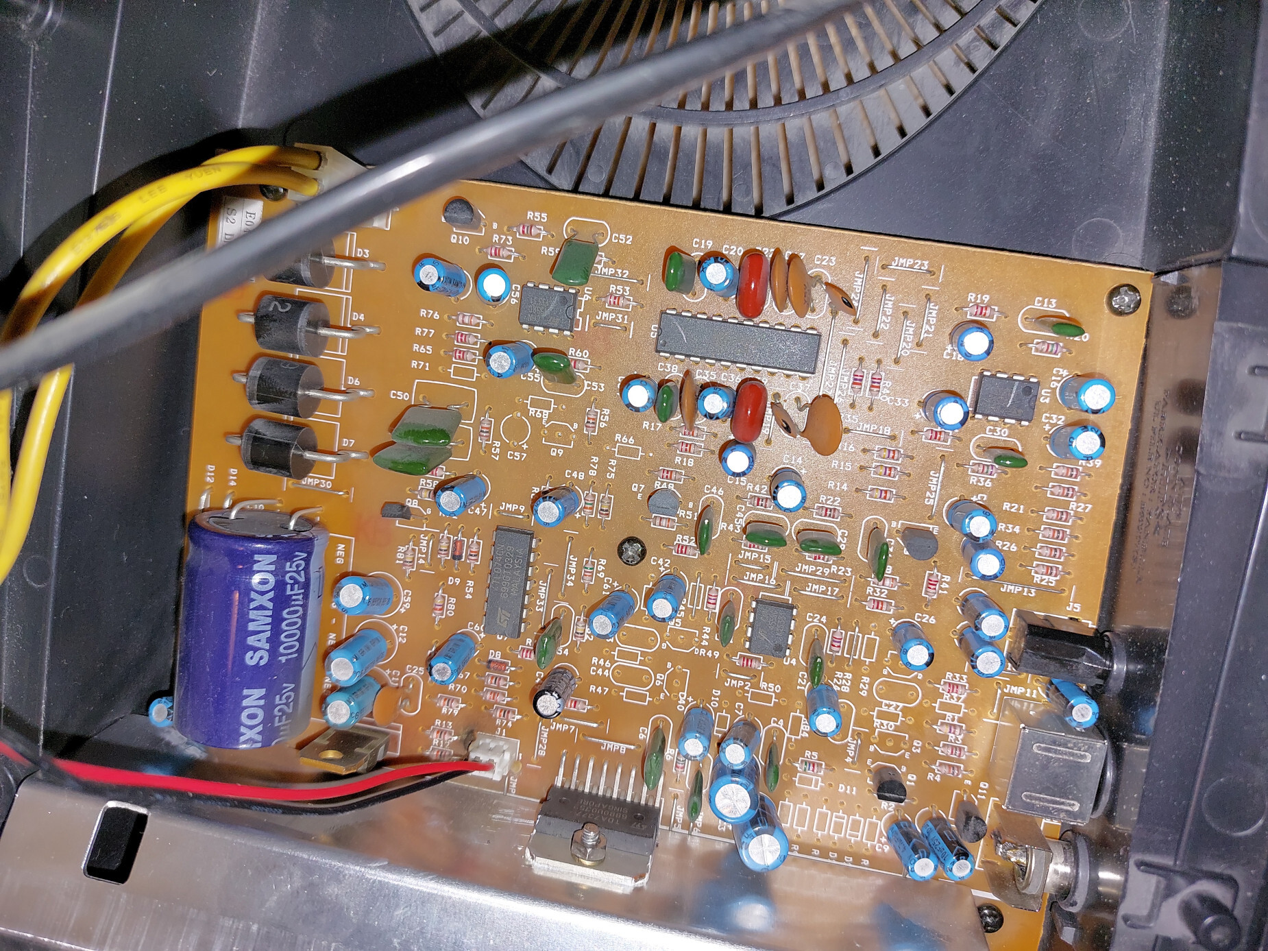

I have this old (2004?) Altec Lansing ATP3 and i would like to replace the capacitors. I have identified 34 out of the 36 of them as Samxon GR of various capacities and voltages.
I can't find datasheets for the Samxon in any of the following variants:
10000uF 25 v - this one i really want to replace because i suspect it is what causes a dull hum regardless of the volume knob position or if the source is plugged in. I am eyeballing the Rubycon 25PK10000MEFCGC18X35.5 for this purpose. So if i pay a 10x the price part for shipping i might as well go ahead and order some to replace the rest.
10uF 25V
100uF 25 V
1uF 50V
0.47uF 50V
2,2 uF 50V
0,1 uF 50V
4,7 uF 50V
47uF 16V
470uF 16V
0.68uF 50V
Now, can i just replace them with some Nichicon UFG/Rubycon/Panasonic FR/FM? If so, what Series?
If anything, could you please provide some generic tips like ripple current, ESR ballpark values?
