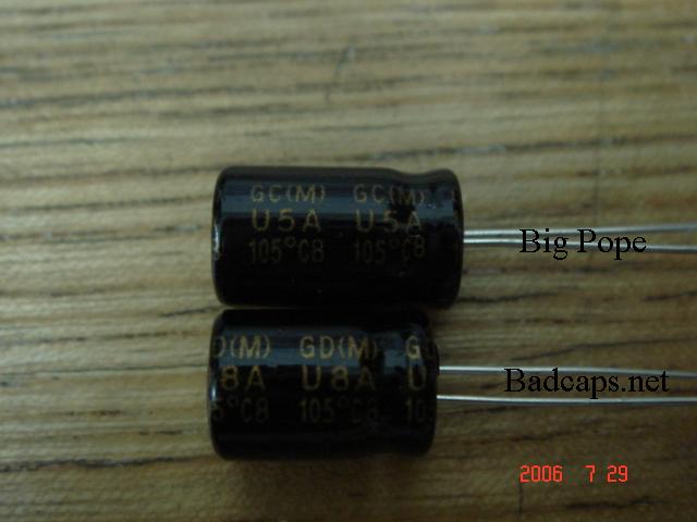

                              Once again, Joe (Big Pope) came through again. Another forum member (Wetback) donated a KT7 to the project, to make it a 4-way competition. As the fourth capacitor contender, I decided on Sanyo/Nippon WG series caps (another personal fav of mine). When I mentioned this earlier in the thread, Joe indicated he had a source for them, and would donate some. As always, he came through with his promise, and they arrived in the mail on Monday. Once again Joe, I personally wish to thank you for all your efforts and contributions with this project!
                              I also have another very generous contribution on its way, and I'll post that information when the items arrive. This project will be launching fairly soon I hope, I still have a few things to round up, but we're almost there!!!
                              Once again, thank you Joe!
                              Here's some pics:

                                Very nice - a big applaud to Big Pope as well, as Topcat for recap work.
                                Any answers to couple questions of mine, Topcat?
                                Sanyo WG aren't any great specs caps, but maybe they hold pretty well?
                                Sanyo WG 1800uF 16V - ESR 0,012 - ripple 2800 (4 000 h) 10x23
                                Come to think, that Chemi-con KZE caps has similar mediocre specs:
                                Chemi-con KZE 2200uf 16V - ESR 0,018 - ripple 2770 (5 000 h) 12,5x25
                                And they are on stock in digi-key as well, as Panny FM ones:
                                Panasonic FM 2200uF 16V - ESR 0,015 - ripple 3190 (7 000 h) 12,5x25
                                Since at first it was a Rubycon, Samxon and Panasonic and then we added this Sanyo WG - then might we as well add the Chemi-con KZE ones?
                                Just find another Abit KT7-R board and 5-th way? Perhaps?
                                I just wonder how nice the Chemi-cons are.
                                More that willing to donate them - eg. pay for donating them from digi-key - but who can donate KT7-R board?
