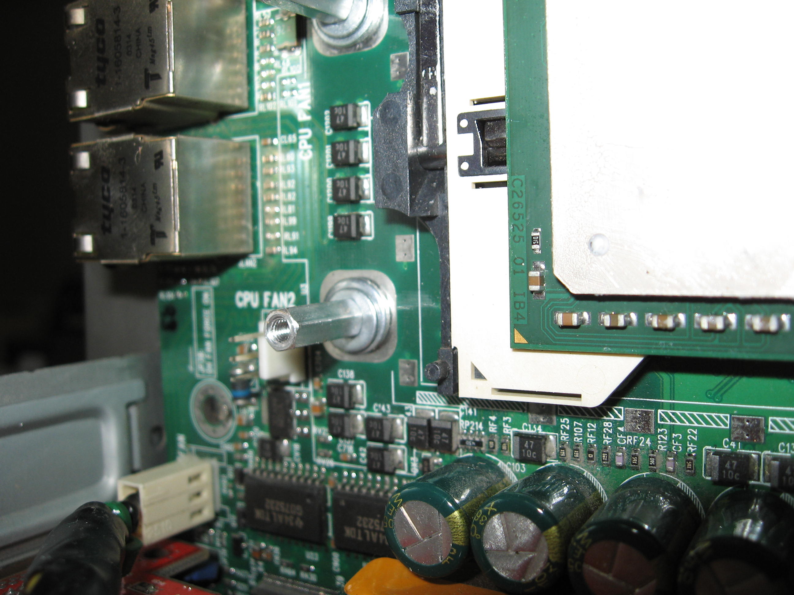

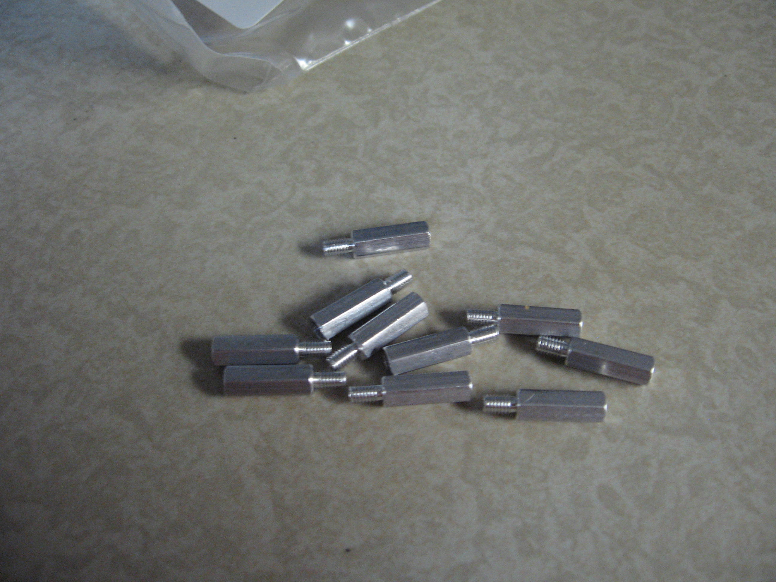

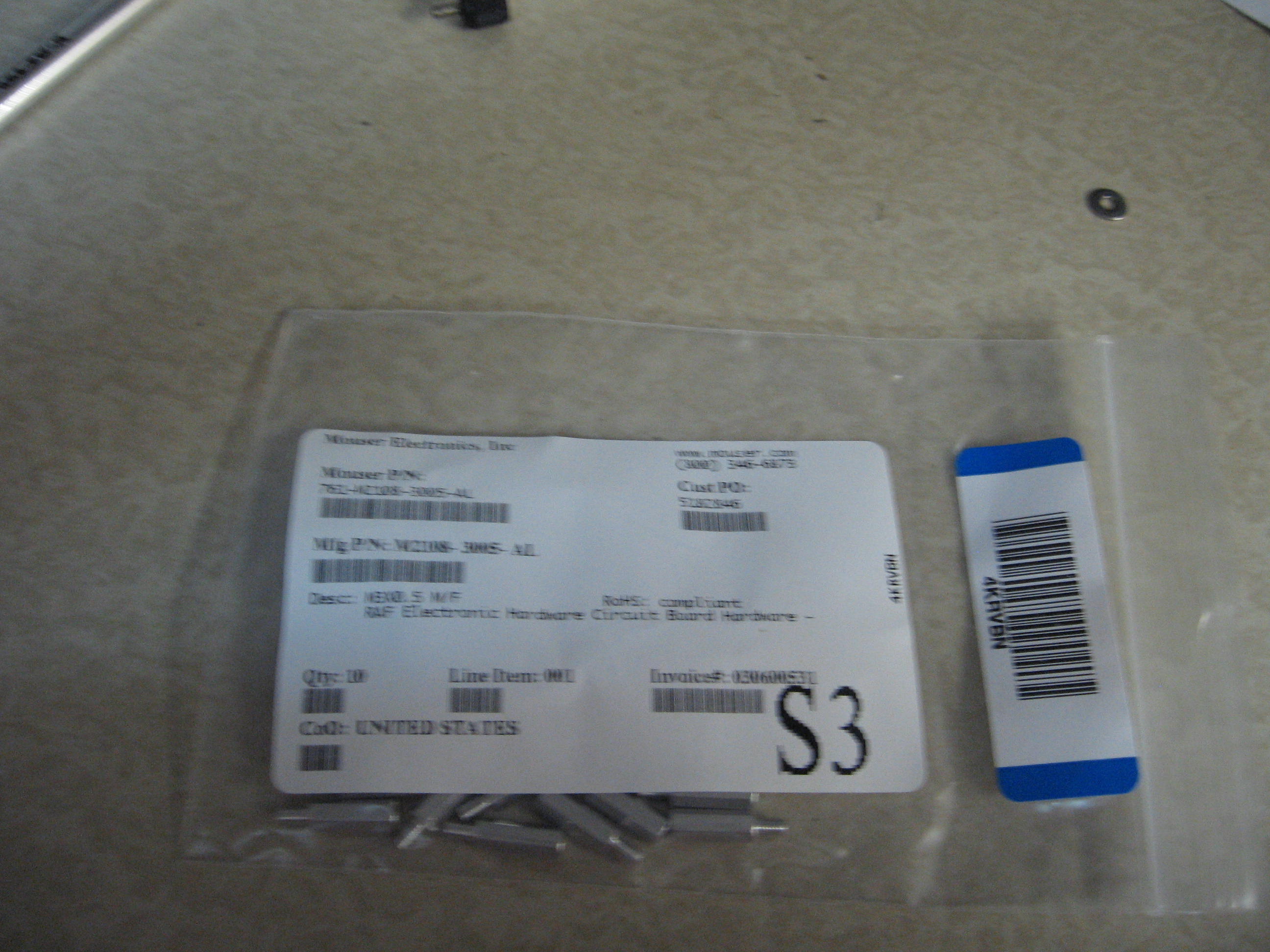

    I ordered the AL Standoffs, as the SS ones were out of stock.
    They came in today:

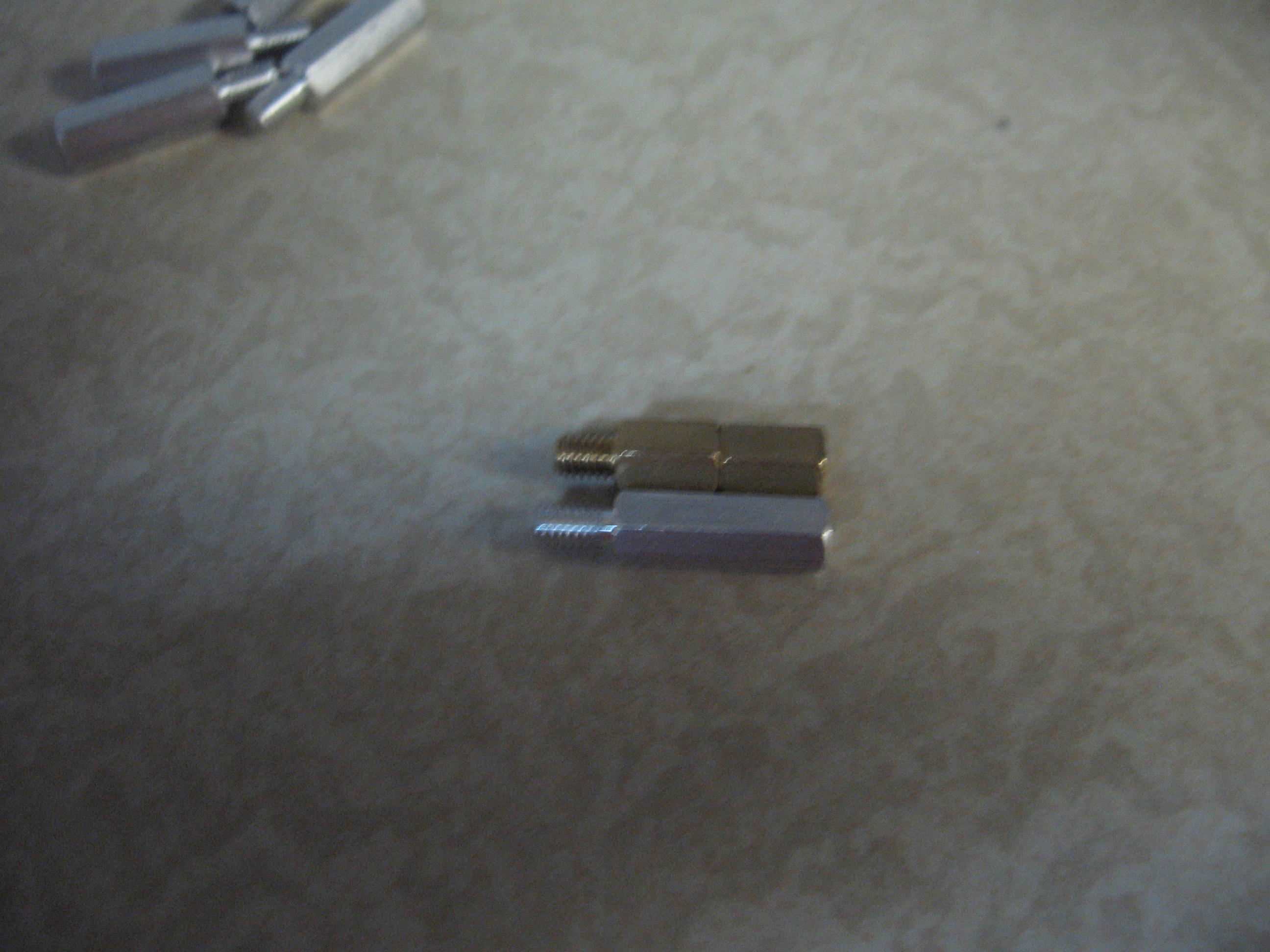

    They are M3 x 13mm, the same length as the two stacked 6.5mm brass standoffs:
    I bought 10 of them even though I only needed 8... this way if I somehow snapped one like I did last time, I wouldn't be up the creek again.

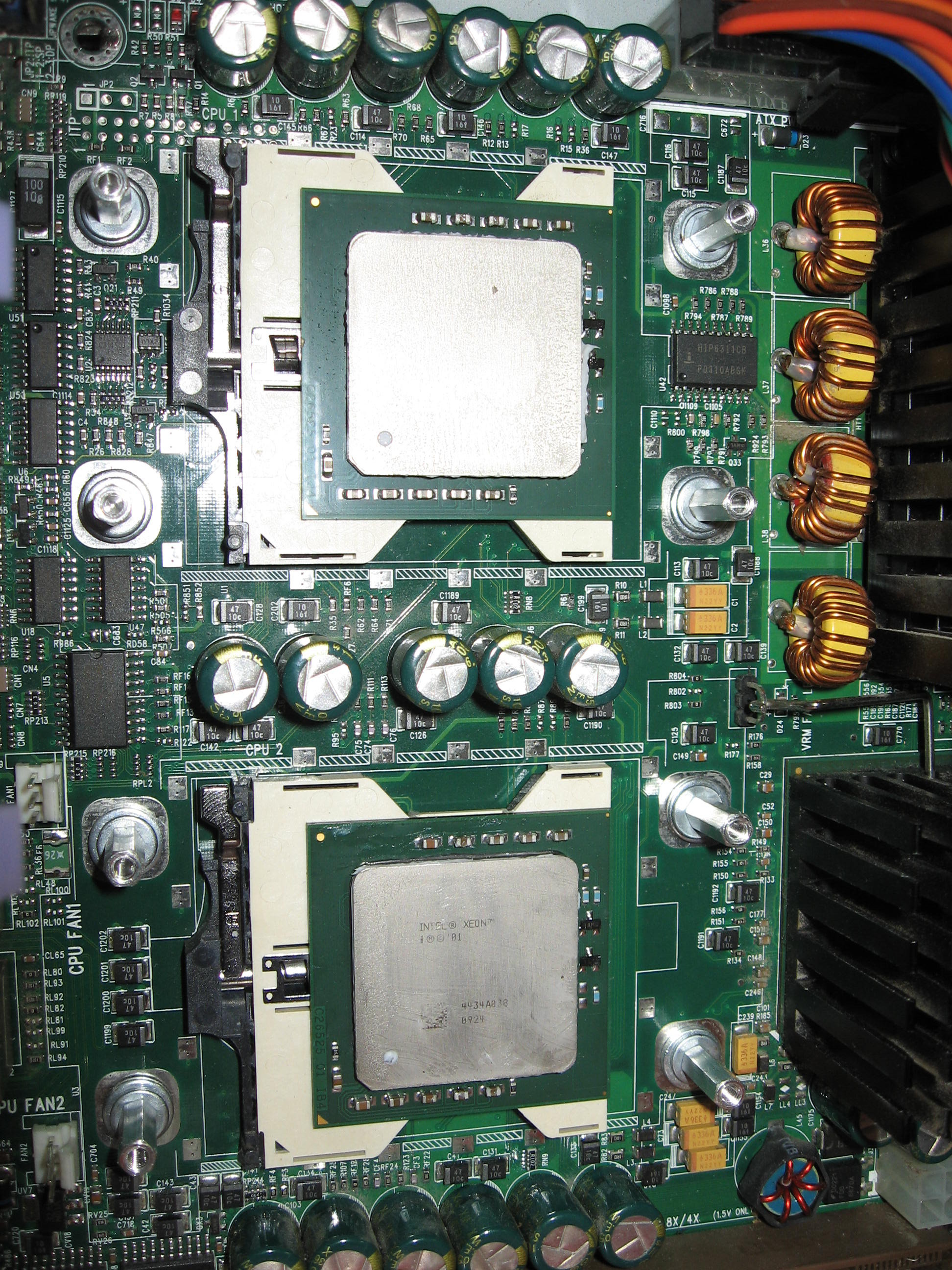

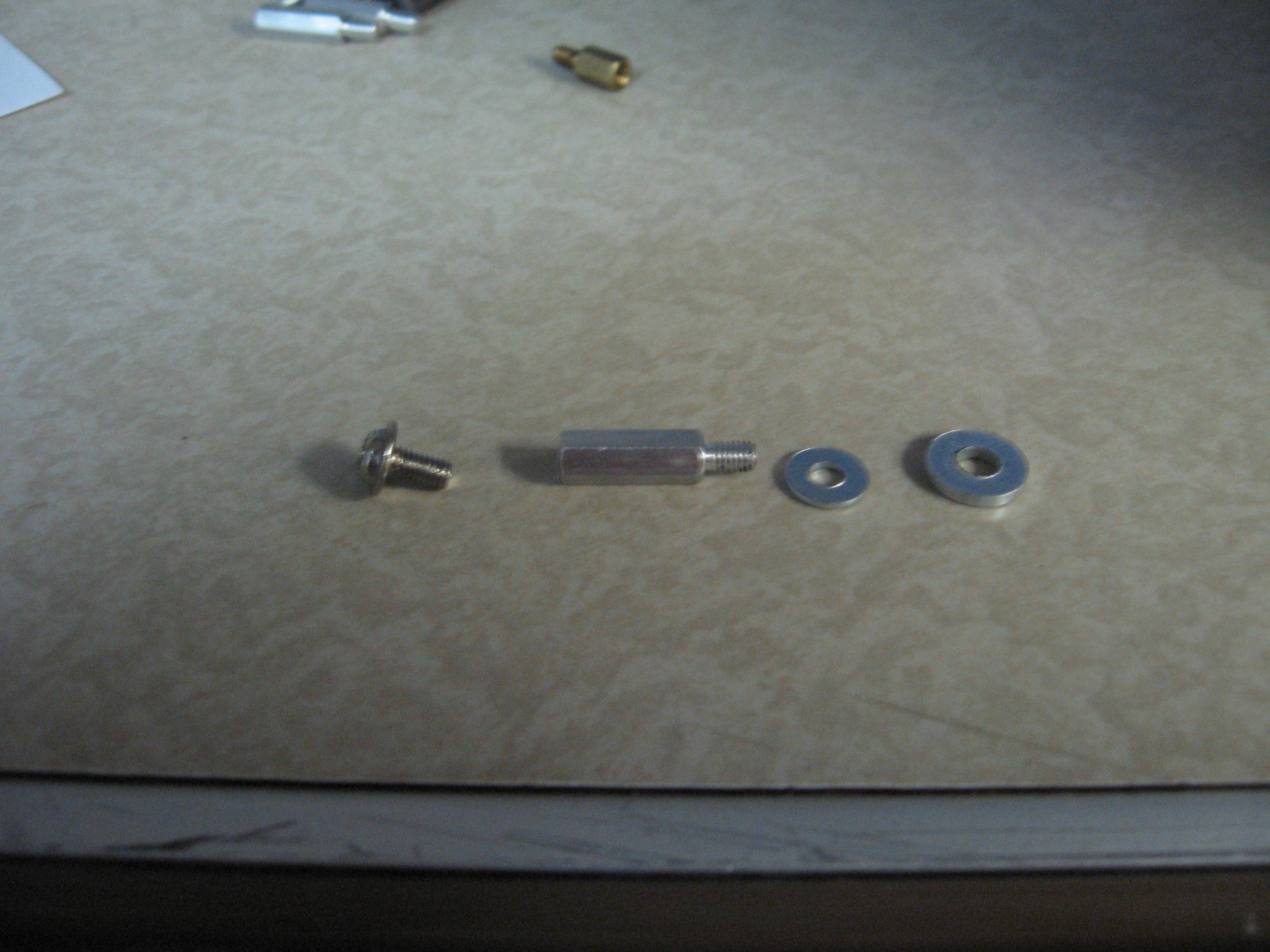

    The final hardware layering :
    Hardware installed (No standoffs snapped this time):

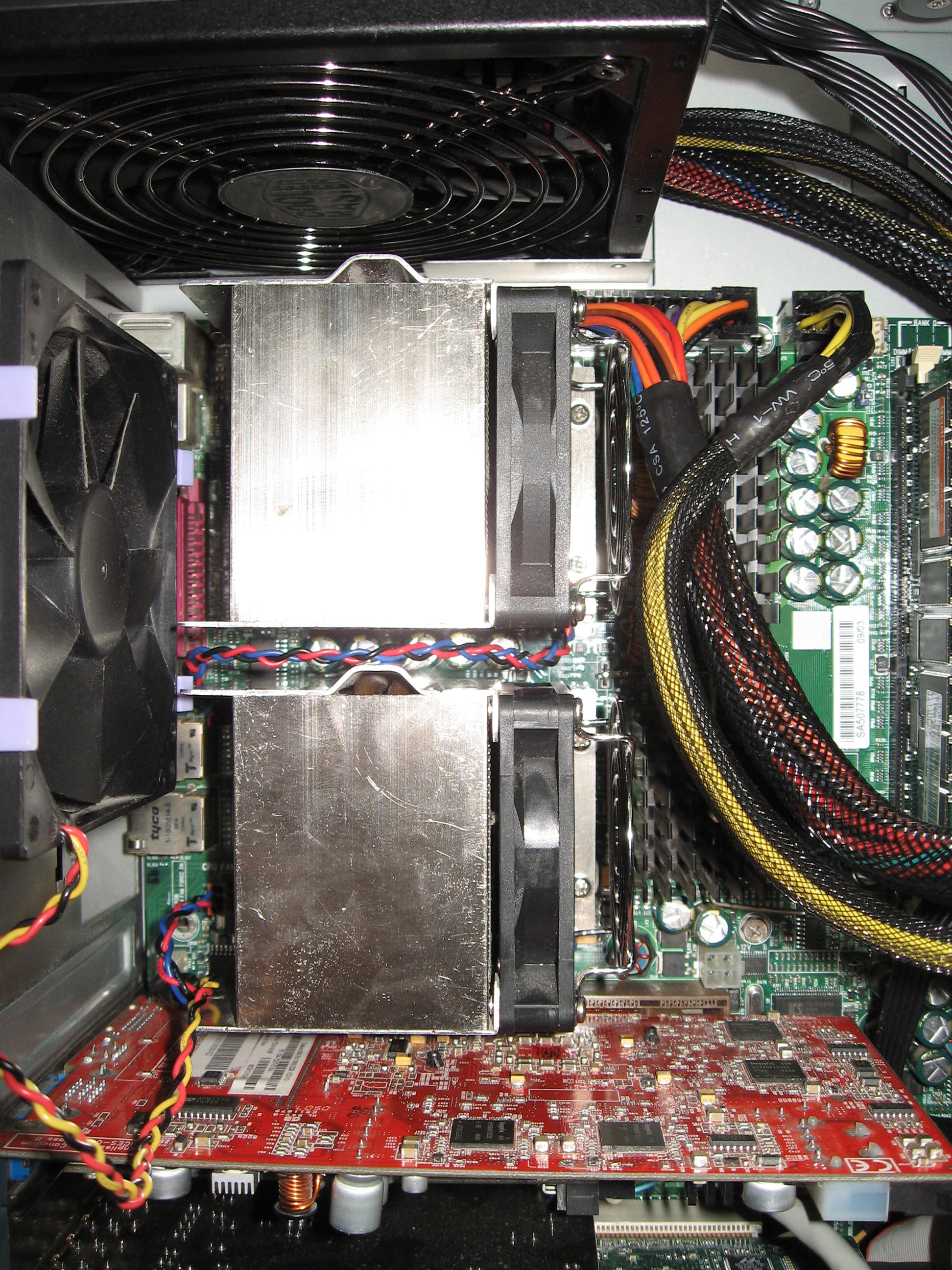

    Coolers installed (fresh thermal compound on both):
    So far the coolers are cooling well with the new mounts.
    Since the last update, I swapped the SATA DVD-RW drive for a PATA one and the DVD-ROM for a CD-RW. I also re-installed the TV tuner, as my problems are partially caused by a sketchy 1ft Coax extension cable that wasn't doing what it was rated to do. The card only picks up a few (maybe 6 unencrypted) channels, not the 100+ my PCI-e tuner could pick up (which is going in a soon to be built HTPC rig).
    All it really needs now is a pair or trio of HDDs (in the works) and some more RAM...

      Some stats:
      Under full CPU load (via F@H), the highest temp I am seeing is 66C... From what I saw at CPU world, I am good up to 71C. 66 is a tad high though... would changing from the generic white Synco Compound I am using to something else, like one of the arctic silver compounds make a sizeable difference?
        Depends, but I usually find that it doesn't matter much.
        The number one mistake a lot of people make is over-apply thermal compound. The "pea-size" method is a good way to over-apply thermal compound in most cases. Not cleaning the old compound and layering new compound on top is the second mistake I see a lot of people make. Both of these can actually make the CPU/GPU overheat.
        As for your situation, do the heat sinks feel very warm when the CPU(s) is at 66C? (for most people, 66C is very close to "fees like burning" temperature)
        - If yes, then the thermal compound is working and you've just reached the capacity of your heat sinks.
        - If no, you may have applied too much thermal compound.
        A good amount of thermal compound is to barely cover the CPU - almost see-through. After this has been done, you put the heat sink on top of the CPU, apply some pressure and twist back and forth a little, then remove the heat sink. The heat sink should now have a very thin layer of thermal compound on it as well. If there are bare spots, add a bit of thermal compound to the CPU again in those areas where the bare spots on the heat sink are located. Put heat sink on CPU again, put pressure, twist, lift, and check again to see if the bare spots are gone. When they are, you can put the heat sink back on the CPU and latch it.
        This is how I do my CPUs and usually I get 2-5C lower temperatures, even with cheap thermal compound.

          Don't get me started on overappying compound.
          IMHO pea-size is often too much on certain chips, specifically ones with an exposed die... my buddy fried a pIII 933mhz due to that (in addition to using an undersized socket 7 cooler).
          I did do a very thorough cleaning of the CPU and heatsink mating surfaces.
          The compound is the ghost-white crap that comes in tubes at radio shack that is normally used for transistors and the like...
          The Heatsinks are pretty hot, so I do doubt it is a compound issue.
          Side-note- the fans are slightly slower than the stock fans. I swapped them because the old fans were really loud 5000RPM PWM fans designed for a CPU with a much higher max TDP and the cables were too short. These fans came of a pair of cooler master coolers from Some 478 Presario celery boxes.
          I wonder if they make higher flow 60mm fans that aren't too loud?
