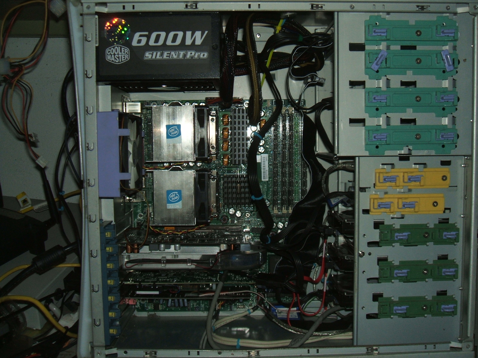

                  Reviving this thread for updates...
                  This rig was stuck in limbo for the better part of the last year and a half... I attempted to Slic the bios which was a huge mistake... and through all of it some settings got dicked up and moron here forgot that one must max our the AGP aperture for it to like 8GB of RAM. Since then, the issues have been fixed and it is back to functional condition.
                  It had been changed though... over the time it was dead, I pulled some parts off it for my two other workstations... it presently only has a single optical drive, an IDE HP lightscribe burner (a nice one) and the hdd shoved in it died (2nd dead WD 320GB in a row) and was replaced with an 80GB seagate clay pigeon. Until recently it was also missing the psu. FinallyBut now it is running again and about to see a couple upgrades.
                  First, I scored a gold pcb'd firework card with an internal header... and more importantly, a discreet power connector, a Berg. To use it I will need a molex adapter, which I will be making myself as nobody makes one in black presently. Not really a needed upgrade, but I've always heard that it was best to use a firework card with such a power connection to supply the 12V.
                  Second, I found a seller on eBay with 3 Seagate 160GB 7200.9 drives for 9 bux a pop. To go with that, I also bought some fresh SATA cables and a 3ware 9550sx with BBU. The 9550sx, based on my experience with the other two rigs, is much faster than the 9500s, even with 7200RPM drives. I'll stripe the three, and this thing will fly again (it already does with the single hdd, minus slow booting).
                  I'll take pics of it once I've made the swap... in the mean time, I'll be keeping my eyes out for a fresh burner for the 2nd optical (the LG drive was a turd and the lite on was moved to another rig).

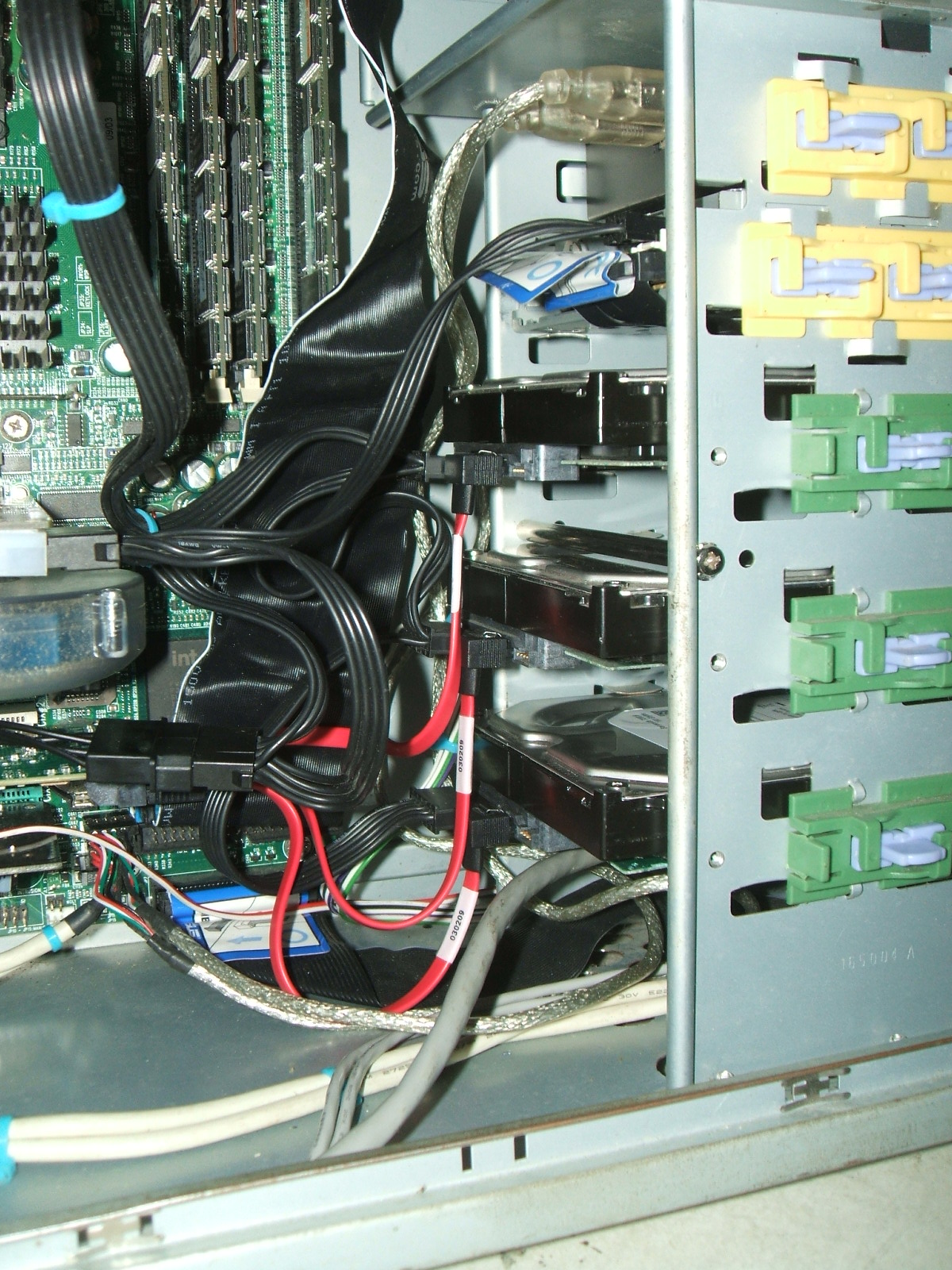

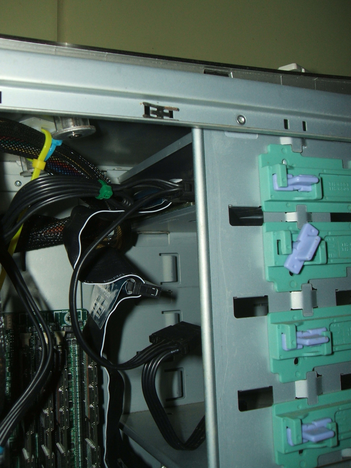

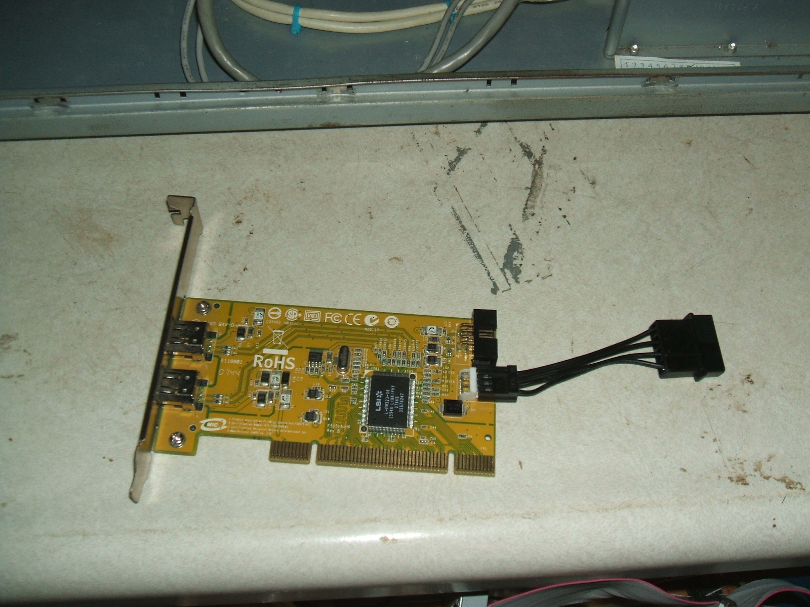

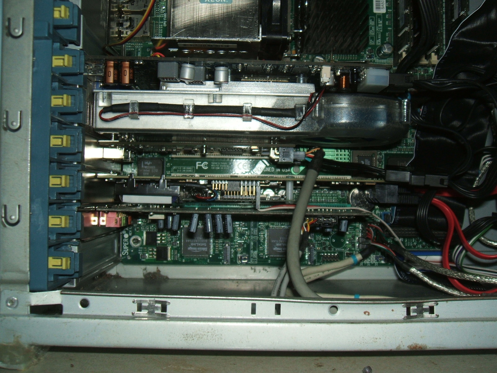

                    After re-learning the install process a couple of times (the PAE RAMdisk seems to make windows live essentials not install w/o an error), I have it running... and here's the pictures I promised:
                    An overview of the updated hardware:
                    First, the (unfortunately empty) 2nd 5.25" bay:
                    Next, the 3 HDDs and thier cabling:
                    I think it turned out better than the last setup like this.
                    The new 1394 card and custom made adapter:
                    Finally, the new card layout:
                    IMHO the custom molex adpater I made looks pretty nice, an off the shelf colored one would look like shit in comparison. Speed wise, time will tell... I did novabench it before I had to re-install windows (to make it so live mail/photo gallery would install)... but I had a hard time buying the results. I may re-bench it and post the result.
                    How does it look? Aside from a 2nd Optical drive, this will probably be the final update to the machine... it's maxed out (physically and/or economically) as far as possible. For a 2003/2004 vintage platform (with some modern GPU assistance), she runs pretty well.

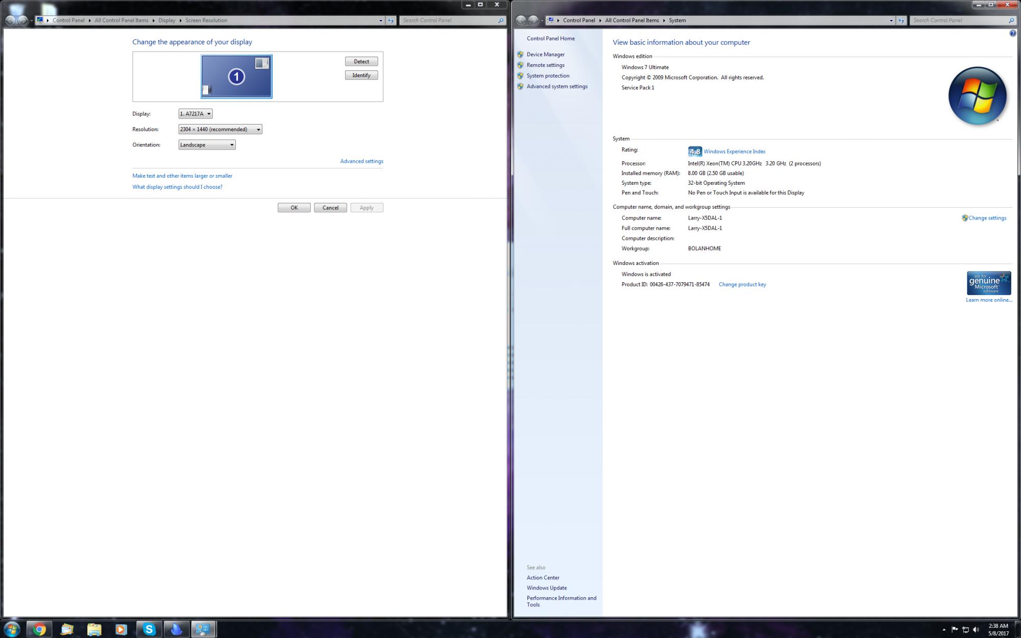

                      #270
                      Re: Ratdude's Main rig V2
                      I've been up to no good. Thanks again, Topcat!
                      (see attached screenshot for what i'm doing...)
                      sigpic
                      (Insert witty quote here)
                      • mariushm
                        • May 2011
                        • 3799
                        #271
                        Installed memory : 8 GB (2.5 GB usable)
                        Good luck with that.

                            That's not new. Read the thread again. 8gb with 4.8gb in a PAE ramdisk, of which 4gb is page file and the remaining 800mb is a self clearing temp file.
                            For the real change: Hint look at the picture's filename.
