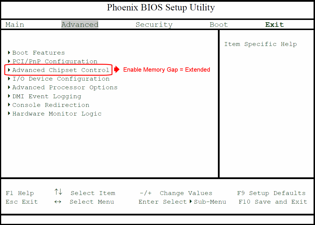

    Nope. Not in the X5DAL-TG2 bios (and it is indeed pheonix).

          Uh oh. Gavotte didn't see the extra RAM. Am I f*cked?
          edit- never mind, moron here probably forgot to enable PAE. Let's hope that's it.

            Re: Ratdude's Main rig V2
            Nope. Thanks to the lack of remapping in my BIOS, I'm fucked.
            edit- No I'm not. I had an old copy... a new one had an extra registry and worked. 4.8gb Ram drive created.
              Used 4gb for paging (max allowed), not sure what to use the other 800mb for. Too small for temp?
                That's what the X5DAL-TG2 manual says . Anyway if ...
                ... worked. 4.8gb Ram drive created.
                ... most def your system has both PAE & mem remapping enabled.
                Things you can move into a volatile (vanishes on shutdown) ramdisk:
                · Pagefile, fixed or variable size according to your needs. Set, restart, then set no pagefile in any other drives, set and restart.
                (If Windows starts bitching it can't find any pagefile, put one minimal fixed size 16-16 MB vestigial pagefile into some SSD/HDD, that will stop the bitching).
                · User & system environment variables %TEMP% and %TMP% :
                · Browser cache. The procedure varies according to browser.
                · Any other application cache &/or temp files suitable to move into a volatile ramdisk, like Photoshop scratch disk.
                With a non-volatile ramdisk (saves on shutdown, loads on booting), the sky and the user's tolerance to long booting times are the limit.
                ... not sure what to use the other 800mb for. Too small for temp?
                Should be enough 99% of the time. I used 767MB with Se7en without problems.
                Anyway should conflict arose, you can always shrink the pagefile to leave more room in the ramdisk, or point back %TEMP% & %TMP% to any SSD/HDD, to solve the situation.
