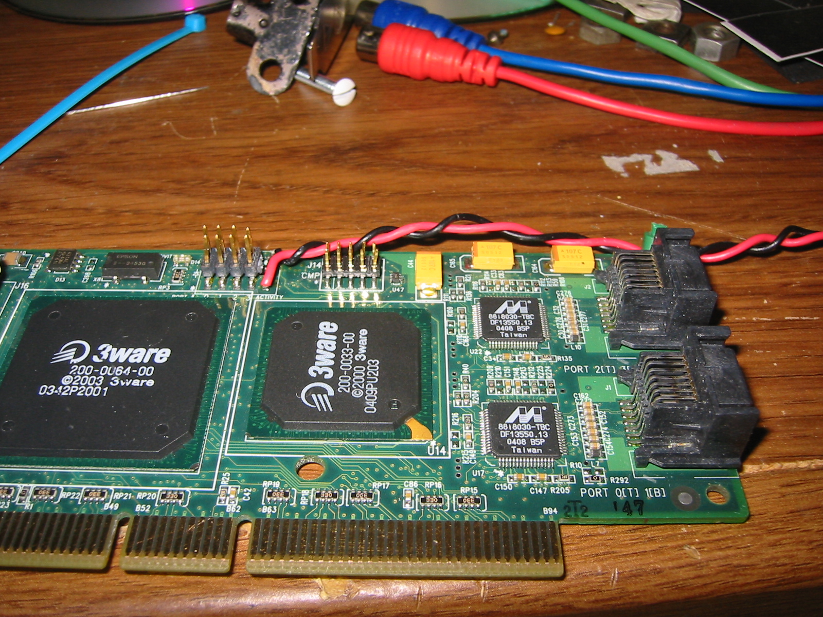

                        Bad news: while test-fitting the 3ware, I snapped on of the pins on the activy LED header pins.
                        Good news: I was able to fix it:
                        On the plus side, this makes it easier to plug in the HDD led and fixes the clearance issue with the header... right below the card, there will be the tuner:
                        top to bottom ( device (slot) ):
                        -AGP GPU (AGP8x)
                        -1394 (PCI)
                        -Sound card (PCI)
                        -controller (PCI-X 100MHz)
                        -Tuner (PCI-X-66MHz)
                        yup, all slots will be filled...
                        I know the fix is , but does it look ok anyway?

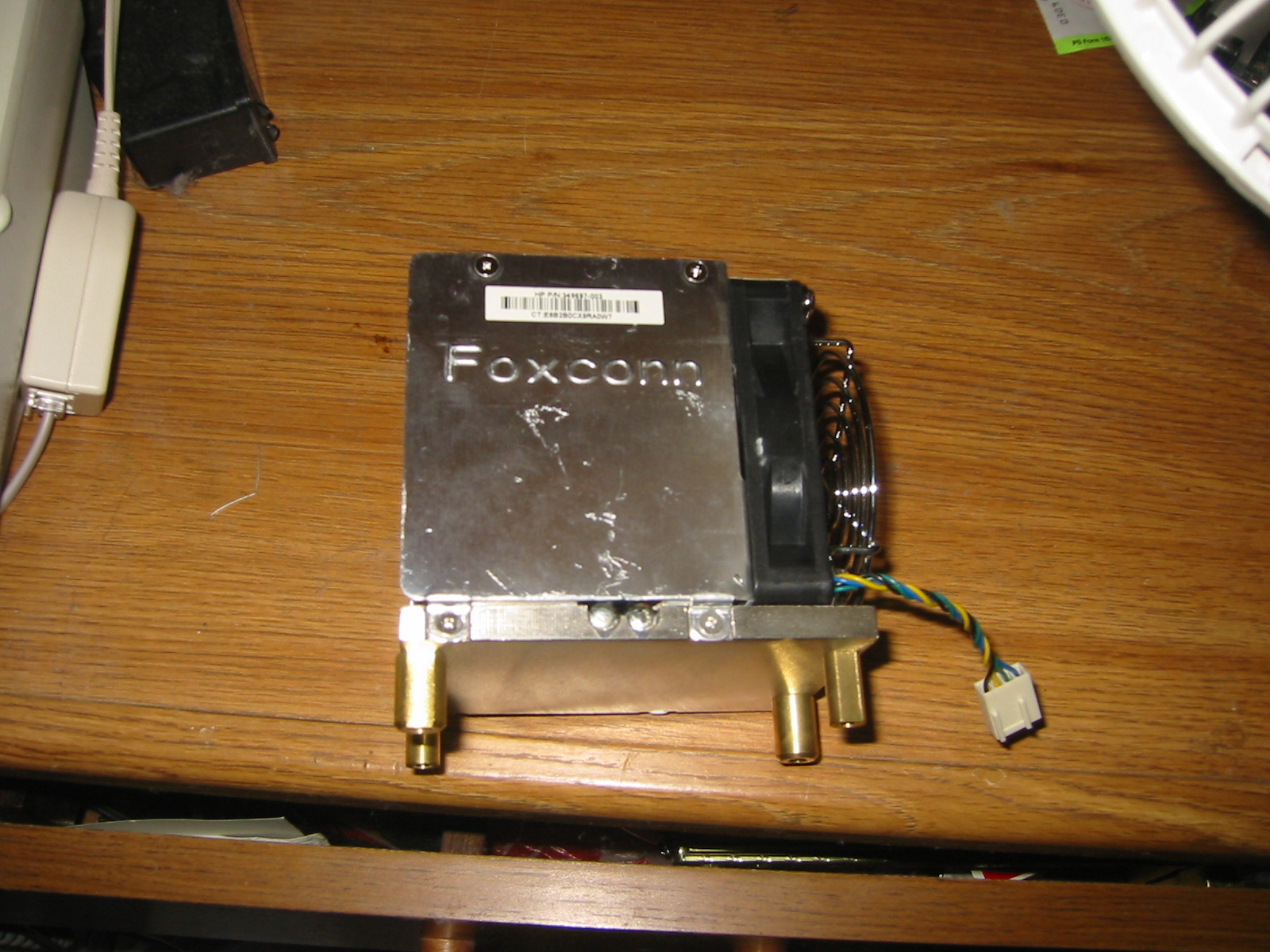

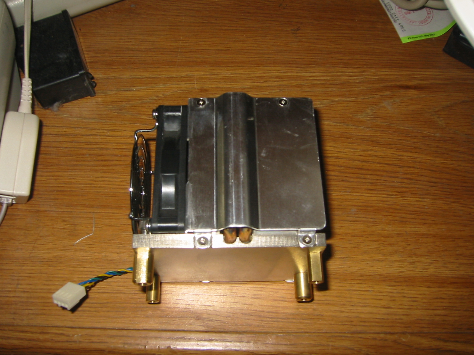

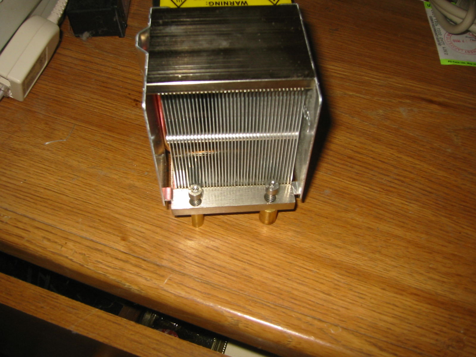

                                  Surprise tonight. The coolers arrived... at my old house in West Lafayette, IN.
                                  My only guess why is because the coolers came from hypermicro's warehouse (that other site I bought from had a lot of the same stuff, no shock) and I bet they found my old, obsolete hypermicro account with the old address.
                                  I found out because I was staying there tonight for a FIRST robotice regional I am volunteering at tomorrow (well, today tecnically) and Saturday. I arrived to the house and to my shock I find a fedex note on the door and a hypermicro box below, with the coolers inside.
                                  since I brought my camera, some pics:
                                  the side shown by the site's pics:
                                  the other side:
                                  and the mounting system:
                                  (According to the "seller", the mainboard yet to be shipped has matching threaded backplates)
                                  I will be swapping the fans with a pair of cooler master labeled deltas pulled form some junk 478 celeron Compaq presarios... the replacement fans will have longer cables (needed) and also will run quieter while still moving air (my board doesn't have PWM). Once I get to my current home on sunday, I will swap and take piics of that.
                                  I also got a $2 discount per CPU ($10 instead of $12) because they were listed as new but they went to ship them and found they were used and had a few "marks". They offered a refund or a $2/cpu discount... you can see which I took... and heck, for $10 a pop, IMHO its a steal. (604 coolers are not cheap).
                                  Comments?
