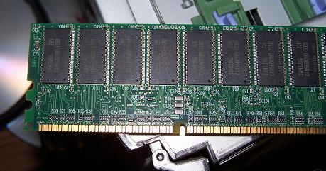

                UPDATES:
                The new GPU (9800 pro) came in, as did the 3th DDR stick.
                The good news: the GPU works-- it is requiring an OS (Mageia 2 beta2 GNOME) reinstall due to firmware issues though.
                The bad news:
                See the issue? No? Look at component C84:
                Yup... the second dead 4th stick in a row due to Physical SMD damage... (the first one, not mentioned previously, had an SMD cer. cap snapped off)
                an updated pic:
                (it doesn't work with 3 sticks or RAM and an unplugged GPU as shown)
                Looks like I need to find more ECC DDR... Anybody have a spare PC2100 512mb ECC stick?

                  #68
                  Re: Ratdude's Main rig V2
                  Seriously? Just 1 cracked ceramic cap and you're calling the whole RAM module dead?
                  Just remove the cap and test the RAM stick. Chances are that it will work fine. And even if it doesn't, it won't kill your other RAM - it will just lock/crash your computer. In that case, find a ceramic cap of the same size on a junk board, take it off, and put on your RAM module.
                  Last year, I accidentally bumped my "RAM bag" (a small bag where I keep most of my RAM modules) and it fell on the floor. Several modules had ceramic caps destroyed. One even had slight trace damage. 1 hour later with the soldering iron, and I got all of those RAM modules fixed.
                  If you have flux, you shouldn't have a problem soldering these components back.

                  • ratdude747
                    Black Sheep
                    • Nov 2008
                    • 17136
                    #69
                    Well, here is what happened:
                    1. I put all 4 modules into the computer.
                    2. I get a "spin fan" condition
                    3. I try different pairs of RAM to determine it is the faulty chip
                    4. I look and find the broken cap.
                    I might be able to swap a cap from the first dead module (its missign part is unknown)... I do have flux, so I'll give it a try...

                      master hoarder
                      • May 2008
                      • 12175
                      • Bulgaria
                      #70
                      Ceramic caps are delicate and when they get cracked, they can become shorted. So it's possible that's the reason why you got the "spin fan".
                      As for the other dead module, post a picture of the area that has the missing part. I might be able to identify it.

                        #71
                        I lost the other dead module... it was a screwball ECC stick that was low profile (regular non-ecc height).
                        I did find a similar cap on a a dead linksus router board... and with some braid, a flux pen, and my newly acquired weller w-60P w/ a tiny tip, I got it swapped. it isn't pretty but it's attached. Once the computer is done re-installing mageia, I'll test it.

                        • ratdude747
                          Black Sheep
                          • Nov 2008
                          • 17136
                          #72
                          I mispoke about what the cracked module did... it would void the whole bank at boot (only the 1gb in the other bank would show up). unlike a 3 module mix where it would spin fans, this failure was weird.
                          The fix was not successful... same symptoms.

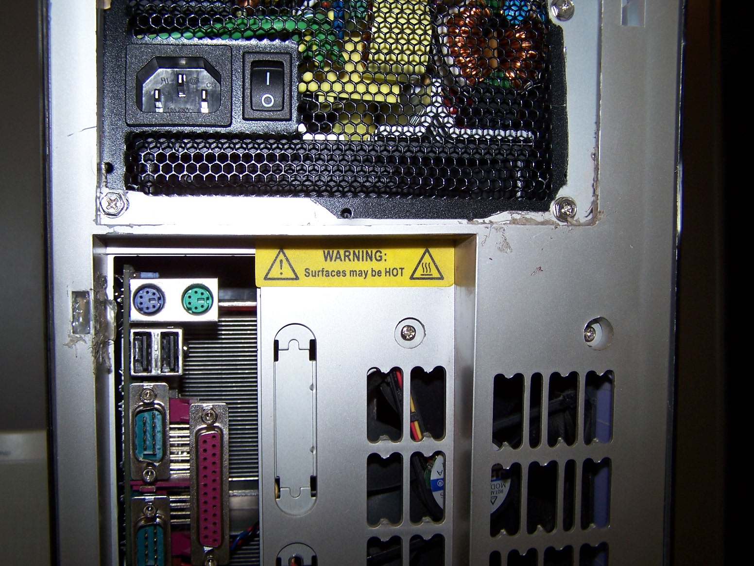

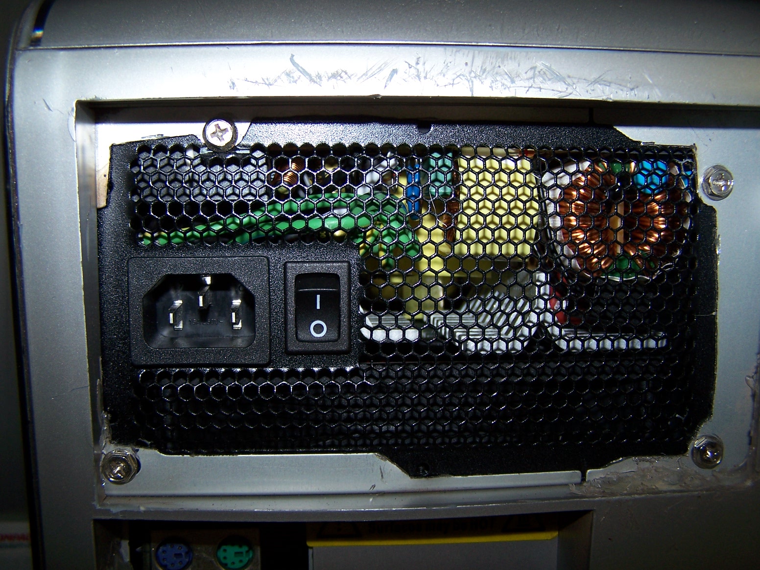

                                • ratdude747
                                  Black Sheep
                                  • Nov 2008
                                  • 17136
                                  #76
                                  A belated update:
                                  awhile back I recieved a 600W CM PSU with a bad fan controller (thanks Everell!) that I fixed... It's modular too. As luck would have it, it had the right set of modular cables included (1 3x SATA strand, 1 3x molex strand, 1 2x molex + 1 berg strand, no PCI-e strands).
                                  The only caveat was that the PSU fan hole wasn't compatible with the PSU (the grille sticks out) and for a while I could only install the screws part way.
                                  Today I fixed that using my dremel...
                                  Pics of the new setup to come later tonight.

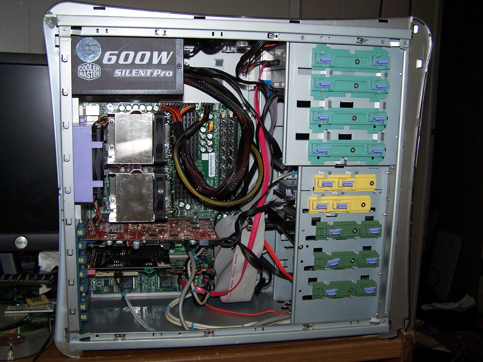

                                    #77
                                    Some pictures:
                                    That should help with the airflow...
                                    That is one of the stickers that came on the coolers' original fans. I placed the other sticker on the bottom of my Dell Latitude D630 (It does get hot, so it applies).
                                    I love how clean the wiring looks now... every strand has a use, there are no extra cables. Since it is a single rail unit, the lack of PCI-E doesn't affect the available wattage.
                                    Yes, I know my desk is a mess... and don't sweat the CDs, they are virtual coasters (out of date beta disks).
                                    Now to find more RAM for it... 1gb isn't quite cutting it.
                                    The computer is missing a part previously installed. 5 points goes to whoever can spot it .

                                    • t.j.
                                      • Apr 2010
                                      • 383
                                      • canada
                                      #78
                                      not tuner card~!
                                      • Topcat
                                        The Boss Stooge
                                        • Oct 2003
                                        • 16959
                                        #79
                                        Originally posted by t.j.
                                        not tuner card~!
                                        yup. tv tuner is gone

                                        • ratdude747
                                          Black Sheep
                                          • Nov 2008
                                          • 17136
                                          #80
                                          not tuner card~!
                                          You have been awarded 5 points.. what the points are good for is beyond me
                                          What happened was that the tuner card was choppy under my distro and I suspected it was the card. combined with the fact that me-tv was only picking up 16 channels and that myth TV was an epic fail (to date I have NEVER gotten it to work with anything), I removed the card.
                                          I may put the card back in if I try something like debian testing... Mageia impressed me at first but the list of unfixed bugs is getting pretty long... If I can get my sound card working under it then I may try the card again.
                                          Edit- Topcat also gets 5 points since he beat me to the punch.
