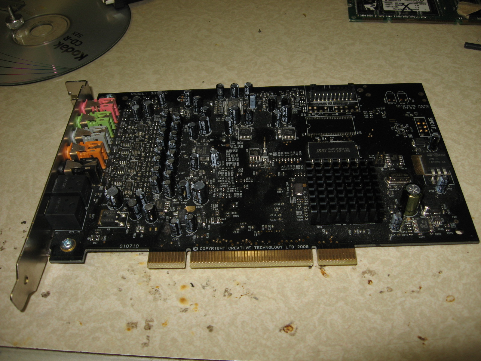

        Sound card came in.
        Good news: Linux seems to like it better... so far so good.
        Bad news: It wasn't quite as pictured and has the proprietary Dell jack instead of the usual AC97/HDA jack (I should have known better)... but the PCB has the holes for one. All the pins translate between jacks (confirmed via multimeter), so I'll order some 10 pin 90 degree jacks and swap them.

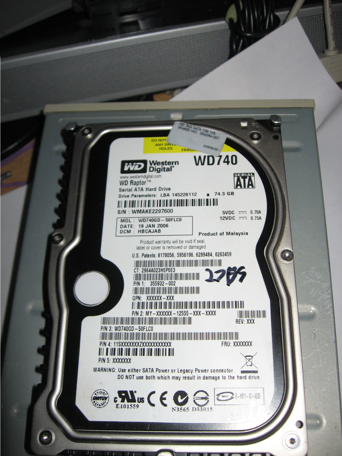

            I think I found the culprit:
            I went through each of the two drives... the first two had a clean bill of health... while drive #3 had 26 bad sectors. There were none pending, but since I had an extra drive (no bad sectors), I figured I'd try the spare tossed in with the two good drives.
            I also swapped in the RAM module that originally came on the card... Just to see what would happen.
            So far, the new array is rock solid and wicked fast. I used a 64kb stripe this time.
            Good thing Shovenose's buddy was selling the drives in lots of 4.
            As for the cause of death, I won't point fingers. There was one drive that I unwrapped and didn't re-wrap after unboxing them in my van... Not sure if that was the failed drive... But a dead drive is simply a dead drive. Sh!t happens.

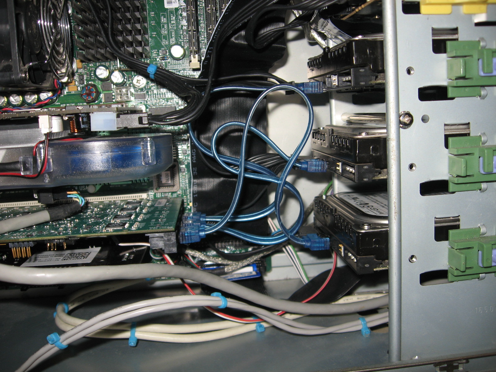

            In the mean time, here's a few quick pics of the rig so far.
            General inside:
            GPU installed:
            RAID card and HDDs:

              No pics of the card itself... because I first went about fixing the stability issues (which I determined were not related to software).

              Right after I posted that... CRASH!
              Right now I'm trying them on the old RAID card... if it keeps running, then I can blame the card (write chaching is enabled right now). In that case, I'll need to review my ebay warranty... since the BBU is still good, I don't want to have to return the whole card. Heck, after close inspection, all the old card needs to run the BBU is the BBU jack... which I'm going to order off digikey and solder on.

                Knock on wood, but it seems to be working better on the old card. BBU jack ordered (a $1.70 part, why my card omitted it is beyond me).

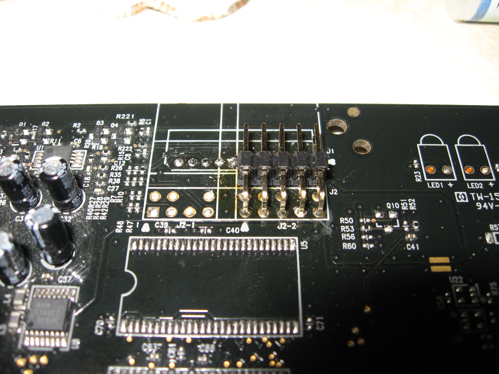

                      Today's Modding activities started with some seemingly simple solder mods.
                      First, I changed my sound card:
                      (Once Topcat ships my latest order, that 220uf 25V G-luxon will be history)
                      ...from this:
                      ... to this:
                      Getting the old jack off was a PITFA. I ended up snipping it out with flush cutters and desoldering out what I could. Removing headers is always a PITA... the pins are so tight in the holes.

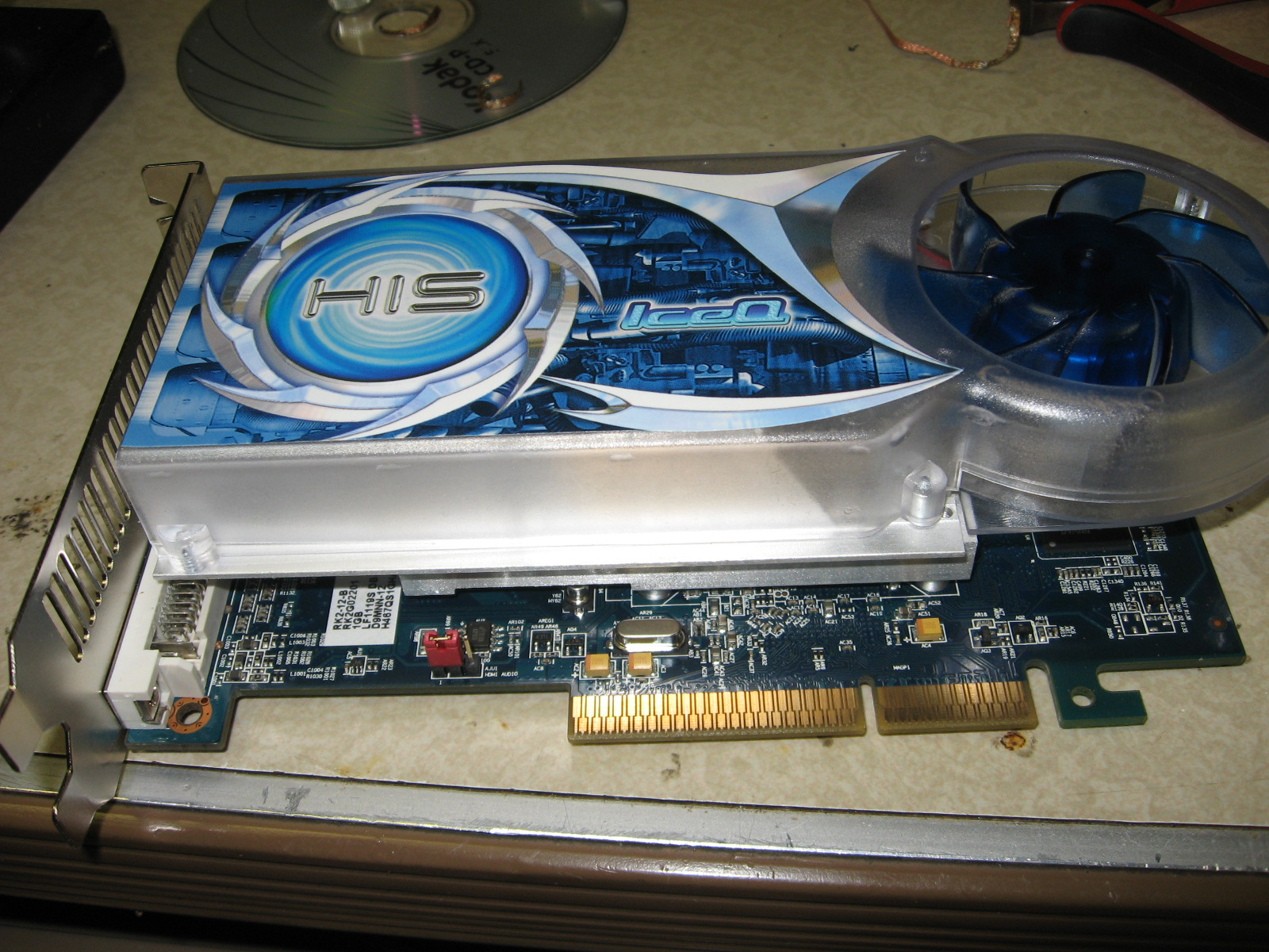

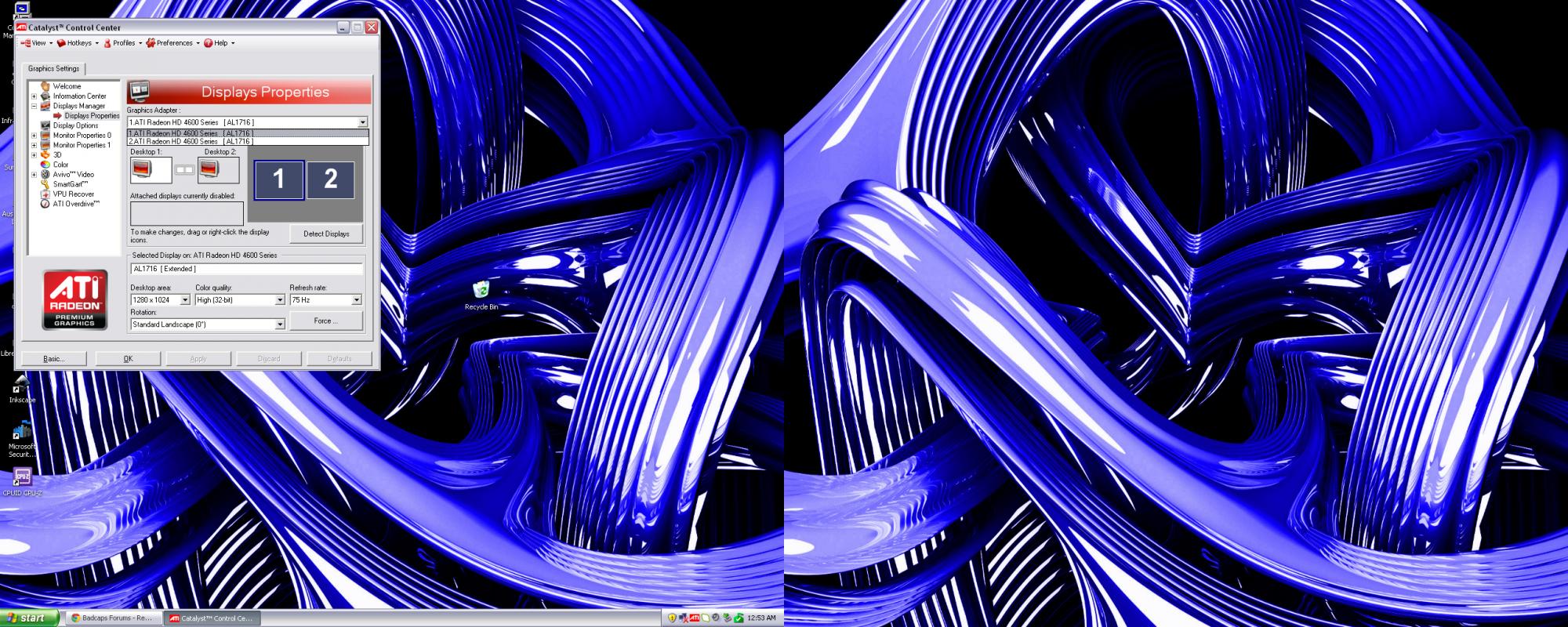

                      Here's my new GPU:
                      It's an ATI Radeon HD4670, 1gb. AFAIK it is the fastest AGP card EVER made.
                      It also runs cool due to the newer chip and a well designed Artic cooling cooler (or so the sticker on the fan says).

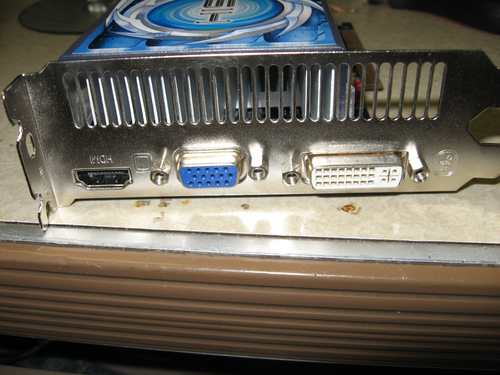

                      The I/O:
                      Which, in addition to working with dual VGA monitors (via a DVI to VGA cable), It also is game for a down the road DVI upgrade:
                      (that adapter won't fit with the card installed in the case, but you get the point).

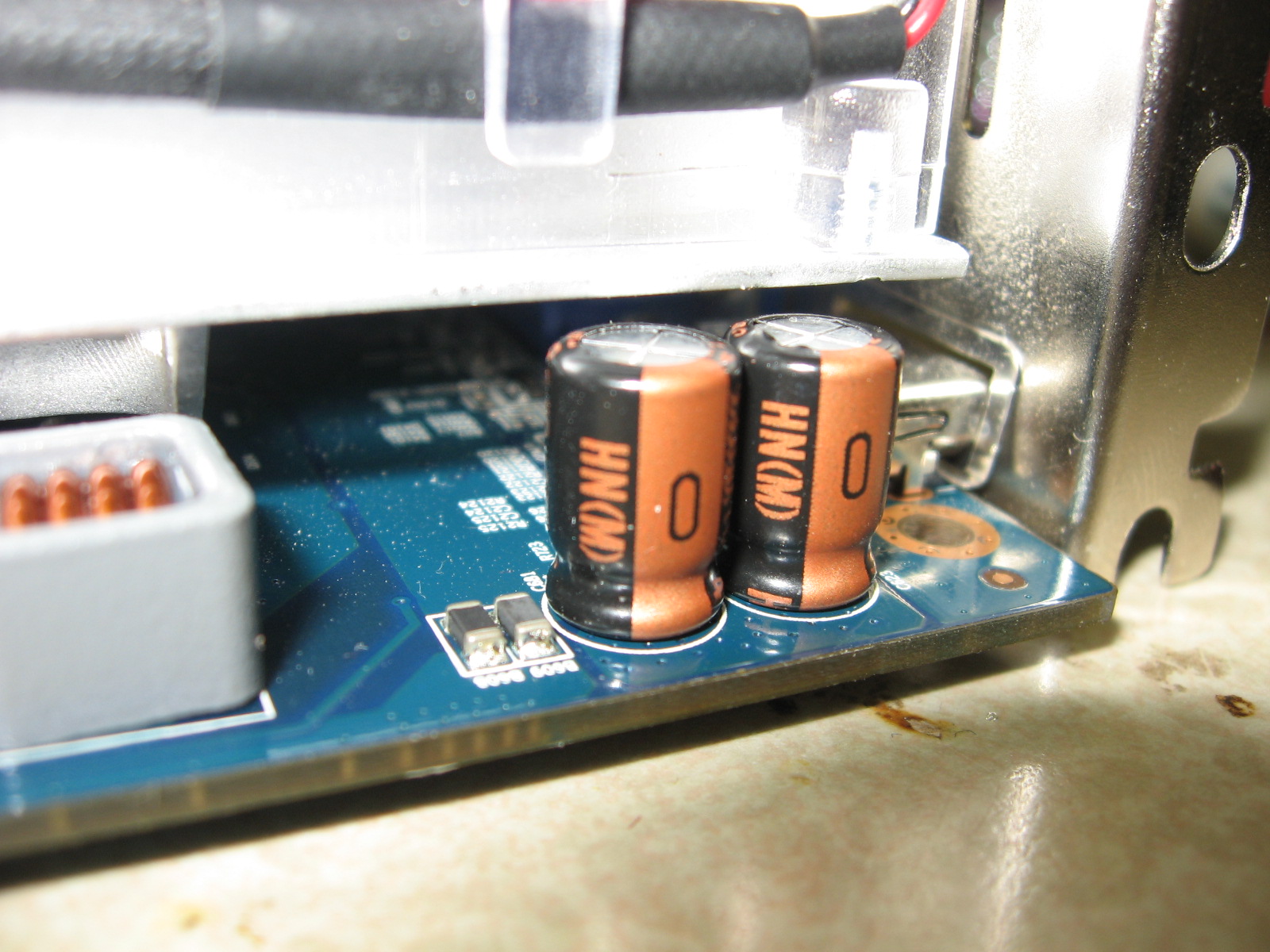

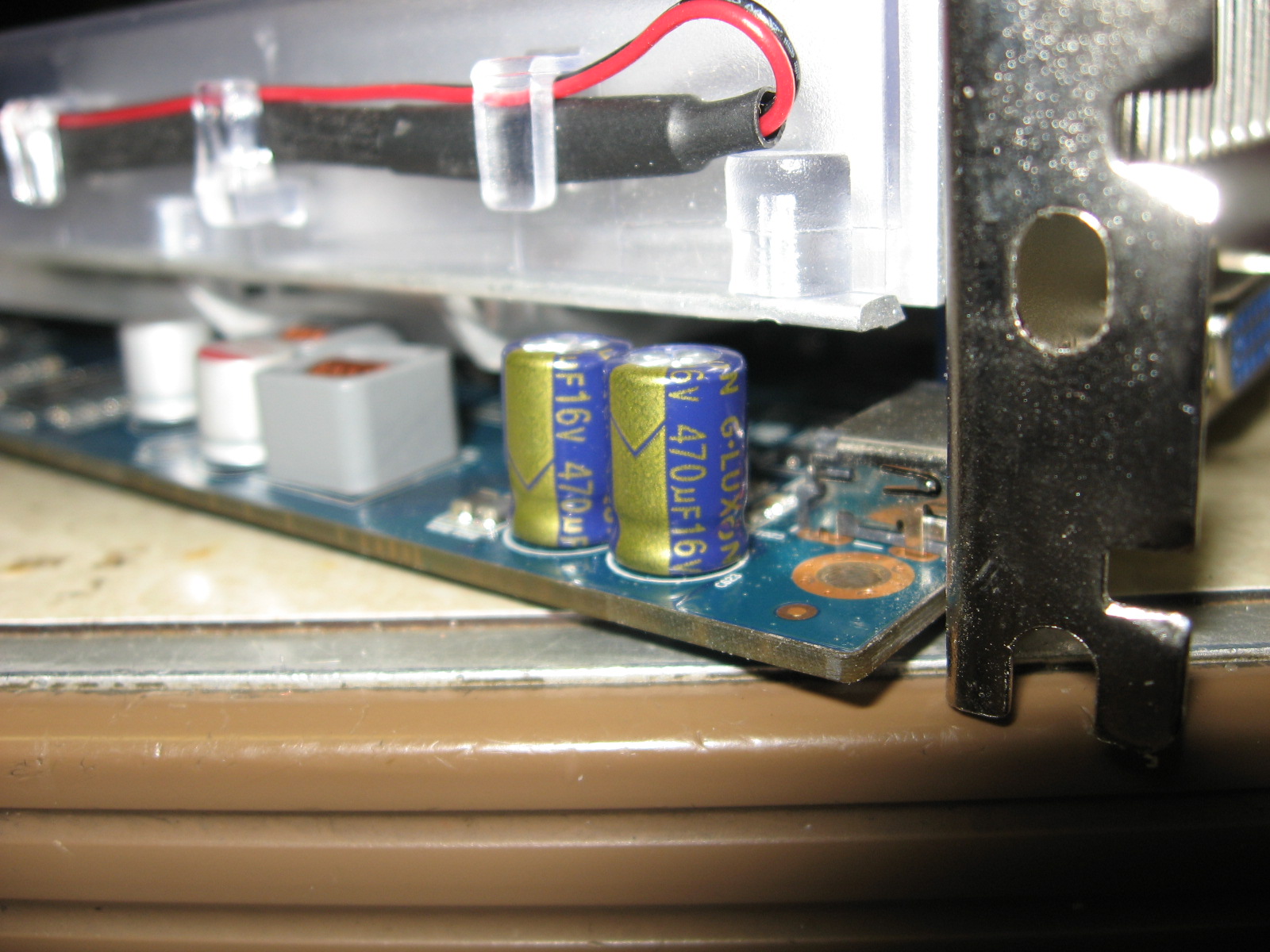

                      There's one thing I didn't like about the card:
                      (lots of G-luxons in this post)
                      ...which two 470uf 16V HN's later was no more:
                      This card used some particually difficult Lead-free solder (and some somwhat large power planes)... my Weller W60P struggled a bit at first but in the end, It was actually a pretty good recap.
                      I will note that I tried a new braid brand (Chemtronics Chem-wik) since I wasn't going to be near a fry's for a while and the cost at Newark was the same as they had listed for my usual MG Chemicals (Both were listed at $30 for 50ft). Fry's has it for $20 but they price gouge shipping.. $13 for a spool of braid? :bsfalg:. Anyway, the chem-wik did an excellent job (as predicted, my college uses the same stuff). It seemed better than the MG chemicals but it's hard to say; both do a good job.
                      When I went to power on the sytem, I found that the sound card's header is indeed intel HDA, not AC'97.
                      I had two choices... either go back to the old card (which isn't as nice as the new card) or do some hardcore case modding and convert AC'97 to intel HDA. Given that I said there would be two posts, I hope you can see where this is going.

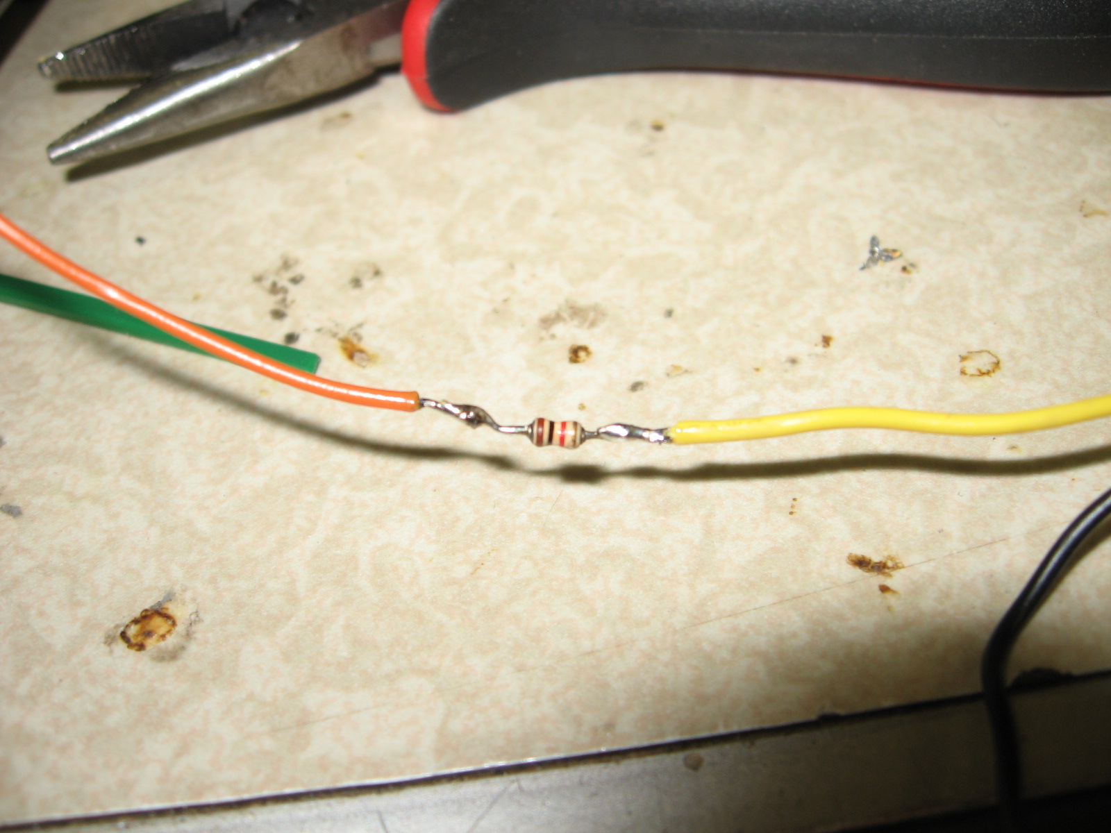

                        Next task was adding two more wires to the audio cables, one of which has the 1K ohm resistor added inline:

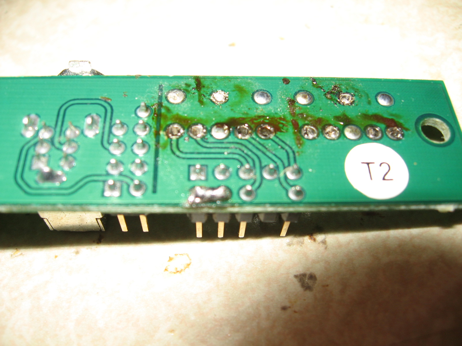

                        Next, I shorted the two ground pins on the Header board:
                        From here, It gets dodgy.
                        First, the connections to the old switches on each jack need to be cut off (desolder the jack or cut the traces, )

                          I went through each of the two drives... the first two had a clean bill of health... while drive #3 had 26 bad sectors. There were none pending...
                          1. Note the number of bad/pending sectors
                          2. Do a complete zero fill / low-level format on the drive. Let drive cool a little.
                          3. Run a normal error-scan with HD Tune, then check S.M.A.R.T. attributes again. See if bad/pending sector count has increased.
                          - If yes, repeat steps 1 to 3 until bad/pending sectors no longer increase.
                          - If no, drive should be okay to use again (but don't put it in a critical system). That HP/Compaq D530 should be quite happy with it. I have a 40 GB Seagate laptop HDD with over 1700 bad sectors. Works great and it's been stable for a long time now.

                                  PS. That Radeon 4670 if I remember correctly WILL NOT run 2 vga monitors, the card should have only one DAC so only one vga out. AFAIK it's 2 digital or 1 digital + 1 analogue
                                  You're memory is incorrect. I'm running two VGA's in a twin monitor setup just fine... see the screenshot (which I intentionally didn't crop).
                                    27 Bad, 0 pending.
                                      PS- I suggest you try memtest86+ brain edition.
                                      I have the pci express radeon 4850, which only has ONE vga analogue. Not that I use it, I have two dvi monitors connected to it. Actually, it has only two DVI ports, and only one DVI is DVI-I (so I could use a dvi to vga adapter).
                                      Strange (and cool) that it has two analogues out, I would have assumed they'd keep it down to one to keep the card cheap.

                                        Time for today's pictures:
                                        My shipment from topcat (Original Mobo box, I/O shield, etc.) and some caps came in.
                                        Original I/O shield (bare metal) vs the old I/O shield (colorful plastic):
                                        Original I/O shield installed:
                                        I also replaced the one G-Luxon on the audio card:
                                        Man this rig rocks and rolls... with the exception of two levels (which were choppy), I was getting between 56 and 110 FPS in SuperTuxKart. The open-source linux driver? More like 20-10. Yeah, the right driver makes all the difference.
