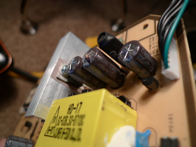

    Howdy everyone!
    I've read that when replacing lytics with polys the fraud value should be about halved. https://www.badcaps.net/forum/showthread.php?t=8679
    But I recently fixed a monitor before reading such, http://www.overclock.net/monitors-di...l#post12759917. So, what can I expect in the long run? The monitor seems to work fine.
    Cheers

    Well...the capacitors you replaced are on a power supply board. Generally, you want to stick close to the original specs there are far as ESR and ripple. Polymer capacitors have much lower ESR compared to electrolytic capacitors. Those who understand electronic theory better than I do say that changing ESR too drastically can throw things out of tune. The ideal replacement would have been an electrolytic capacitor with similar specs from a more reliable manufacturer.
    Reducing capacitance when decreasing ESR only applies to certain areas of a PC motherboard. On a power supply, keeping the capacitance the same was the right call.
    I wouldn't worry too much about the reliability of the ones you just replaced. What I might worry about - I see that there are other Capxon on the board you did not replace, as well as what look like Taicon. These brands are unreliable, and I would have replaced all of them while the monitor was apart.
    All things considered, good job with the repair

          Nice work, Fir3Chi3f! I like the pictures with the stick figure in your thread - very cool .
          Like yyonline suggested, though, you should replace the rest of the CapXons as well, along with the Taicon caps.
          Besides the capacitor brand name, capacitors also have a series marking (usually a 2 or 3 letter code). Different series have different characteristics (such as ESR/impedance and Ripple Current). For example, you can have two 220uF 25v caps, but one may have a different ESR and Ripple Current rating from the other cap. The brand of the capacitor, along with the series will allow you to chose proper replacements. Capacitors datasheets can usually be found online (if not, ask here ).
          Ideally, you want your replacement caps to have the same or higher Ripple Current rating and same or lower ESR/impedance.
          In your case, you have CapXon. The most commonly used CapXon series in monitors are usually KF and GL (and sometimes KM). Yours are black, so I would guess either KF or KM series. Based on the datasheets:

          As for the solid caps you used - they have much better specs than the CapXons. If you did this on a regular computer power supply, this might have been a problem, like Th3_uN1Qu3 described. Monitor power supplies, however, don't seem to mind that much. Part of this is due to the lack of large inductors and steady power draw. With that said, you can leave the solid polymers you originally installed. In fact, I think it's good to have them there since they can take heat abuse much better - and most of these monitor power supplies do get quite hot.
          By the way, one more thing - the capacitance is not measured in fraud but in Farads (F) (on those CapXons, though, it may as well say FRAUD ). The μ in front means micro, or 10^-6.

            When it was first created [HERE BTW] the "1/2 Rule" was improperly applied by many and bad info got spread all over the web.
            It is based on what is said in a tech document for a VRM controller chip and outside of a VRM it does not apply.
            If you are not working on a VRM there is nothing at all that actually says it's okay to reduce uF.

                      I was looking at the new broken monitor (because it's already open) and all the caps are CapXon GL. I was doing some googleing and couldn't find much on "CapXon GL" except for other blown cap tutorials/situations. http://pavel.kirkovsky.com/2009/03/s...r-204b-repair/ <- This guy miss-matches caps because he couldn't get the 820uf 25v.
                      So I don't have to keep coming here to ask what caps I need, Where can I find these data sheets?
                      Based off of voltage, farads and this chart I need Rubycon ZLK. Is this correct? I will be replacing all the caps this time.
                      I'll need to reopen the monitor to see what they are, thanks momaka! I actually gave that monitor to my little brother; I'll need to wait until he isn't using it.
                        second link with Google search, boom!
                        I see your monitor also has the 820uF, 25v CapXon GL caps - check their size (dia. by height in mm). I've had both 25v 820uF and 25v 470uF CapXon GL caps, and both had the same 10mm x 20mm size.
                        Since the ESR and ripple current rating of a capacitor depends on its can size only (this is within the same series, of course), my 10mm x 20mm CapXons GLs were actually closer in spec to a 680uF 25v CapXon GL.
                        So keep that in mind when you're replacing yours, in case you have a hard time finding a replacement 820uF cap with those specs in that can size. The Rubycon ZLK you pointed may be a bit of an overkill (in terms of ESR and ripple), but they will more than likely work fine.

                                I found another source for that same info sheet:
                                I've hit something of a wall however, the dimensions on these sheets do not match the dimensions of the caps I have.
                                Specs on my blown caps:
                                820uF
                                25v
                                10mmX20mm
                                Closest match on the spreadsheet is 8mmX20mm
                                Overkill doesn't sound like a bad thing, any reason I shouldn't just replace these with Rubycon 820uF 25v ZLK 10mmX20mm that are available in the badcaps store?

                                  8x20 is very far off. Go by can size for Ripple and ESR - uF and volts don't matter for ESR.
                                  Use the dimensions on the cap you have in hand and the specs from closest the one in the data sheet with the same dimensions.
                                  [ESR and Ripple for whatever series are based on the can size.]
                                  In the GL data sheet the 820uF *25v* is 10x25mm with ESR=.043 Ripple=1460.
                                  Closest 10x20 is ESR=.052 and Ripple=1280.
                                    The Ruby ZLK are close in specs to Panasonic FM, and from what I've seen, Panasonic FM has been used quite a bit for monitor repairs around here and it has always worked. So the Ruby ZLK should work fine, too.

                                      Capxon KF are NOT polymers.
                                      Small lytics don't always have vents.
