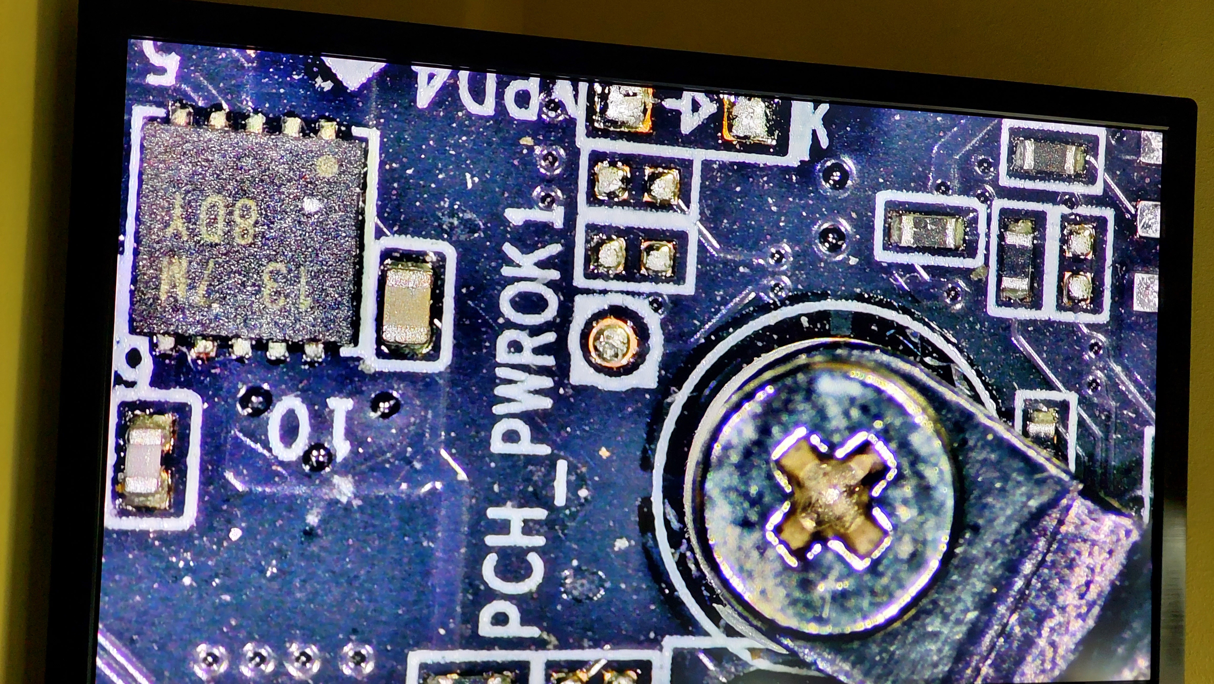

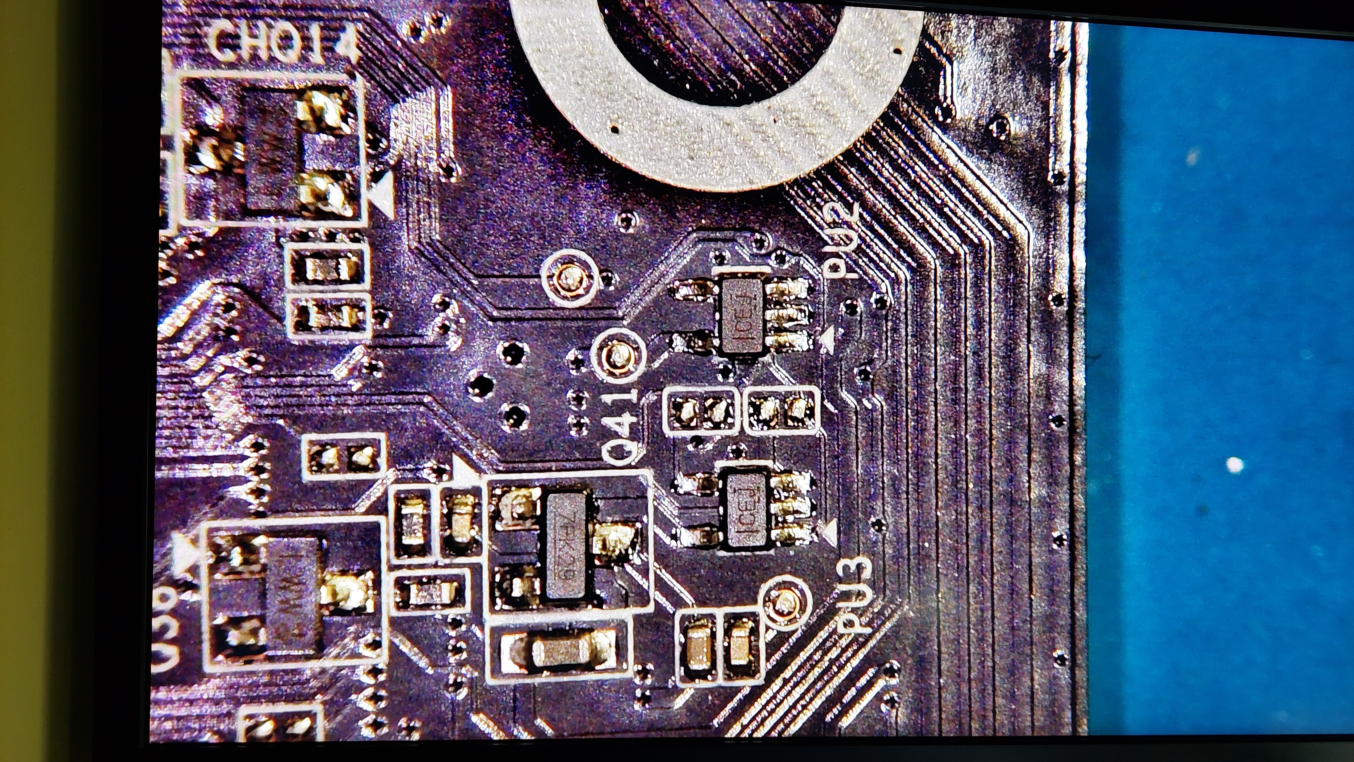

      Very strange design, very strange marking, check this Click image for larger version

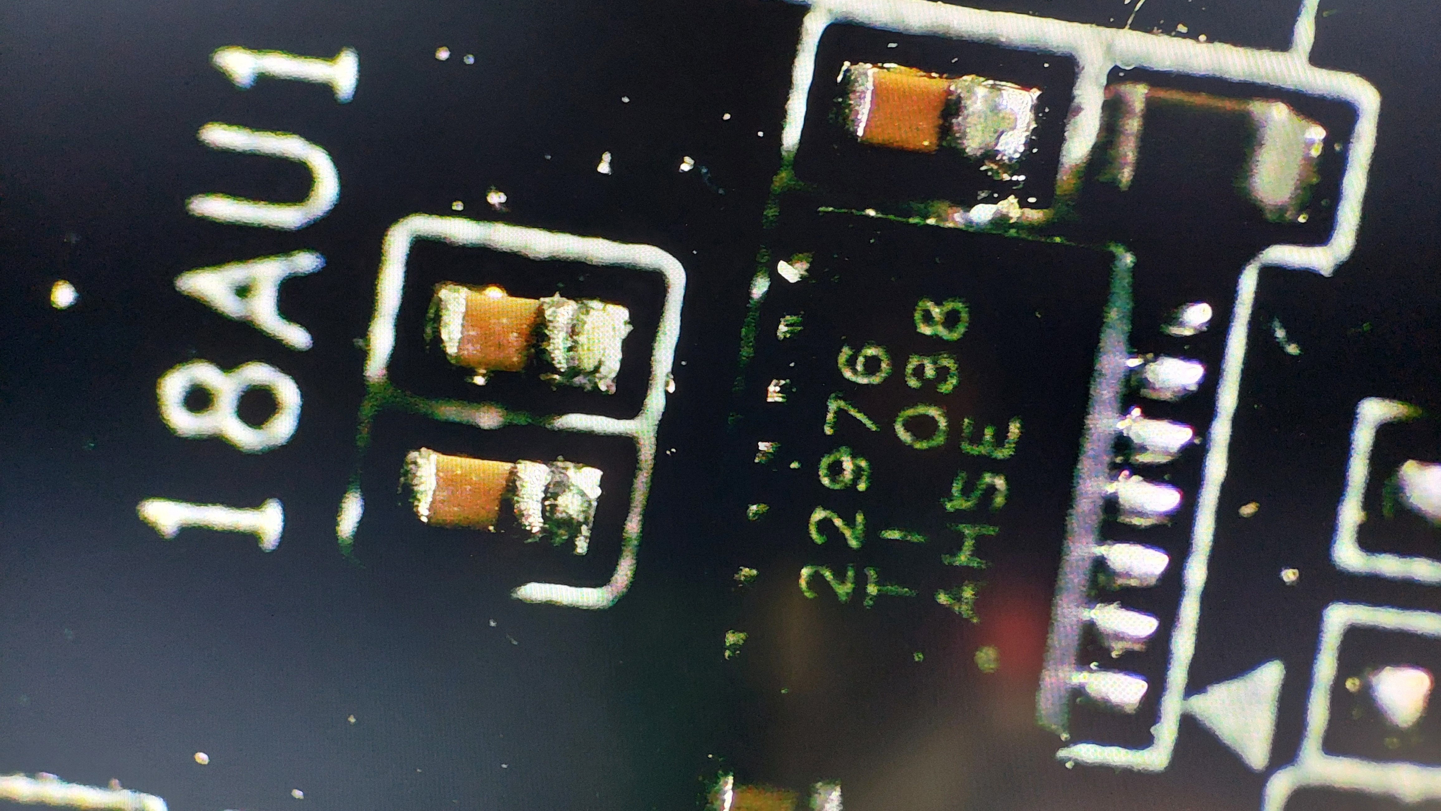

      • ArchangelGabriel
        • Feb 2022
        • 37
        • Romania
ID:	3156585 this should be 1.05alw, I think!

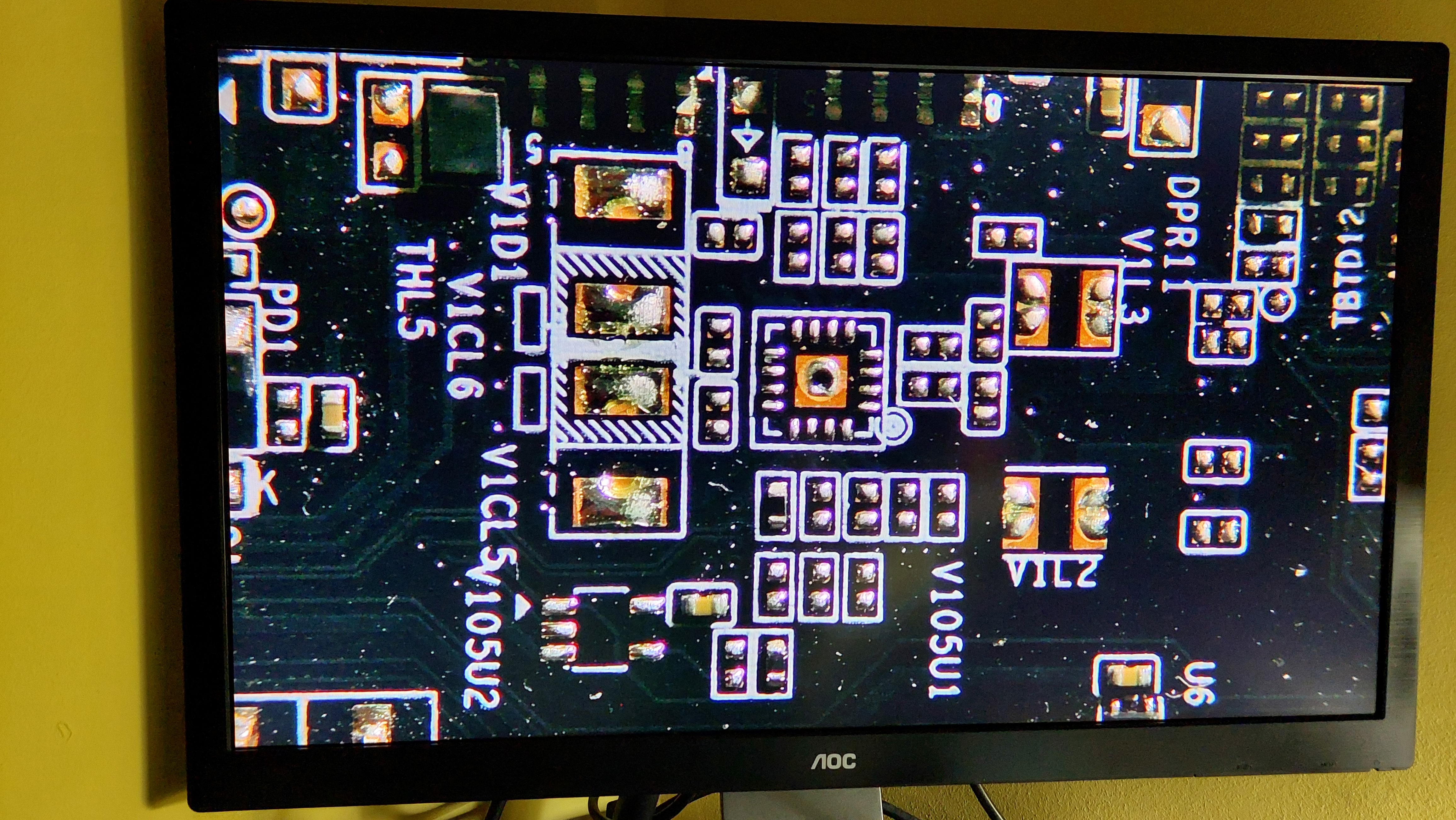

        • ArchangelGabriel
          • Feb 2022
          • 37
          • Romania

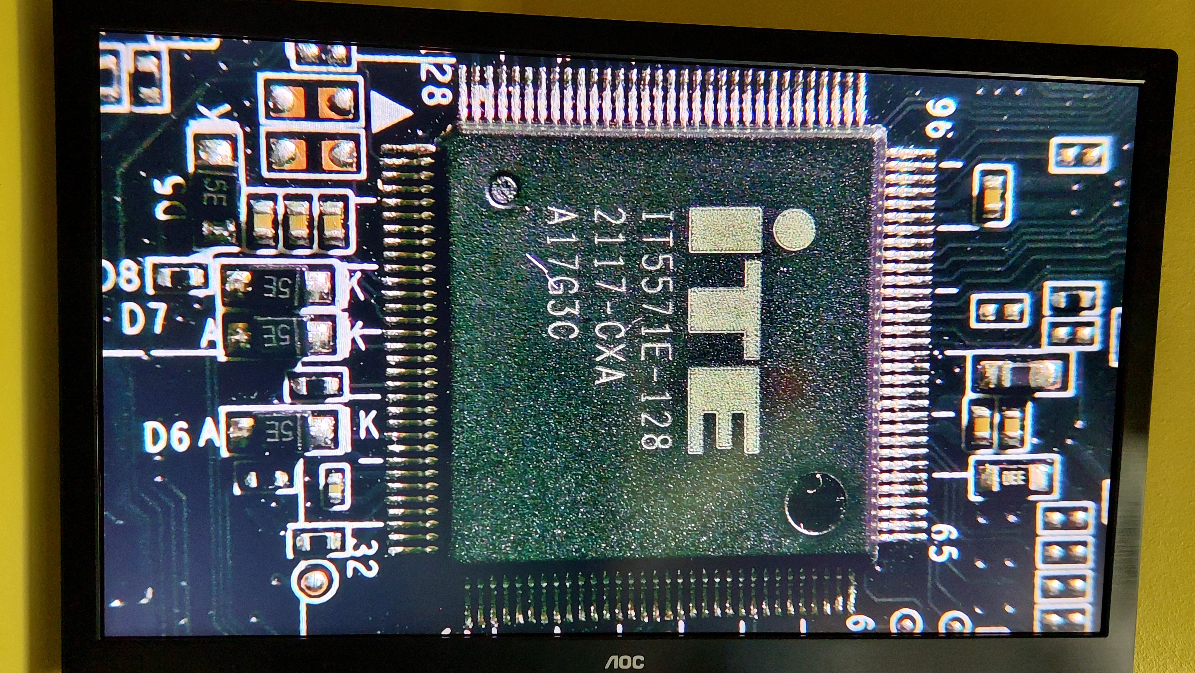

          With dc-in I could not find 1.05 3.3v and 5v alw, but I have 3.3 on pwrbtn, if I pres it, the mainboard awake, etc. Click image for larger version
ID:	3156589EC, I could not find datasheet!

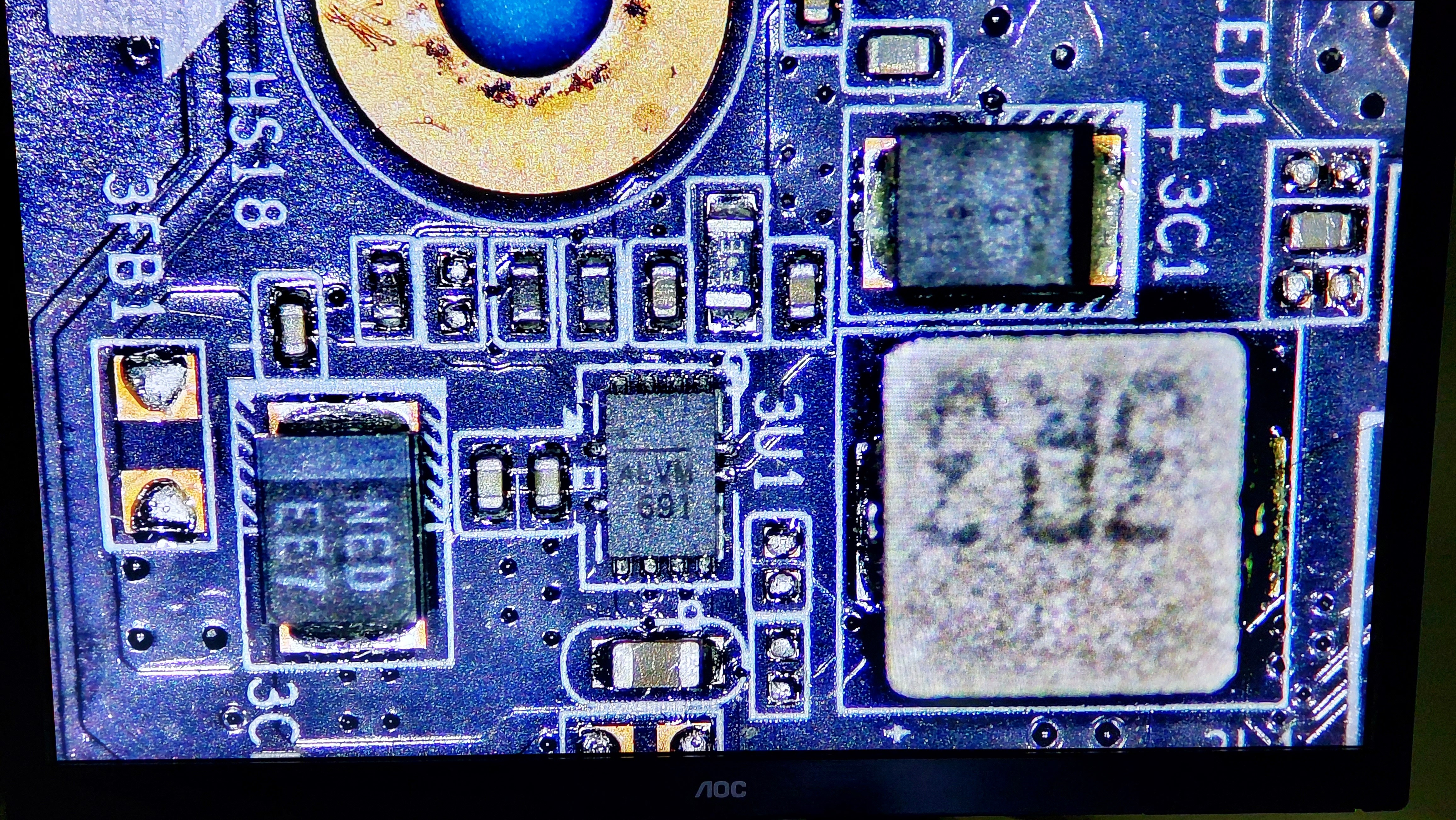

            1.8v I think Click image for larger version

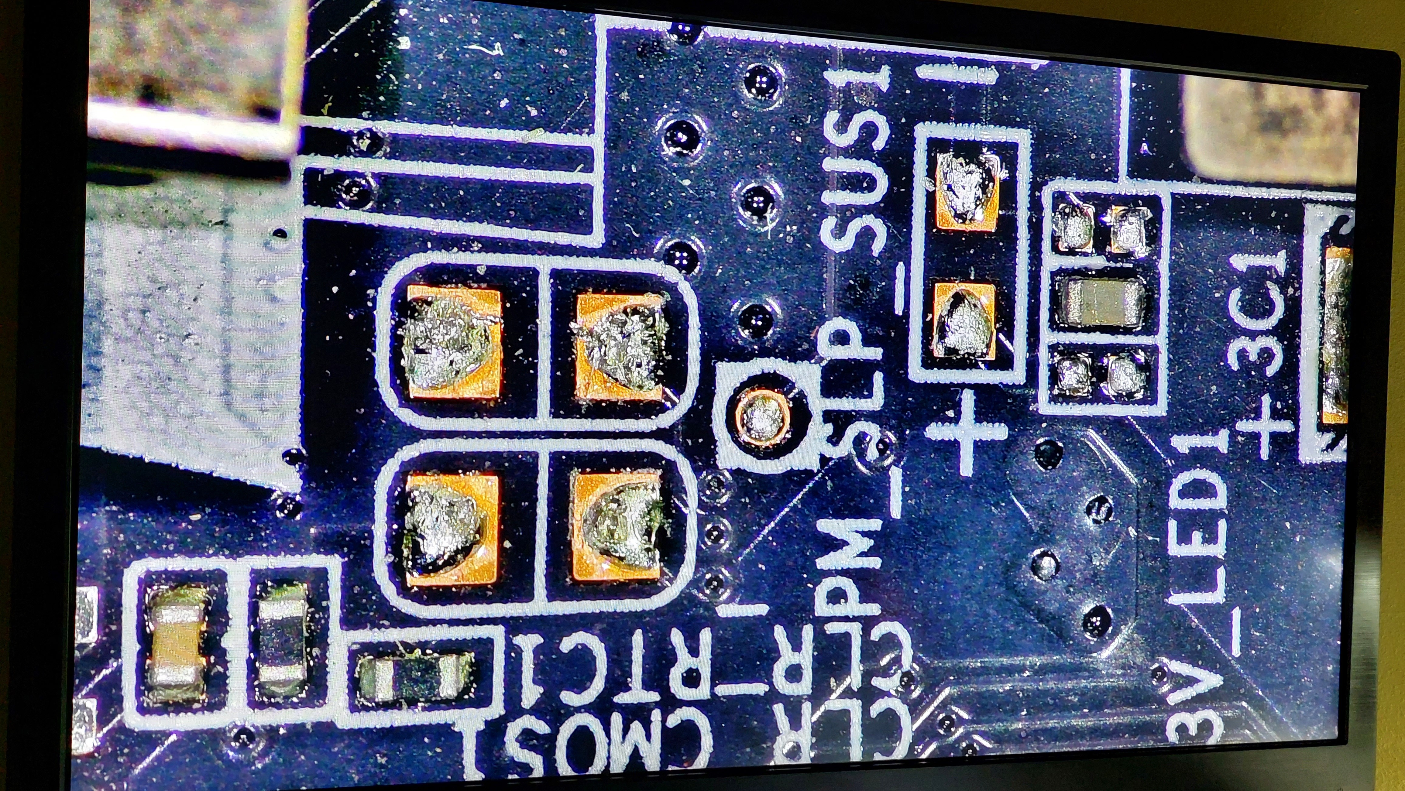

                More marking Click image for larger version

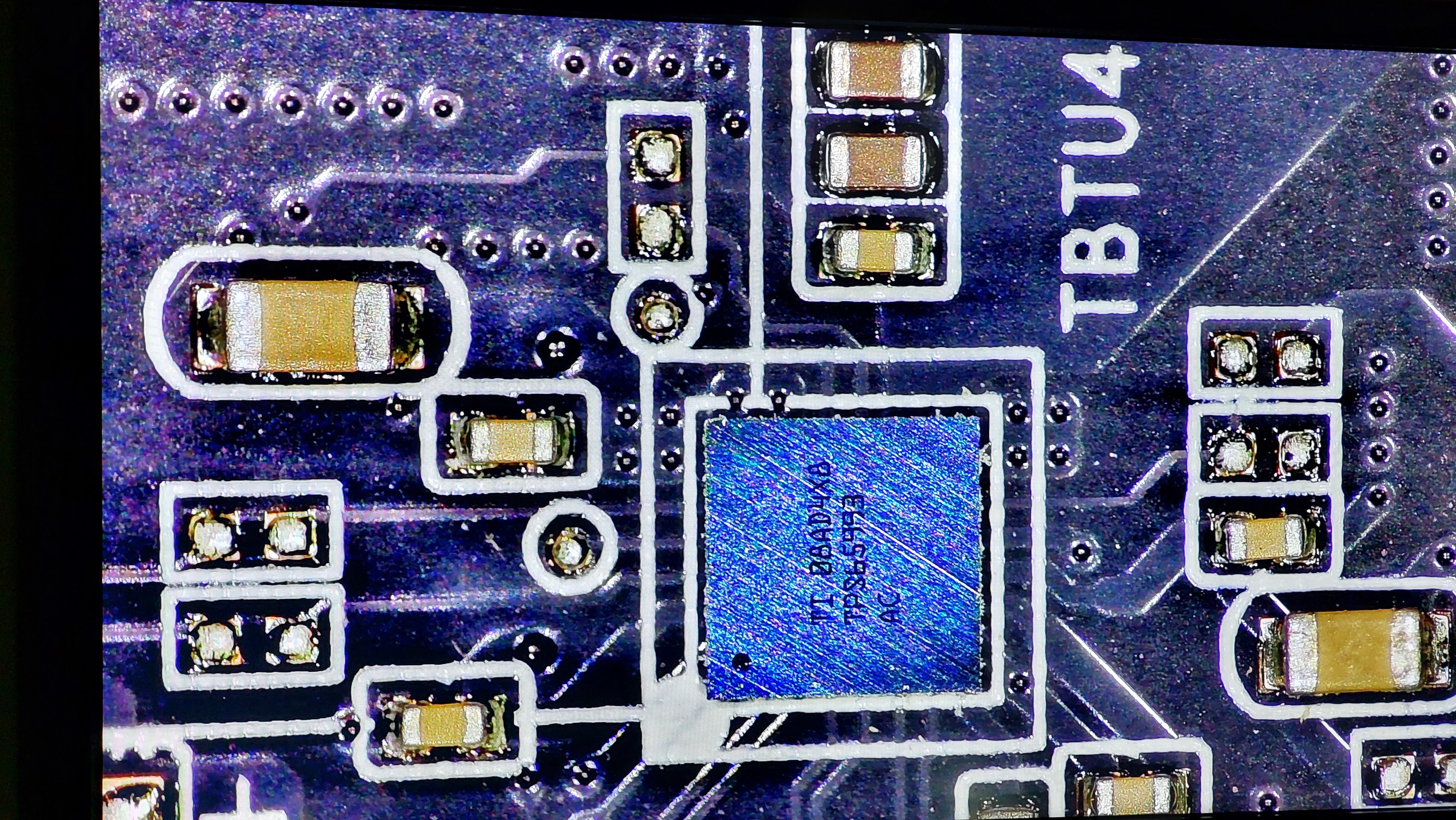

                  More Click image for larger version

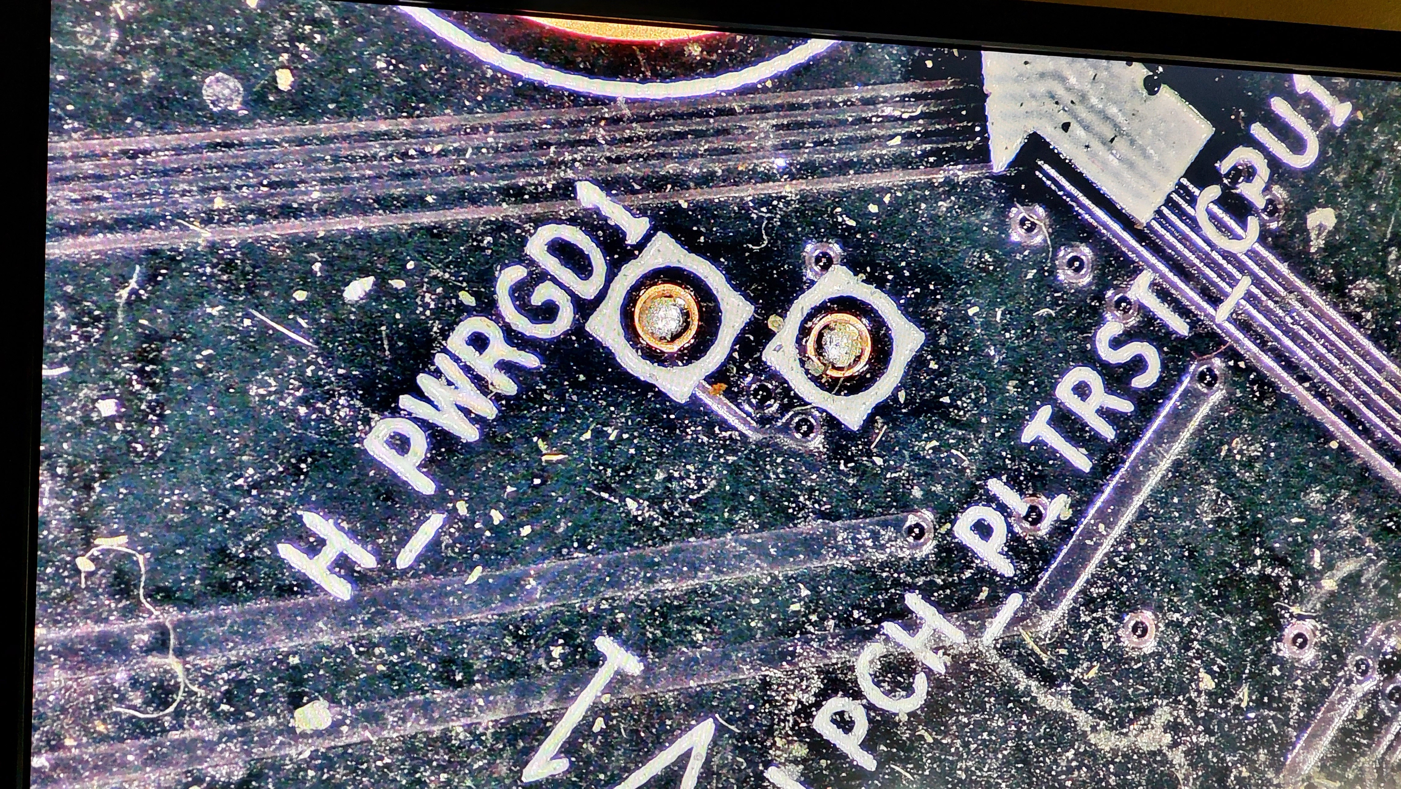

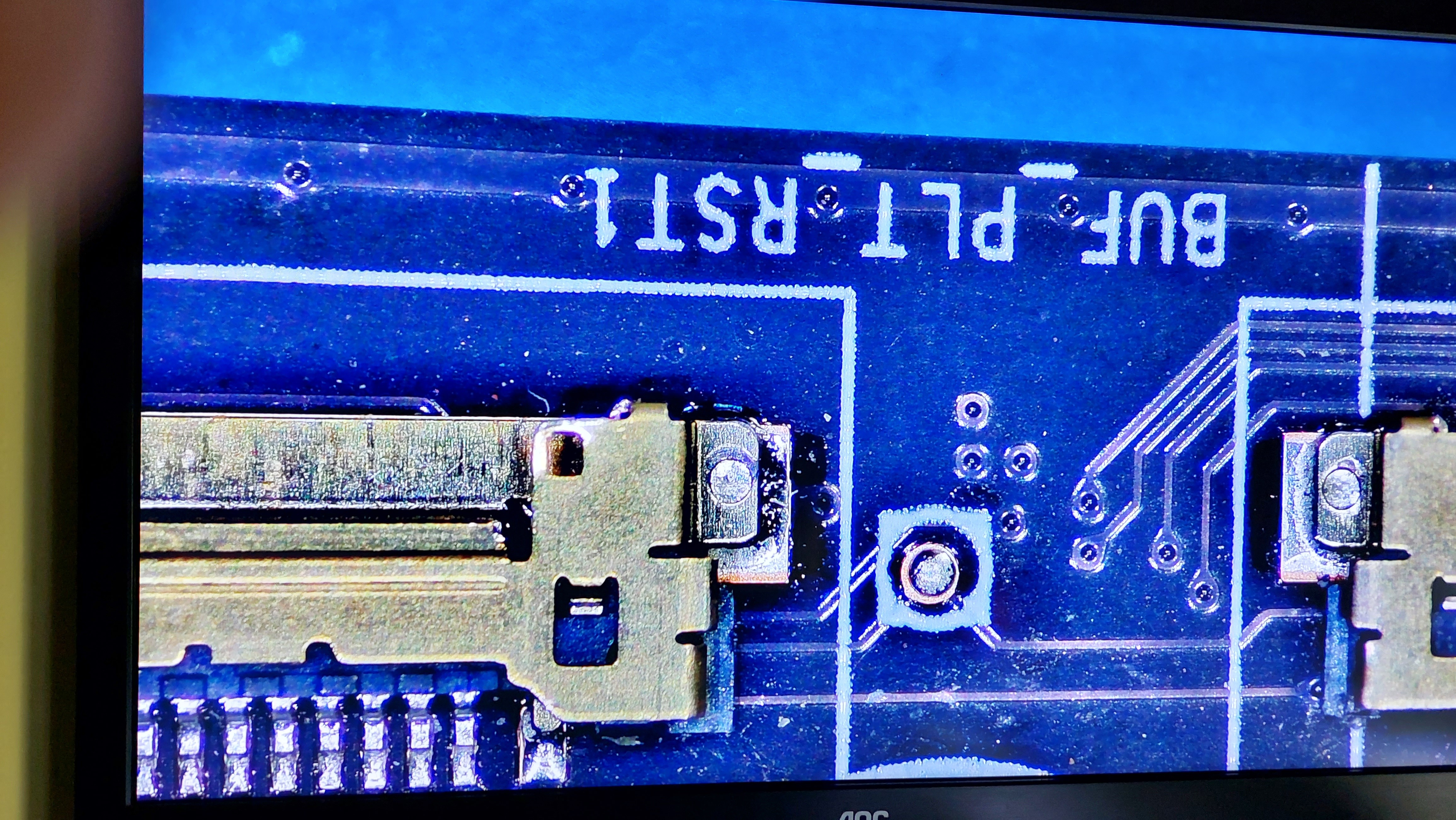

                    I found some testing point, sorry to bother! From what I see all are active high so I should have 3, 3V on them when the laptop is awake and running? Thank you! Click image for larger version
