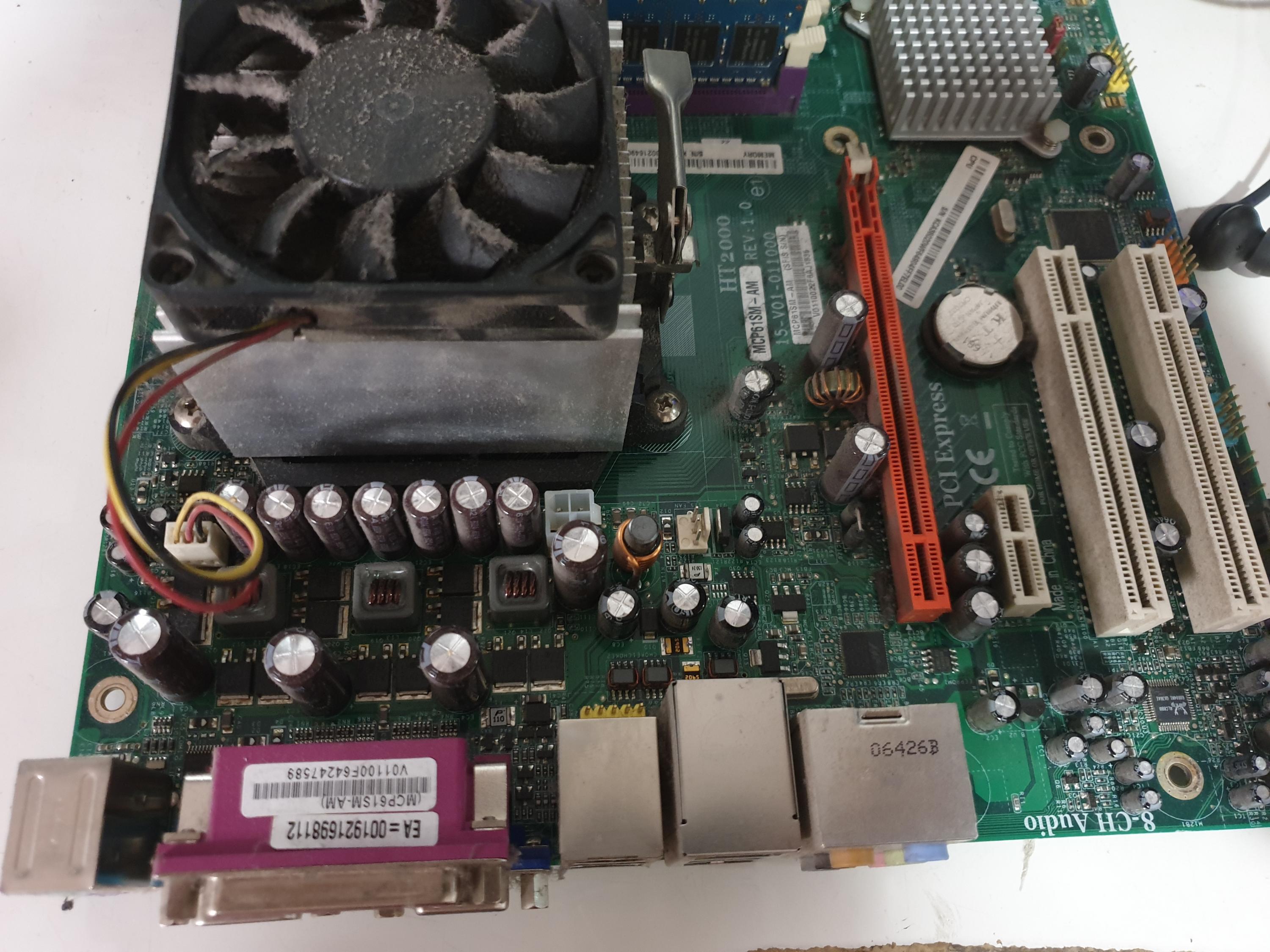

          typical fault in ECS MCP61SM-AM (used in HP and Acer)
          The OST and TK failed when the computer had more or less 60,000h.
          I just failed with 70,000h (the HDD is original, and marks 70,000h of use, because its owner never turned it off).
          Interestingly, all g-luxon are fine: O
          But I'll be honest, I'm impressed that this board has endured so many hours, and the chipset being an nforce with IGPU has never failed the FCBGA.

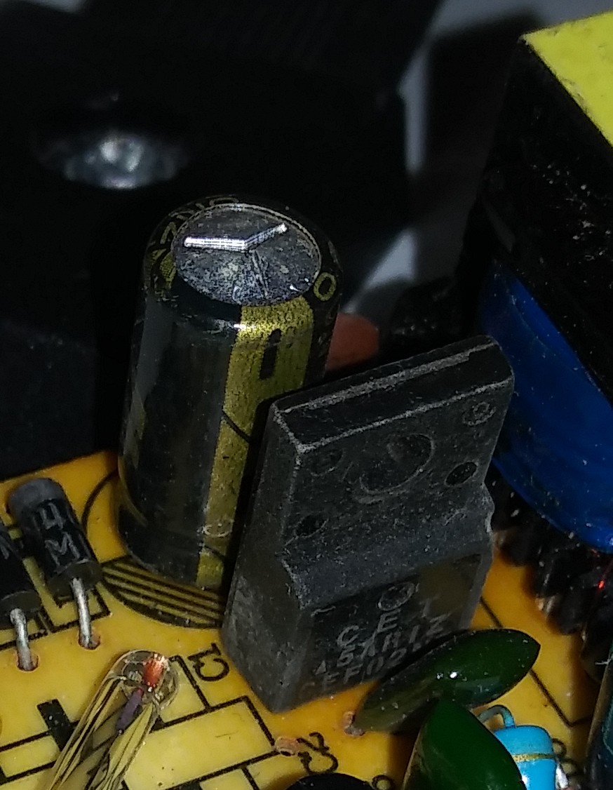

            Generic "CIA LOW ESR" 10uf 400v. Died in under 4 hours in a "2 amp" power supply.
              Mine failed at a little less than that. Also, my board had TK, OST, and Sanyo WF caps. Despite Sanyo being considered a good brand, their WF series are problematic - same as other early ultra-low ESR Japanese cap series, like United Chemicon KZG/KZJ (and Rubycon MCZ to an extent.) The OST caps were RLS, IIRC, so they didn't have issues. Still, I recapped most of mine preemptively.
              Maybe it ran in a cooler environment/ambient? I can tell you that at "standard" room temperature of 77F / 25C, the chipset HS gets scorching hot and certainly won't last long. Mine's starting to fail - it looses the LAN port on cold boot if room temperature is below 64F / 18C. Also had the USB ports panic last summer, hogging all the system interrupts with requests (and bogging the CPU down.) After disabling Enhanced USB (USB 2.0 capability), the interrupt panics stopped. Re-enabling Enhanced USB controller brought back the panics. Eventually, I got mad at the thing and punched the chipset HS. Must have been the right force, because that instantly fixed the USB 2.0 issues. Now working fine again. And the LAN port has been a lot less problematic at cold boot.
              So solution for faulty/dieing GeForce 6100/6150 chipsets: punch them! But not too hard
              Or just put a 40 mm fan on it, to prevent all of that, if possible.
              Caps developed by the CIA? LOL

                I don't think they're developed by the CIA but they seem to be very common in cheaper power supplies, this is the first one i've had fail and boy it stunk.

                        I did not know that Sanyo failed, I have had several WFs and I have not seen any bloated.
                        Thanks for the warning, I'll keep it in mind.
                        If I tell the truth, I do not know what environment it was in, but it was in an Acer case, it was probably working at a low temperature.
                        I do the same to the problematic chips, you put them on a fan and surprisingly the useful life is very long.
                        had a gt8300 with passive heatsink of the defective series, I put a fan and never failed.

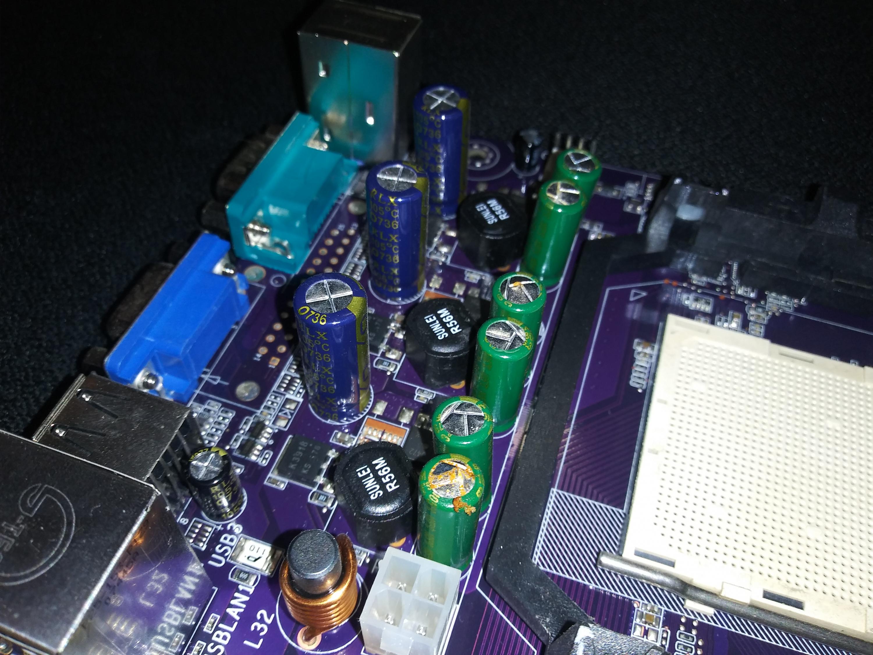

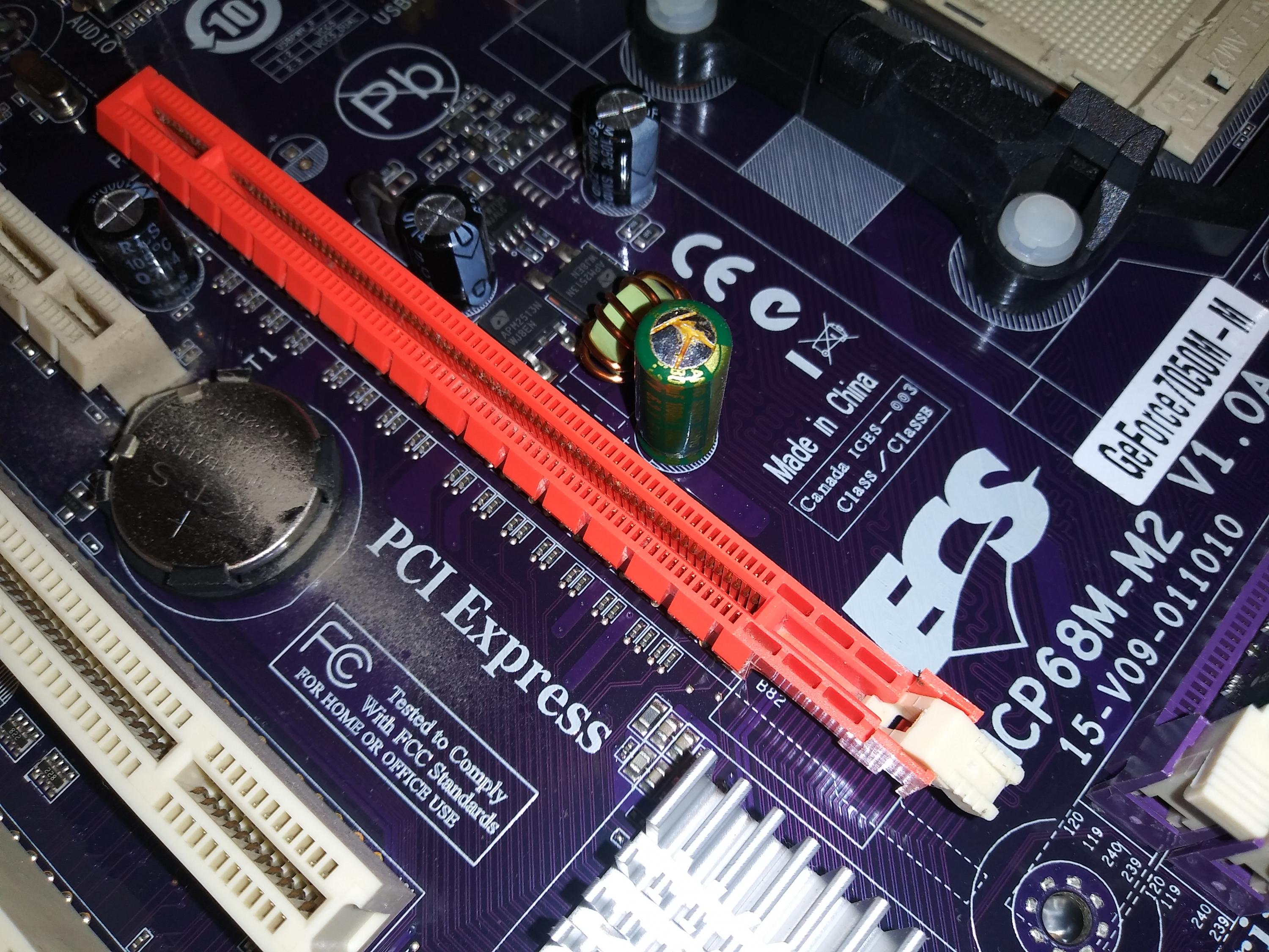

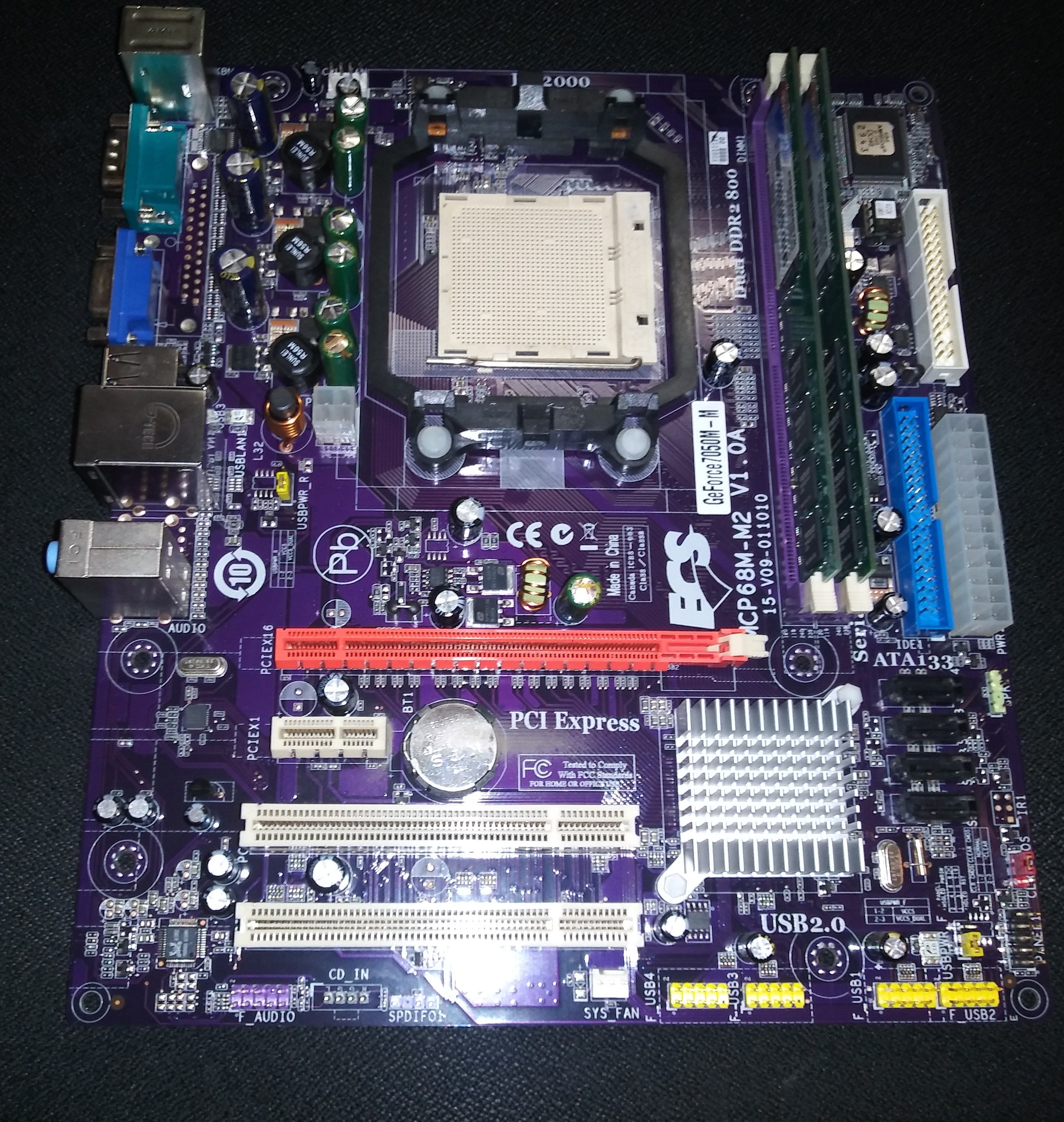

                                4x Sanyo WF 1800uf, 6.3V.
                                These are on the same motherboard i mentioned in a previous post.
                                  I hope Sanyo aren't bad now...

                                    Sanyo’s WF series has issues with long-term reliability. I would not deem Sanyo (Suncon) a bad brand just because of that one series. I’ve seen quite a few ECS motherboards from 2009~2010, loaded with 1800uF 6.3V Sanyo WF and a few 1000uF 6.3V Sanyo WG. The Sanyo WF seem to fail quite often while the WG seem to be okay, along with the rest of the caps. I guess you could chalk this up to the WF being in more stressful locations (on the output of buck regulators, high ripple current duty), but I take it as more of an indication that the WF series is just plain unreliable.
