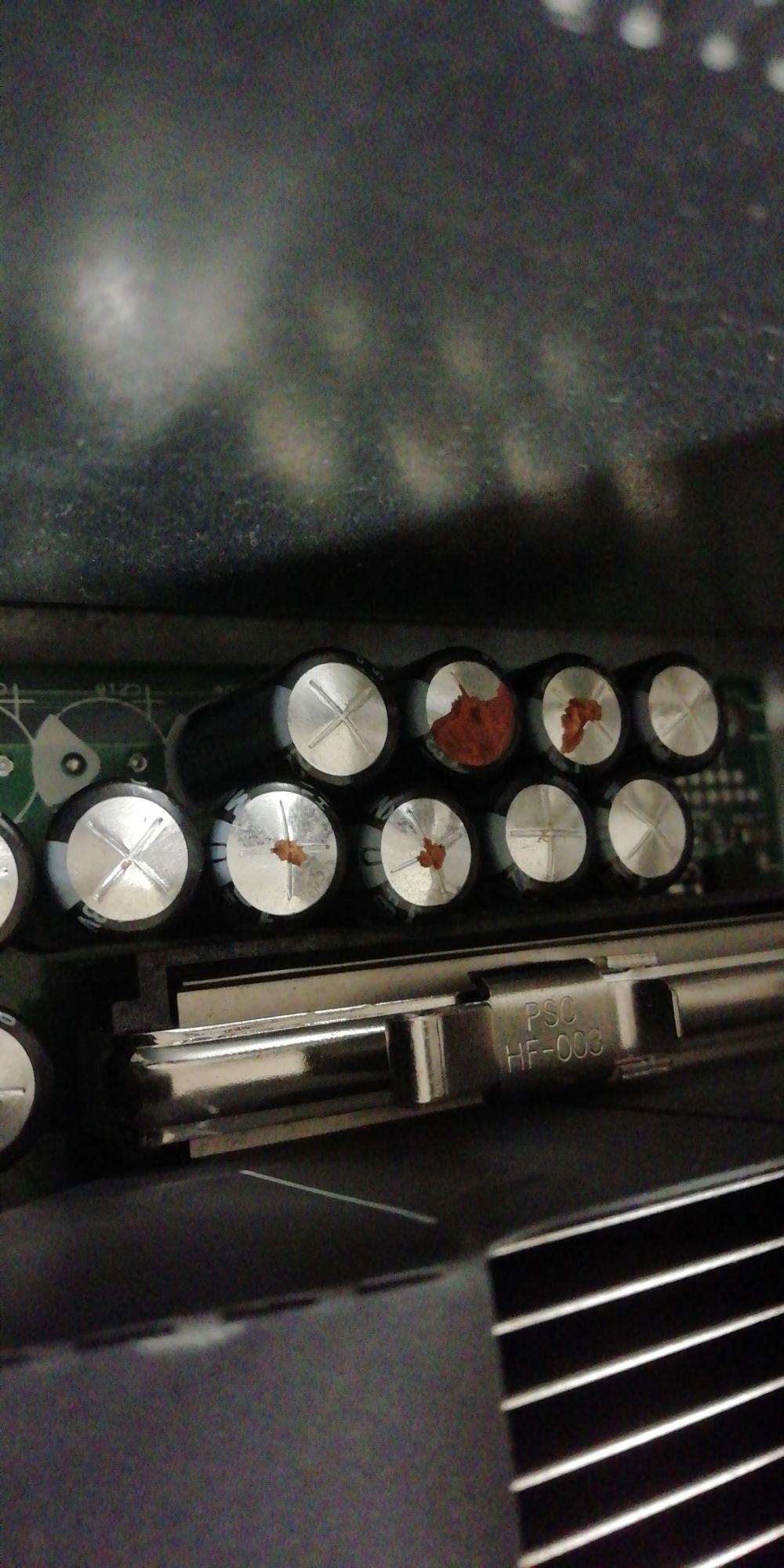

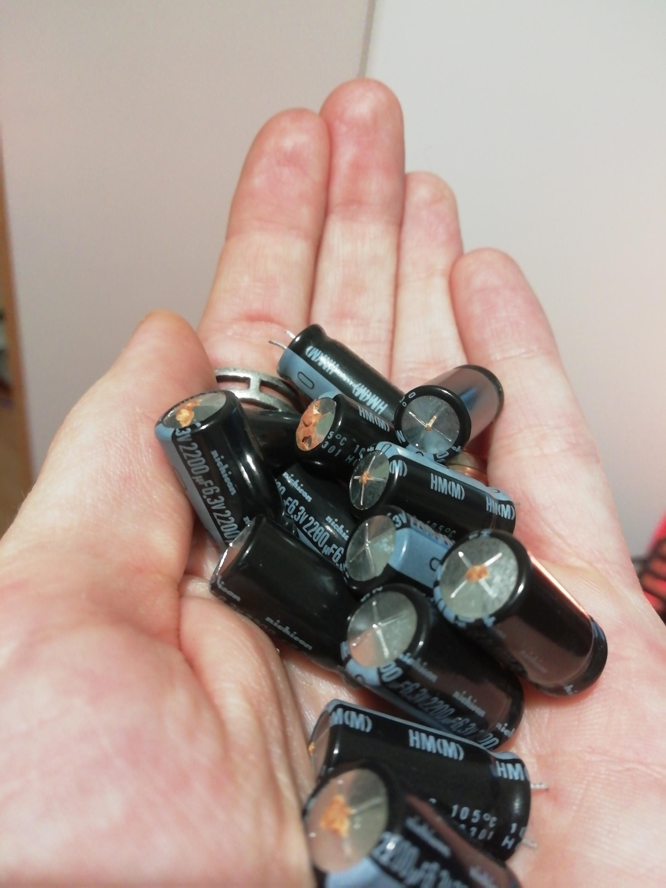

    Bunch of Nichicon HM's from old HP D510S/845G. To my suprise, powersupply was full of HZ and alike, all good.

      Re: The Hall of Shame - Badcaps Photo Montage
      Is that computer an SFF style machine?
      If so, not surprised. Those computers are a true test for capacitor thermal ratings.

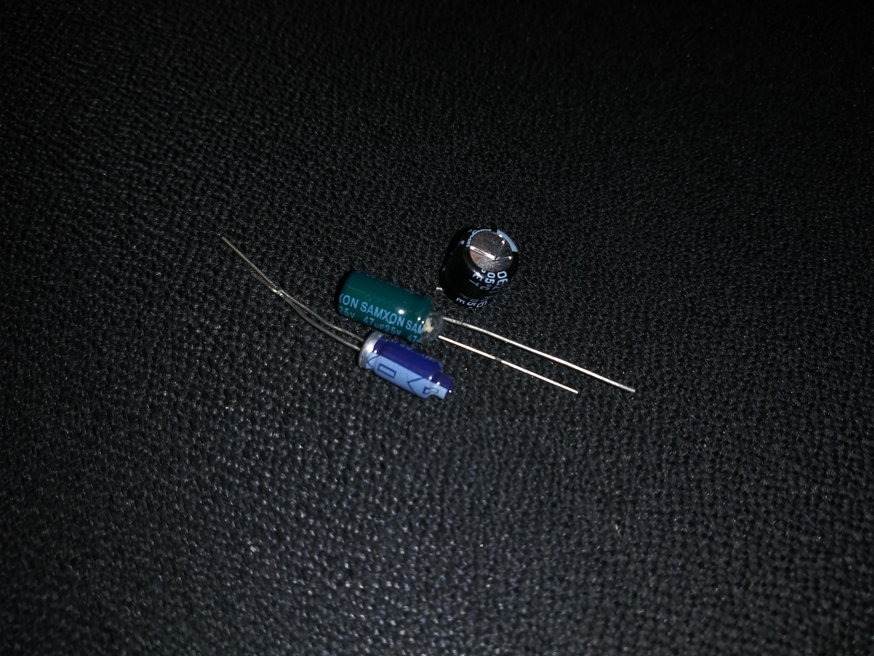

          Some caps from a grab bag; a (brand new) Samxon GF 47uf 25v that is blown out the bottom. A Rubycon MFZ 680uf 4v cap that is bulging (tests at 230uf). and a Samxon cap with a heat shrink error (nothing electrically wrong with it).

            The Ruby MFZ probably sat on the shelf too long without use, and they don't like that too much either (though nowhere near as sensitive as UCC KZG). I've also never seen MFZ in that size offering (680 uF @ 4V). Custom spec caps, I suppose?
            As for the Samxon GF... meh, those are known garbage. Not surprised it failed.
            The blue Samxon looks like GS series. Those are general purpose series... and also not very good, especially if there is any heat involved. Also, that sleeving error is very funny. I've seen caps over-sleeved or under-sleeved - even from the good Japanese brands, but nothing this bad, lol.

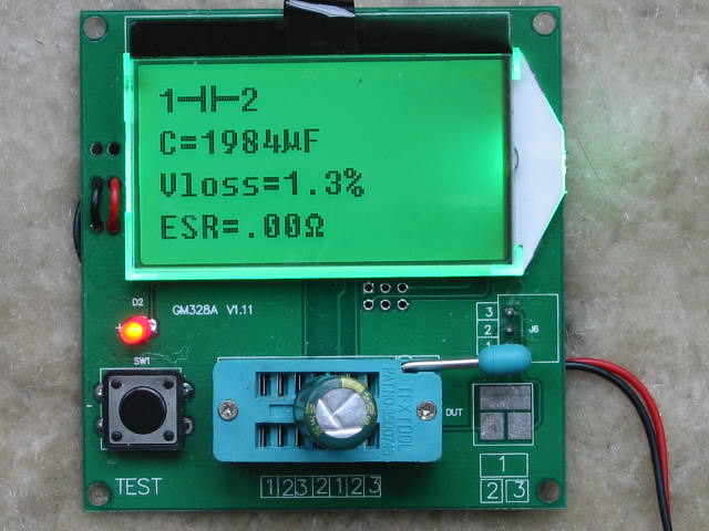

                      The Hall of Shame - Badcaps Photo Montage - Sanyo WF series

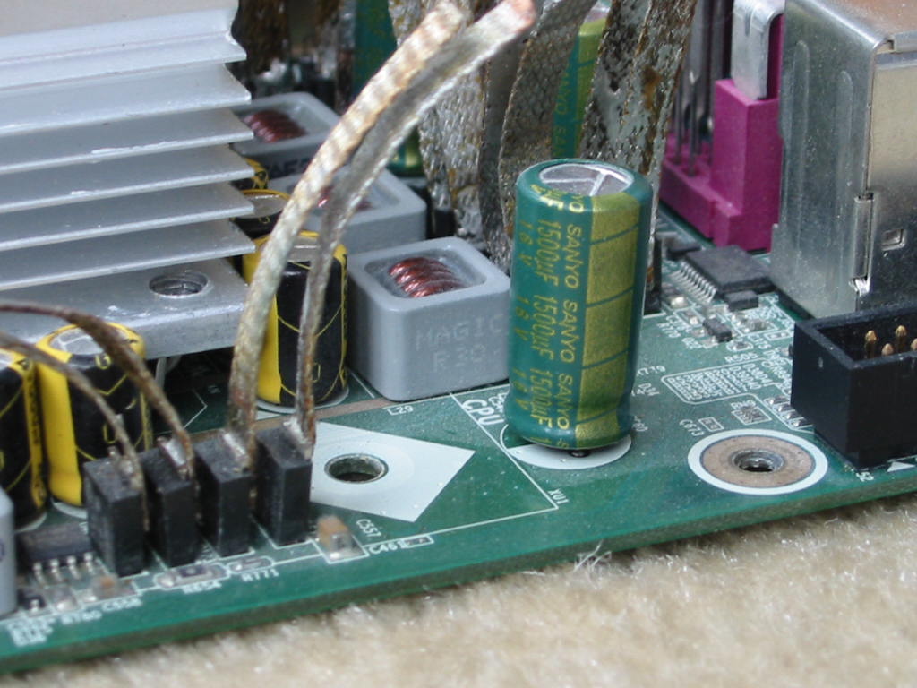

                      Remember this video card that I recapped a while back in 2014?
                      https://www.badcaps.net/forum/showthread.php?t=37602
                      Well, I've been using it on-and-off as a test card and even semi-permanently in a few PCs.
                      Last week I pull it out of storage again (after maybe close to a year without use) to test another build and what do we have…
                      … a slightly domed Sanyo WF, 16V, 1500 uF cap. That can't be good!

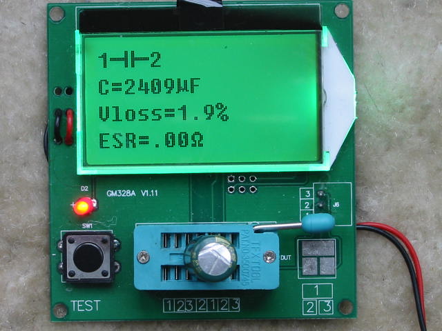

                      Let's see what my ESR meter says:
                      Yeah, 2400 uF? That's failed for sure. Seems to be high internal leakage, just like United Chemicon KZG likes to go.
                      Now, I will be honest that these Sanyo WF caps were salvaged from dead Xbox 360 motherboards, so they may or may not have seen a few high-temperature cycles from a reflow or two. But really, that shouldn't matter, because I have Rubycon MCZ and Nichicon HN caps in the same capacity and size, salvaged from the same Xbox 360 motherboards, and none of those have gone bad on me.
                      Since the above EVGA GeForce 6200 card was one of my early recaps, I decided to pull another old recap of mine out of storage where I used the same Sanyo WF caps. It was on an Intel Maverick/Silverado motherboard for an HP DC7700 desktop tower. I previously used this board about 4-5 months ago to test the TDP capability of some heatsinks (by using a Pentium 4 -630 CPU on that board as the heat source "test dummy". )
                      So I grab that board and inspect it. Immediately, I notice almost the same thing:

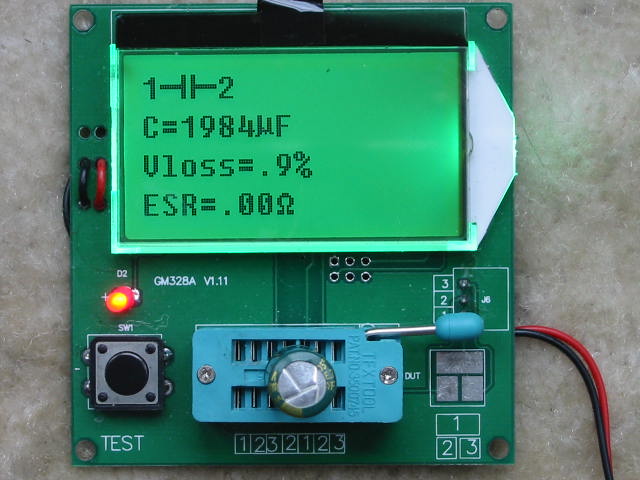

                      … except on this one, the bulge on the Sanyo WF cap was much smaller. Nevertheless, I desoldered it to check it and this was what the cap meter said:
                      -bad again!
                      Since I used two more of these caps on that HP DC7700 board, I pulled those out too. One measured nearly the same thing as above, but without showing any signs of bulging or being domed:
                      The last one, though, showed this:
                      … 1700 uF, which is still technically “in spec” for a 1500 uF cap. But do I trust it? –Absolutely not.
                      As a comparison, shown below is the reading of a Rubycon MCZ, 16V, 1800 uF cap (the one and only left) original to that board (the rest of them bulged due to excessive heat, as it seems that board was in a case with bad ventilation, as there were scorch marks all over the board in the hot areas):
                      https://www.badcaps.net/forum/attach...1&d=1604735471
                      After finding all this, I check the rest of my stock (all of 3 caps, lol) of Sanyo WF, 16V, 1500 uF caps that I had salvaged from bad Xbox 360 motherboards (I guess these were rare on Xbox 360 motherboards… and maybe for a good reason!) Surely enough, most of them tested above 2000 uF, despite me actually reforming them at least once every year.
                      In addition to that, I also have an ECS motherboard that used to have a bunch of Sanyo WF 6.3V, 1800 uF caps. When a few of them bulged, I removed them all eventually. Some were still OK for a while. But when I last checked after the above incident, all were now bulged and showing high capacitance too - some well above 4000 uF! Unlike the 16V, 1500 uF units from the Xbox 360 motherboards, half of these weren't in hot spots or abused in any way. They simply failed after roughly 10 years of life total.
                      So there you have it… Sanyo WF series = bad news.
                      Of course, that's not to say that Sanyo (now Suncon) makes bad caps. Their WG and WX series are mostly OK. But if you have anything with WF series - recap it!

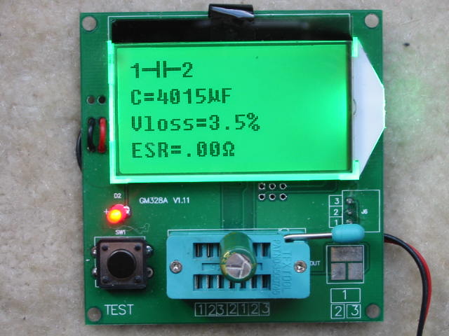

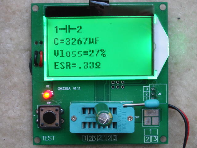

                              And looks like I took pictures of that too, back then. Just found out I had them yesterday, lol. (My file organization has slacked a bit for the lat 3-4 years.)
                              Anyways, pictures attached below.
                              I find it funny that the bulging cap is showing lower capacitance than the normal-looking one. But then look at its Vloss - a whopping 27% and ESR starting to climb too. I think what happens is the electrolyte keeps "attacking" the foil layer and at the same time also forms excess Hydrogen gas (with or without the presence of an external power source.) Then, once the cap's vent operates, the electrolyte starts to dry out, making the cap loose capacitance and increase in ESR.

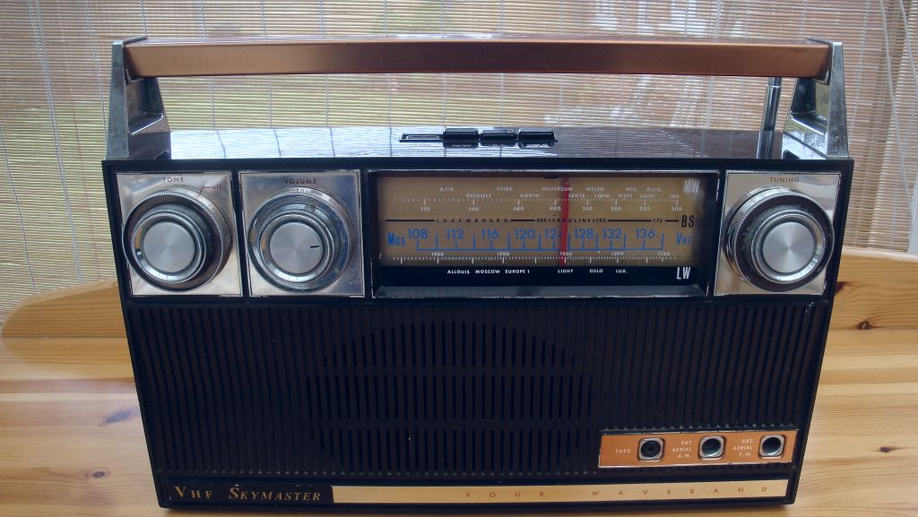

                                      Pictured is a very nice example of a VHF Skymaster that I acquired on ebay recently. The transistors in these usually suffer from the tin-whisker problem, so probably why this one isn't working. Suitable replacements are in the post [from Ukraine!].
                                      I've owned one of these radios for over 50 years, but it's not worked for decades. A great radio in its day, so I hope to resurrect it. It's as dead as a doornail at the moment.
                                      https://www.radiomuseum.org/r/masteradio_d517.html
                                          Wow, that's a really cool radio! From the time when it actually meant something to own one, I imagine.
