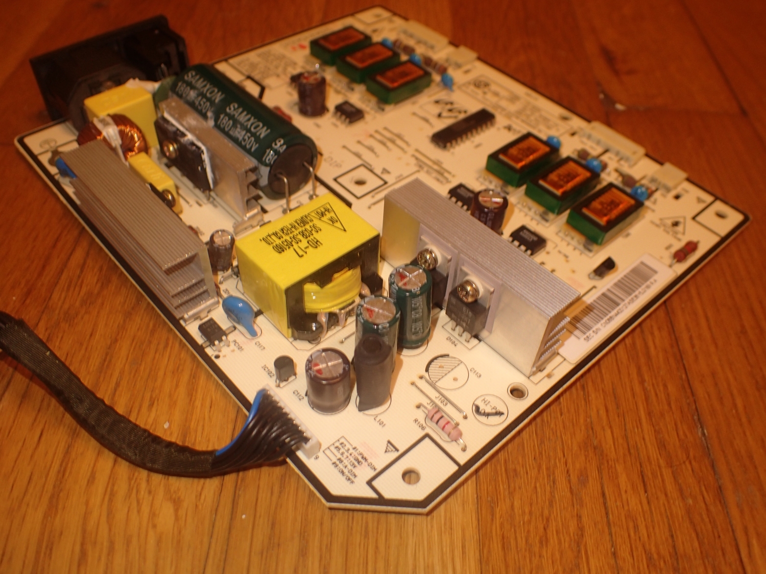

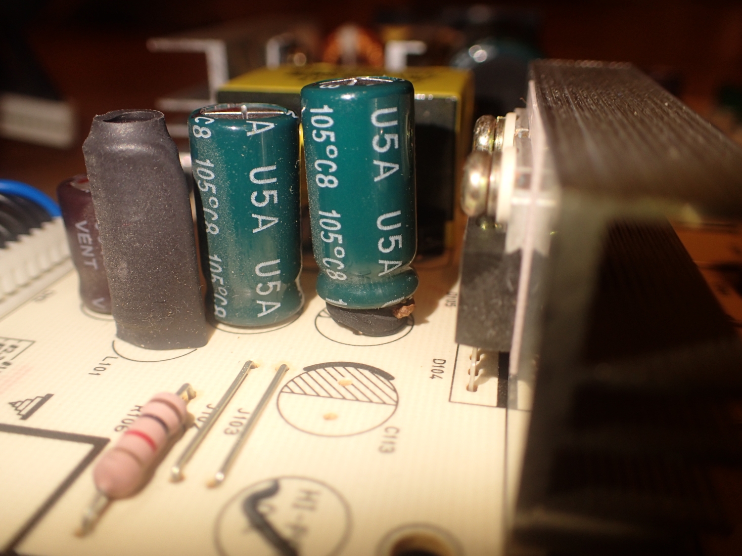

                      Anyways, I've got some specimens of my own to share.

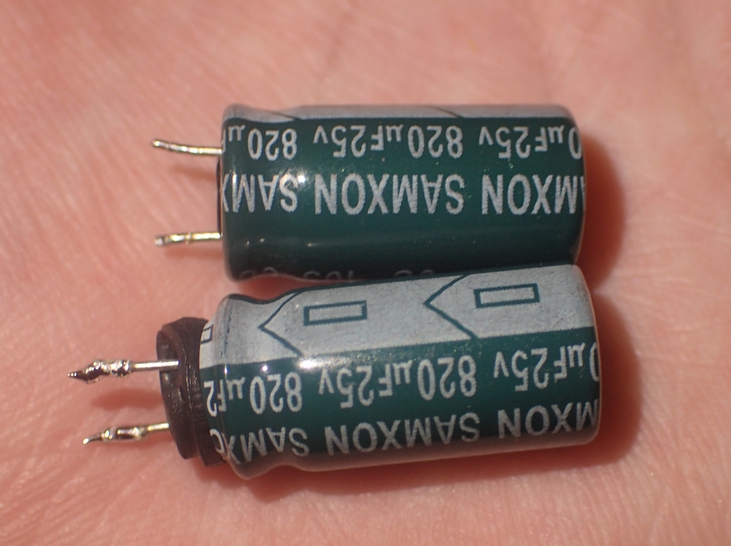

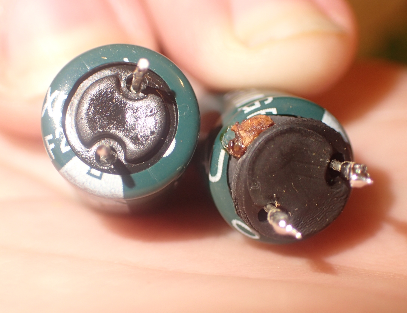

                      The notorious Samsung SyncMaster 204T, with failed SAMXON ("Sam's Gone") GF ("Go Figure") caps.
                      The bung has pushed out, and a little crust built up. Who fed this cap some Taco Bell?
                      The bloated cap measures a measly 51uF, and the other measures about 340uF. Both way out of spec.
                      NOTE that the non-bulged cap has a wet appearance on the bung, I think it has been leaking!
                      The CapXons (GL series) *appear* fine, but I'll replace them anyways.

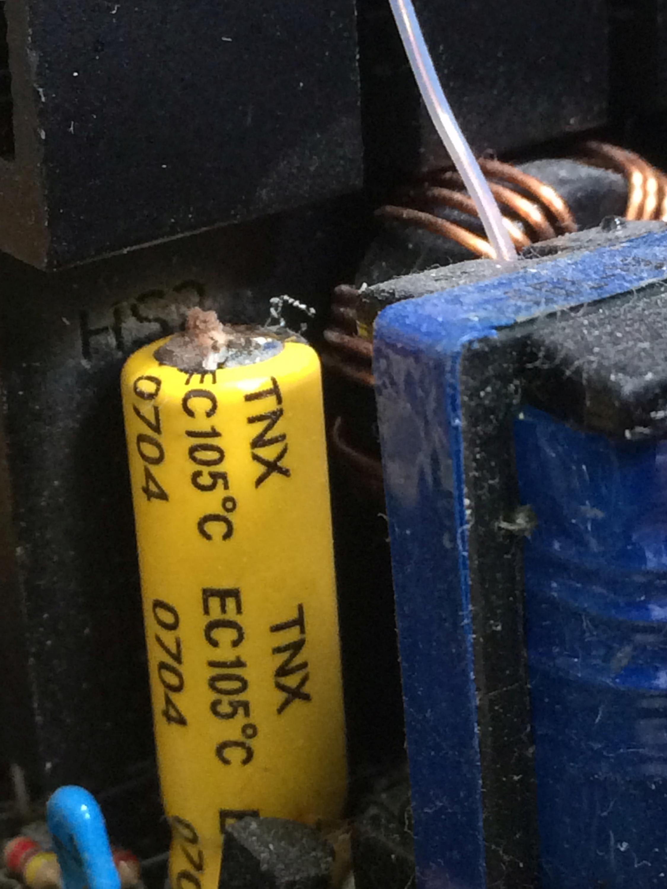

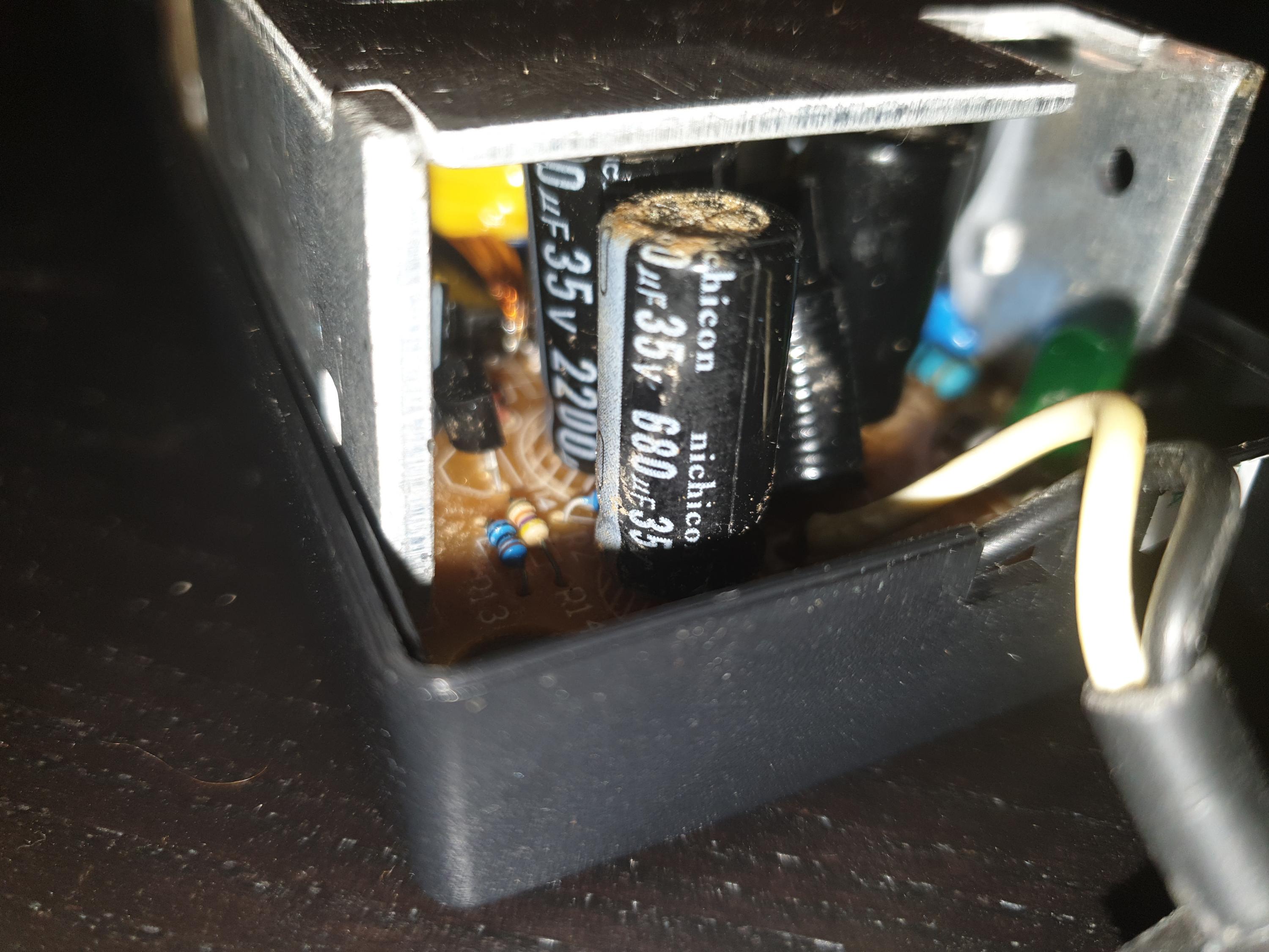

                            Found the attached slightly vented capacitor in an xilence 1000W ATX power supply - when issue first surfaced, the supply would only run on warm days, so it had a couple of months of being assisted with the gentle application of a warm hairdryer, though eventually it gave up altogether. This capacitor appears to be the only one showing signs of failure, though I've not replaced it as yet.
                            • PeteS in CA
                              • Aug 2005
                              • 3586
                              • USA, Unsure of Planet
                              #954
                              Re: The Hall of Shame - Badcaps Photo Montage
                              Well, on one hand I'm pretty sure that's a low quality brand, but on the other, it's about 12 1/2 years old. Even if it has needed hair dryer help for 2 years, that's a reasonably decent life.
                              PeteS in CA
                              • Opeless
                                • Dec 2018
                                • 3
                                #955
                                Thanks for your comment PeteS - that's a valid point, and I'm not particularly upset about the failure - I just added the pic for interest. The cap is mounted against a heatsink too, which likely also had some bearing on its failure.

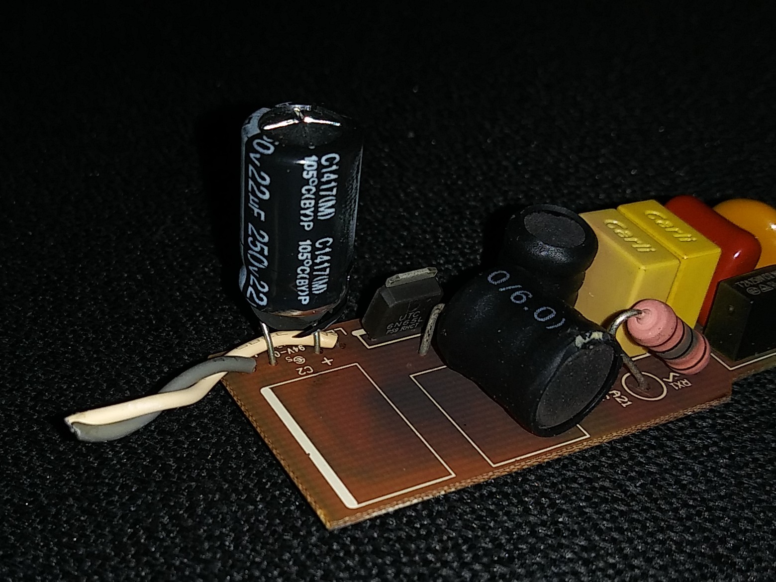

                                  Taicon BY 22uf 250v.
                                  This is in an older Feit Electric LED bulb that has a LED with a corner burned off.
                                  I'm not a expert, I'm just doing my best.
                                  • PeteS in CA
                                    • Aug 2005
                                    • 3586
                                    #957
                                    Whole lot of toasty badness going on there, ruky con!

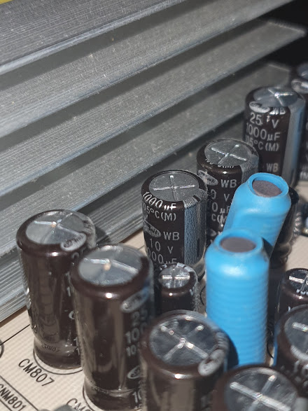

                                        Samwah WB series from a Samsung TV (Hansol?) PSU
                                        The bulging caps are 1000uf 25v, there are also 1000uf 10v caps that while not bulging, may also be bad.
                                          Seen plenty of bad WB series caps, they also fail open without any visible signs as well. Replace all of these caps, not only the bulged/leaked ones.
