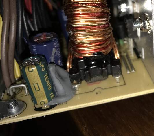

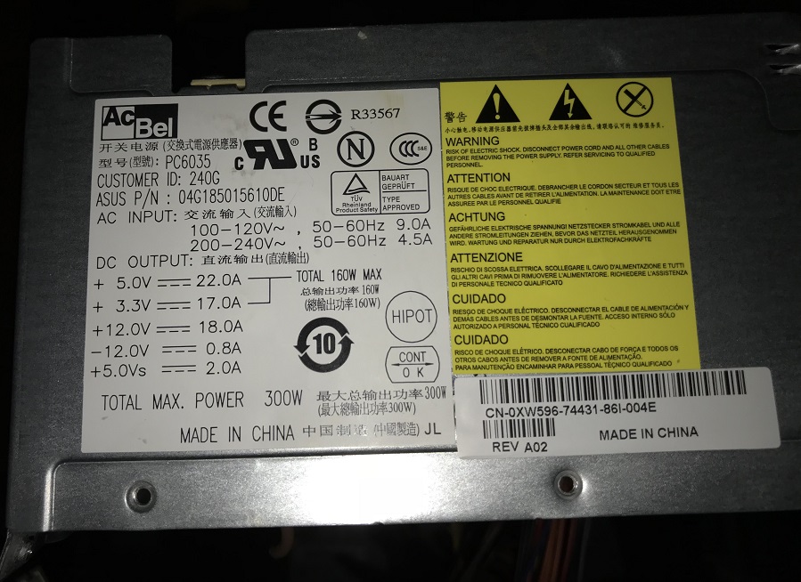

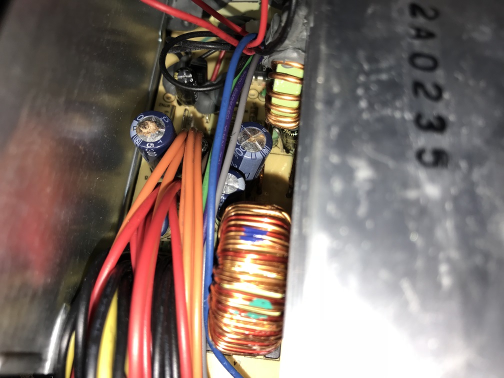

                                Re: The Hall of Shame - Badcaps Photo Montage
                                PSU from a Dell Vostro 200 (300W AcBel).
                                It has a nice mixture of Teapo, Ost and Ltec caps (all the failed ones are Ltec).
                                The bad caps caused intermittent booting problems, and the harddrive is damaged (extremely slow).

                                  #876
                                  Check if the drive (or the controller) isn't stuck in PIO mode, sometimes happens. Look into device manager.

                                    #877
                                    Typical.
                                    I've found that lately, Ltec caps fail even before CapXon does, especially in OEM units. Same PSUs with Teapo, CapXon, and Taicon all still work okay.
                                    So now I recap Ltec on sight.
                                    Also, I second what Behemot says about the controller stuck in PIO mode. I had that happen a few times as well. If the HDD is not making any weird noises when opening files and is just slow, it's probably a controller speed issue.
